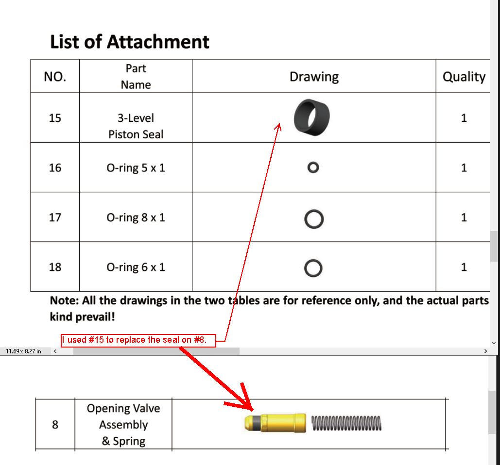

I bought a GK1 and HB-35 together but on my first fill of the GK1 the HB-35 popped the opening valve seal. Luckily in the spares part #15, 3-level Piston Seal, seemed to be the same as the band like seal on the opening valve assembly. On the opening valve assembly I found that band like seal slightly mangled and when I took it off there was a small o-ring left that was under it centered under its width. I used silicone grease and pump oil and the spare #15 slid over in place of the band like seal on the opening valve assembly and the o-ring that i discovered under it. The entire reason I joined this forum is to locate a source for more of the #15 spares since if they are interchangable the spares bag only has one spare (that I used) when the pump is using 2. So I want to replenish the spare. Both the Opening Valve Assembly and 3-Level Piston Seal are sealing on the same tube and ID spec. My pump works great all the way to just under 350 bar because I leave it with that pressure at times and if it got warm... It pumps to 350 bar just fine too after using spare #15 on the opening valve assembly. I used silicone grease and pump oil while putting the HB-35 back together. Any help on locating HB-35 Handpump parts?? Any help would be a huge relief - what a waste of money if you can't find parts. I think it may very well have been a fluke that this seal blew on the first use around 300 bar and I have filled the GK1 a few times since putting the HB-35 back together so I feel that the pump is working well now and want to believe it was only a rare fluke.

I e-mailed the manufacturer directly. They responded copy and paste next,
Dear Miles,
Sorry for the delay reply!
Frankly speaking, I don't have such detailed information of all seal parts, all the needful parts we put in the spare parts package with each handpump. 15# to replace 8# is correct, if you need more of this part, you could purchase it through our Spain dealer, they have shipment every month, pls kindly note! Thanks!
Have a great weekend!
Best Regards
Jacky
Huben Hong Kong Co., Limited
Email: [email protected]
Website: www.hubenairguns.com
YouTube: Huben Jacky
Facebook: Huben Jacky
WeChat: Huben - Jacky
And since sending the email I have found pretty detailed parts list. Still waiting for some glimmer of hope in being able to locate and buy the seal that i used out of my spares bag. The response did help with me being pretty sure what I used the spare #15 for was OK.
