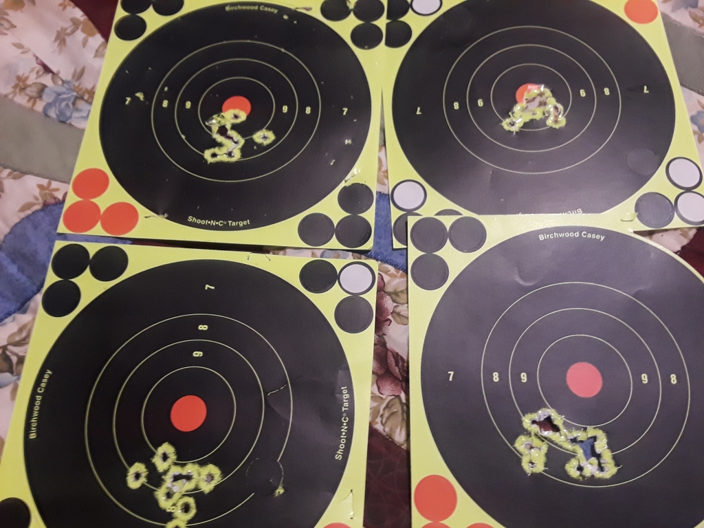

Alright here are my 50 groups with Huben K1 with jsb 18 @870fps. There was heavy wind. Top two groups were with a cleaner barrel and less wind. Bottom two were with heavier wind dirtier barrel. Bottom two were on camera, plus some 100y steel.
https://youtu.be/ls0FaEYwQ_o
I was planning on shooting slugs only with this gun. But, with a 110bar regulator and the gun being extremely efficient, I'm going to go with it as a pellet gun. Over 100 shots with a 4500 fill at this setting, still at 30fpe. With a low tank I can still hunt.
