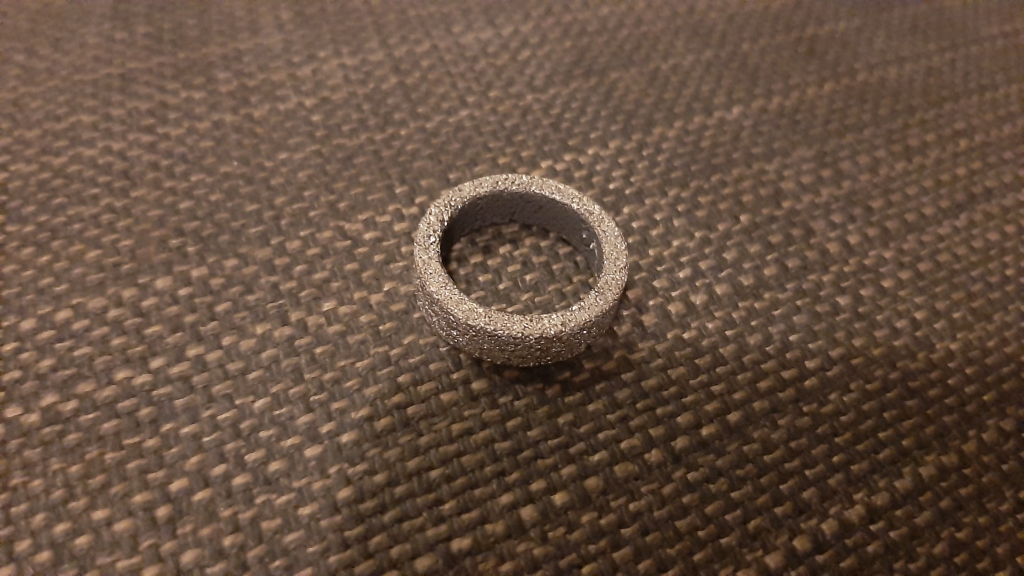

Huben k1 needs some adjustments to develop 100% of its performance.
The first point is its suppressor, it when original and new works until well but after some time of use it is no longer efficient because it absorbs a lot of waste and ends up interfering in the precision (generating flayers).
Picked up a used K1 recently and yes, flyers all over. I removed the baffles from the shroud and bingo, no more flyers.
There is lead built up on the inside of those keramik(?) rings between the baffles. Cleaning that should help?
