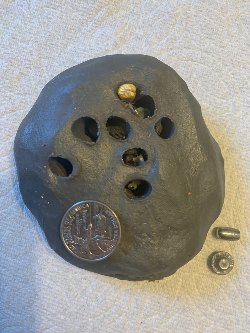

Here is an 8-shot group, with one hole-in hole at 100y. Shot into duct seal block into a tree with a piece of corn stuck in the top to help me spot it! No cherry picking, just 8 from bags with a strict 8 seconds between shots. Since it’s semi-auto, I expect it to be able to shoot quickly!
It’s around 1.6moa CTC, with the caveat that the soft putty tends to expand from the impacts. 8-10mph wind but that doesn’t mean much with a BC of 0.21. Not my Panthera accuracy, but considering the form and size, power and semi-auto function, I think it’s phenomenal!
Also pictured are the slug before and after the shot. Rifling marks are clear, expansion almost complete and every slug I’ve shot has expanded in a concentric manner, indicating that they are flying stably and hitting the duct seal straight. I didn’t officially test BC but the strelok predicted drop was right on.
