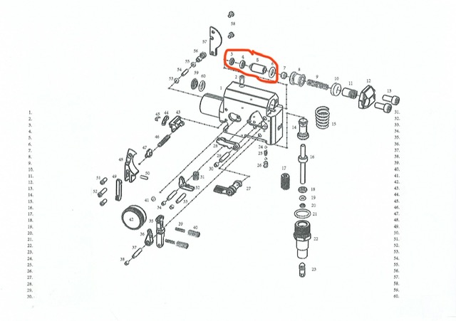

If the air is leaking from the barrel then the valve(part #5) or one of these parts: #3, 4, and 6 are bad. You need a special tool to remove the valve or you risk damaging it. Contact Kelly (owner of Kraz Cool Airguns). He can sell you the parts and might sell you the valve removal tool as well.

I just had kinda the same thing going on. On mine most of the air was leaking out the bottom of the receiver. O-ring #6 was bad. You can ship just your receiver to Kelly and he can go through it for around $100, give or take on the parts needed and labor. I shipped mine to him last Saturday and I was putting back together and shooting last night. I am super pleased with fast turnaround and customer service. Good luck, I hope you figure it out.
