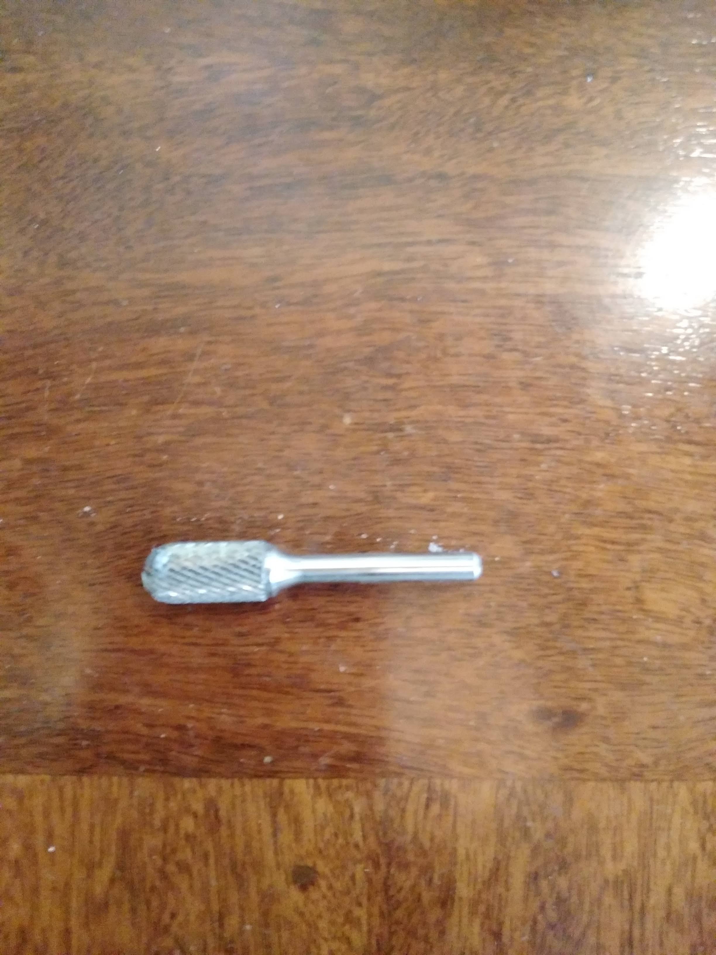

I recrown the barrels of my rifles with this tip and the drill:

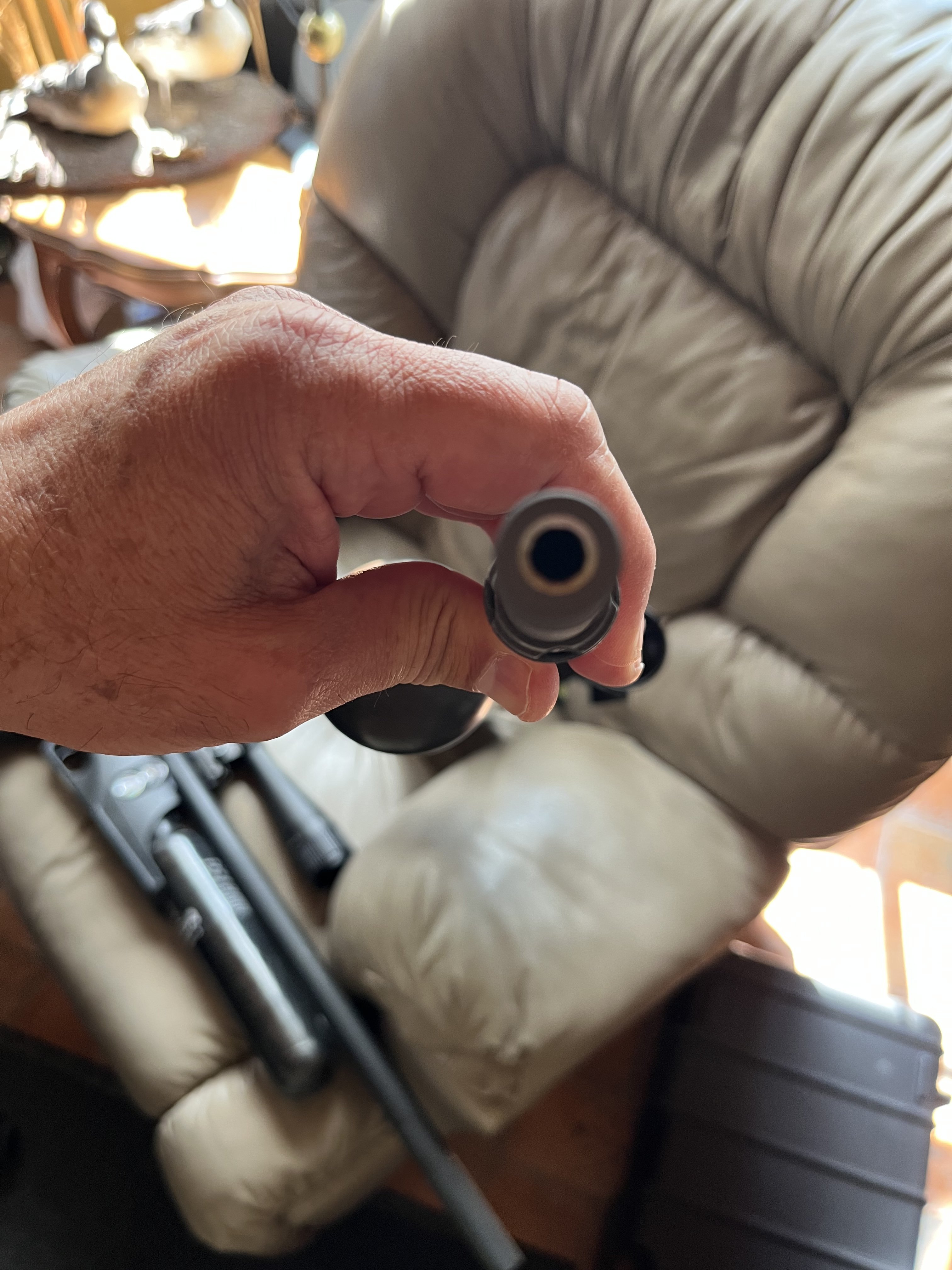

I will consider this. I was wondering if the baffles in the shroud are doing something too. I may take the shroud or at least the baffles out and see what happens. Next time I have it apart I will take a look at the crown and see if it seems rough. When I polished the barrel with the non embedding jb, I did feel it get smoother. Looking down it, it seems to be pretty dang good
I would reconsider using a hand drill to do any barrel work unless it was a cheap crosman barrel. If you want to shoot slugs more accurately put an unchoked barrel on there. The stock barrel does best with pellets

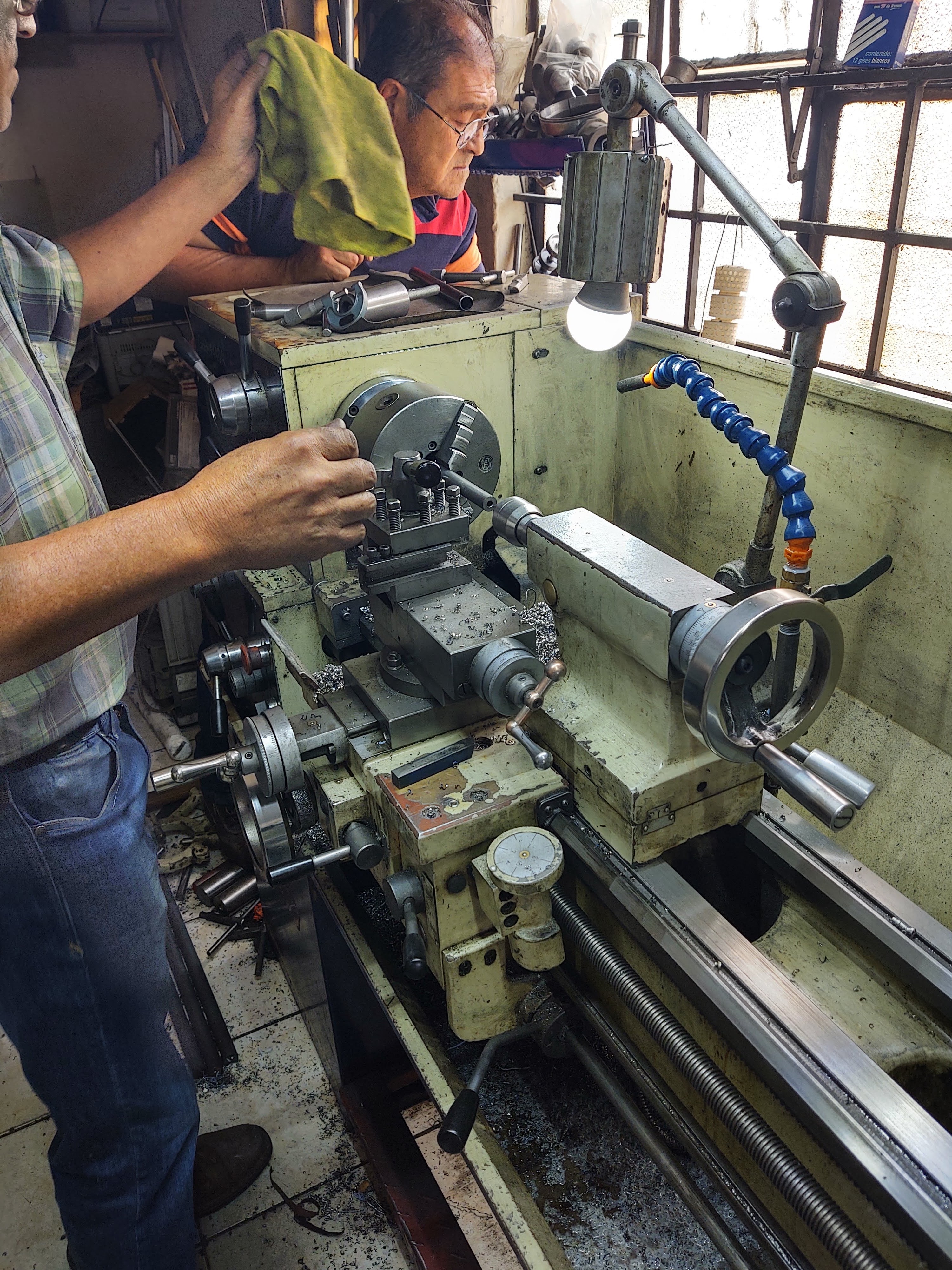

I bought the LW barrel to replace the original one that had a very bad accuracy.
I took the new one to machine it and made it fit in the Bantam. Precisely. So I am not afraid of working with the barrels. They just need to fit precisely.
When you said drill I thought you meant hand drill. You have the right machine for barrel work sir👍
