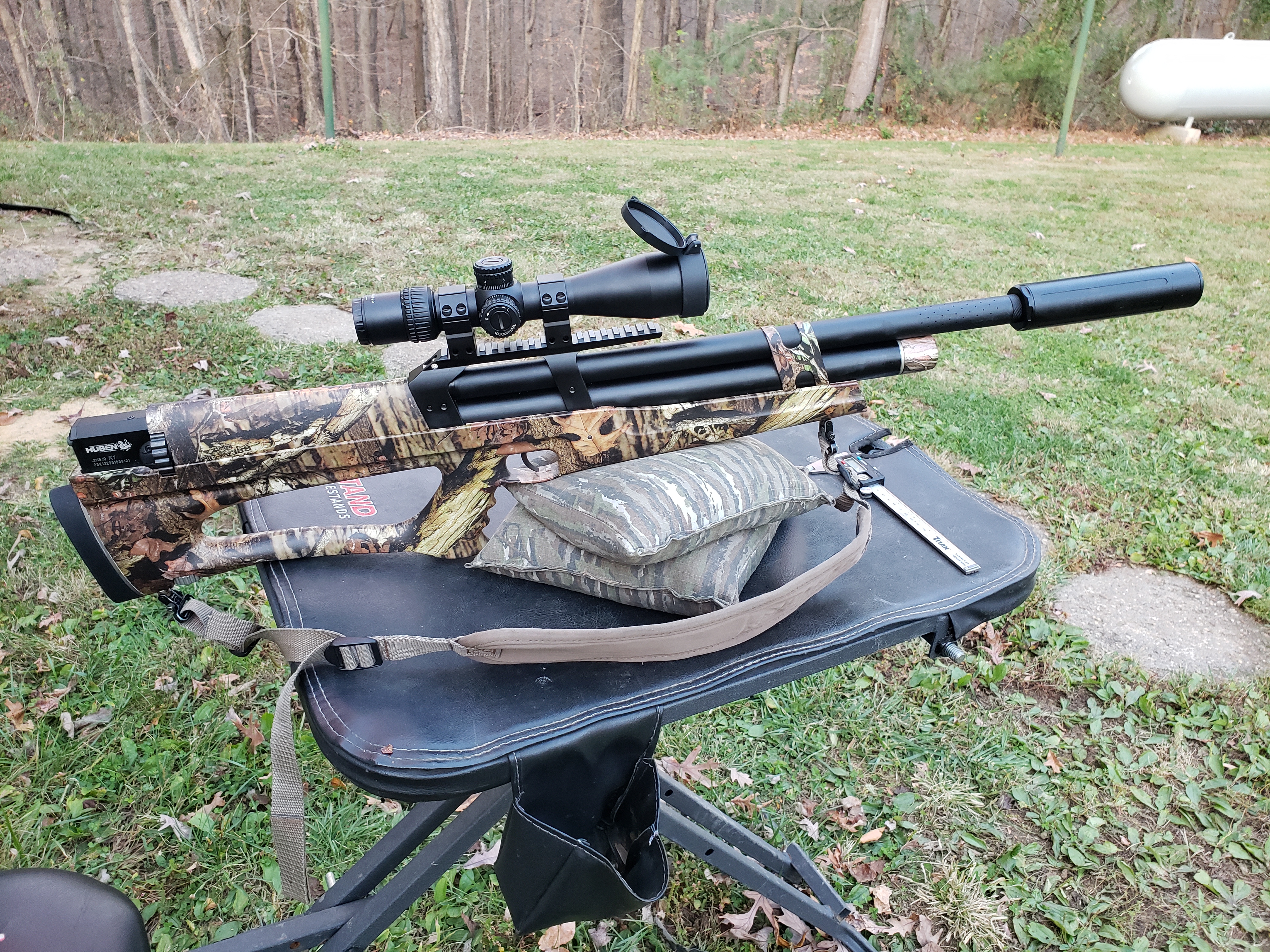

Huben k1 before and after barrel polish
The TJ barrel is .250, were you still using .254 slugs? Or did you get the custom mag for .250 slugs?
*if you were using the correct .250-.251 slugs in the TJ barrel with the stock mag that would explain the terrible accuracy as you know the .250 slugs would be loose in the stock mag and negatively affect accuracy

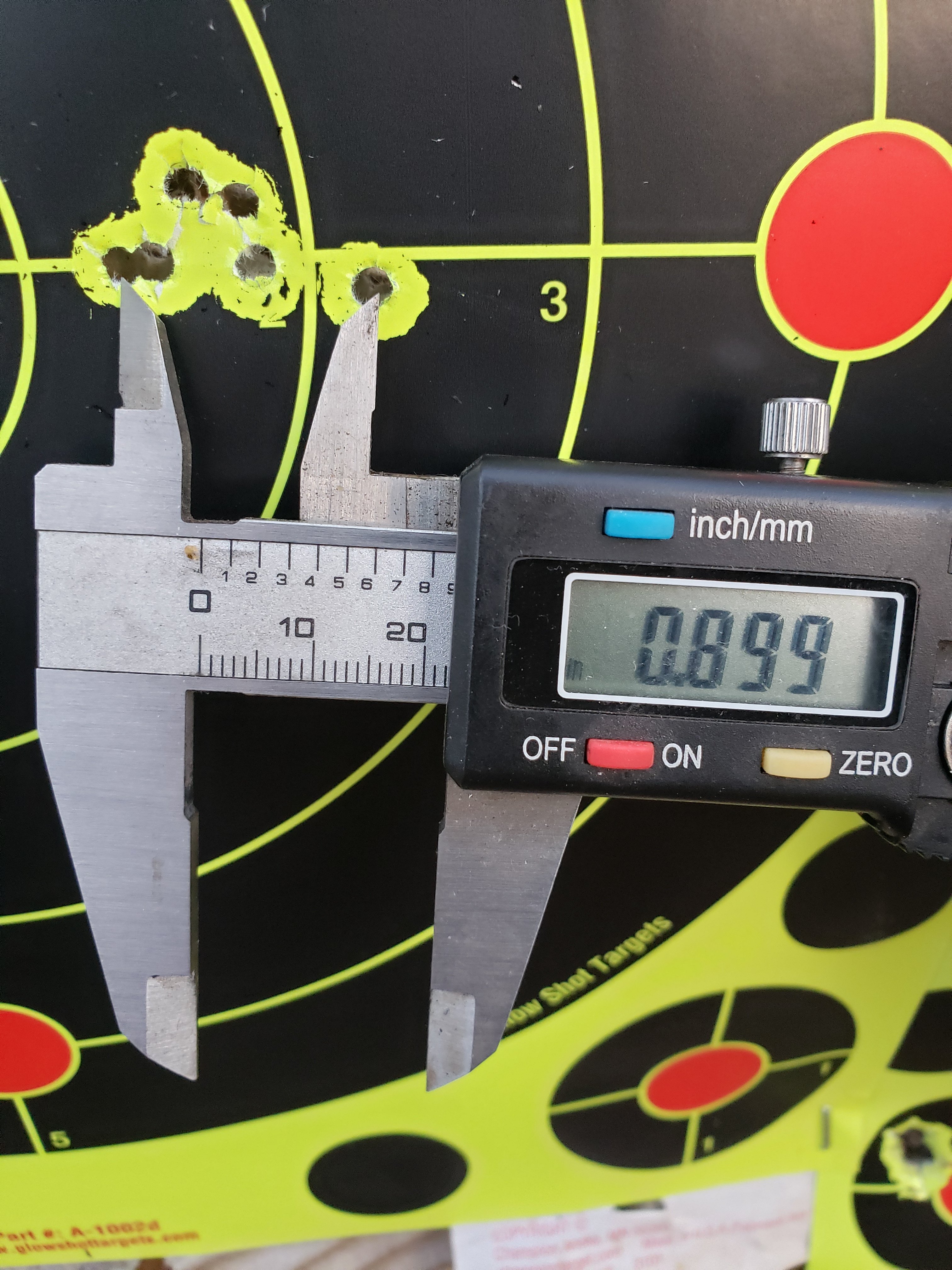

I honestly did not consider the magazine and Kelly didn't mention anything about it. However the accuracy was so bad I find it hard to believe that a slight mismatch between magazine and barrel would account for the accuracy I saw. I'm talking like 6 inch scattershot groups at only 25 yards from a rest. Of course I could be wrong. Like the stock barrel, I tried .250 NSA slugs, and .2513s from AVS, .253s, and .254s with the tj barrel. I still have the tj barrel. Does Kelly sell the modded magazines and if not, where? If he does I find it strange he wouldn't mention them or put one on when i first got it with the tj barrel. Or when he sent me the stock barrel afterwards he made no mention of having to change the mag due to putting a different one on first

I was blessed with a very accurate Huben from from the start but, I was also able to take it from good accuracy to incredible accuracy by taking the time to align and stabilize the baffles in the tube.
Baffles appear to be machine pressed and shaped and while the reasonably well fitted to the tube there is some play in the tolerance so I suspected some clipping.
To remedy this I removed any burs from the inside the baffle holes and added a thin washer at the top to ensure everything was compacted tight while simultaneously running a carbon Arrow through all the baffling to the barrel to keep everything aligned all the way down to the barrel.
The arrows I currently shoot just happened to be the perfect size. I also replace the end cap with a Donny FL adapter and an air stripper.
All this really took my accuracy to the next level with the Huben. It's lights out all the way to 100 yards.
I believe it would be worth your time to make sure your baffles are aligned and compacted in a similar method as I described, before declaring the barrel or the crown as the problem.

Whatever you run through the baffling to align it make sure it's very straight and soft where it touches the barrel so it's not too damage your crown. The air stripper I use is a Hatsan. I removed the brass Center piece to lessen the possibility of clipping there also and still benefited from the air stripper housing.
Even without the air stripper , Just the aligning and compressing the baffling by itself should show drastic improvement if clipping is the problem.

I've addressed many of these in the thread and post. Depends on what you mean by " doesn't like slugs" it's capable of .5 inch groups at 50 yards but I'm trying to dial in its 100 yard accuracy. Even back then people were referring to it as a slug gun. Even with the choked barrel although I do understand the distinction

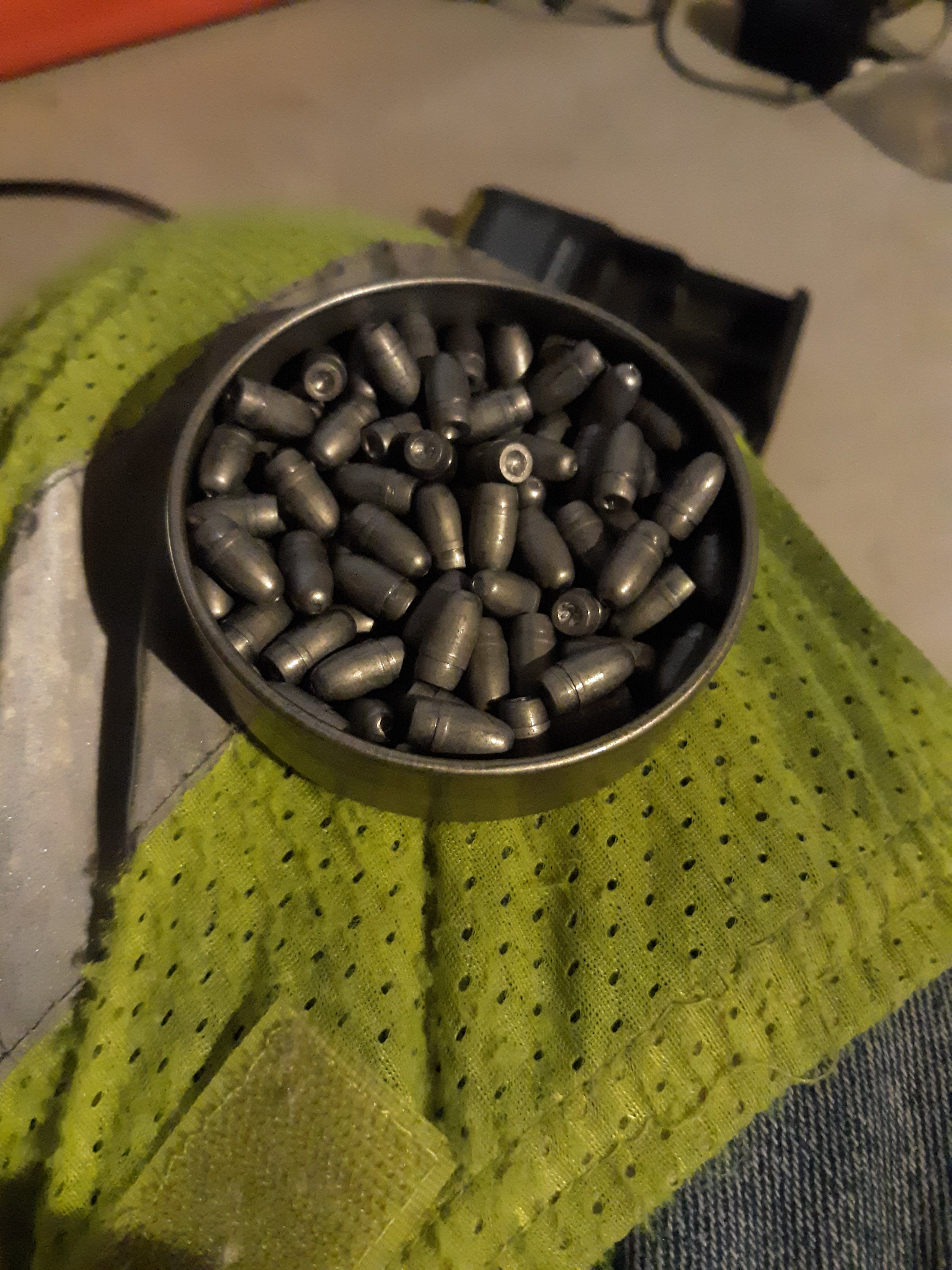

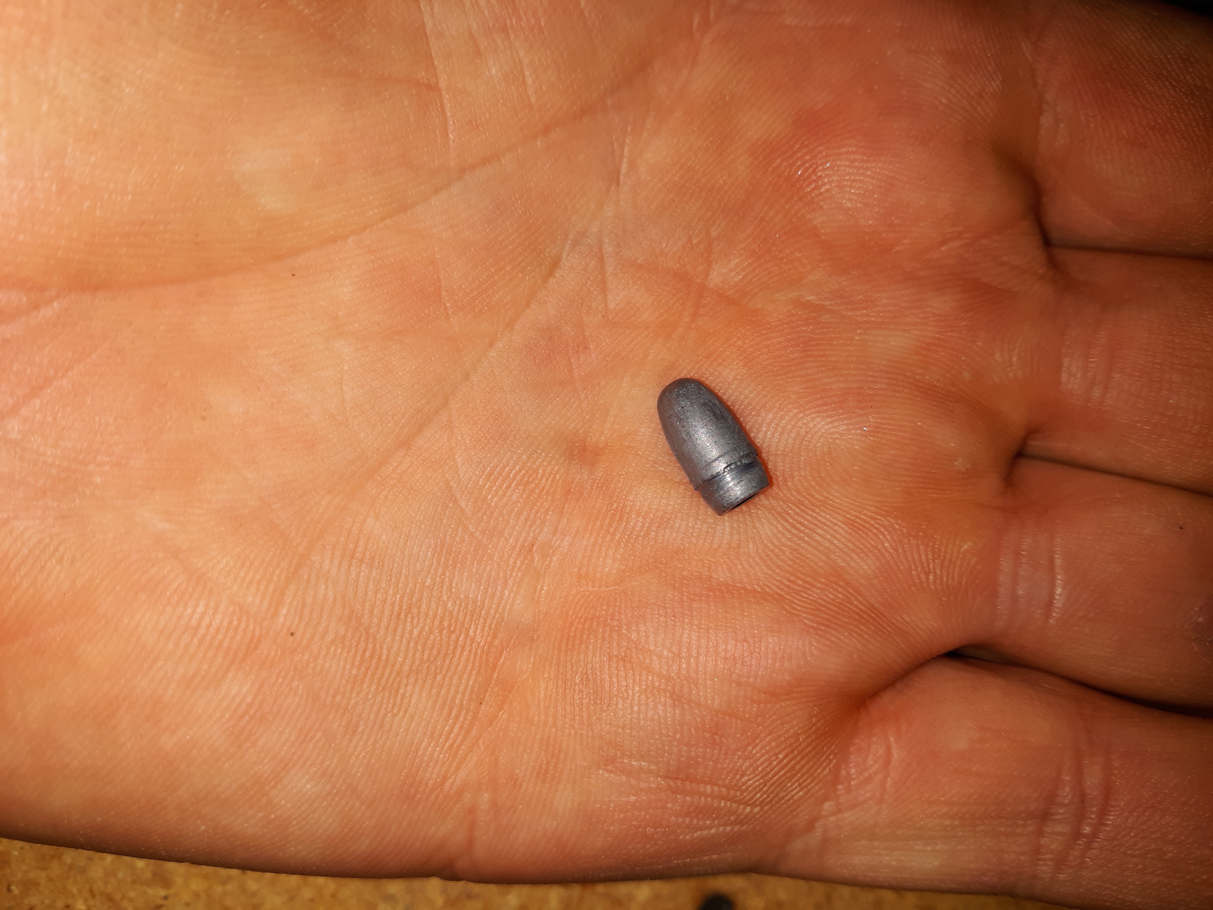

Yes originally I had a swage die from huben but they were poor quality in terms of longevity of design, and I was very careful with it. It's slow use and unreliability is what made me get the Corbin. These are the slugs it made, roughly 36.6 grains. I still have 450 of them
