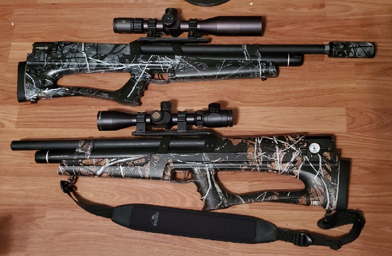

several of us have the 2018 versions and a couple 2016 versions in my area and have settled on the 25 gr JSB as the best all around pellet. However we also found those models to like the 18 gr JSB. I have one set up for 25 and one set up for 18 so I don't have to keep changing settings. One guy is shooting the 21 gr H&N Barracuda with good accuracy.
Usually keep my reg setting around 120 bar for 18 gr at 915 fps and 130 bar for 25 gr.at 900 fps. Gets lots of shots and is a pleasure to shoot.
I never had much luck with slugs or with the 34 gr JSB in these. .
Black one is set up for 18 gr and brown one for 25 gr.

Excellent thanks, my must arrive next week so any advice is very appreciated, love the look on yours!!!.

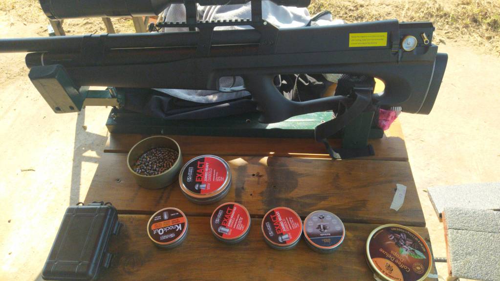

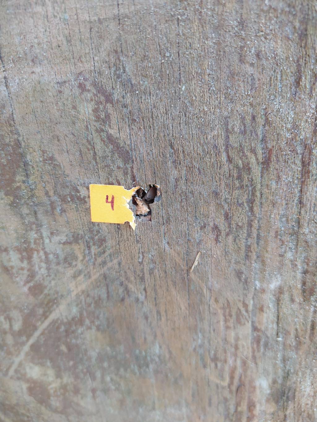

Well my HUBEN arrived yesterday and today I was able to test some pellets, JSB 18g, 25g ,33g .216 knockouts and 21g h&n and by far with the actual configuration ( how it came from the factory) it loves the jsb jumbo beast of 25.39 , at 40meters it made almost a single hole and it's firing them at 935fps so I'm very happy with the results, now I need to play a little more with it and see the accuracy at longer ranges.
