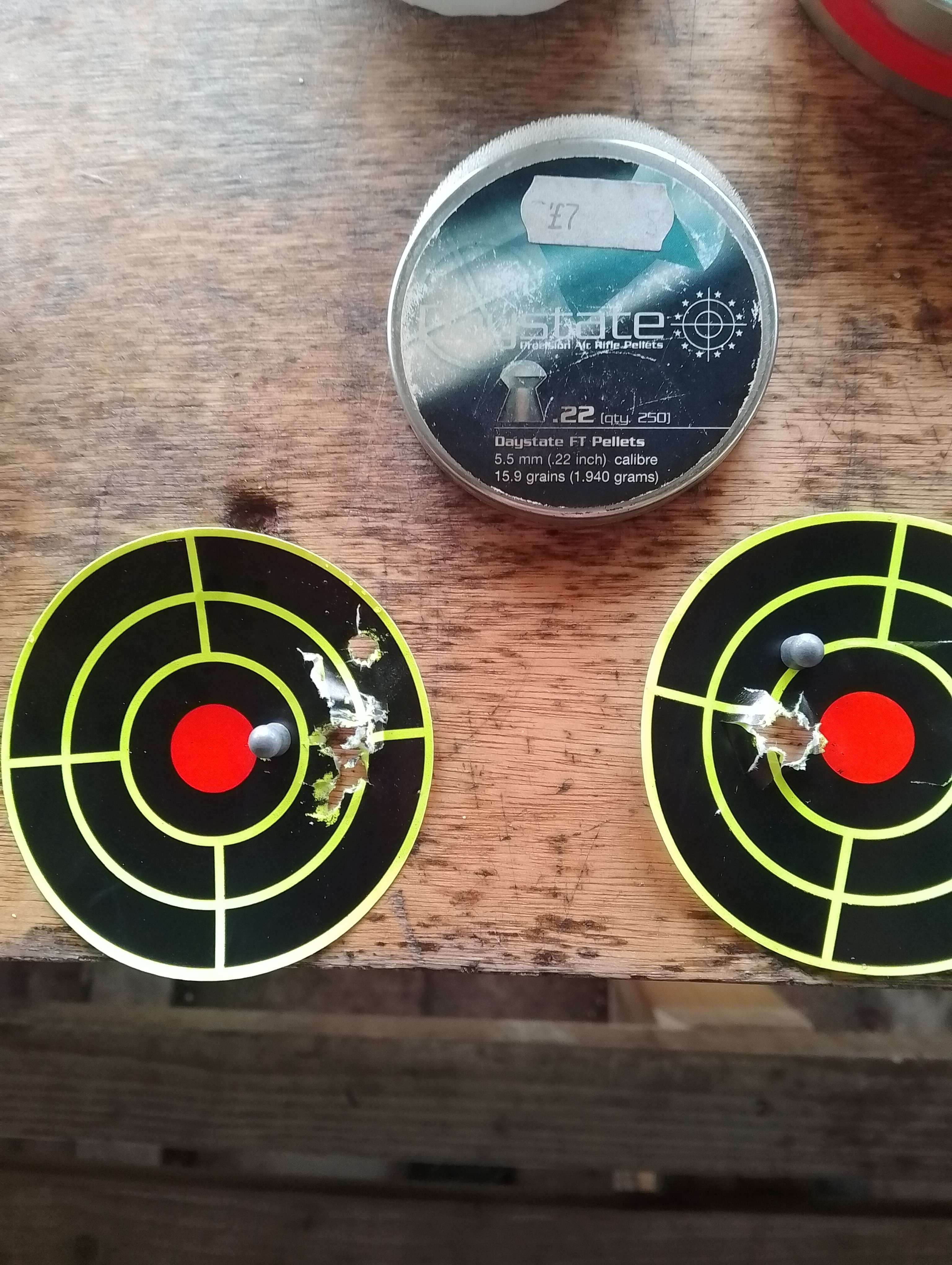

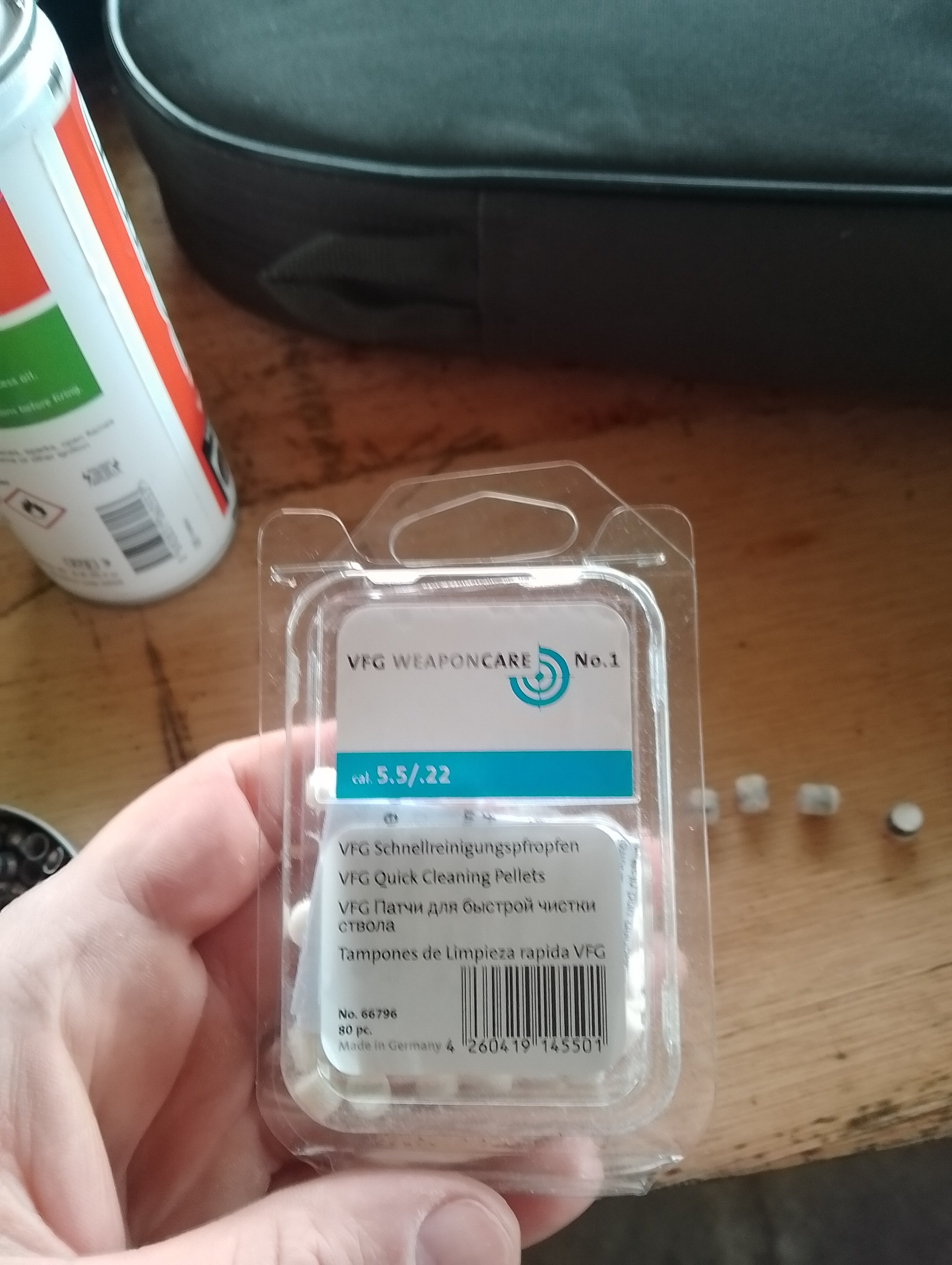

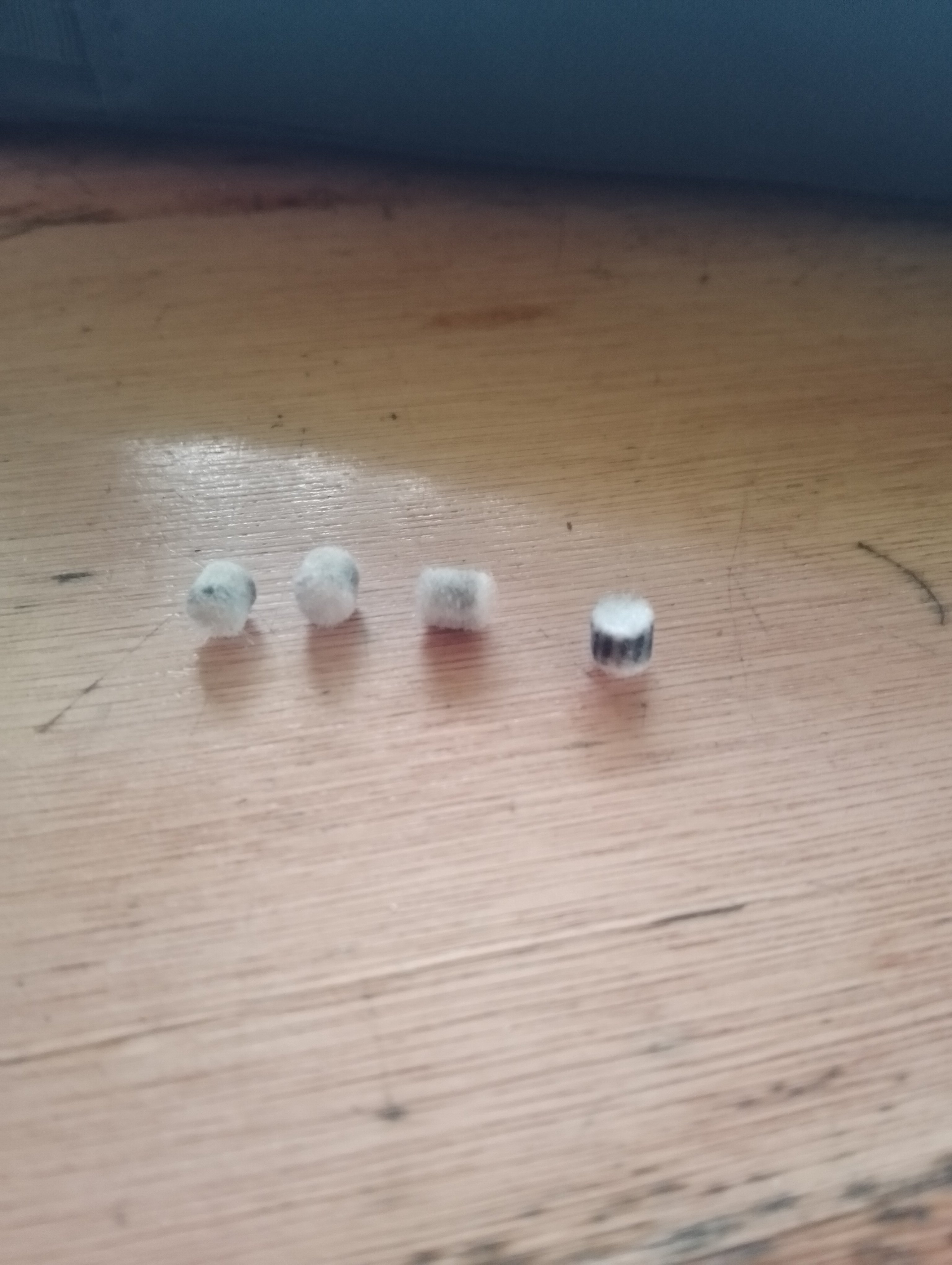

Hi guys cleaning pellets work, after getting my k1 and trying to figure out how To clean the barrel these really work and it's easy , I am UK sub 12flb so don't know if it will work on high power. I hope this help guys , that group is a 50 yard group

You won't get a 6mm tube down the barrel buddy for a .22 , it worked for me with the vfg pellets, I put them in the mag then pushed them to the front of the mag , i am using a 12fpe gun so you might have to turn yours down first if you have a full power version
Just to check, did you only need those 4 cleaning pellets to get a clean result?

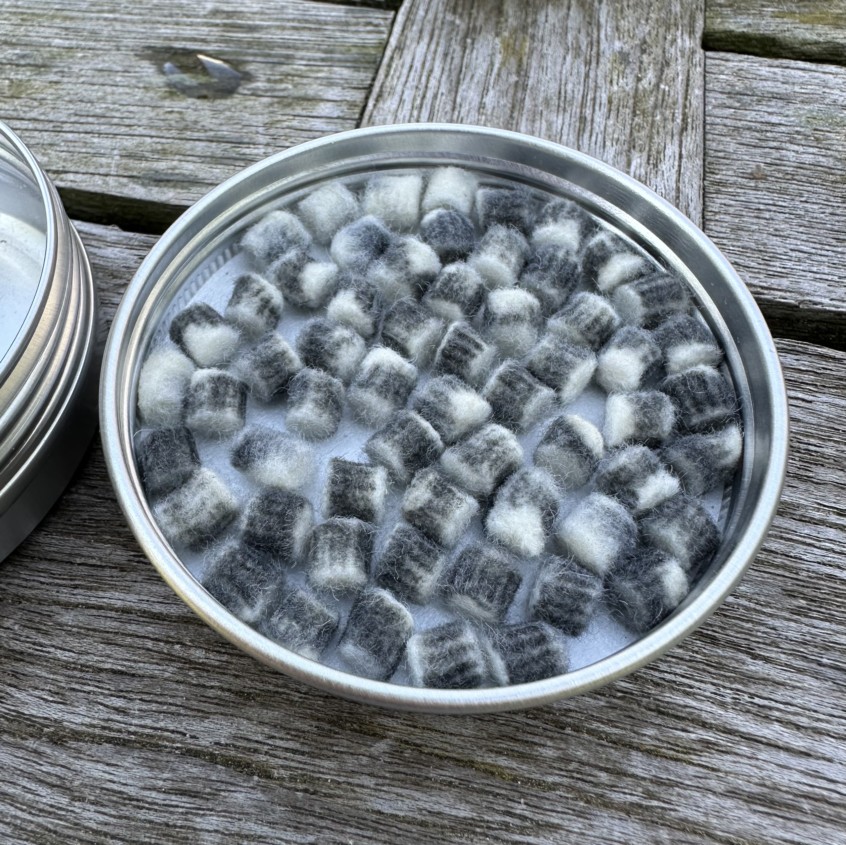

Yeah - I've been using this method on my K1 and GK1 for a bit now. I usually wet one cleaning pellet in Ballistol or CLR and load it. Then I load a dry cleaning pellet behind it. I do 2 or 3 of these followed by a final shoot with just a dry cleaning pellet. Definitely enough to restore accuracy in a slightly leaded barrel.
