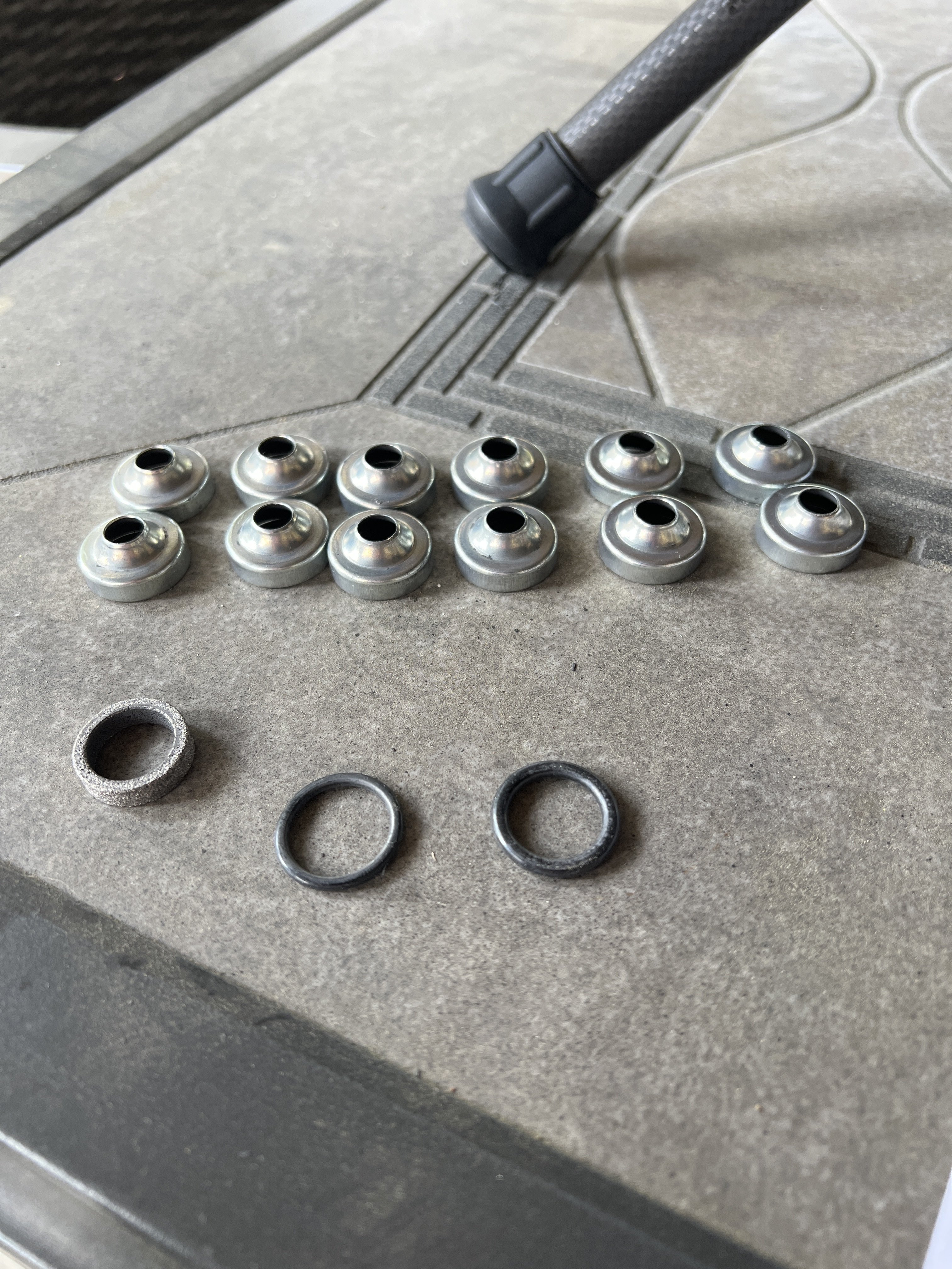

Does anyone know the correct order of the pieces of the internal moderator baffle for the Huben K1? Inside the stock shroud where the holes are I had a several washers and spacers and one thin o ring fall out. I don't know the order they go back in. Any help would be great. I tried to do it myself using the "this looks like how it should go" and that did not work. Thank you.

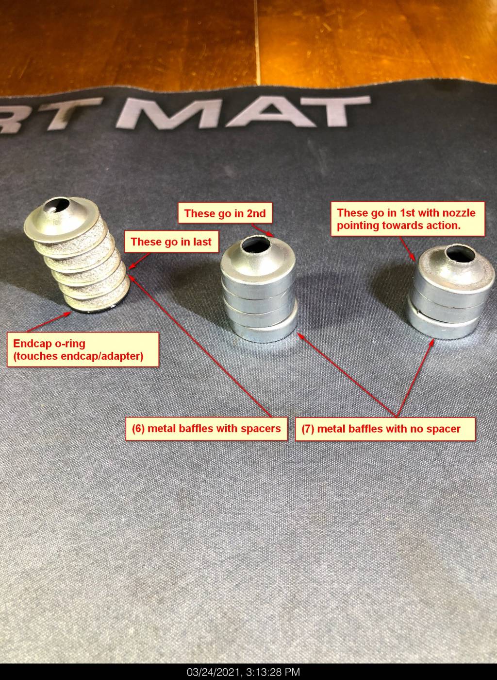

Kelly Schmidt at Kraz Cool Airguns confirmed the below picture I took of baffle/spacers order is accurate. Mine had gotten mixed up after I removed the shroud on my Huben K1 2021 .22, and wasn't sure how to put them back correctly :). A picture always helps to visualize.
