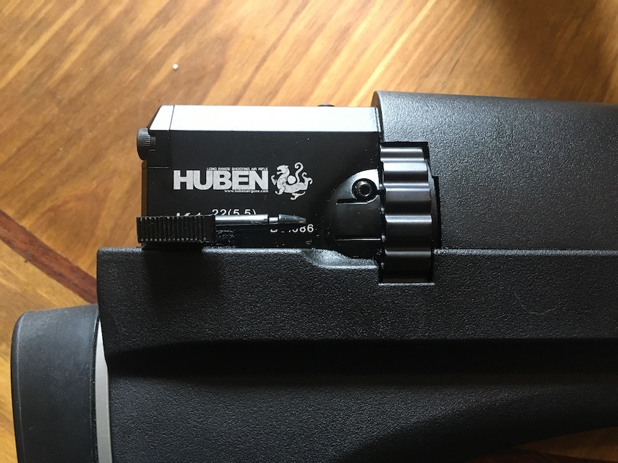

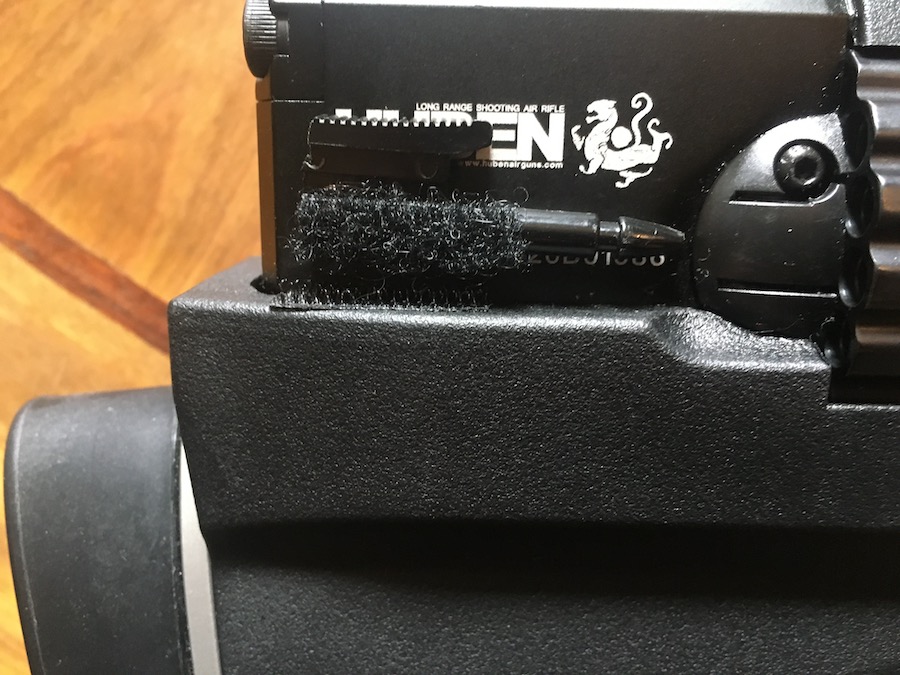

i've been extra careful of making sure i seat my pellets in my huben to avoid jams. in order to make this easier, i cut up a pellet pen, and stuck a small amount of velcro on the probe, and stock, so i always have something close to seat the pellets with.
does anyone have a more elegant solution than this? this definitely works, but i can see the velcro wearing out over time, or me dropping the probe at some point while in a rush out in the field.
picture1: how it sits on the gun while shooting

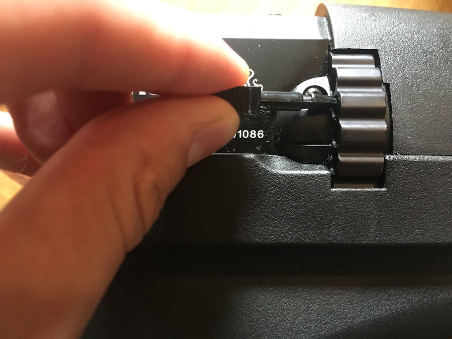

picture2: usage
picture3: showing the velcro

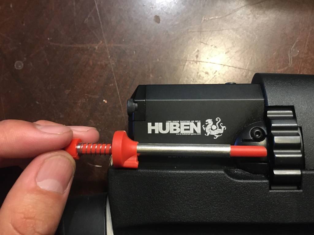

i started to cut up some pens, to see if i could make a way to permanently attach a portion of a push pen, so i could just push it in, and the spring pulls it back so i can load the next pellet.
was hoping someone with better problem solving skills had come up with a solution like that. so its jsut load, push to seat,

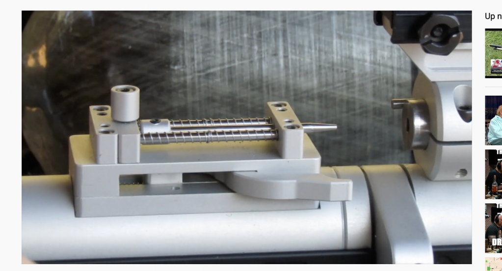

A 4 pellet or even 2 pellet seating tool wouldn’t work with the huben unless you removed the single loading gate(I bought mine in 2018 so I don’t know if the newer ones have the same loading gate). If you remove the loading gate you risk pellets falling out. I know even with JSB 33.99(.25) some pellets will become loose after seating. You would need to install a swing loading gate like on the LCS.

well this solution only allows me to load one pellet at a time but i will be able to seat it after i turn the mag to load the next one. i think this will be easier overall, instead of grabbing something out of my pocket to seat each time.
cut up one of these, and found a matching sized spring:
