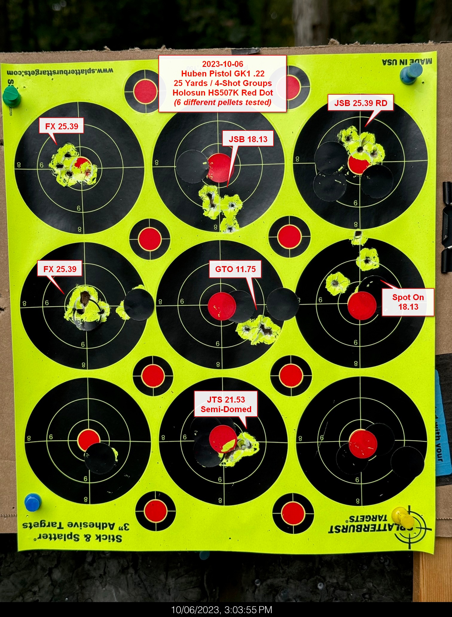

I tested six different pellets with my Huben Pistol GK1 .22 and a Holosun HS507K Red Dot. I wanted to see which gave the best groups. I don't have the 'young eyes' many of you have, but I relaxed, and tried my best from a bench at 25-yards. Each pellet got a 4-shot group (with the FX 25.39 twice).
Background:
- Huben Pistol GK1 .22
- Power Adjust: 1.5 turns out (open). For reference, FX 25,39 shoot at about 33-35 FPE (ft/lbs) at this power.
- Holosun HS507K Red Dot
- 25-yard, 4-shots groups.
- Pistol initially zeroed at 25 yards with FX 25.39.
- Pellets: FX 25.39, JSB 25.39 Red; JSB 18.13, Spot On 18.13; GTO 11.75; JTS Semi-domed 21.53
My question to the experts, is "why do the lighter pellets seem to shoot lower, when they are actually moving faster'? The JSB 18's and GTO 11.75 hit lower?
The GTO and JTS's were the best based on this test. But, the FX/JSB 25's were not far behind.
Basically recoil but because your grip prevents backward motion, the recoil is expressed as the muzzle moving upwards (rotation around the center of mass, which is below the bore). Heavier projectiles cause more recoil force and take more time to leave the barrel, both of which enhance the upward POI shift.

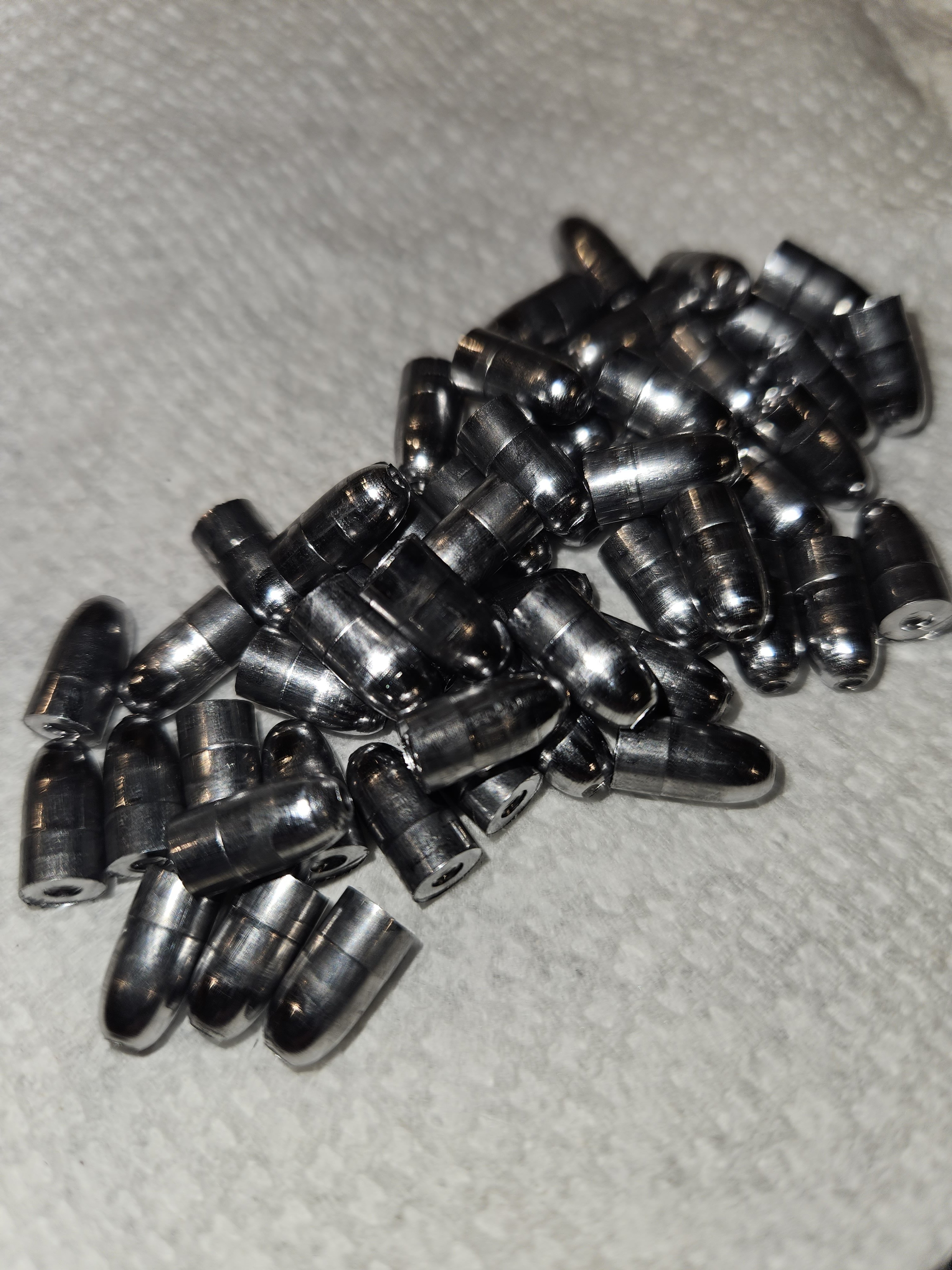

I'm partnering with Kelly doing a little side hustle selling swaged slugs I make. He sold out 2500 in one day. They were .2225 diameter, 39.66 grain, 10.9mm long, pure lead, hand swaged. I plan to make some more as well as some 25s but I've been working too much at my regular job to make much progress. Hopefully that will change soon
I'm partnering with Kelly doing a little side hustle selling swaged slugs I make. He sold out 2500 in one day. They were .2225 diameter, 39.66 grain, 10.9mm long, pure lead, hand swaged. I plan to make some more as well as some 25s but I've been working too much at my regular job to make much progress. Hopefully that will change soonView attachment 394702
If they shoot as good as they look, they are going to be great. Lead beauties.

I was just about to post this in the main 'Huben Pistol' thread, but your new thread seems more appropriate.
Background:
I will second the JST 21.53, @ 850 fps in my GK1 are awesome. I quit trying anything else.
