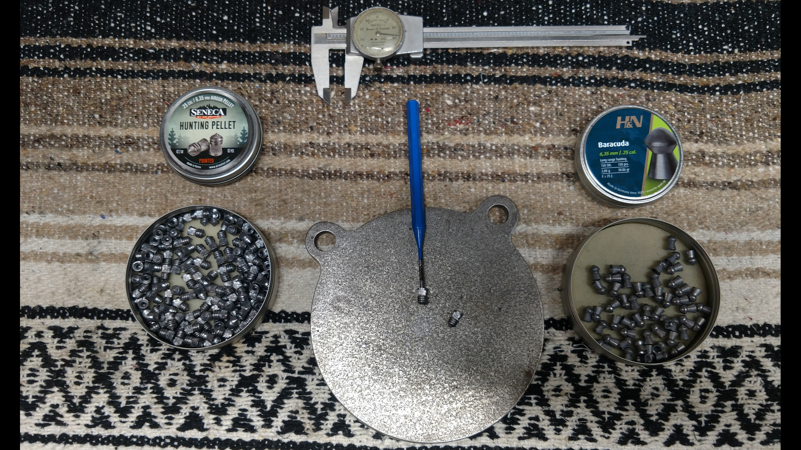

FYI about two different .25 caliber pellet ammo effecting cycling of the GK1 magazine...
The H&N Barracuda 30.86 grain Long Range Hunting Pellet is a little long with it's pounted tip and narrow in the skirt, so it will slide forward in the magazine causing a tip jam. It has been alright as a bench ammo where the gun isn't being jostled around with the barrel being nose first. It usually does it while loading. The jam is easily cleared by bumping the back of the gun against your palm, sometimes while putting a little back pressure on the magazine.
The Seneca 43.2 grain Pointed Hunting Pellet is way too long for the magazine. These are made by EunJin Pointed. With an appropriate small diameter sized punch placed in the skirt and tapped on a piece of steel, the nose is easily smashed and length becomes acceptable to stay in the magazine. Note that too big of a punch will make the pellet diameter oversized. I have not tested long range hunting accuracy after being resized, but it works for closer range target shooting.
I chop the tip of my EunJin 43gr and they fit perfectly, I will do a formal accuracy test by mounting a scope one of these day,...never had a jam.
the other pellet I use is JSB 34gr MKII, I seat them pellets and never had a jam either
I will do the formal accuracy test with the scope on and decide what pellet I will shoot going forward
That method works much faster than trying to retain the weight by smashing the tip. It took about half the time with a razor knife to cut the tips of a tin of pellets versus smashing them tonight. Once these tins are gone I'll be sticking to the JSB MKII's or ZAN slugs.

Do you notice a substantial impact to accuracy? The reason I ask is I’d assume the slicing with a knife would deform the pellet in an uneven manner, but maybe not?
Reactions: Bandito
I'm not using them at extended ranges to know what they are doing. It probably doesn't effect them much below 25 yards.
