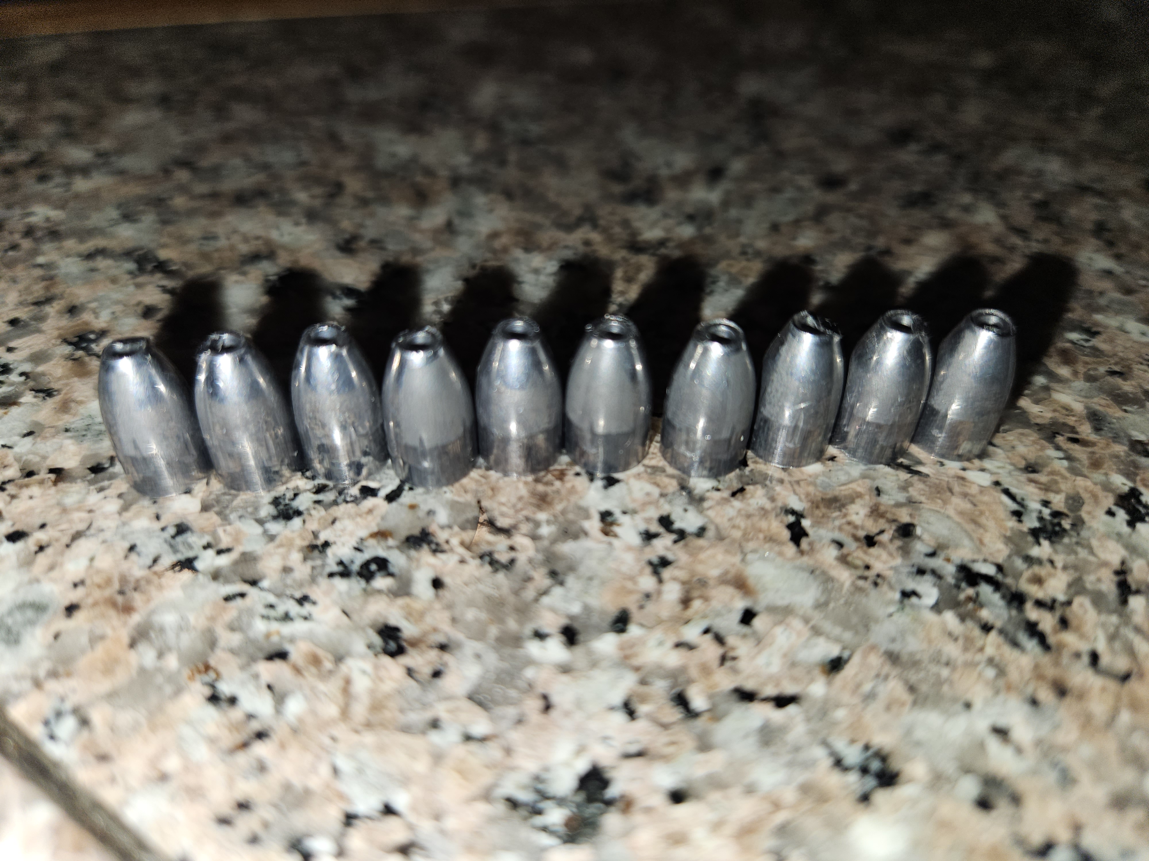

Apolo Slug .25 cal/6.35mm 40 gr Pellets (Tin/200)
Designed for the most powerful rifles capable of accurately firing at 50, 100 or even 200m. Extremely favorable ballistic coefficient ensures a flat trajectory &www.fieldsupply.com
There you go. Trust me these are awesome for the price, the only slug I really use anymore because I bought a lot of them cuz they work so well in both my pistol and my regular K1 Huben.
Im surprised these work . I have the apolo 40 grain slugs and they are very loose in the mag and fall right back out if I tilt the pistol up. The apolo 25 and 33 grain pellets however work well.I use these in my GK1, I can get these for $10 a tin. My pistol loves these, accurate and powerful for a great price.
