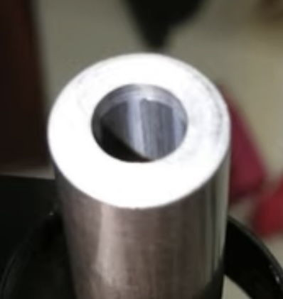

Steve - This is a picture from one of Gregor’s videos showing the barrel from the K1 .25 with the low number of L&Gs, same as mine. He states that it is ~1:28 twist.
I haven’t measured the twist on mine but 1:28 doesn’t comport with its ability to accurately shoot the 51g Altaros slugs.

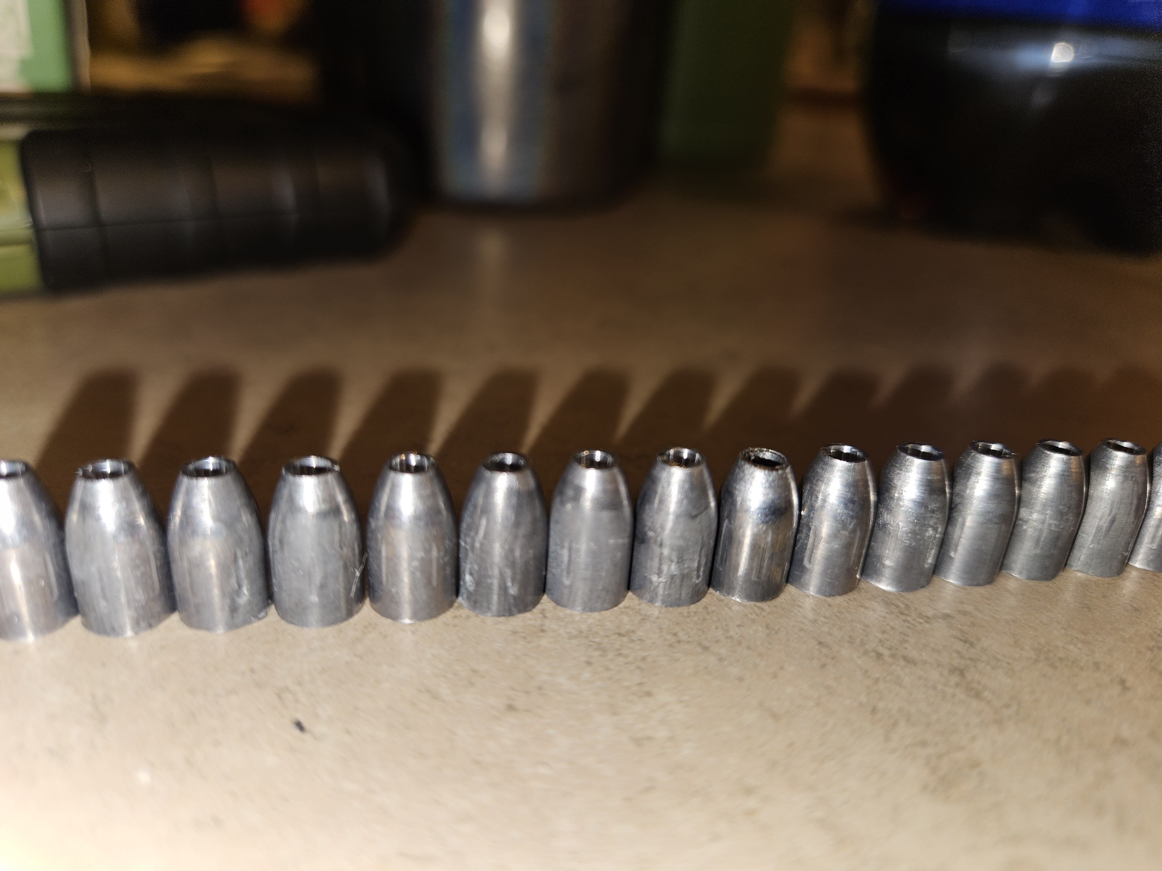

Well, here's the thing. I'm trying to get a better die made by Corbin. My current one presents a few problems.
1. For the .25 gk1, full length slugs work fine. However, for the .25 k1, at least the 2021 iteration that I have, if i make them full length, they require a tool to seat fully in the magazine slots. I can make them shorter and lighter to avoid this, but I'd like a die that can make full length slugs if I want that don't need a tool to load. At full length I can make them a bit over 50 grains, but the tool is needed. To not need the tool to seat, they have to be made about 41 grains, barely heavier than the 22s.
2. The extractor pin which forms the nose on that die I have now is a hollow point former. It makes the slugs harder to remove from the pin, they stick a bit, and I have to use both thumbs and forefingers to remove them rather than just one hand's thumb and finger. I can't just tilt them to remove them, it would deform the nose because of how far the hollow point forming pin sticks into the slug. They have to be lifted off. So when I get in a groove, I can make the 22s like 2X faster than i can make the 25s. the 22s dont have a hollow point so much as a small indent. I may see if i can order a different pin that doesn't make a hollowpoint to correct this at some point, but the seating issue would remain. I suppose if I at least solve the hollow point issue on my old die, I can make heavy slugs that seat in the pistol easily but not the rifle, but I'd prefer to make a slug that works in both. I did clock one of the 50.2 grain slugs today at 805 fps, I previously clocked a 46 grain at 860 fps at the same power setting. The 46 is actually making a bit more power by going that 55 fps faster. I haven't yet tested what weight of my slugs is ideal for energy in the pistol. I need to make a bunch at various weights and test all on the same day. Sometimes it seems that even a bit of temp or pressure difference can change my velocities on a given day, so I should test on the same day to make sure it's apples to apples

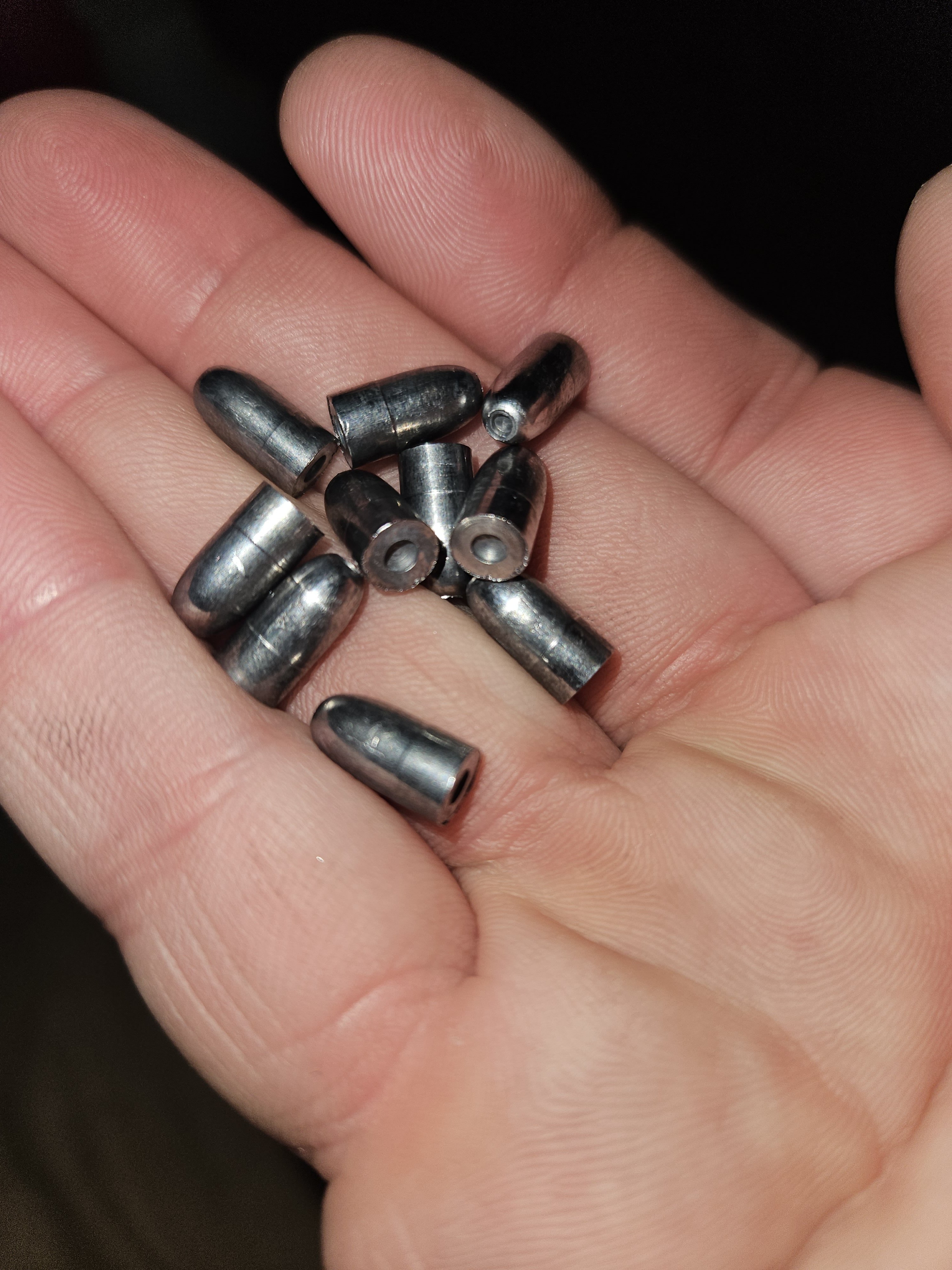

I made some full length 25 slugs and seated them in the rifle using a tool, them unloaded them so that the rifling marks, which is what makes them require a tool to seat, were visible. If the ogive were just a bit more pointy, I wouldn't have this problem. So I sent these 10 sample slugs to Corbin and told them to replicate them but just make them a bit more pointy to avoid the rifling in the magazine slots. I said I didn't want them to be hollow points, and wanted a flat base. They messed it up in just about every way. They are less pointy, encountering even more resistance from the rifling, they are hollow points, and came with a dish base punch. Corbin is sending a new punch and pin to correct the base and hollow point problem that they messed up, but they haven't responded to my email yet about messing up the slug shape, which will require a new die. I am worried they won't admit they messed up and will want me to pay another $650+ for a new die. I explained very carefully what I wanted, and even sent the example slugs so they could take measurements, so I will be pretty upset if they won't fix it and want me to pay AGAIN. In the past, they have been attentive to my requests, but they are under new ownership now too.
All this is a long winded way of saying that I do intend to make more 25s but I'd like to get the die issues sorted so I can make them as fast as I can the 22s. It's hard to compete with a machine and make it both worth my time and competitive price wise with other slugs. What I do have going for me is a diameter and length that is at least somewhat tailored to hubens specifically.
Here is a pic of the slugs that the botched die makes, they've been seated in the rifle then removed. If you look closely you can see the rifling marks that are causing the issue

Great news. Corbin did send the new punch and pin for the .2537 die. Even though it's the same shape slug, them being round nose and flat base made all the difference both in seating ability, and in speed of making. I made some at 10.9mm, the longest slug the rifle can hold. They weigh 47.8 grains. They fit in the pistol too.
I think what happened is the round nose makes them long enough that less of the ogive reaches the rifling, so they can seat. Huge sigh or relief here. Will test them in both pistol and rifle next
