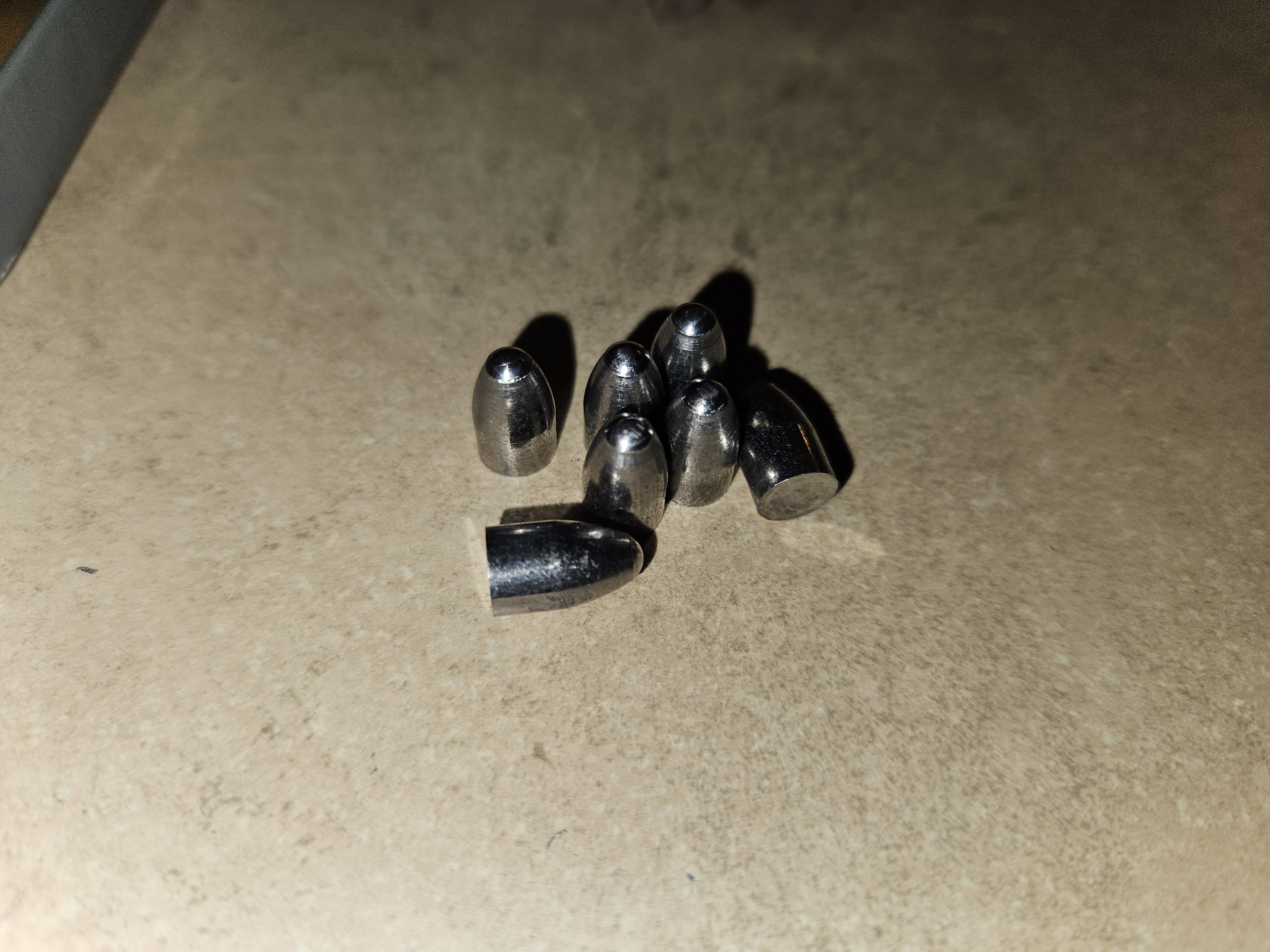

Great news. Corbin did send the new punch and pin for the .2537 die. Even though it's the same shape slug, them being round nose and flat base made all the difference both in seating ability, and in speed of making. I made some at 10.9mm, the longest slug the rifle can hold. They weigh 48.28 grains although I may get a more precise number later when I have more to weigh at once. They fit in the pistol too.
I think what happened is the round nose makes them long enough that less of the ogive reaches the rifling, so they can seat. Huge sigh or relief here. Will test them in both pistol and rifle next

Yes I suppose a vice would be better. I don't currently have a suitable one. I have however made some of the .2537s in 11mm, weighing 48.6 grains to test in the pistol, and some 10.9mm .254s and .2537s, weighing 49.3 and 47.8 grains respectively, to test in the rifle. I do have a full rest for the rifle, and a nice scope, so the groups from that should be more informative. What are the odds that better accuracy in the rifle of one slug or the other will translate to the pistol?
With the limited data I have now, it seems the 254s remain king. I did just make an observation though.
In the past, 10.9mm length slugs that my .254 die makes are difficult to seat without a tool, but I'm trying to remember how shiny they were. Seems maybe the ones I struggled with were duller. The recent lead spools I've gotten from NSA have an issue where the outer layers of lead are more weathered than the inner. I can improve it somewhat by cleaning with swage lube, and I've been making an effort to rub the dirty lead harder. This works to a degree, but it remains the Case that the cleaner lead makes better looking, slightly smoother slugs. I just made some at max length and only had a little resistance seating them, I could still use my finger. They were shiny. So with them, maybe seating won't be a big issue if I can get cleaner lead. I plan to mention it to the guys at NSA next time I order lead, ask if I can get it fresh. i store it wrapped in its bag with a silica gel packet and in its box and padding. It worked well to keep some lead I had gotten from crown metals in good condition. Unfortunately the two 25 lb spools I've gotten from NSA both had inferior lead to what I got in the past from crown metals, but NSA is fast and responsive to my orders, crown metals not so much. Anyway it doesn't seem to make a huge difference for the 22s so I maybe I'll use the more dirty lead to make those, maybe even only for myself. Id rather get quality lead though. I plan to order 50lb spools in the hopes that more of the lead will be in the depths of the spool rather than its outer layer. Hopefully I don't get any more sub par lead. If the 254s remain the most accurate, and if I can get better lead or at least only use the better parts of the spool to make them, and if I get another pin to make them solid nose, I'll be in pretty good shape although the .2537 might still have been a complete waste of time. We shall see. Live and learn.
