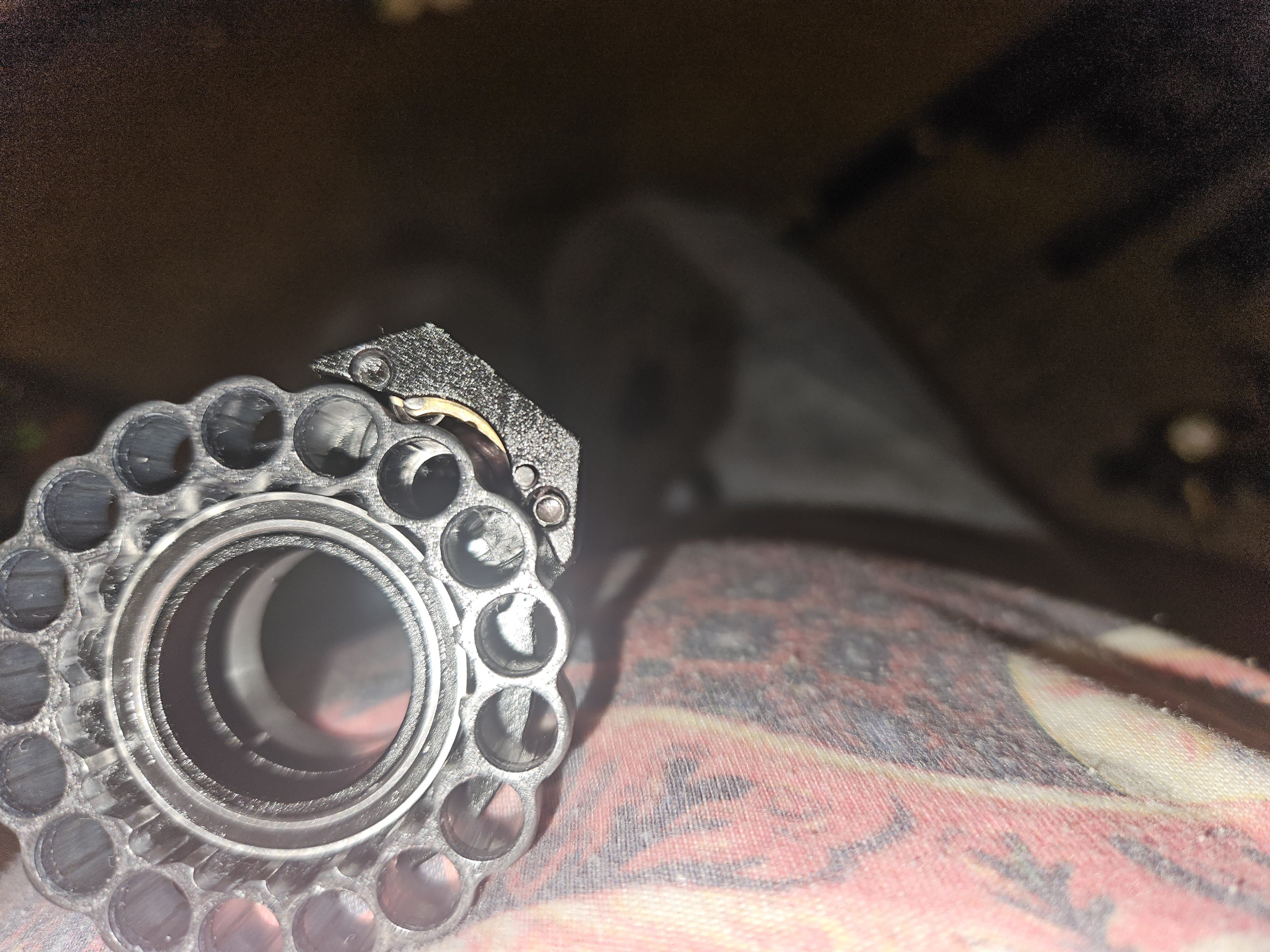

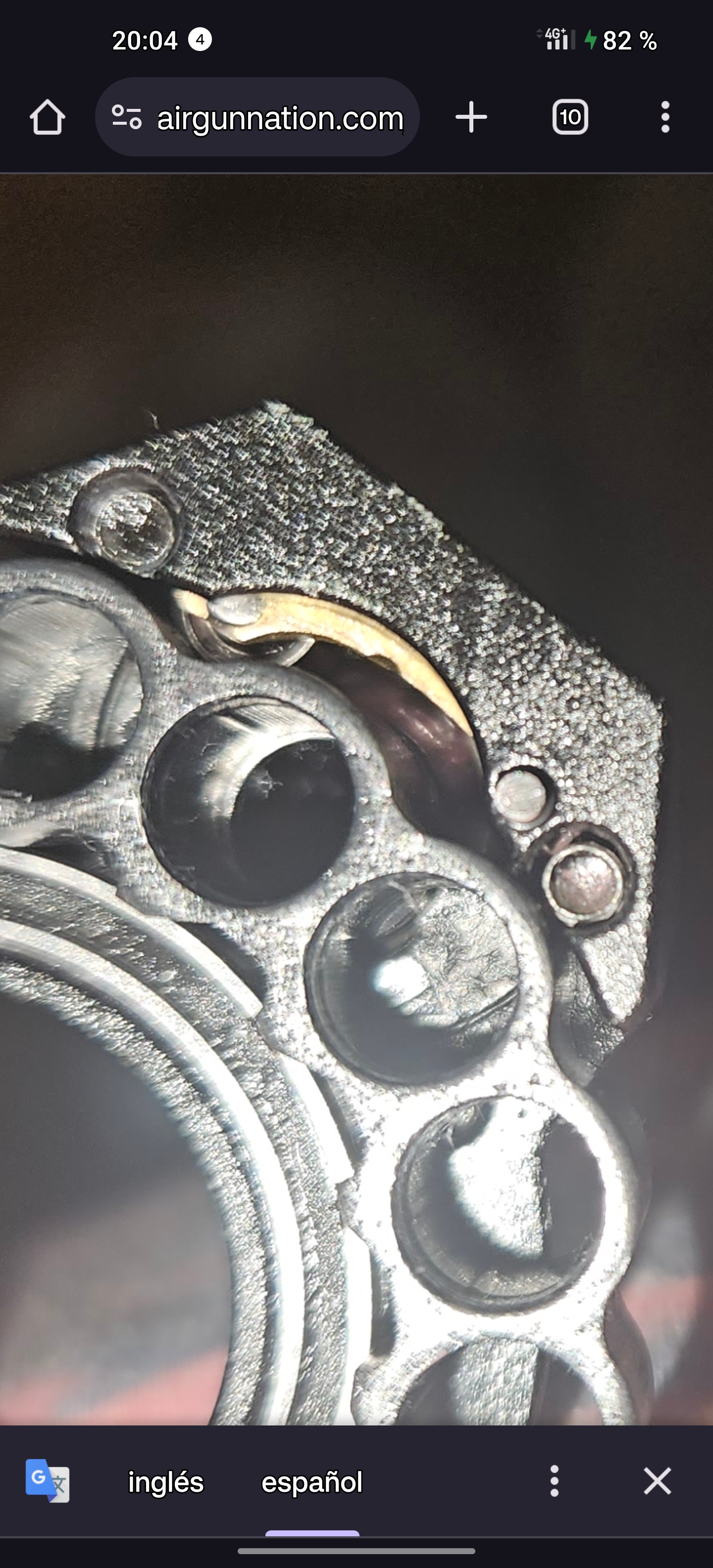

Quick update. I took apart my 25 k1 to polish the barrel and when I did I found out I have an alignment issue with the barrel and mag. In the process of trying to fix it now. Have never adjusted the alignment before. when I get it all back together i imagine it will be shooting much better groups.
Ok got it all back together and will test again soon. Put a slug in the magazine and pushed it almost all the way forward, then put it on the barrel with the slug in the barrel to align. Tightened everything down, removed the magazine and slug, then put magazine back on. Worked perfectly
Actualización rápida. Desarmé mi 25 k1 para pulir el cañón y cuando lo hice descubrí que tengo un problema de alineación con el cañón y el cargador. En el proceso de intentar solucionarlo ahora. Nunca antes había ajustado la alineación. Cuando lo reúna todo me imagino que se filmarán grupos mucho mejores.
Ok, lo reuní todo y lo probaré nuevamente pronto. Coloque una bala en el cargador y empújela casi completamente hacia adelante, luego colóquela en el cañón con la bala en el cañón para alinearla. Apreté todo, quité el cargador y la bala, luego volví a colocar el cargador. Funcionó perfectamenteView attachment 412841
Se aprecia una junta tórica rota en la imagen.

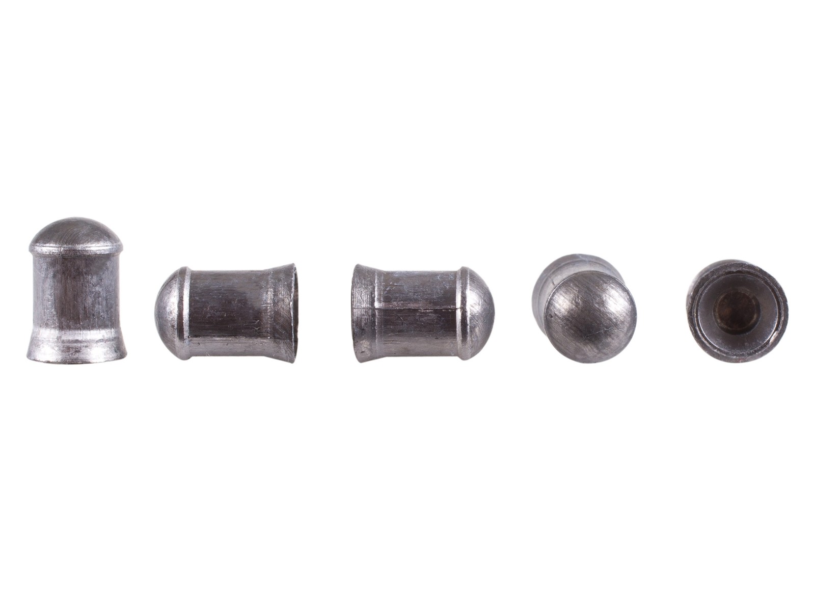

Anyone with a v3 notice the mag seems to be smaller and is closer to .253 instead of .254?
You need to measure correctly. I used a set of precision pin gauges. The number s were .250" Go and .251" No GO. Please also note that the rear of the magazine bores are beveled to accommodate The oversize lip of the pellet. The front and back of the magazine is NOT the same. I also measured the barrel and the lands were .247 Go and .248 no GO. Now, measure your pellet. The pellet I use has a head diameter of.248" and the skirt is .260".This gives perfect guidance in the barrel and .006" rifling bite for good grip and sealing.

First, you just want a light touching at the pellet head and a healthy rifling bite at the skirt. This is exactly what my measurement say I have. The danger comes when shooting slugs because in an air weapon you don't have 30,000 to 50,000 CUP that you have with a PB weapon to overcome excessive bore resistance. With my GK1 anything over .253 is excessive.
Keep in mind that some slugs, usually cast ones are likely to have antimony added, making them harder and the diameter a bigger problem if too big. Swaged slugs are more likely to be pure lead and softer.
