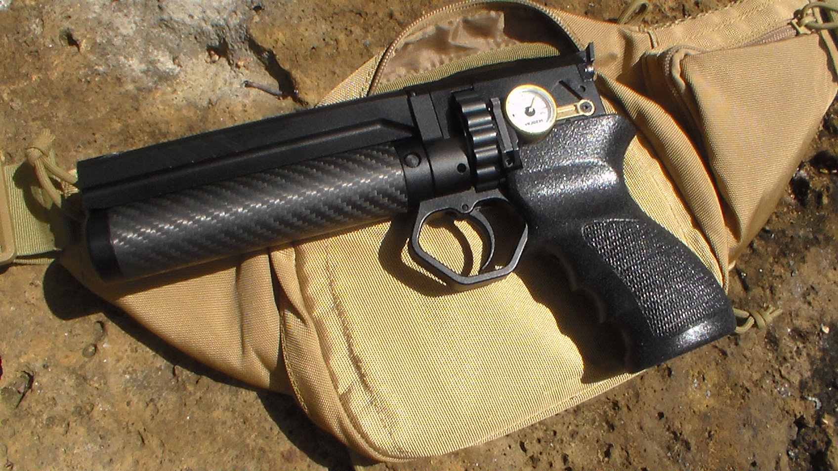

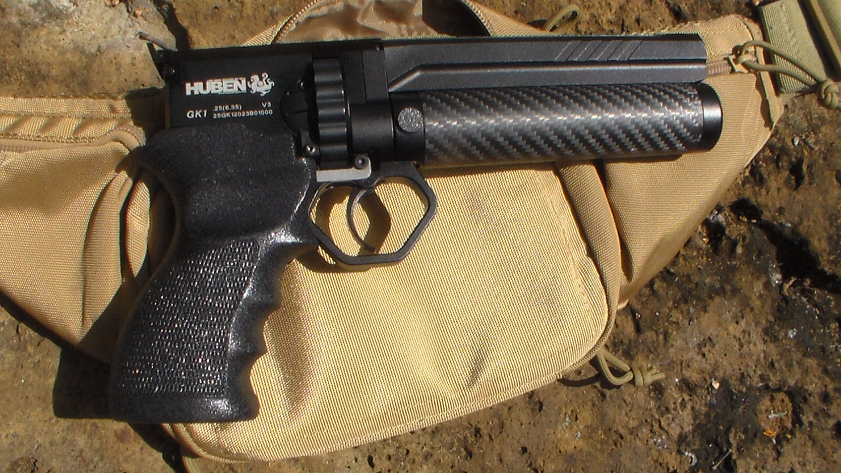

Sprayed the grip of my Shorty with Rustoleum Truckbed coating,....much better grip

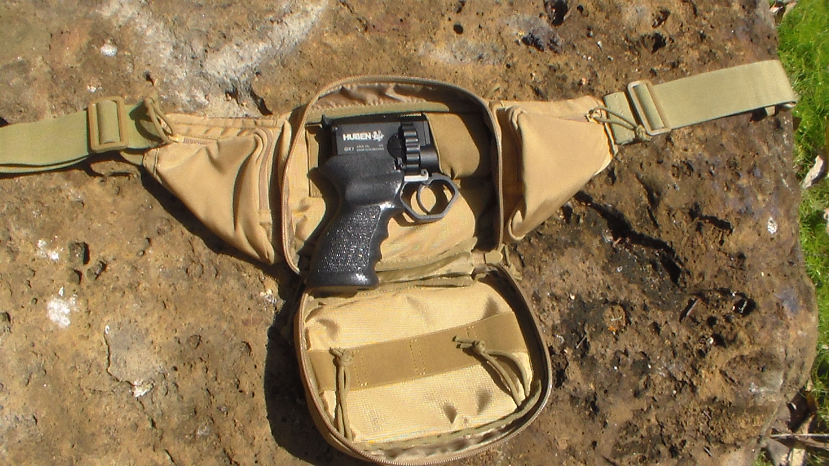

And this is how well the shorty fits in my fanny pack

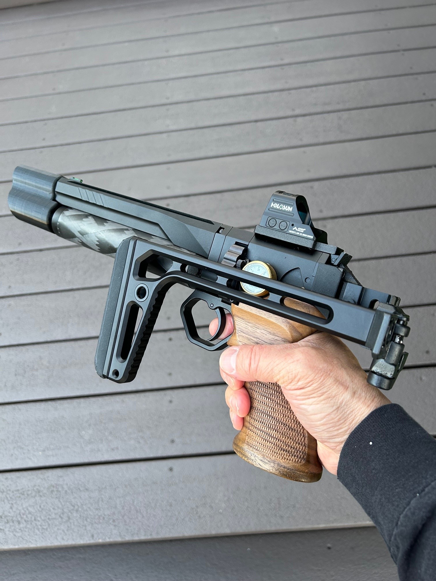

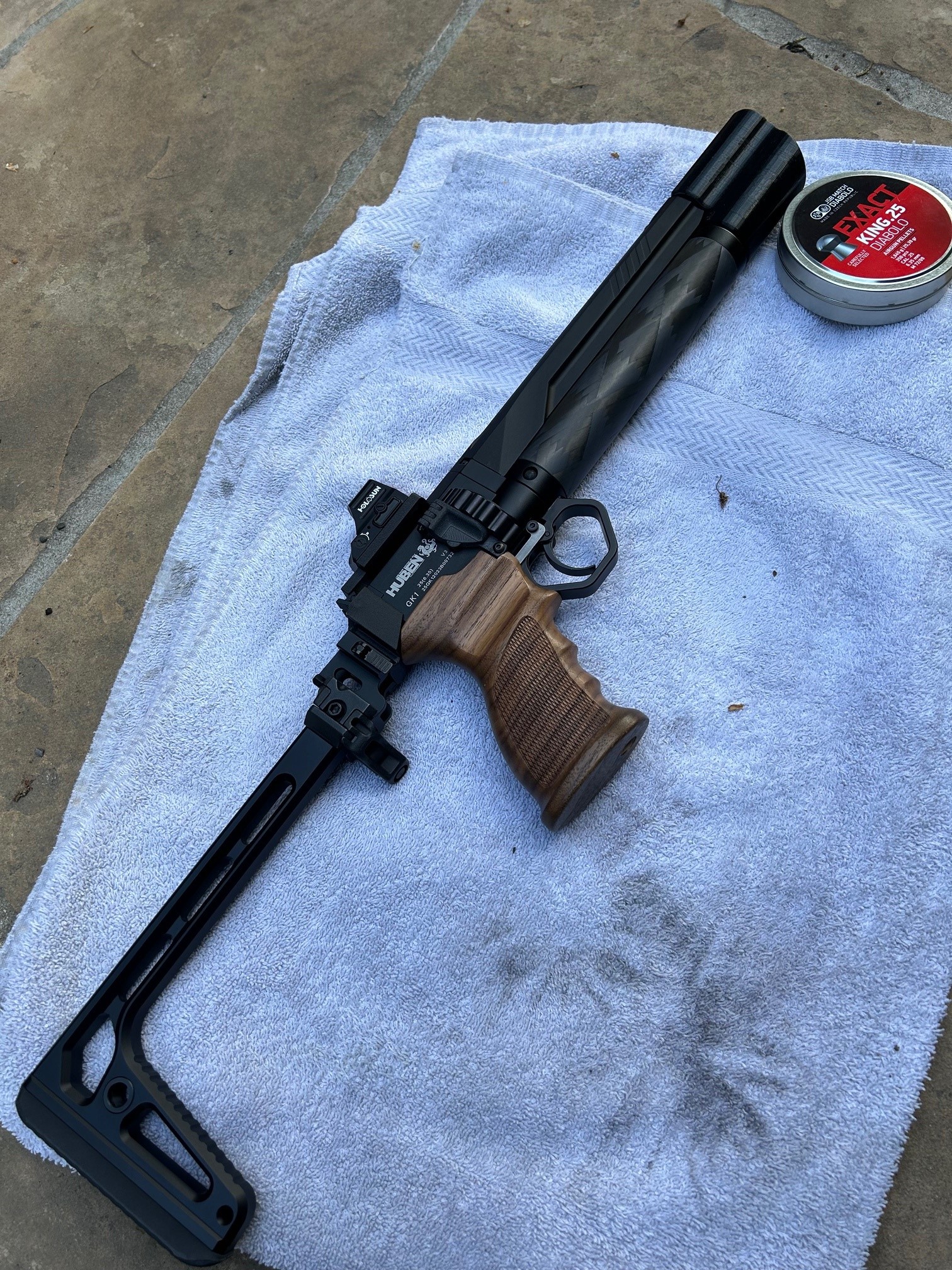

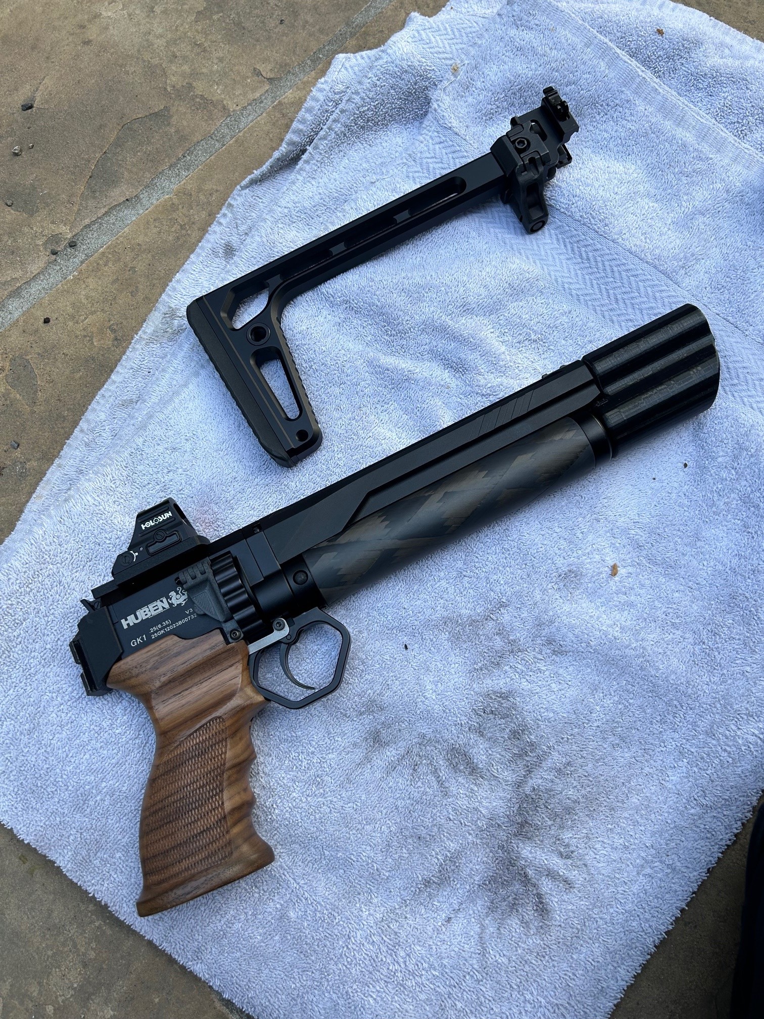

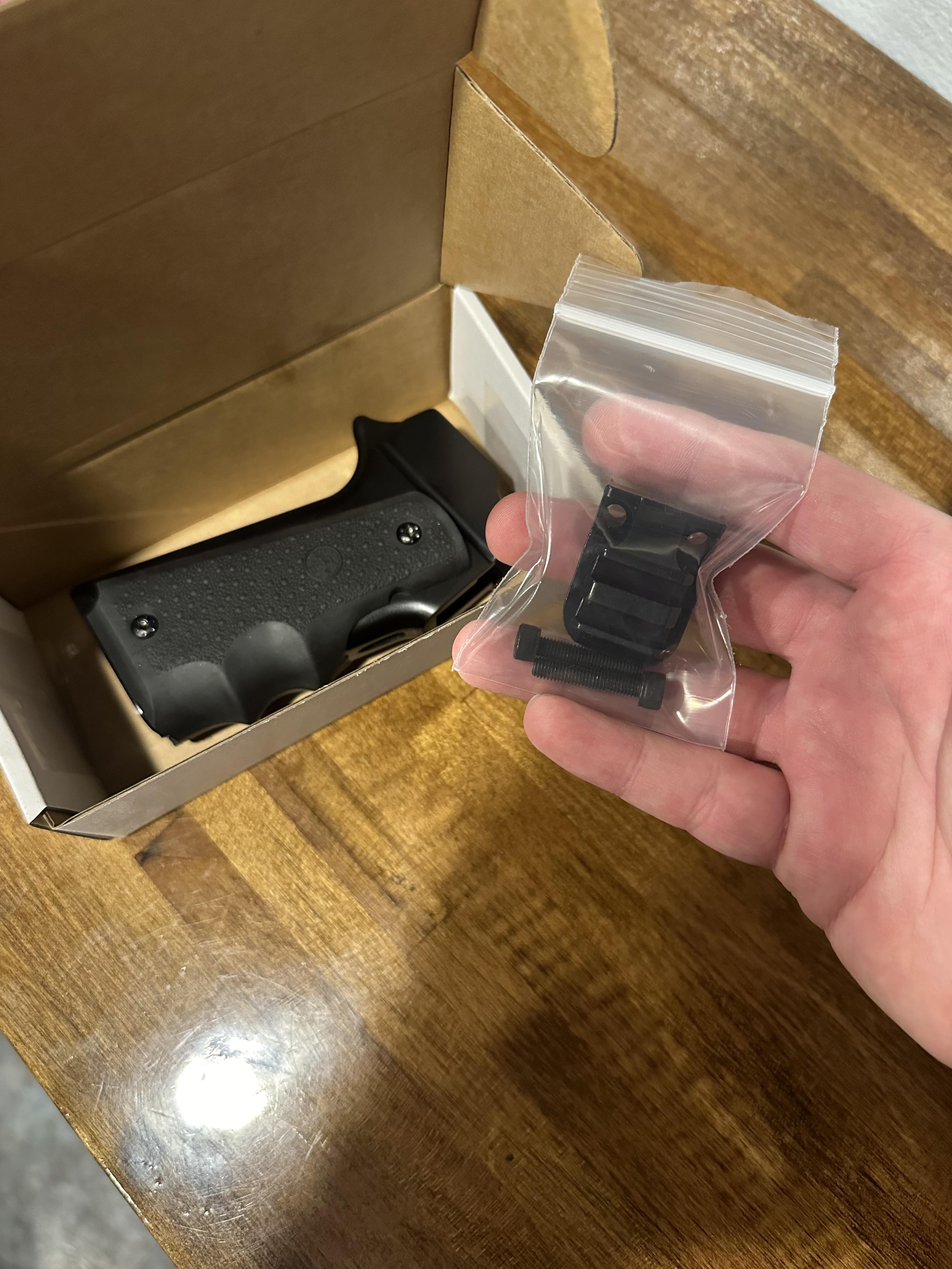

Yes I just had time to mount my Huben3dparts.com rear picatinny mount and try out the carbine stock Andrew sold me. It only takes about 5 seconds to put in on and 2-3 seconds to remove it..
