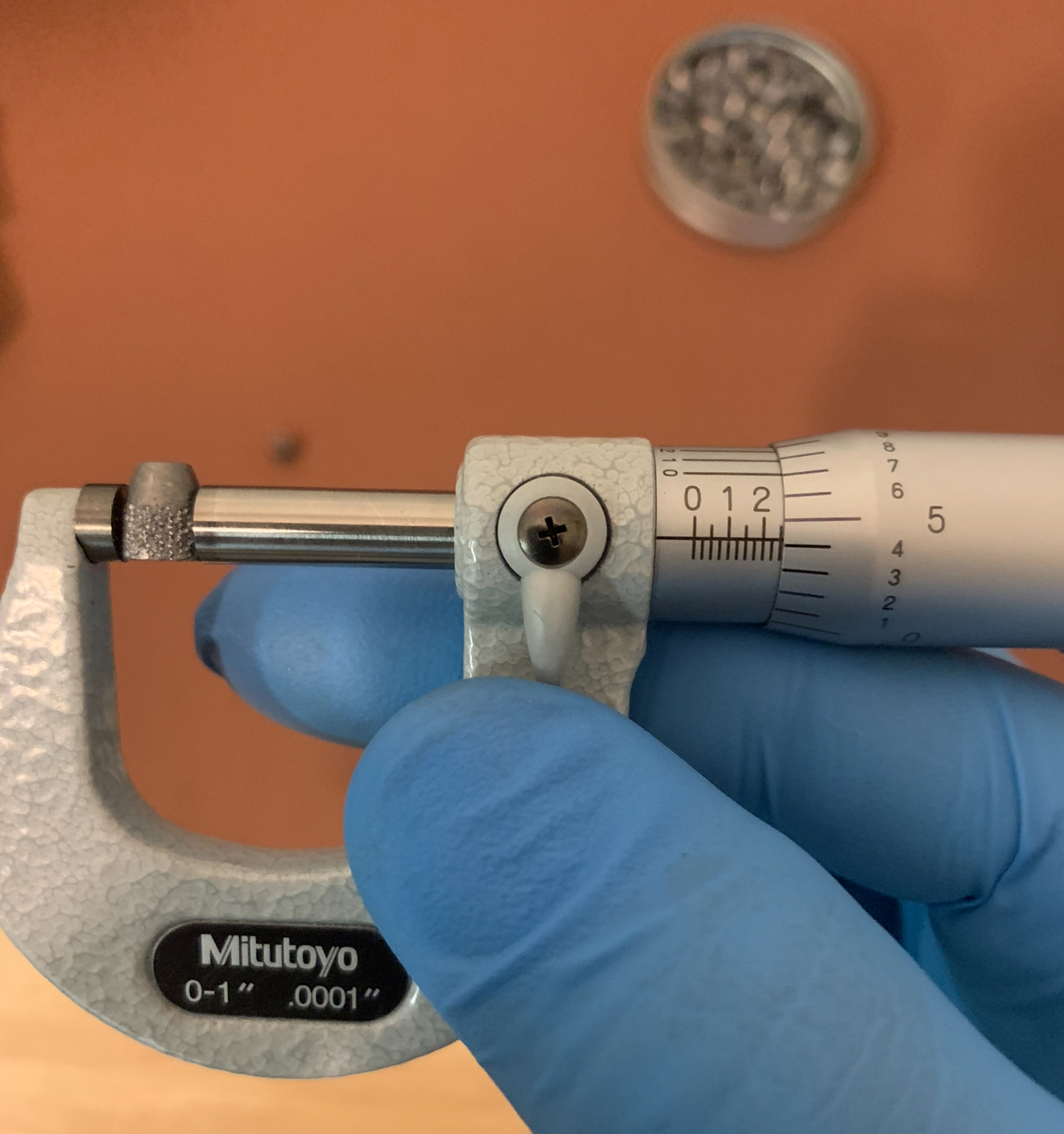

Did you guys tried the Altaros ATP slugs? I'm sure I read about some people using it. But it's very tight to load it in the GK1. I'm afraid it would damage it.
Reactions: rootdude
@Ach3r0n Try .254 or .253 slugs. Those diameters seem to load better in my mag. Although .254 and .255 are a bit snug, with a seating tool they can be situated within the mag appropriately. .255 will take some force, but I saw no damage to the gun from shooting them, no jams. You may have to size down your slugs. Have you measured the actual diameter of those Altaros slugs?
Reactions: Ach3r0n
"Have you measured the actual diameter of those Altaros slugs?"
No. I don't even know how should I do it, I mean I don't have the tool for that. But thanks for the info & advice.
Reactions: Bandito
The tools needed are calipers or a micrometer. A micrometer would be better in my opinion. It looks like this when you measure a projectile.
Thanks.

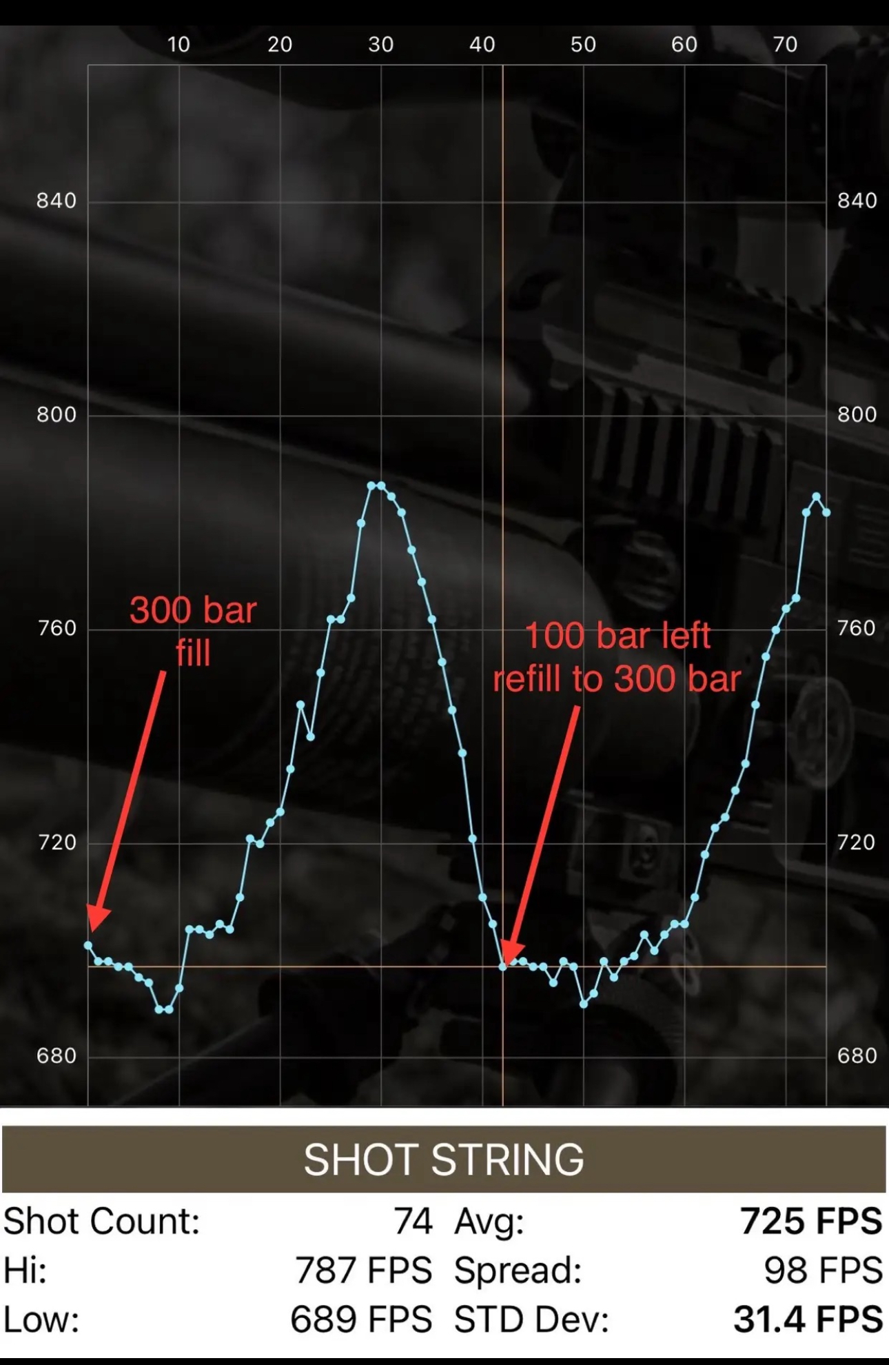

@PCPFanNL Not a clue. Is anyone else shooting their GK1 in .22 down to 100 bar? That seems like it's pushing things. How do those pellets fit into your magazine? They aren't heavy pellets. Does your GK1 do the same thing with heavier pellets? How about if you adjust the power screw? How long have you noticed your GK1 acting this way?
Reactions: PCPFanNL
I think Gregory mentioned not going below 100 bar, so that’s what I’m guided by :)
The JTS 20.73 fit snug, I seat them, and they ‘click’ into place.
I’ll have a try tomorrow with other (heavier) pellets to check. Would be weird if the pellets are causing this right?
This is the first time I notice this FPS changing. I haven’t shot the GK1 for a while, but that shouldn’t be the issues either I guess..
Very curious about this :D
