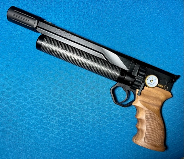

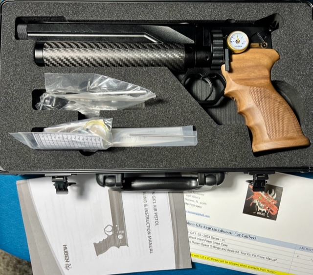

I received my GK-1 in .25 today! I have filled it to 350 BAR and am letting it sit over night to leak check it. It came with the 1/2UNF Adapter installed. I has a spare thread protector and put it on it for storage in the case.
Here are some pictures:
This is what came in the case, which was well protected in the box from Kelly at KrazCool Airguns.

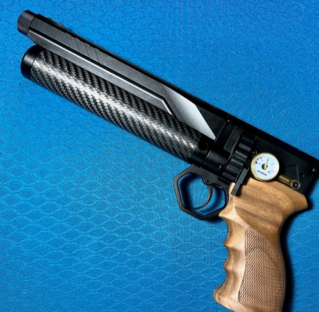

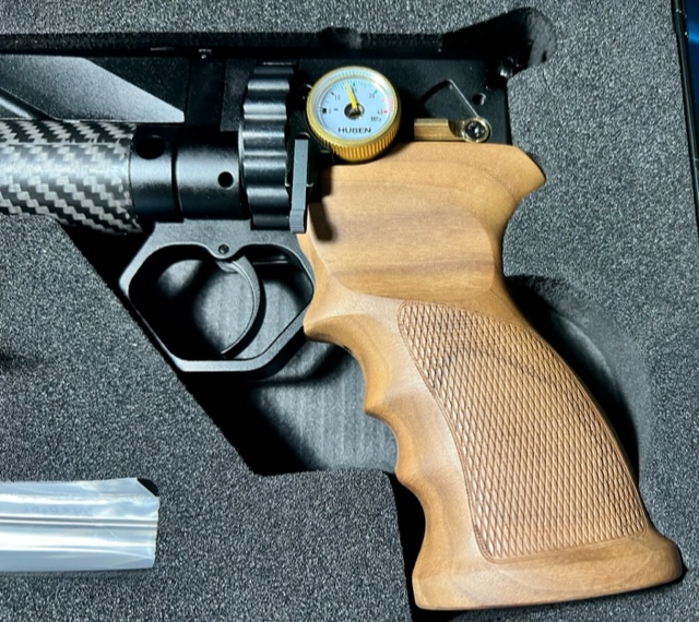

The grip is a very nidely grain hardwood. I believe it's walnut.
Here it is without the moderator...
With one section of a Huma-Air Mod 30 LDC.

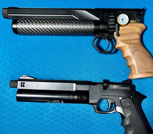

Here it is compared to my Ataman AP-16. This is the short barrel version. They are pretty close to the same size.

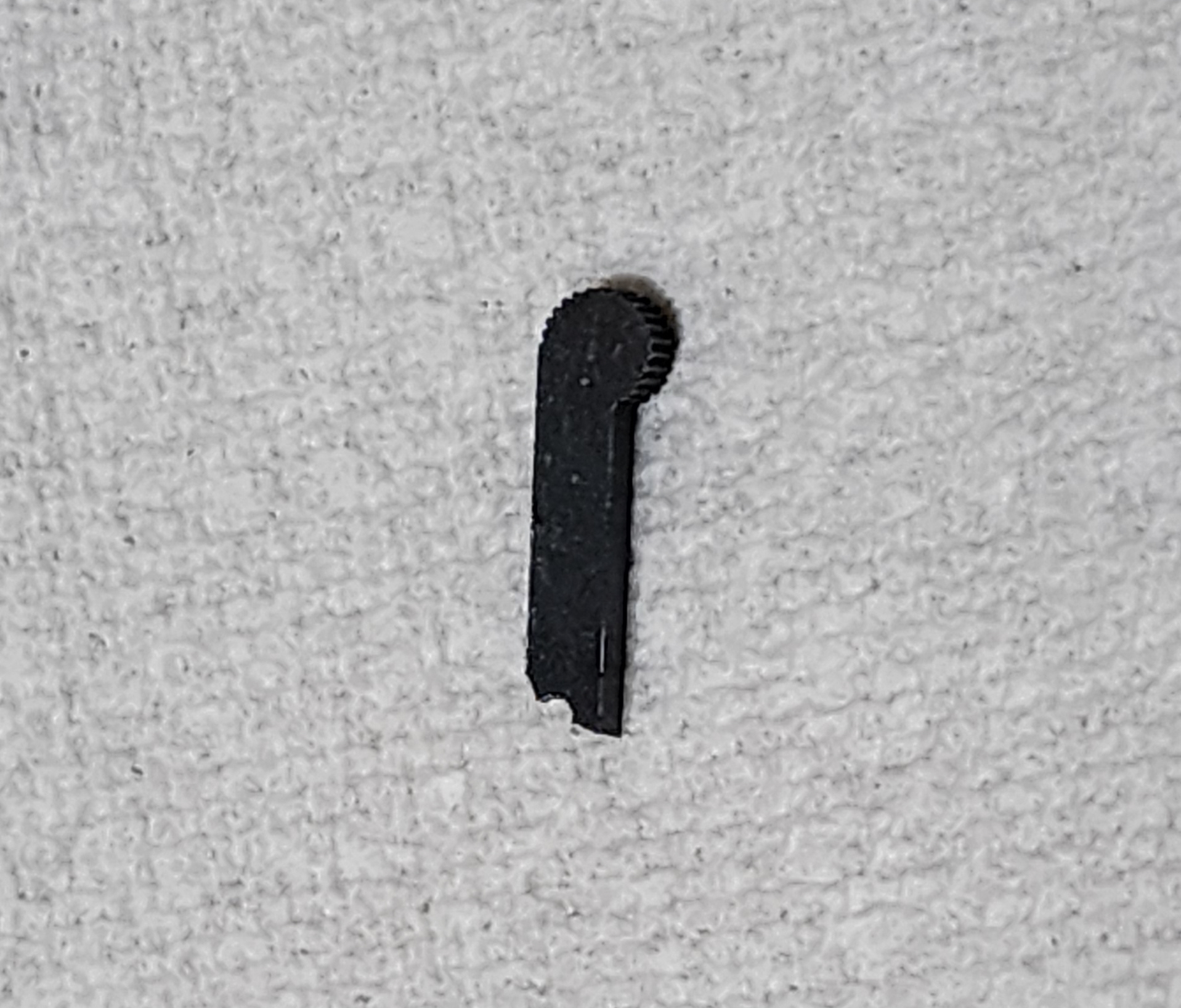

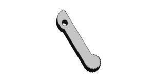

It Broke!
Looks like my fun is curtailed for awhile. The lever that releases the cylinder so that it can be loaded broke off. It broke after the gun was loaded and I was returning it to the firing position. Anyone know where to get this part quickly? It is part 49 on exploded view of K1. Got about 200 rounds through it before it broke. It never jammed.

Jim was that the OEM lever ? I bet you could order one of the improved loading gates and have it at your door in a couple days

Ares has the lever & housing together. I ordered one from them and got it in two days. It is the same one as the rifle. A weak point IMO. I also ordered 3 of the levers from NE & got them in 4 days. I am sure Kelly has them too. If you let that lever, get away from you during closing, it will break. I did the same thing. The lever is harder to open and close the more fill pressure it has. & during closing once, it cams over it wants to slip from my fat fingers.
Kelly has a bunch, I've had to replace the one on my rifle and pistol.

In the four years I’ve owned a huben that lever has never broke. Although, I have heard of this happening to others. Seems like a lack of metal quality or design flaw. It would be nice if they made it out of Titanium like the air tank.
When I got my .25 I was talking to Kelly and he recommended to me to lower that lever slowly and carefully as a few had already been broken by letting them snap down.

Not sure if this has already been posted, but just an FYI on that magazine lever replacement. Kelly (KrazCool) has a YouTube video on how to replace. The lever on my K1 broke, and he pointed me to that video.
I'm not sure if I can link to YouTube, but just search for "Huben K1 Mag Lever Assembly Replace" and you'll find his video.

Yep, but on these GK1 pistols you will need to degas. Wimpanzee informed me of that step, or I might have broken the new assembly on install.
