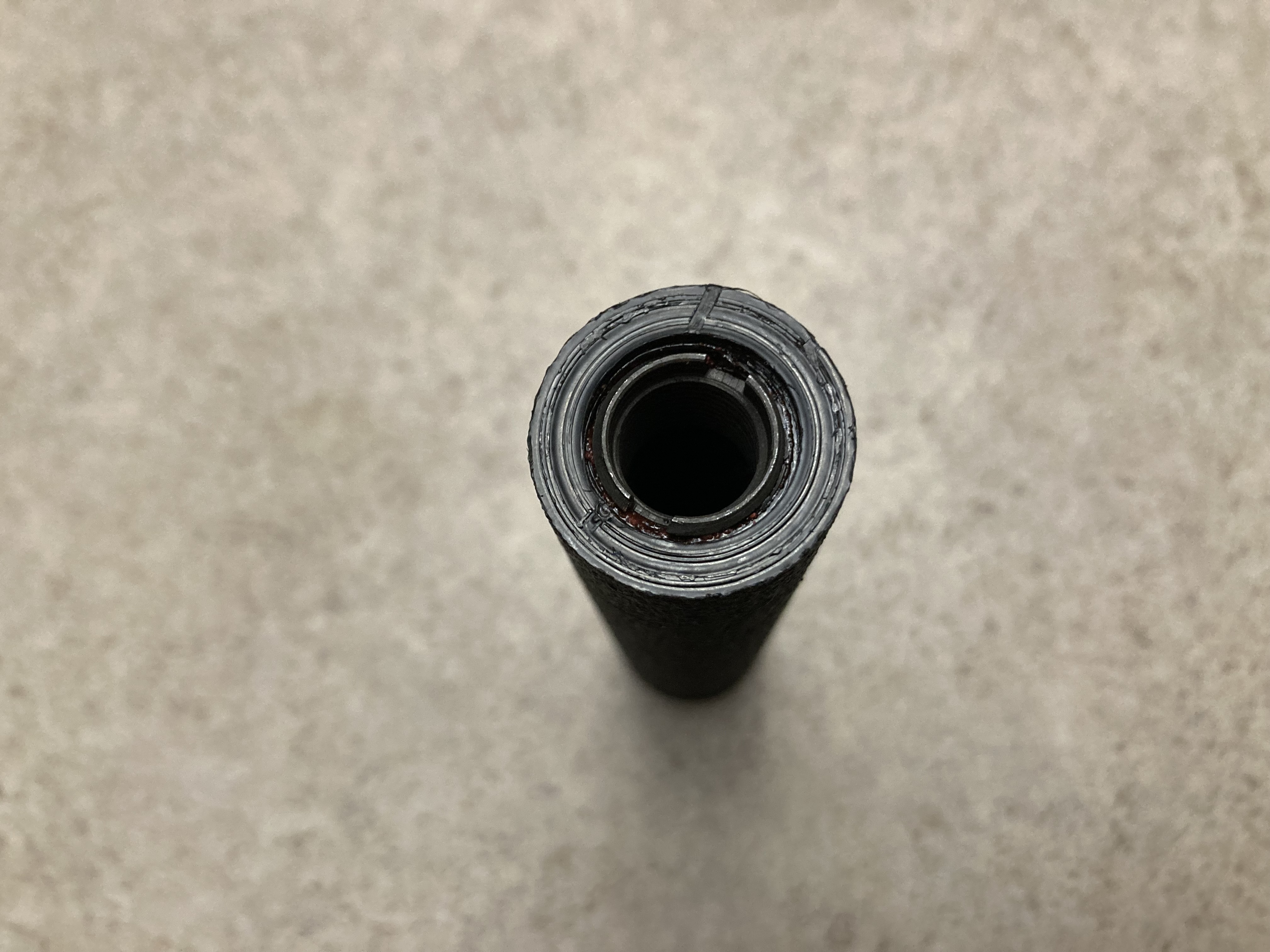

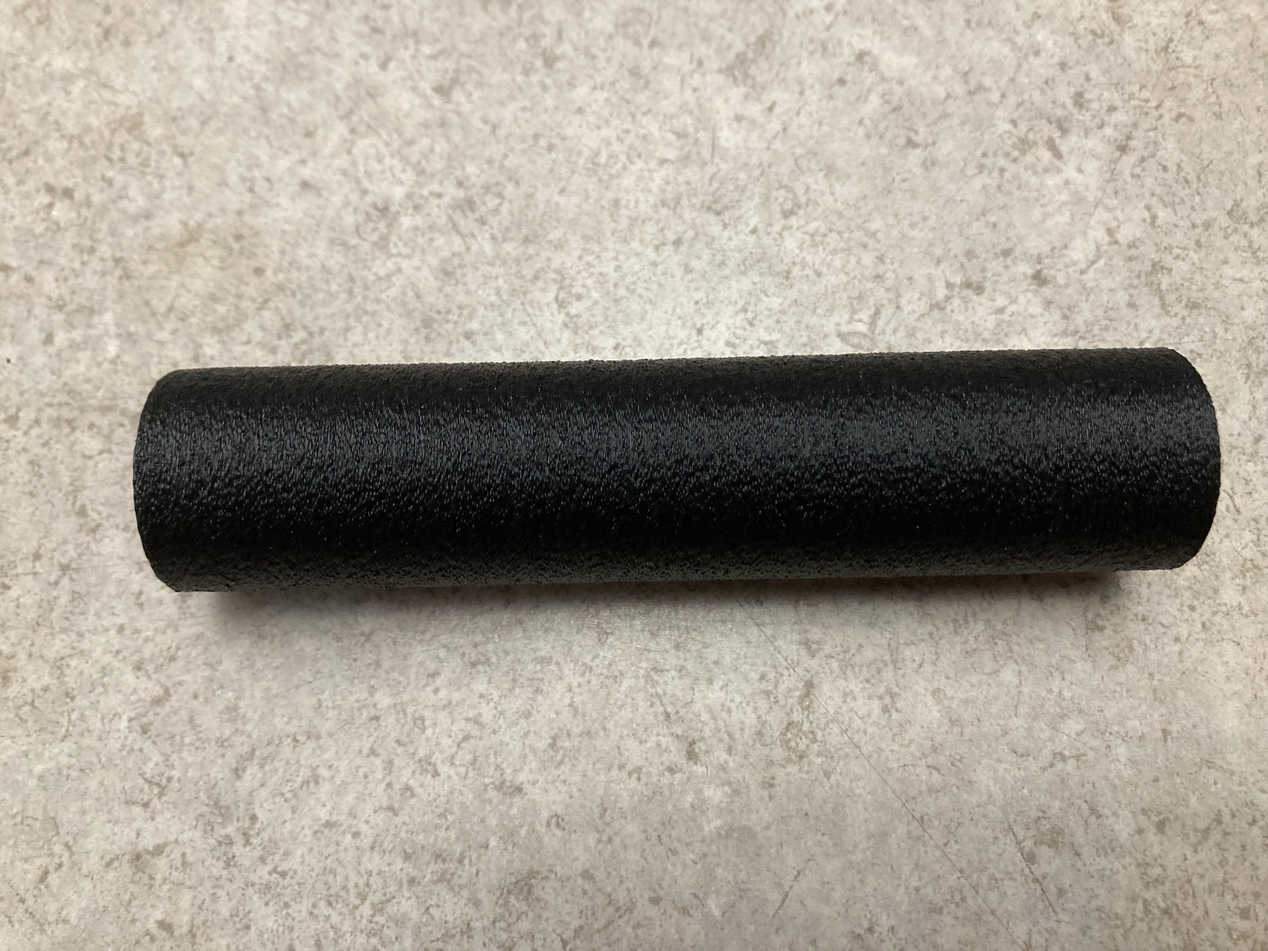

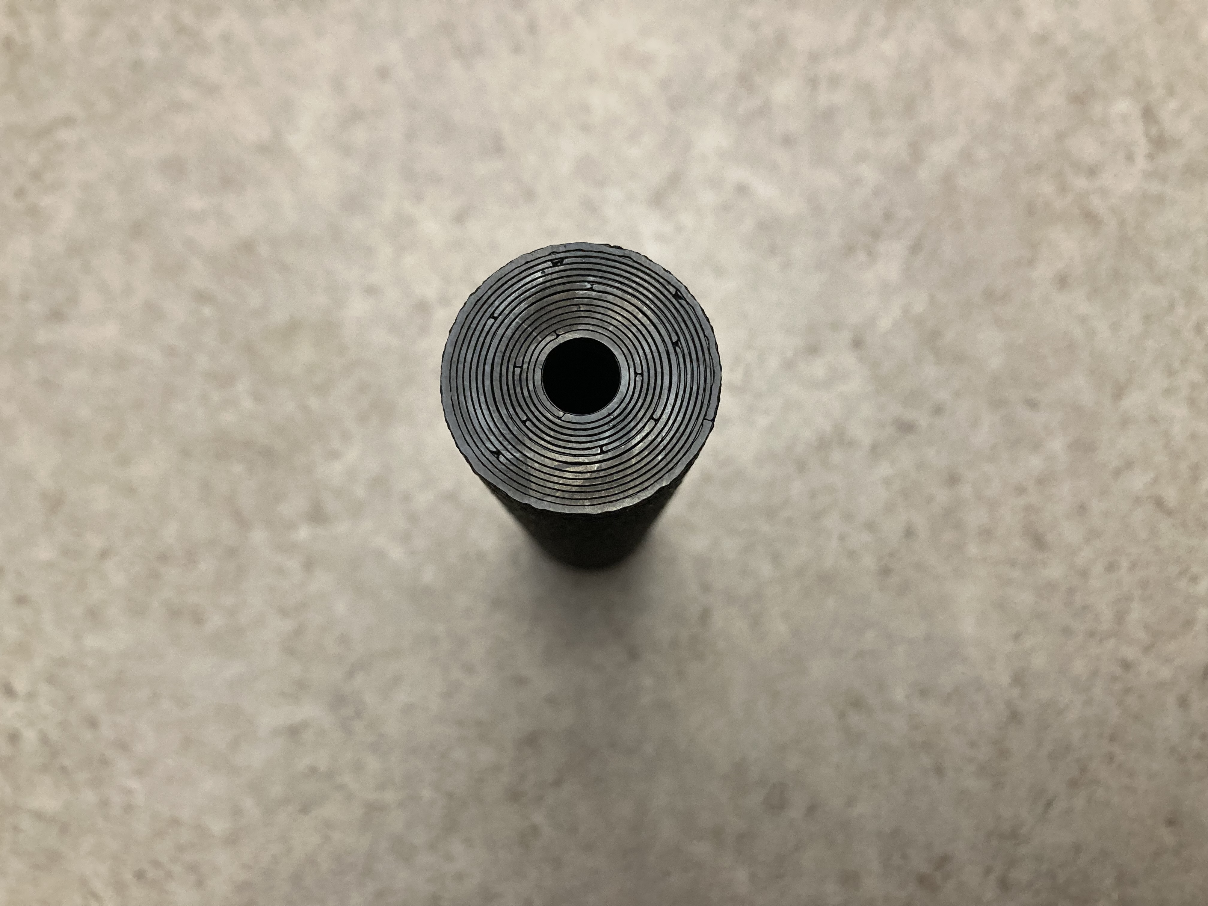

Here’s a 4.25” X 1.024” design I threw together real quick, it only results in like a 2dB-4dB reduction, so I wasn’t sure if it was worth pursuing any further, I like a bit more sound reduction capability personally. It only weighs 34 grams so the 3” would probably be like 22-25 grams.
*Edit: Just tested it and it’s a 1.82dB reduction, however some of the infill/sound baffling material is breaking up inside, so if you are interested in this, I’ll need to explore ways to strengthen the inner structure, otherwise this might just be at the limit as far as how small these can be made before ASA is not durable enough for the job.
*Edit #2: It's actually a 4.17dB reduction. I was using an unmoderated number of the pistol when the Ares Adapter is installed without the cap, which actually results in a 1.8dB reduction on its own, I'm guessing because it directs the noise more forwards instead of out to the sides.

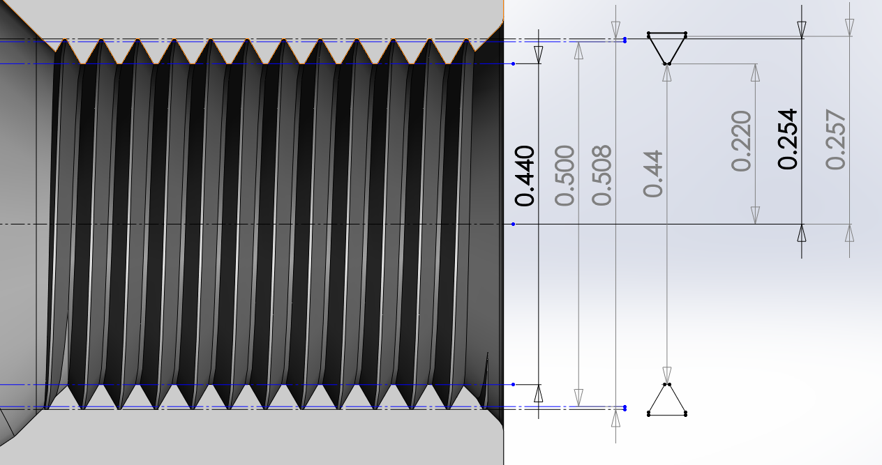

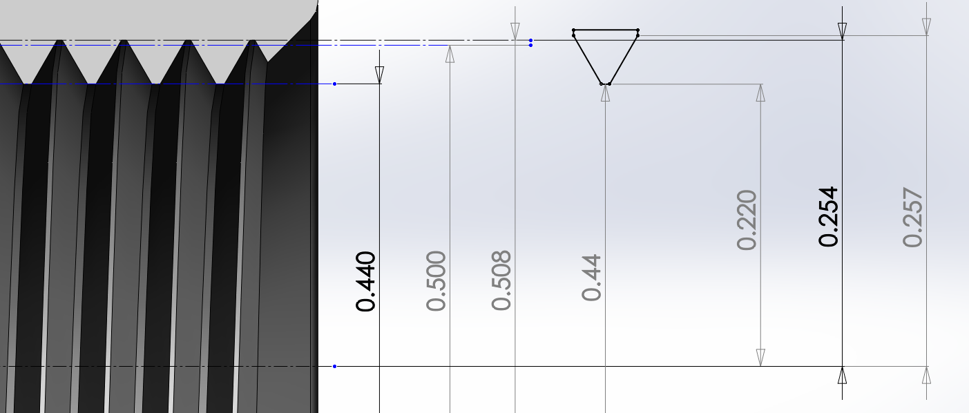

TeslaToTheMoon's advice is rather important; that you print only the threaded section, until you have confidence in thread.
I forgot to mention that the threads in my models are intended to be on the tight side, as the primary customer's print guy prefers to chase threads with a tap. That is a very good idea if you want maximum strength and minimum slop.
Some guys like the thread form "shaved" drastically for FDM printing, but my thoughts are that the Huben pistol is a high stress application, and needs all the strength it can have to keep the muffler from flying off.
The images below show the CAD model and dimensions of the thread form I used. It is perhaps 0.0025" tighter in diameter than if I wanted to be sure it would screw on easily after printing. That is half a percent tight on a nominal 0.5".
You can absolutely adjust the X and Y axis on your print slicer to 100.5%, to open up the thread diameter by 0.0025". If that is still too tight, try 101%. Do not adjust the Z axis, unless you know your vertical part lengths are off from nominal significantly; else you will be inducing a thread pitch error. Pitch errors present as parts screwing on easily for one or two revolutions, then going tight before you have the threads all the way in.

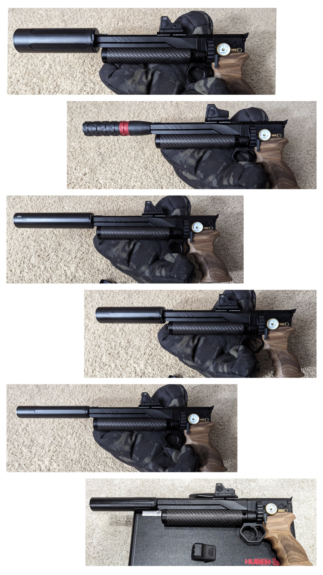

Tested 6 mods tonight--didn't get to the tatsu, FX by donnys, and some 3d printed ones I have.
Keep in mind, I'm on a lower power tune--
But with my ears, ronin was definitely the quietest but way too heavy. Very surprised by the impulse ia-1350. 2nd best in my test--but with 5 baffles. Noticably louder with only 4. This was an ear test tie with the Shogun. But again, weight of the Shogun, impulse wins. Then sumo, koi, and Huma. To be fair, only had 3 baffles in the Huma and it's avalanche inserts, not fabric wrapped. Was a little disappointed with the koi, its normally one of the quieter ones, but it just sounds loud...was not a fan of how it sounded on the gk1.
And yes, I have a cheap db meter I will snag results with all this weekend but I wanted to pew and test some fart cans before it got too dark.
The lineup:

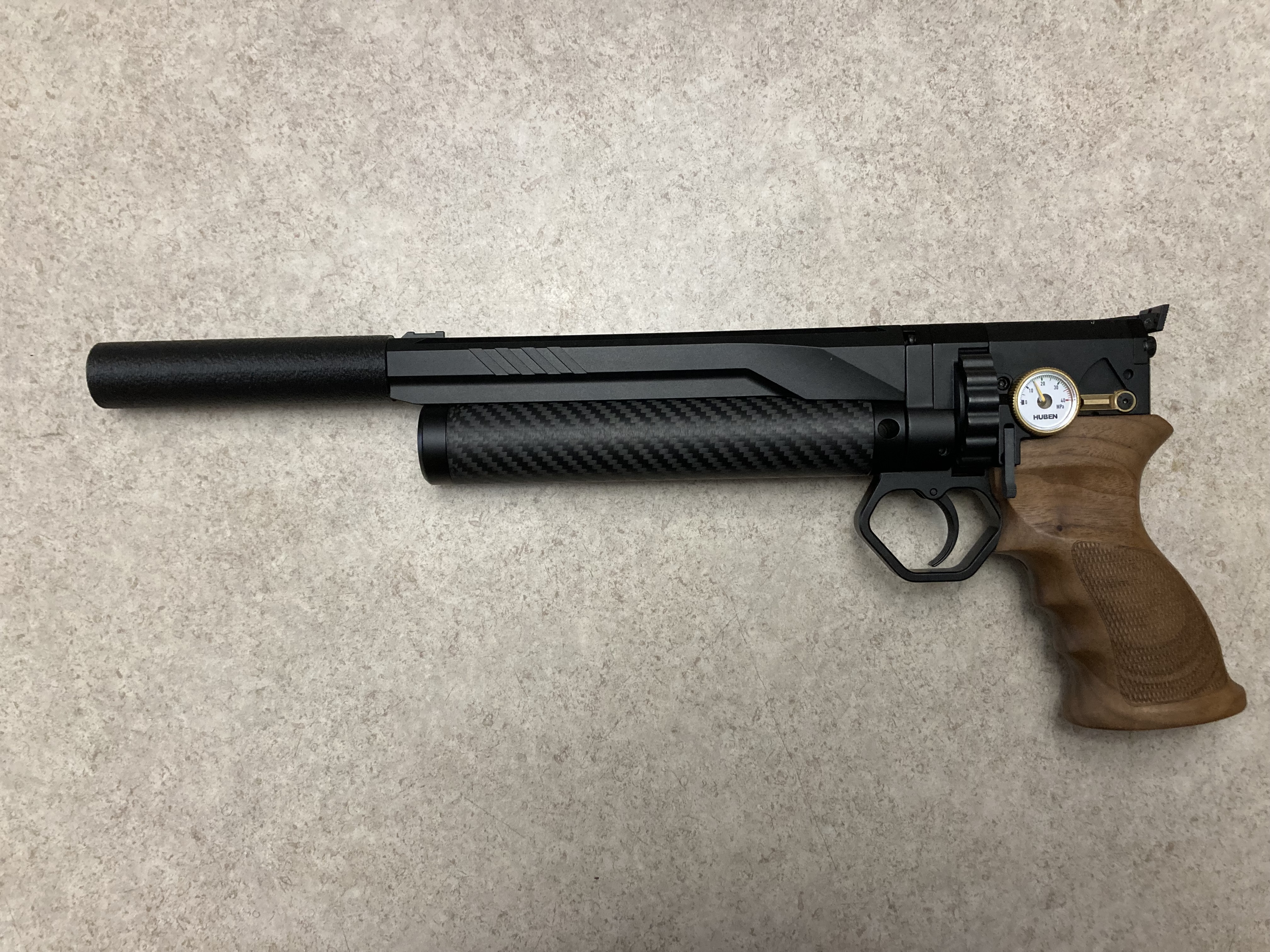

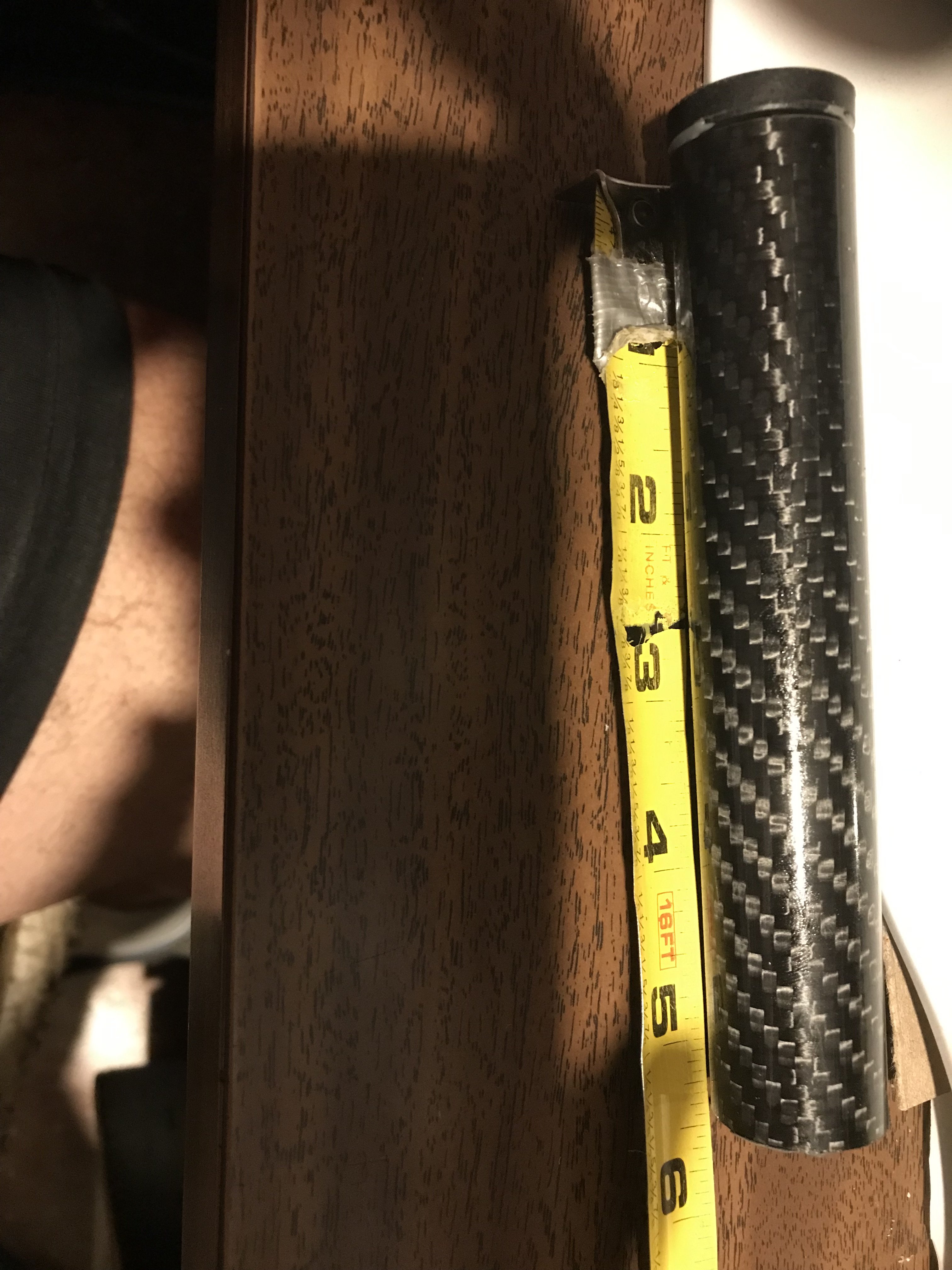

I want to shoot with open sights, So digen around in my JUNK box I had a six inch carbon fiber tube that I JB welded a nut and a washer , Not sure whats on the other end some kind of end cap JB welded , some fine wire and a hail curler stuck in the tube (I think) Got my GK1 turned down to 600 FPS and its super quite with the tube screwed into the ARES adapter,, I am very impressed and how quite it is , I dont think I would turn the power up this tube would fall apart...
