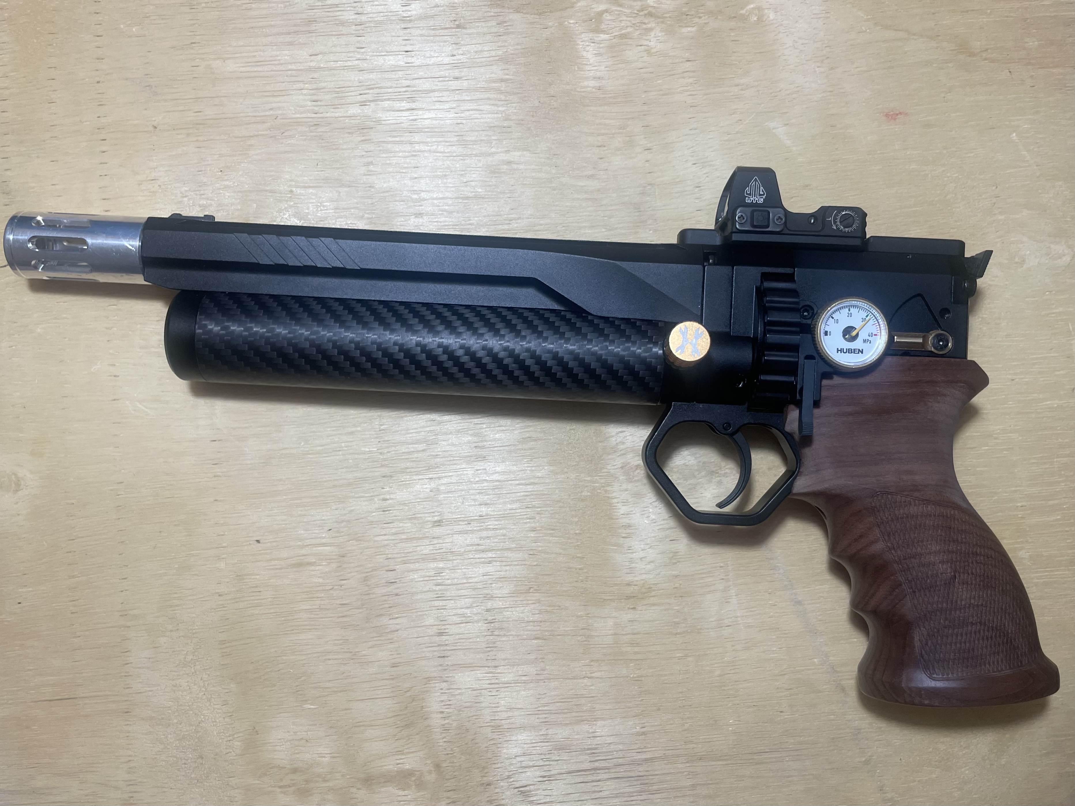

Please check my post #738, I use a Ruger 10-22 Docter base. But an RMR base will also work and same mods are required. A clearance hole is needed for the screw on top of action, you can use 1/4" drill for it.
Reactions: allinssd
Nice setup!
I'm looking for something I don't have to do anything with. I don't have tapping skills, I can destroy anything with a dremel though.
It’s nice having the red dot towards the back. Thanks to @Boomstrike for figuring out this setup. It’s uncanny how a mount made for a 10/22 perfectly lines up with the holes on the huben. What’s funny is that this mount doesn’t fit the 10/22 well because it has a flat base. If it had a curved base like a proper 10/22 mount is supposed to then it would not fit right on the GK1.
