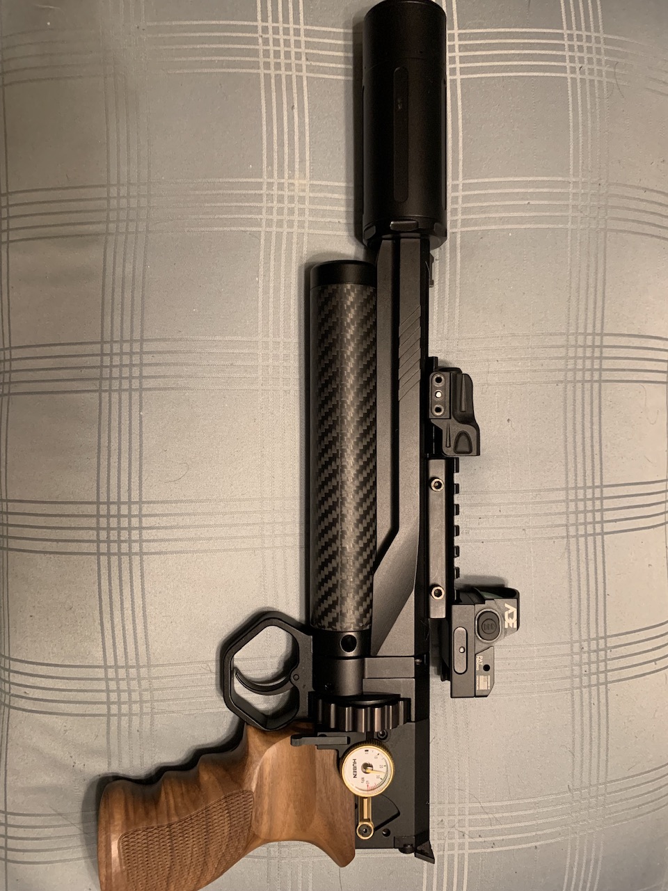

Mine with red dot and green laser. Just walked around the chicken pen and tagged two rats using the laser shooting from the hip. Totally badass pesting rig!

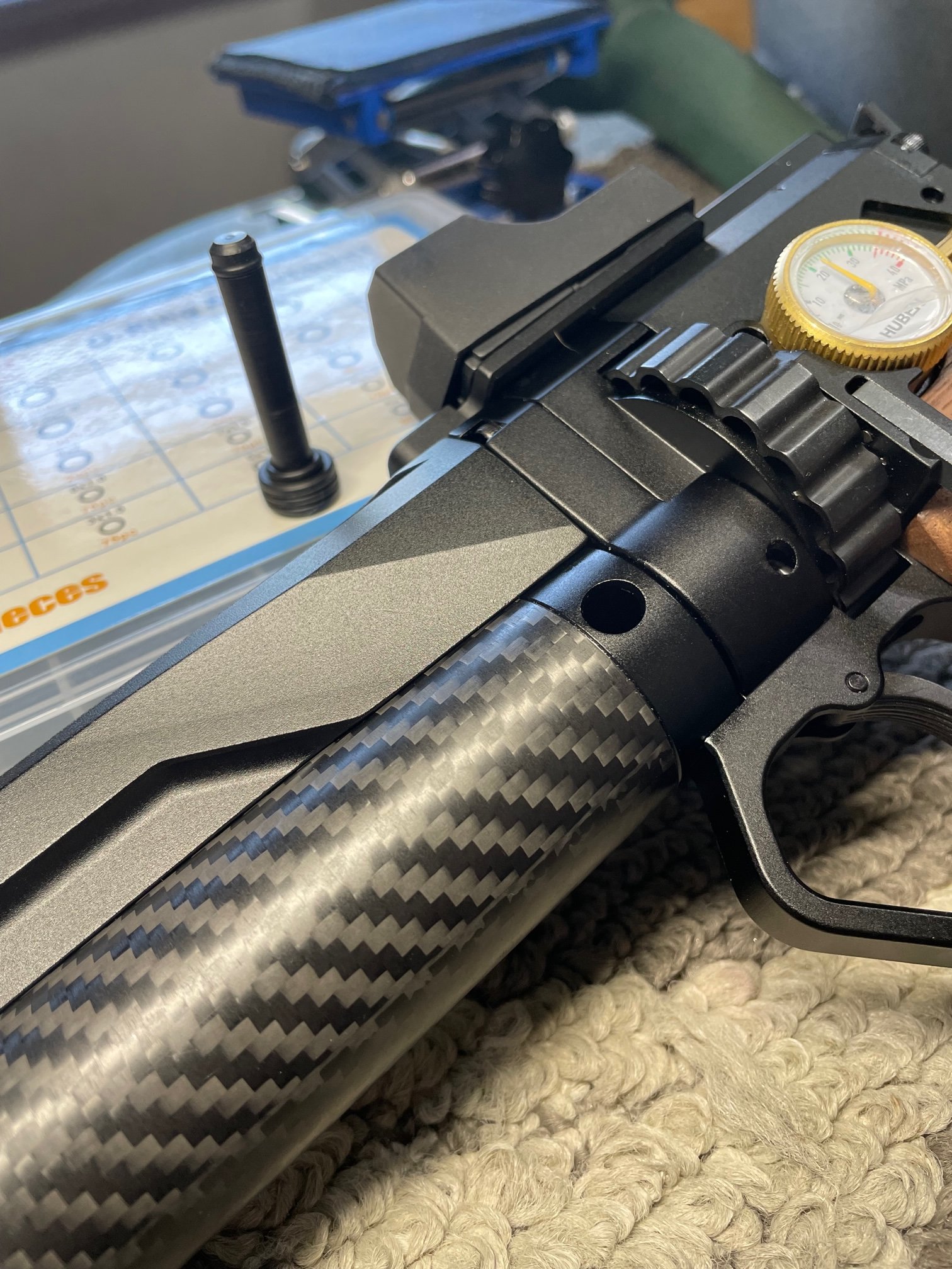

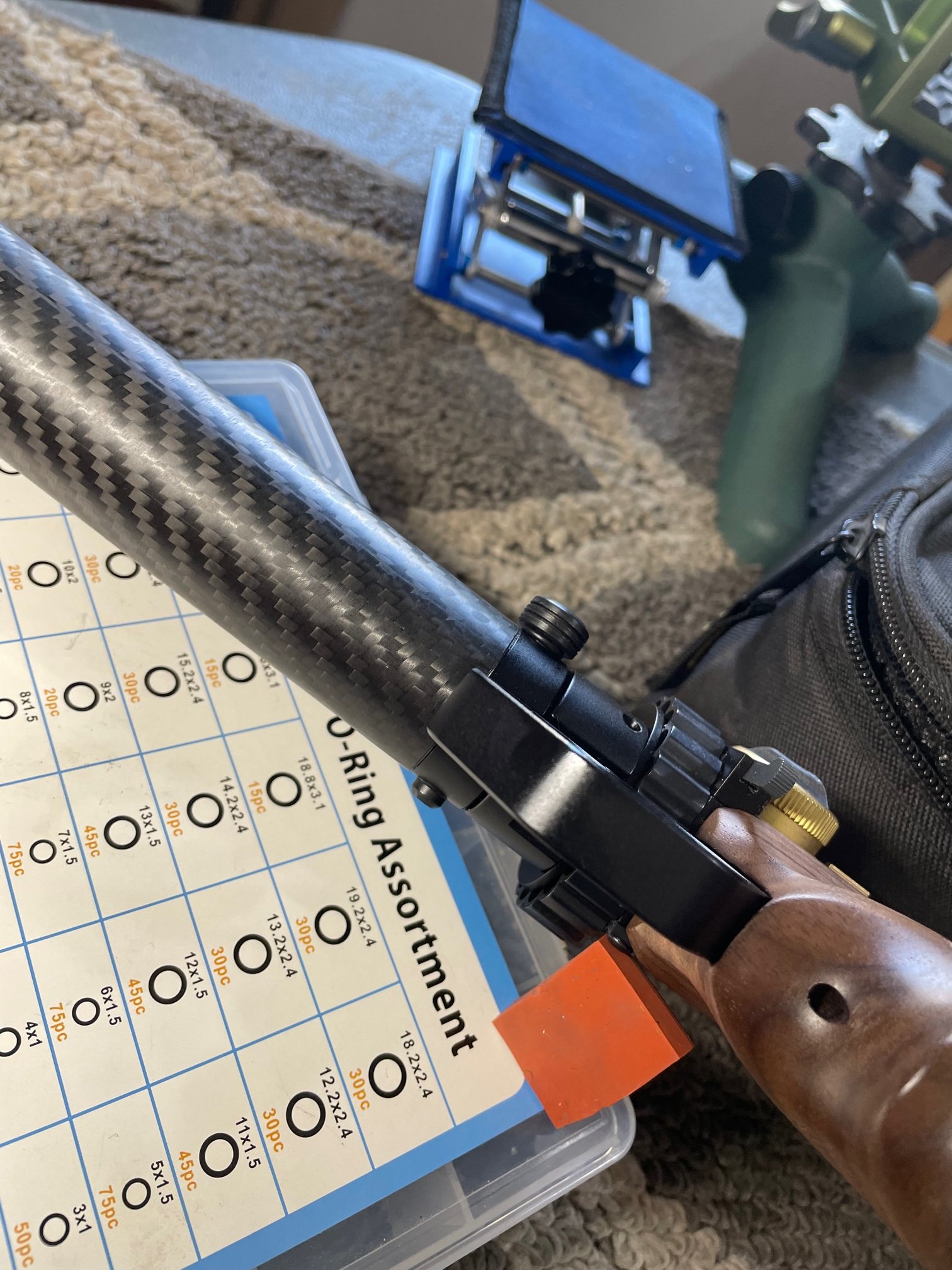

I just want something to keep dirt and small birds out of my air filling port, Legionair has some gold bling on his filling port, Anyone know what will fit or anyone make one with the copy machines, Shipping more than the part I am sure

Damn good question Mike and one that I'm interested in myself. I have not got mine out to shoot yet because of my eye surgery crap but I'd love to plug that hole up.

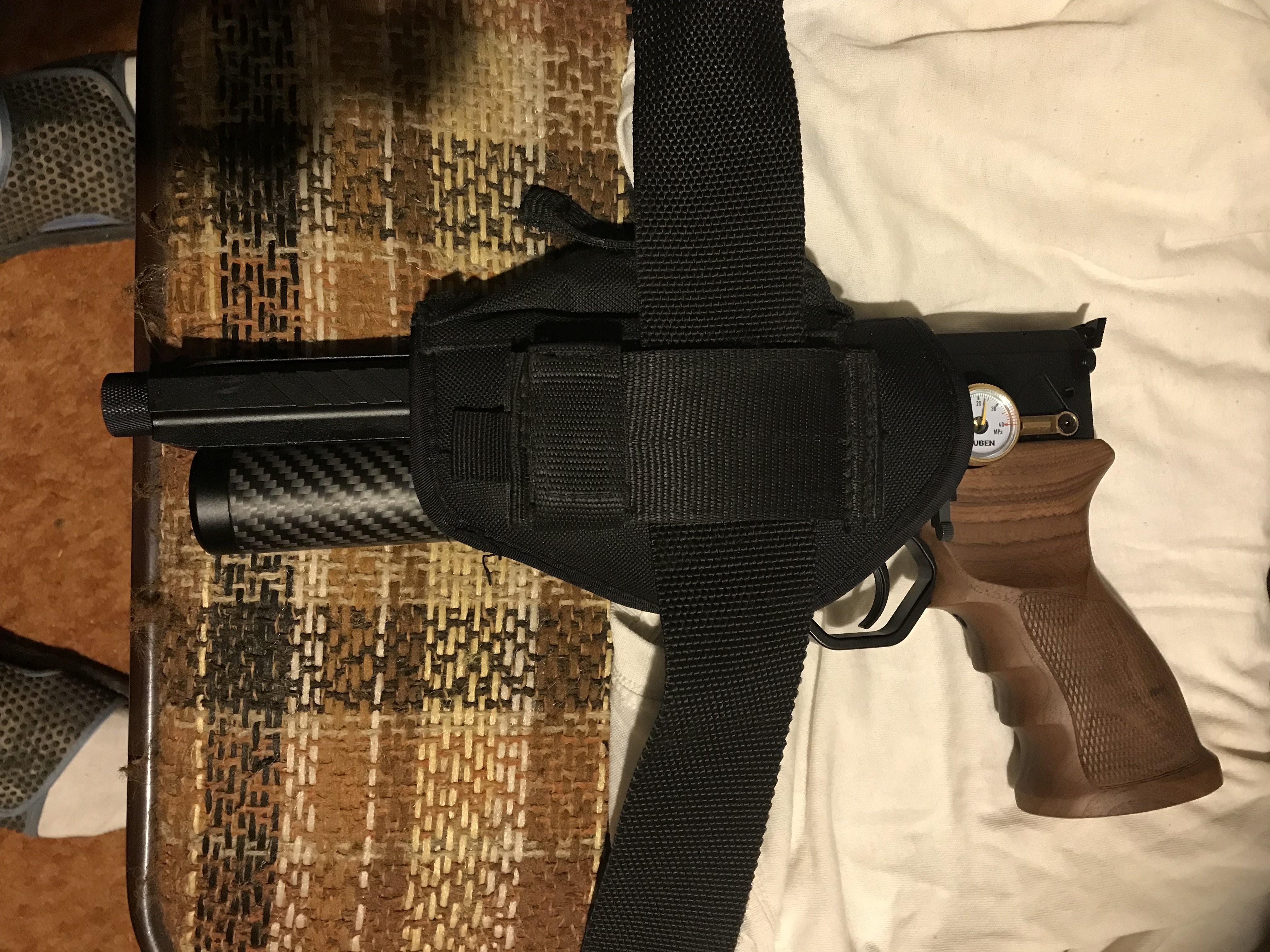

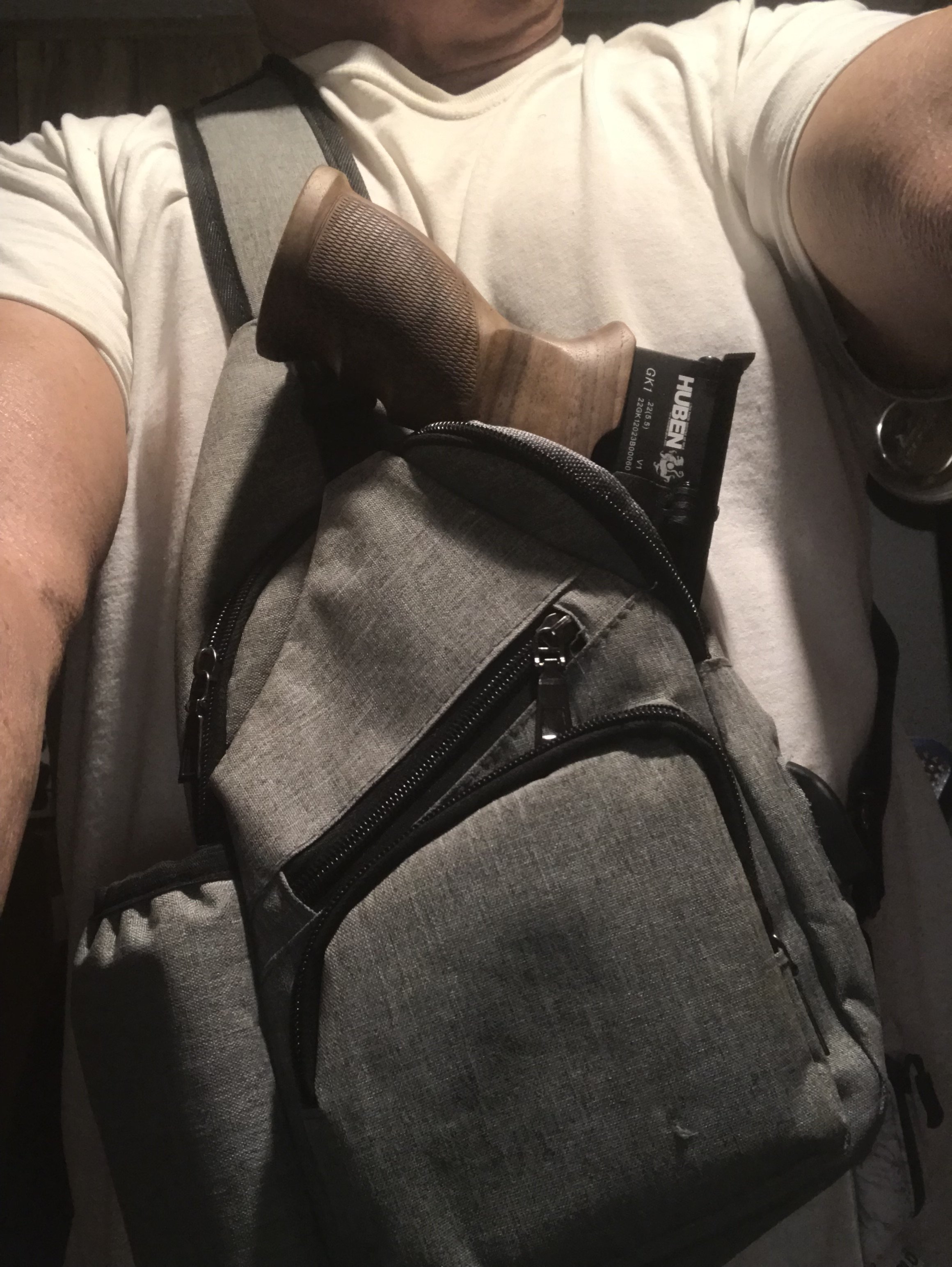

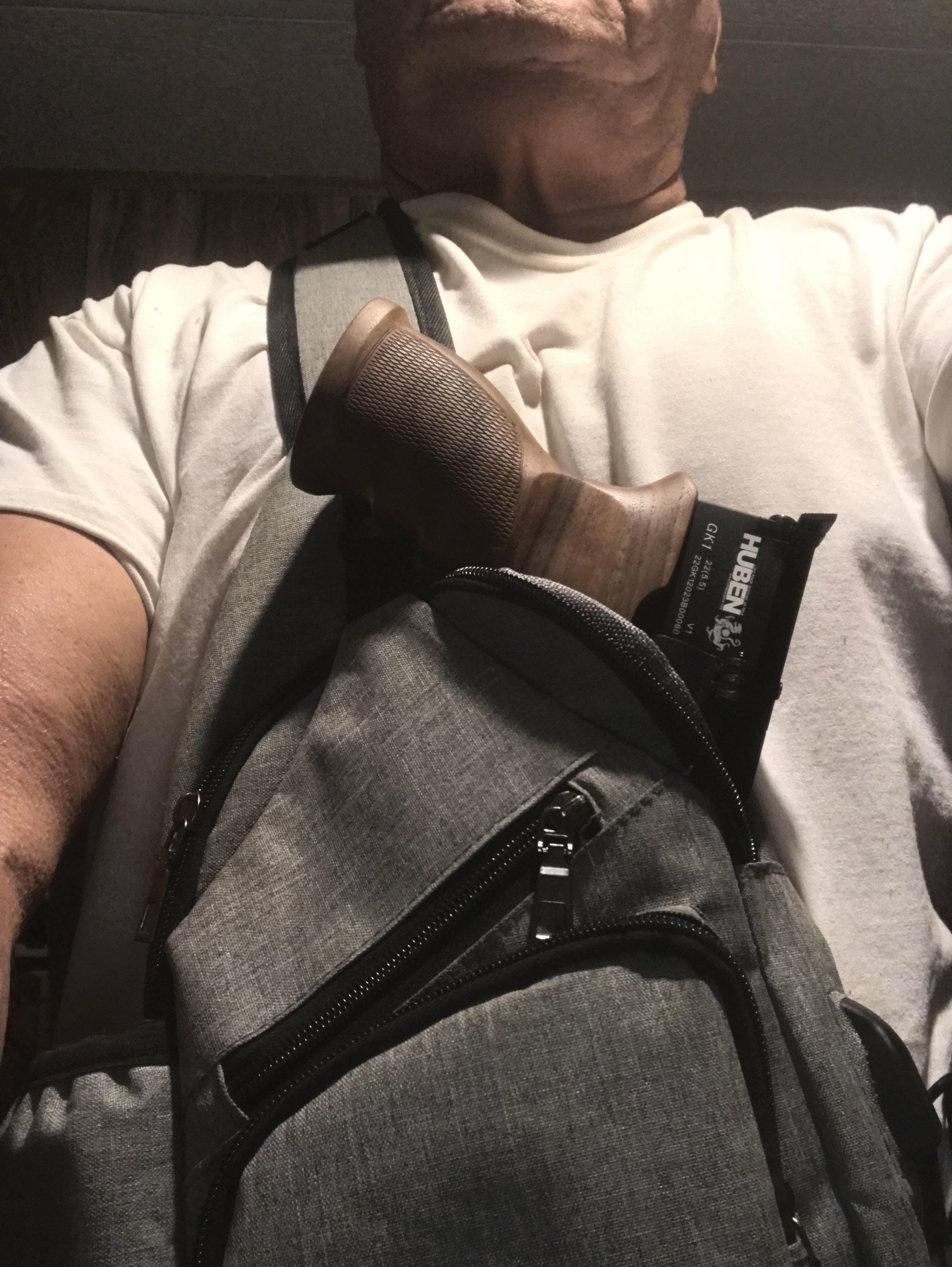

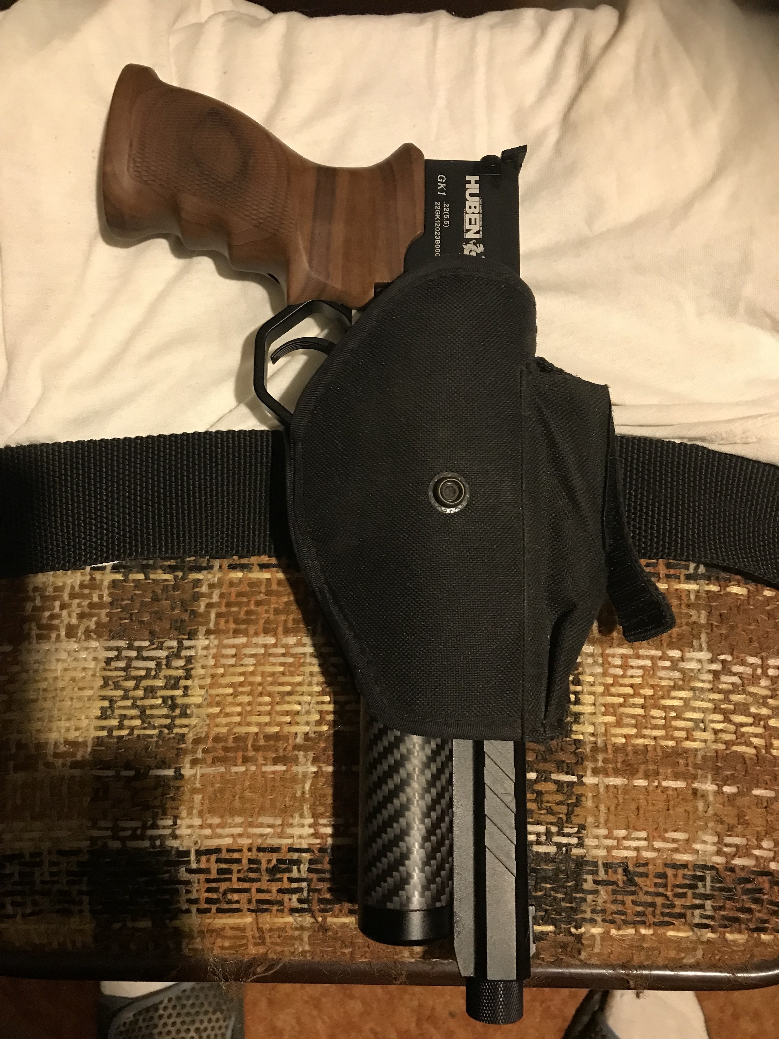

Gun to big for any hip holster I have tried, Maybe if you don't set down it would be OK. I have a shoulder bag that it fits in pretty good be OK for truck use , Or my dirt bike for rattle snake hunting , I have not been able to try either one with the gun but I will see if I can get a picture up of the shoulder bag, No moderator on with gun in holster or shoulder bag.

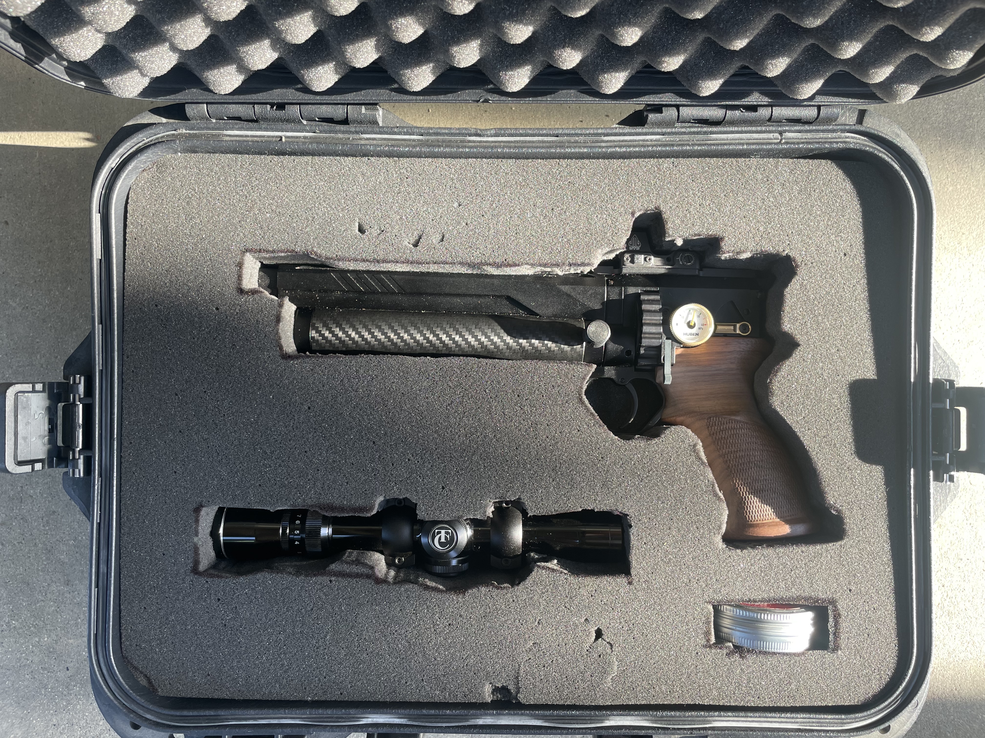

Upgraded the case to a larger pistol case
As you can see by the little puncture marks my dog decided to start customizing the foam before me. I thought the mail man delivered it to the wrong house until I found it laying in the yard lol.
Nice doggy, telling you where fill probe goes in the case,lol.

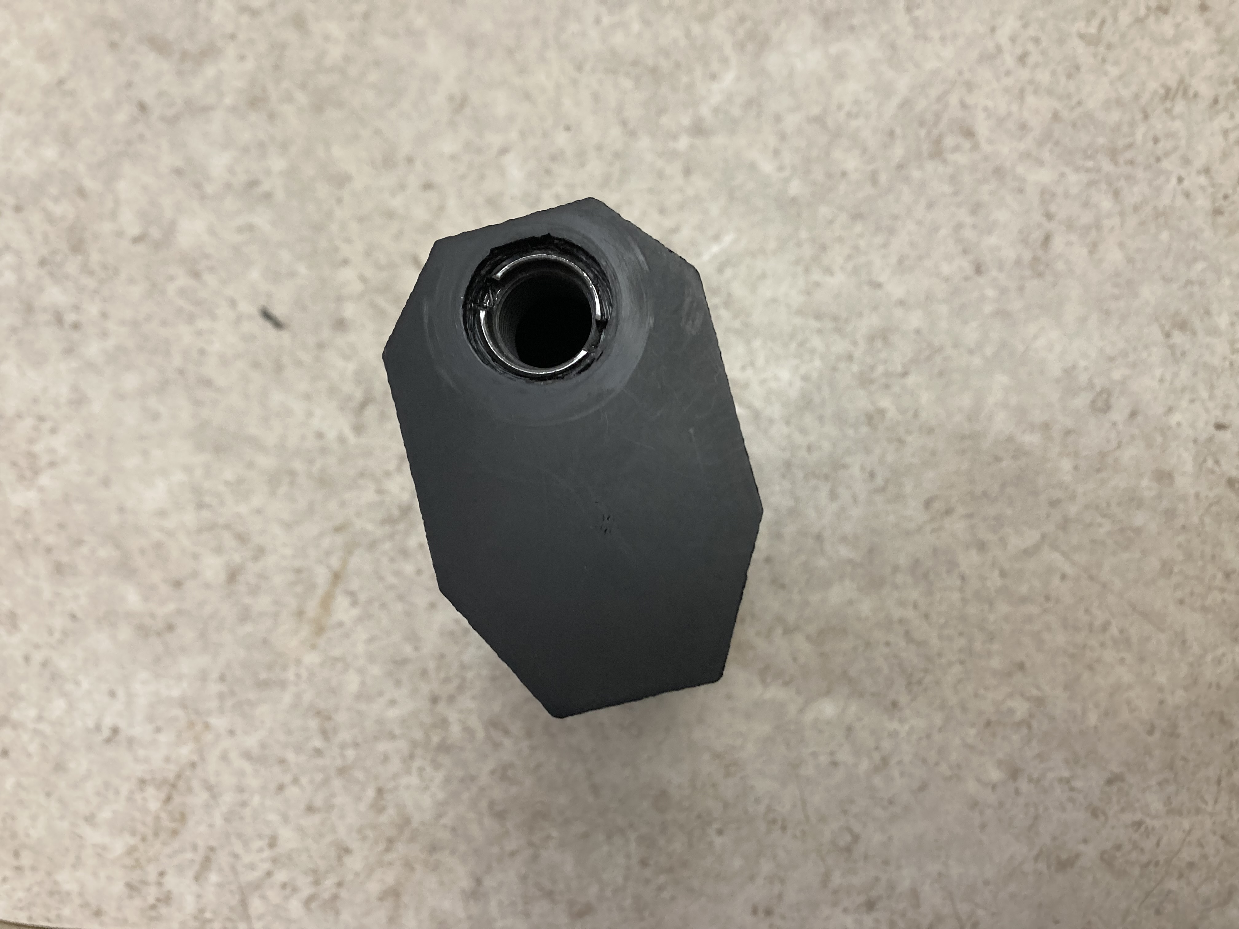

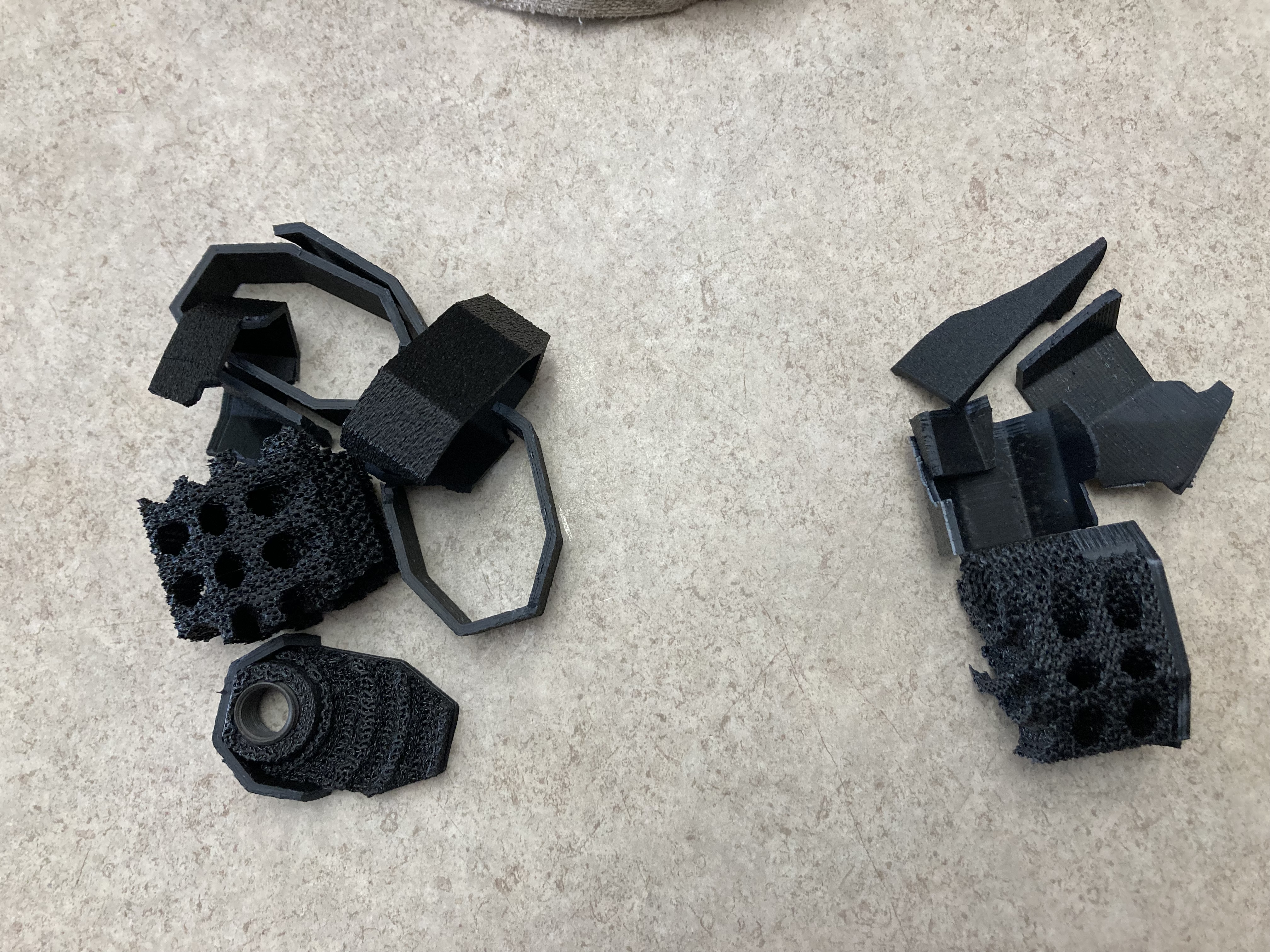

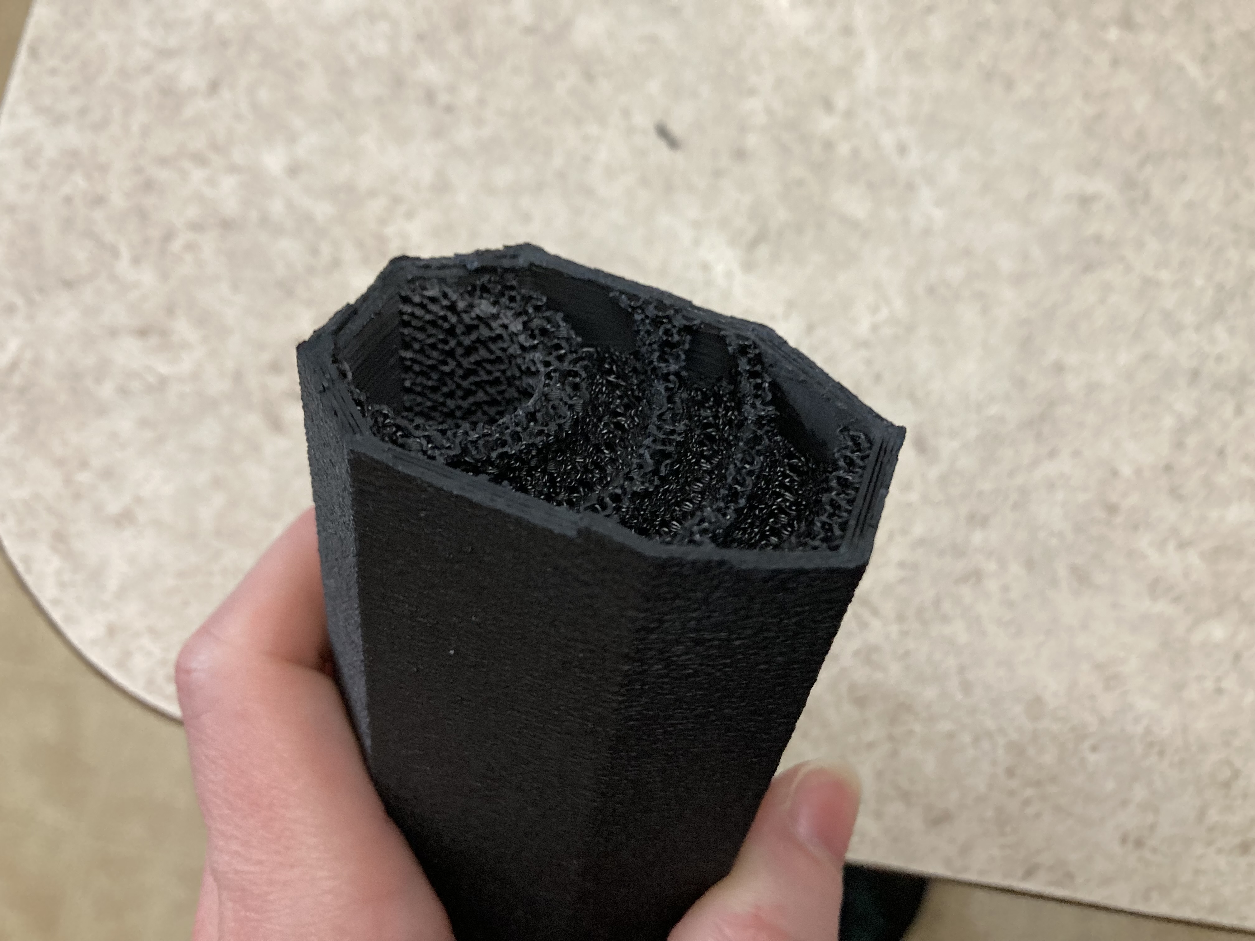

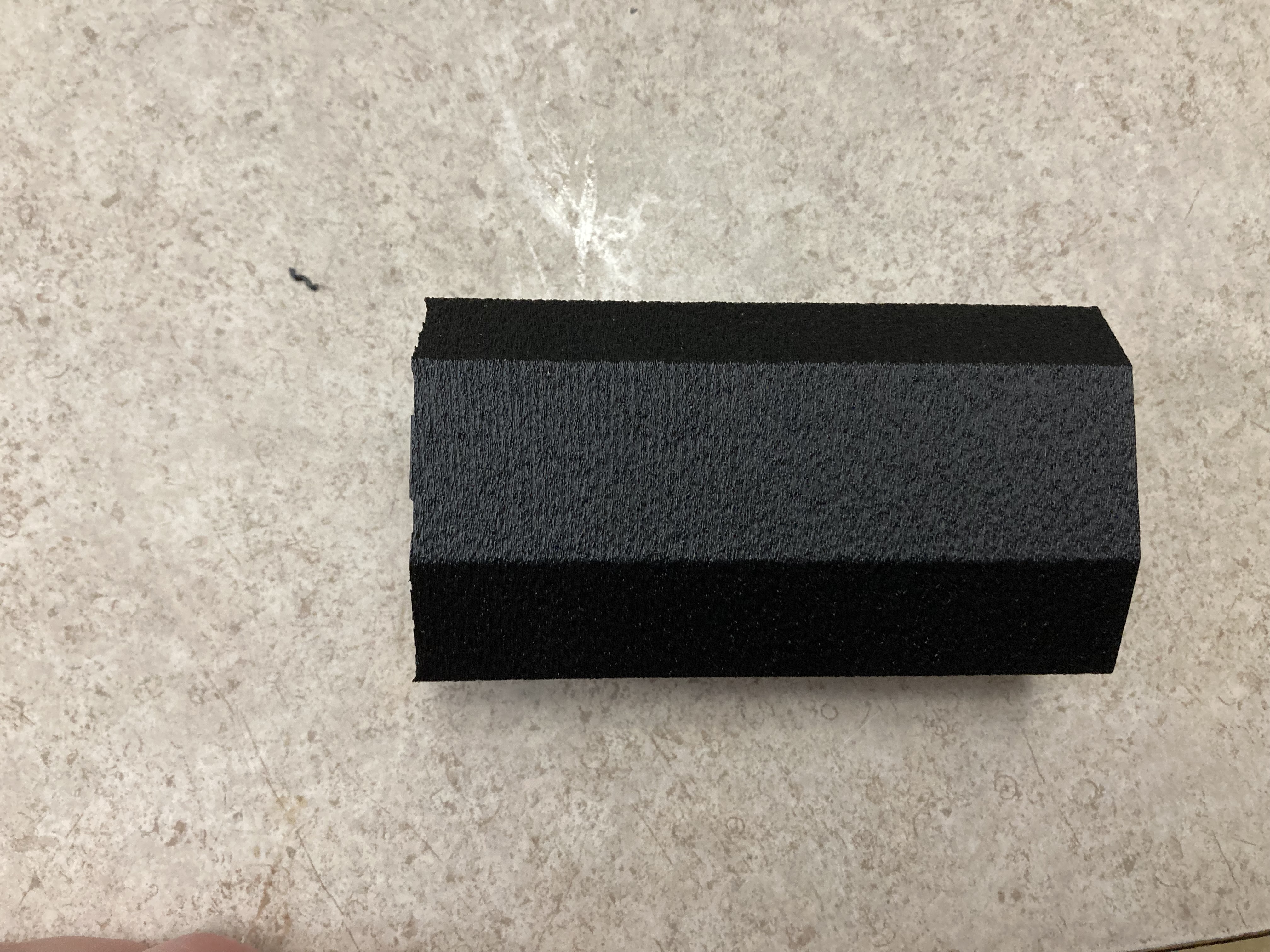

Just a friendly heads up to be very careful NOT to let the reservoir pressure get too low (below 150 bar) when using a 3D printed suppressor or other weaker types of materials. I blew up two in a row because of the GK1 attempting to dump all of the air when the reservoir pressure got too low. That probably caused some hearing damage… It appears my current design is strongest at the threaded insert portion, I need to offset the voids inside the suppressor below the bore line, and possibly decrease or eliminate the gap between the walls of the suppressor and the infill pattern.
What do you think @subscriber, should I try to strengthen the bond between the walls and the interior infill pattern or leave it as is so that if it does burst due to letting the reservoir pressure go too low, it may be less explosive?
Mike
Thanks, you just reminded me. I've been thinking to make one and decided now is the time. I used 1/2" UHM black rod and reduced it to 6.9mm x 35mm, cut O-ring grove at 33.5 mm from shoulder so I can put O-ring by the shoulder also.
There we go, that’s better! It still failed, but not nearly as explosively and it might be fixed by simply offsetting the voids in the infill pattern.
The problem causing it to be so weak was the infill not attaching firmly to the walls when using Prusa Slicer (which I’m not as familiar with), not a problem in Cura. The new printer I got for high speed production (Qidi X Max 3 40% faster than X Plus 1) relies on a fork of Prusa Slicer, so I’ll need to make some tweaks to the model, tweaks in the slicer, or give up some cool features with the Prusa forked slicer and use Cura to generate g code instead.
I think this might actually prove to be a net benefit that these GK1s dump all the air near the end, because now I have an effective and repeatable method for over pressure testing all of my moderators. 😃
For the safety Nazis, I’m putting on safety goggles, hearing protection, a face shield, gloves, a hoodie, a jacket, and placing a 55 gallon drum between my body and the pistol when blowing these up now. 😂 Doing my best not to take any chances. But holy hell is it loud when one of these fail because of a reservoir dump. Hopefully I won’t get a visit from the cops from the sound. 🤯
*Edit, I have no idea where the end piece went, lol. Probably landed somewhere behind in the forest after bouncing up the hill.
