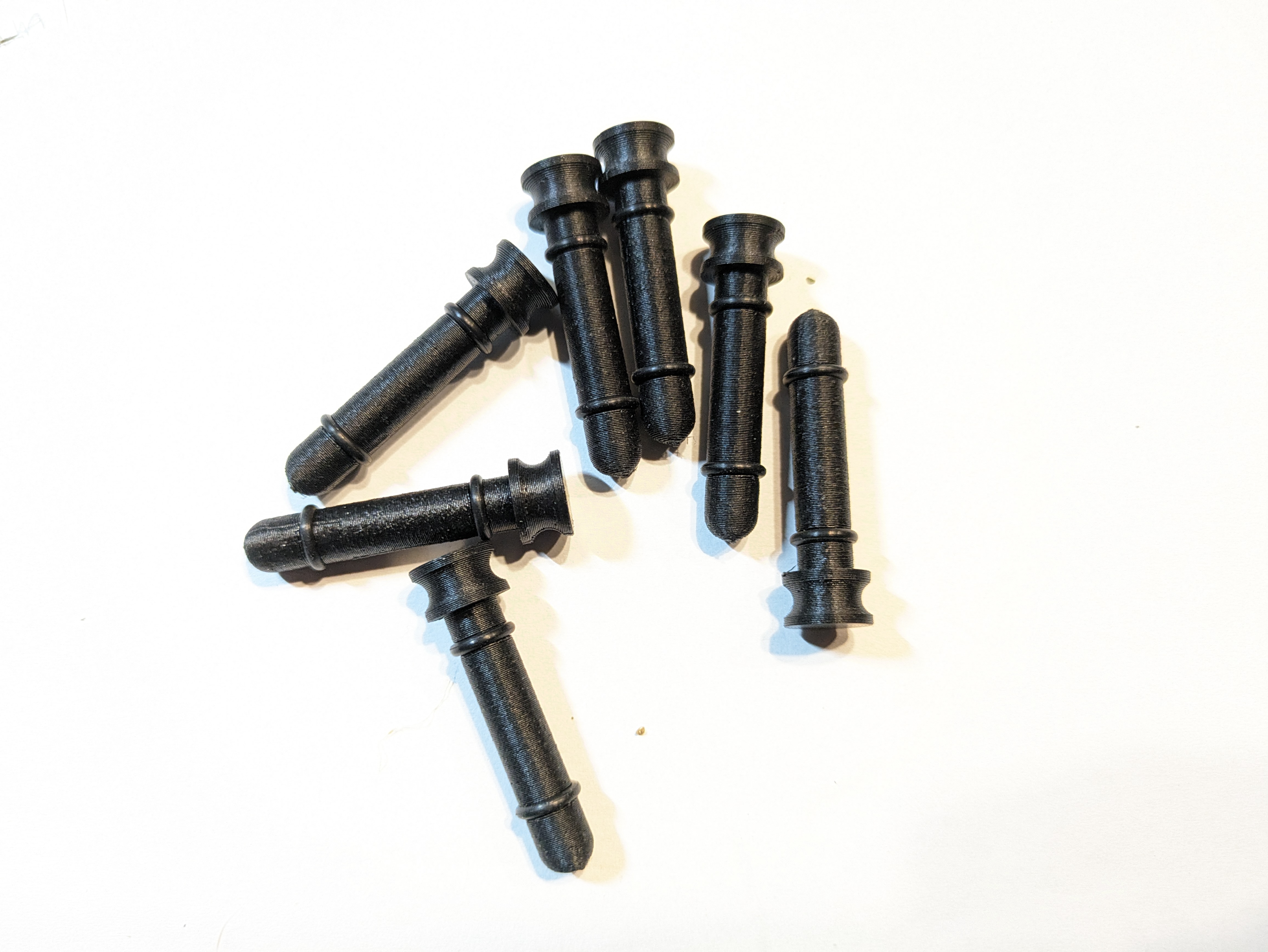

I was looking everywhere for a dummy machined fill prope lol.
like this?
View attachment huben_fill_plug.zip

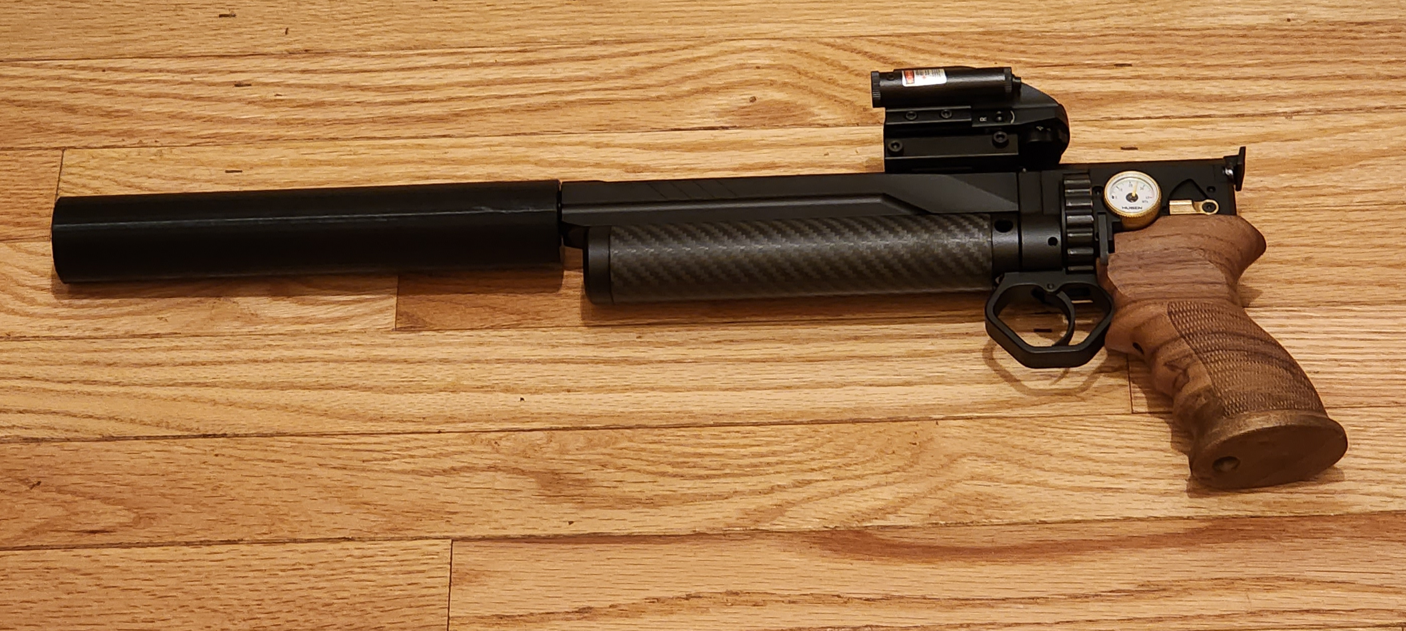

Unfortunately my scale crapped out so I’m unable able to weigh the shroud. There is a lot of weight and mass there for just being basically a cover with a front sight and 11mm dovetail. Ideally a redesigned cover with intergraded sound suppression, front sight and a built in picatinny/ weaver style base is what’s in my head.
@subscriber I printed your 8 1/2" moderator. It sounds a little quieter than the 5" version. Technically it should be about 2 dB quieter. 3 dB is suppose to be the minimum detectable change in sound level detectable by the human ear and is about 1/2 the power.
