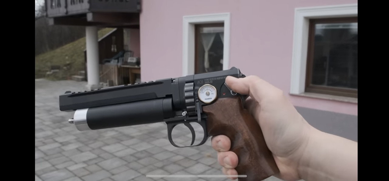

Did someone say wicked Mini-CARBINE ?View attachment 392447
