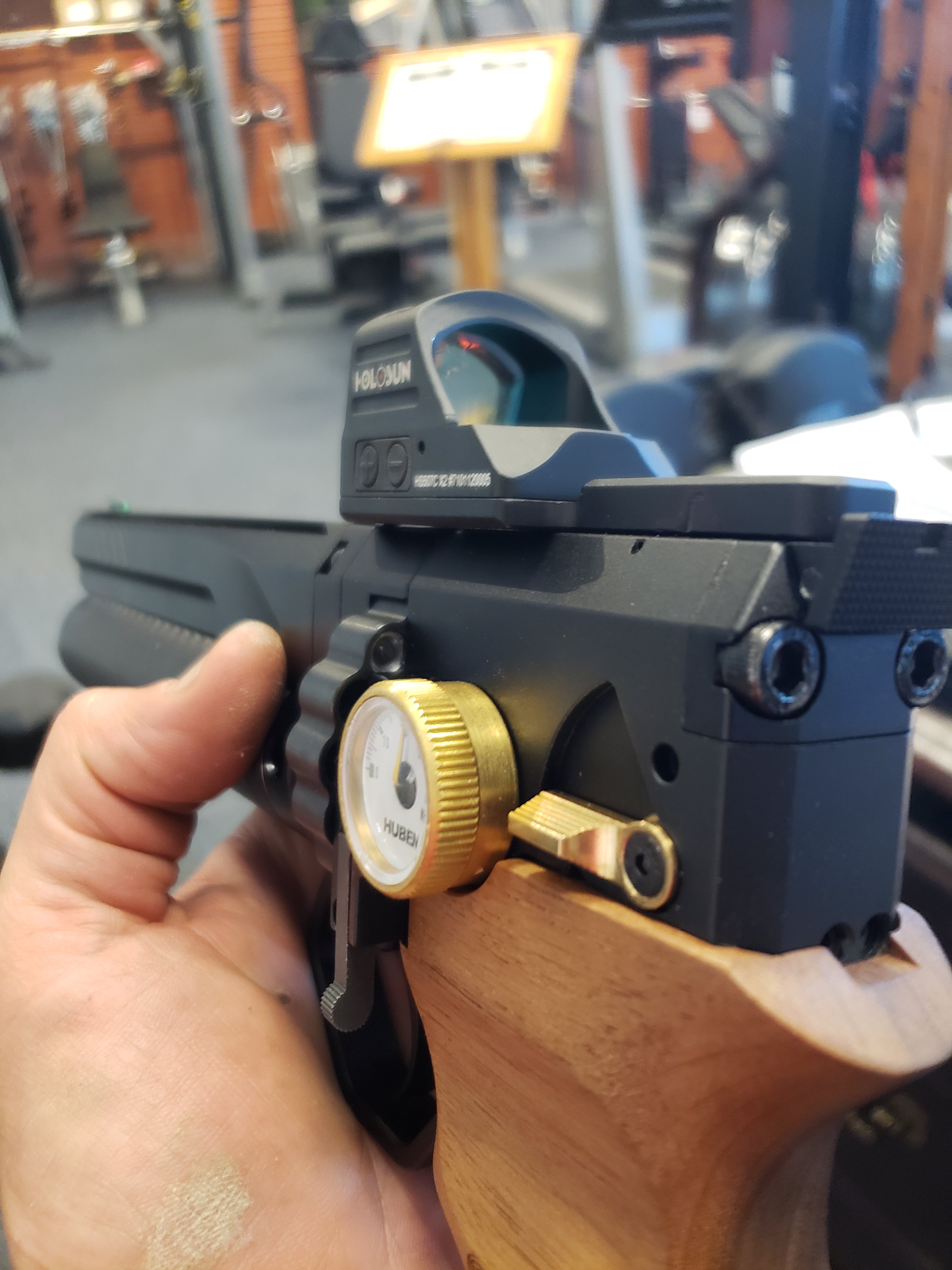

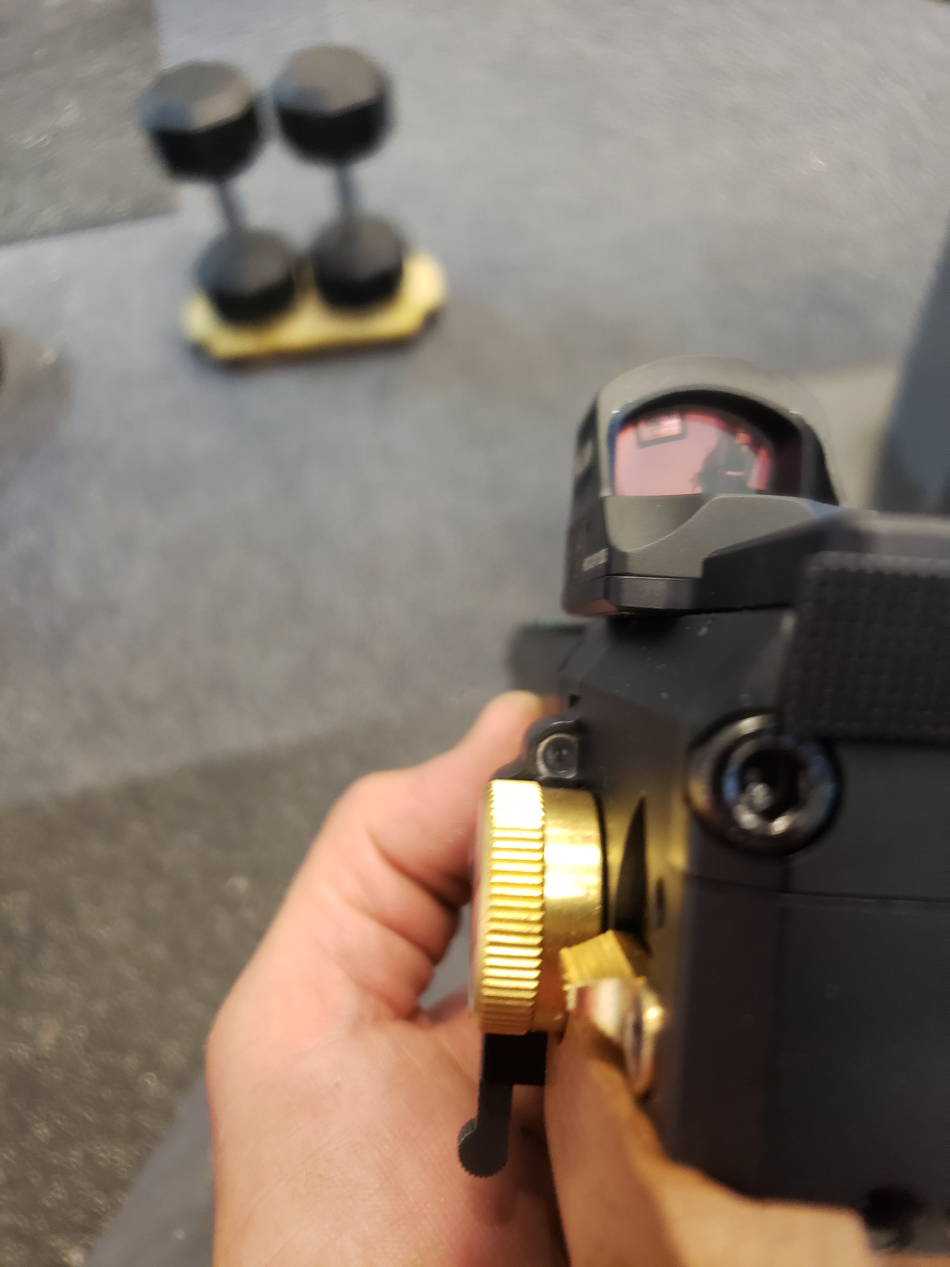

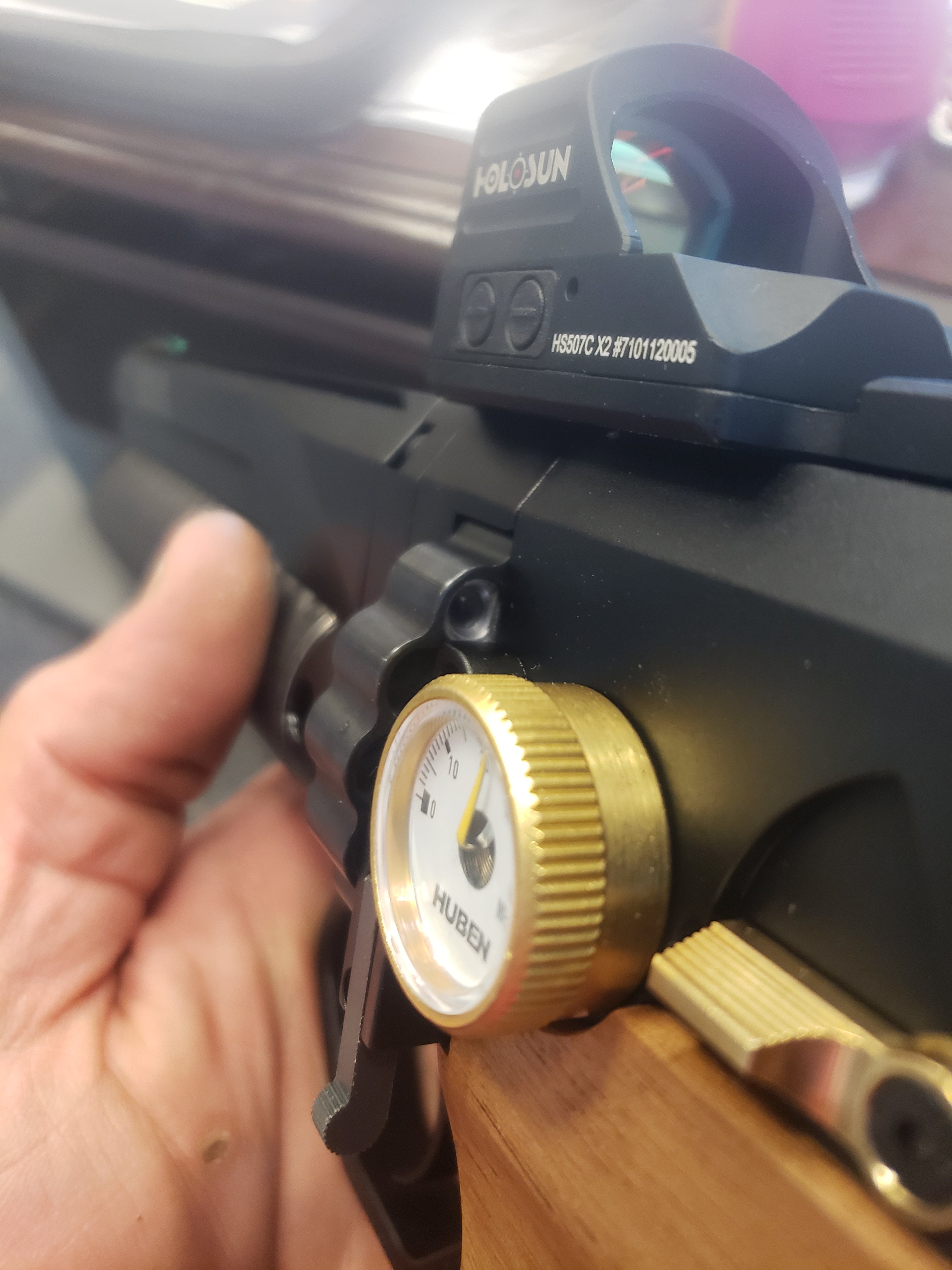

Then, if you can, post a pic of the mag above the gauge so that I can see it’s position in relation to the action
Upvote 0
Perfect. I held it barrel up as I wiggled back and forth and I got some play in the mag and now it's shooting again.Lift the lever and see if you can loosen the mag a little by turning it back and forth and then lower the lever and fire a few shots.
