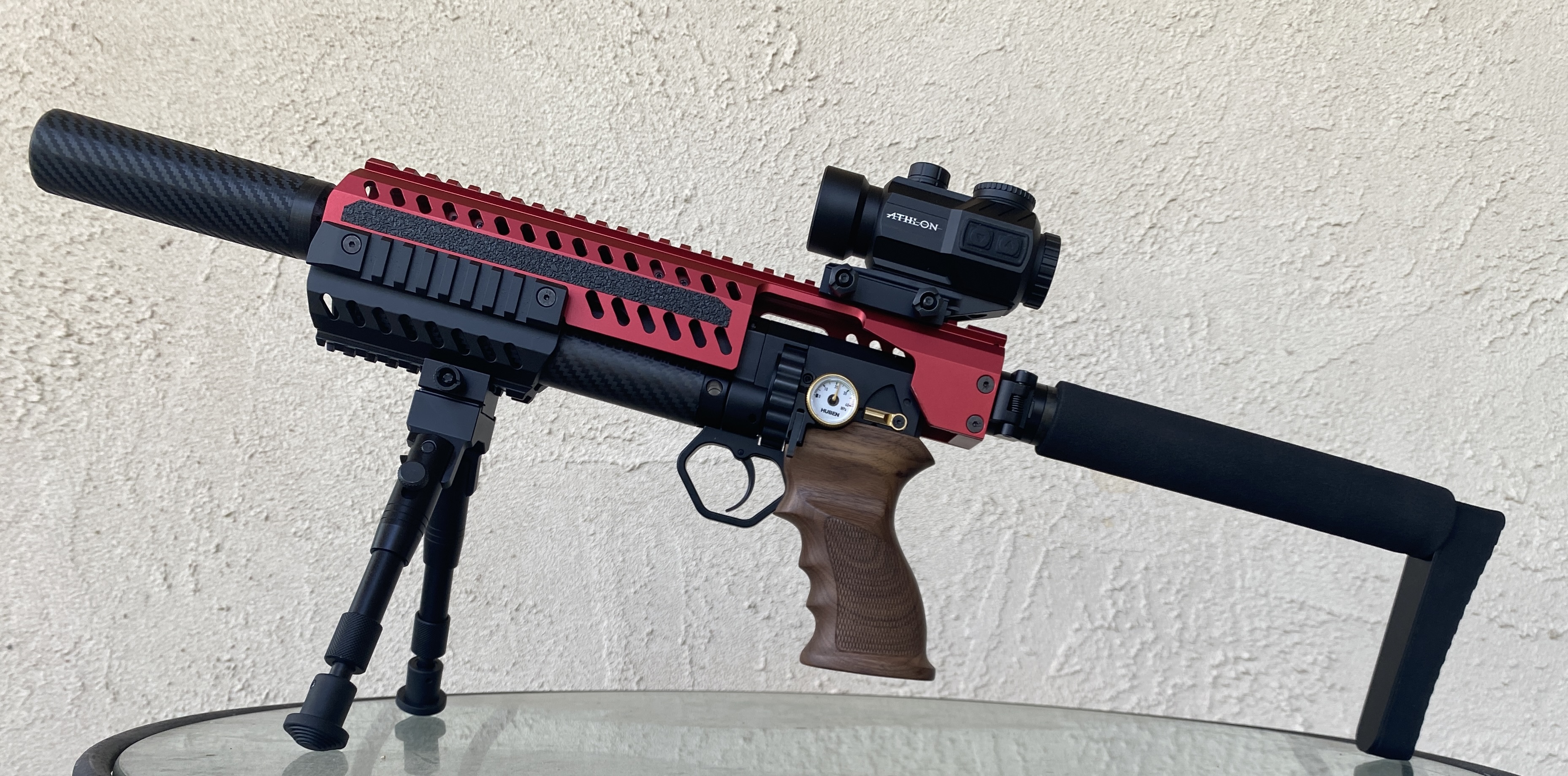

A small folding stock Mini-Carbine woud be ligther, more easy to put in a standard backpack and most importantly capable to get the scope closer to the bore.
With the capability that Huben has to make power I would choose a mini-carbine over the pup anyday.
