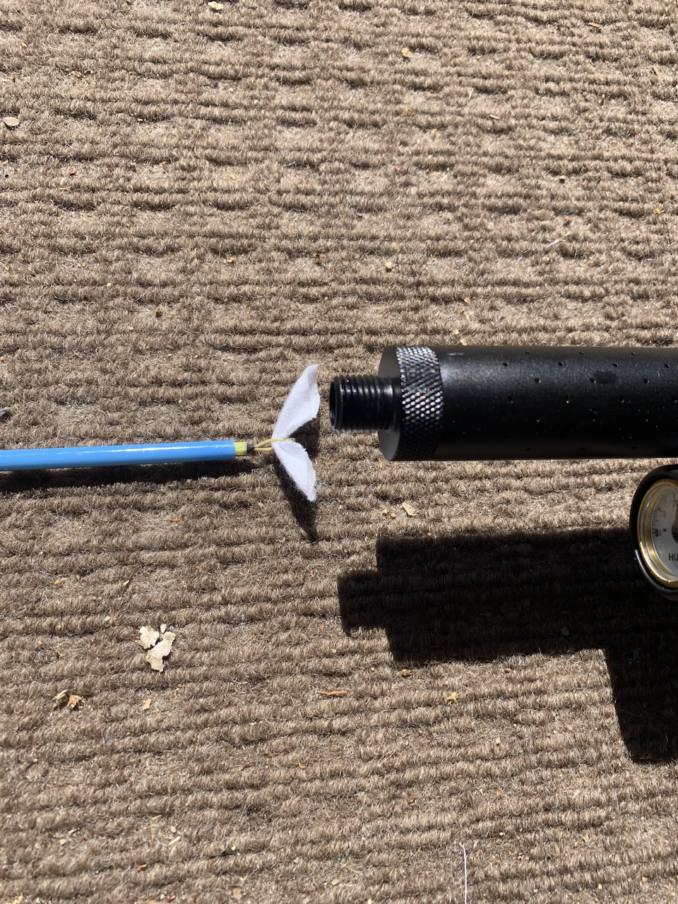

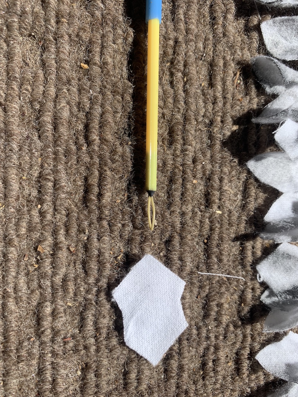

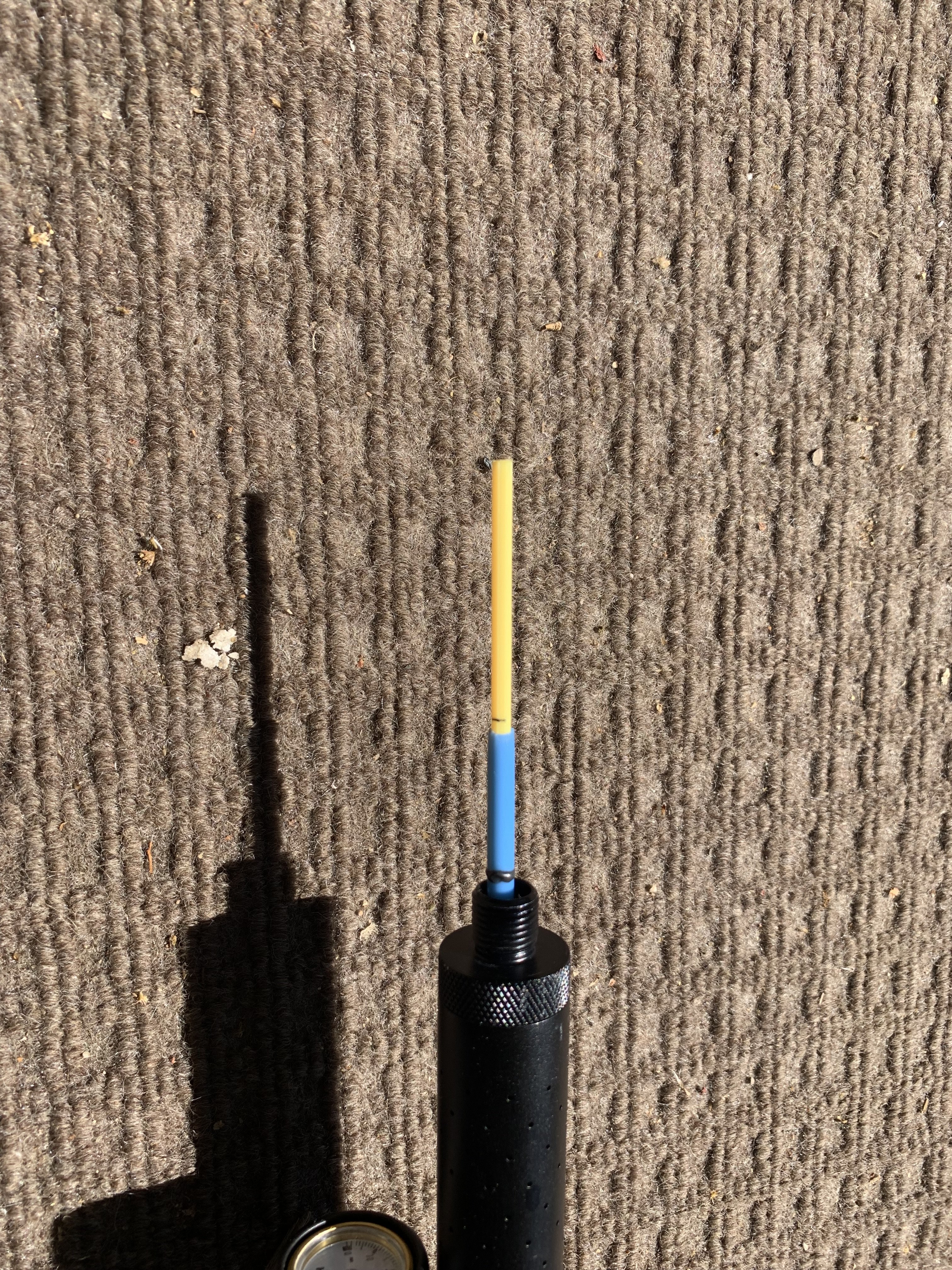

I have a very easy method.
It holds the patch in the outer blue tube during insertion, and the patch gets pushed out inside the barrel. Black marks on the rods indicate how far to push in the outer blue tube and then how far to push in the yellow inner rod to release the patch. The pistol is very easy to clean with this method. I then use a qtip with a drop of cleaner to do the mag. 20 min to run 15 patches through. I do remove the battles and drop them into alcohol when I do the rifles!
It was made from a Sullivan RC control rod but any rod and tube of around .20 will work. A fly line loop holds the patch, epoxied into the yellow rod.

View attachment 398169View attachment 398170View attachment 398171
This is a good idea, thank you! I’ve already got the parts off eBay to assemble it. I saw this when you posted it earlier.
