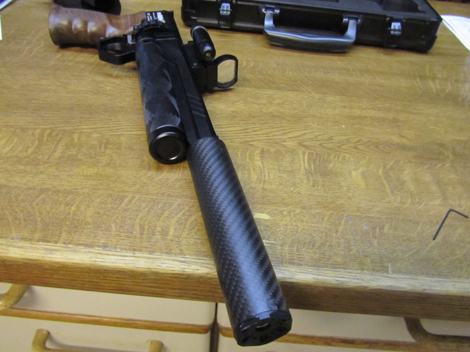

I received mine last night with the CF moderator. It came charged to 300 bar. I have done nothing with it so far. Two things are clear to me. First the standard sights are blocked with moderator mounted and second, with no pellet, the moderator makes no difference in sound.......zero! The mod is very light and fits perfectly. I really like the grip and pistol balance. More tomorrow........

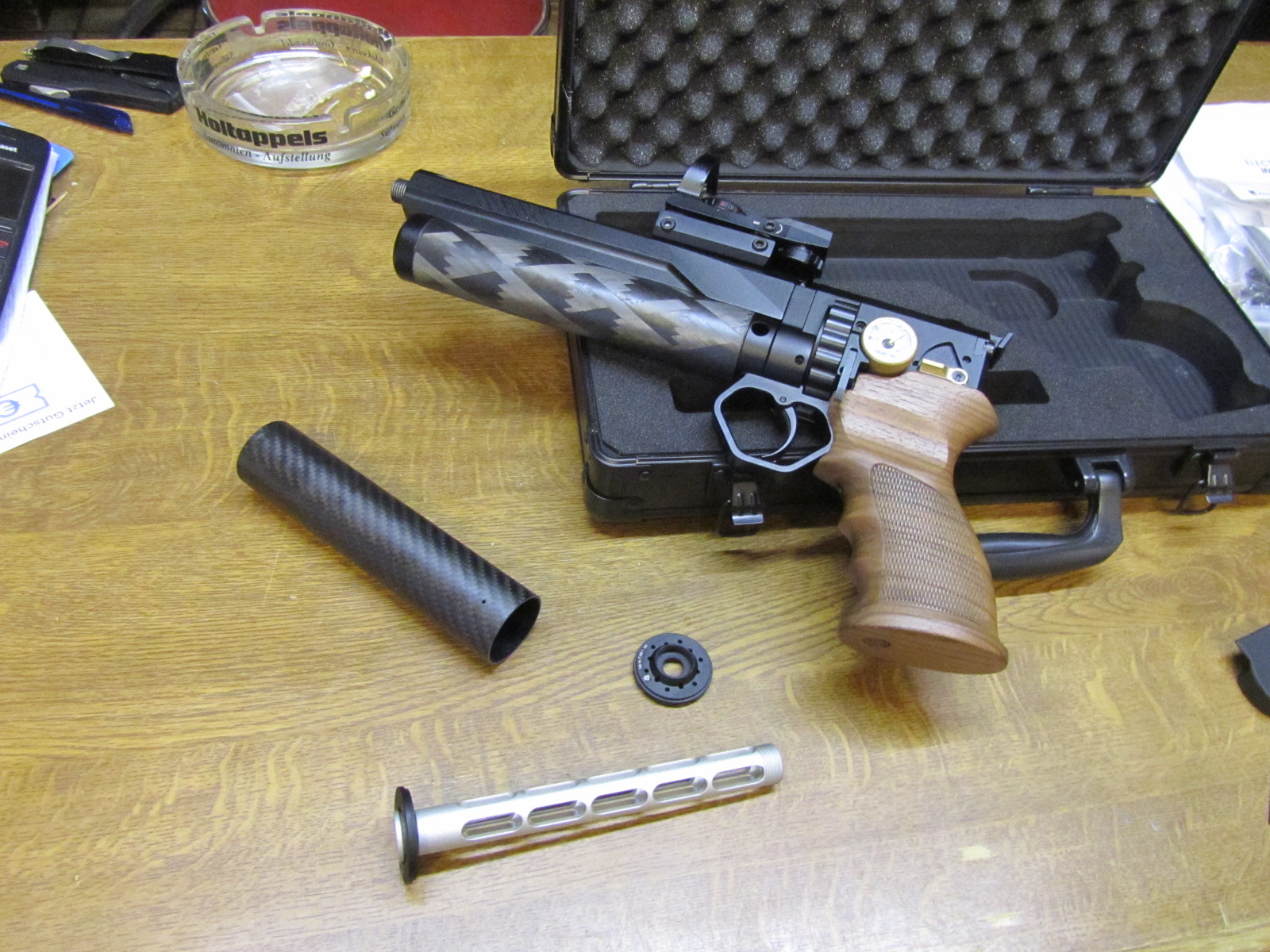

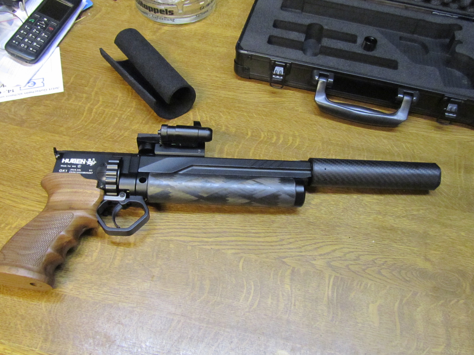

I have just mounted an AliExpress, no name, Reflex sight to the 11mm rail on the GK1 shroud. It fits perfectly. No reason to use a special plate to mount a sight to the receiver block. See photos. I also disassembled the mod. It fits directly on the barrel as the GK1 barrel comes with a 1/2-20 male thread. The following dimensions apply: mod bore = .354", Mod diameter = 34 mm, Mod length = 155 mm, Mod weight = 58.7 grams (without the stupid foam). The sound is not reduced at all with or without the way too dense foam. This moderator is effectively useless. My homemade Mod which uses 3 conical baffles reduces the sound by more than half.
The reflex sight mounts with the following dimensions. Center screen is 49 mm above the barrel center. the laser is 24 mm above barrel center and 29 mm right of barrel center.

I can't speak for what I have not used. I received the "Hush", which is made by Huben. I can also state that any mod will likely block the the front sight. Hence my inclusion of the sight dimensions and clearances. After all the sight testing I did on my PP700SA and the spectacular satisfaction I have had with my reflex sight, I have gone with the same sight on the GK1 and expect nothing less.

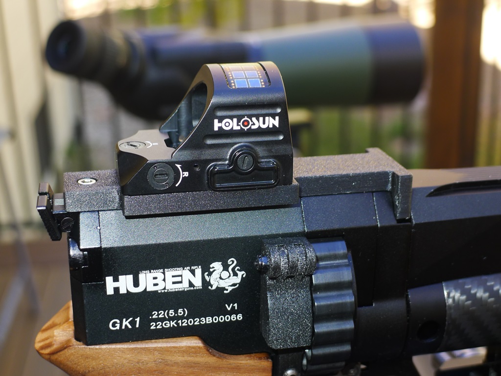

With my Holosun HS507C mounted it does not fit in the original Huben case in the original orientation. From the top of the Holosun to the bottom of the grip is just a bit too large to fit into the case in the original orientation. If you cant the pistol (muzzle toward long edge of case) it may fit but the top of the sight and bottom of grip would touch the plastic long edges of the case if you removed the foam.
Reactions: FuegoMarty
You can cut a strip of the foam from the bottom of the case and transfer it to the top with a little recess for the sight. A bit ghetto but the alternative is to cut yourself a whole new piece of foam.
