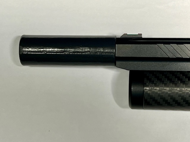

Here is a picture of my .25 caliber GK1 with the 25mm moderator attached. It's shooting 25.39 grain pellets at 850 FPS.
It's only 3" long and does a great job at making it backyard friendly without being too bulky.
This is made from PETG and took 8 and half hours to print. So far I have over 100 rounds through it and have not had any problems.

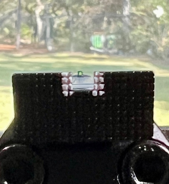

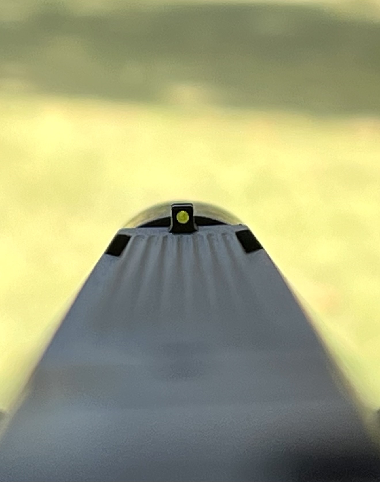

Here are some pictures looking at it from the back using the iron sights.

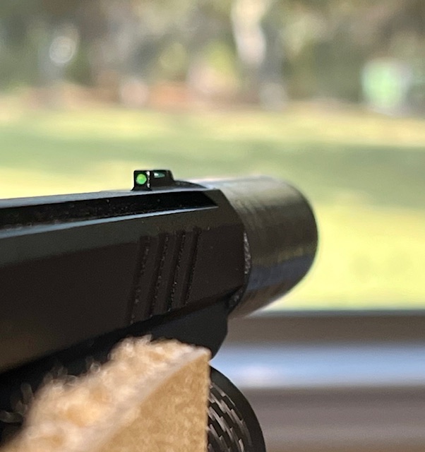

Front sight clearance of the moderator.
Another angle showing the clearance and usefullness of the front sight.

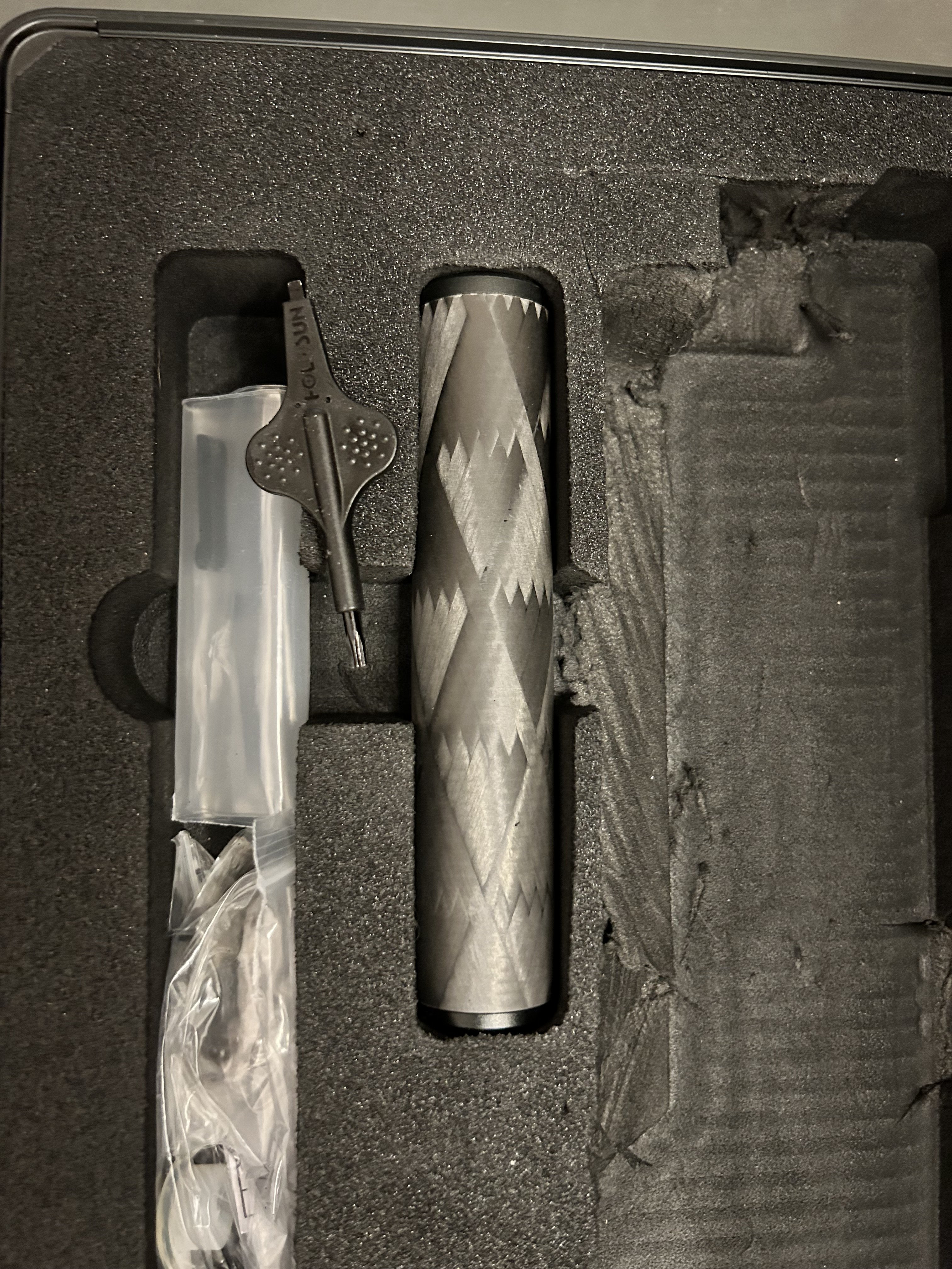

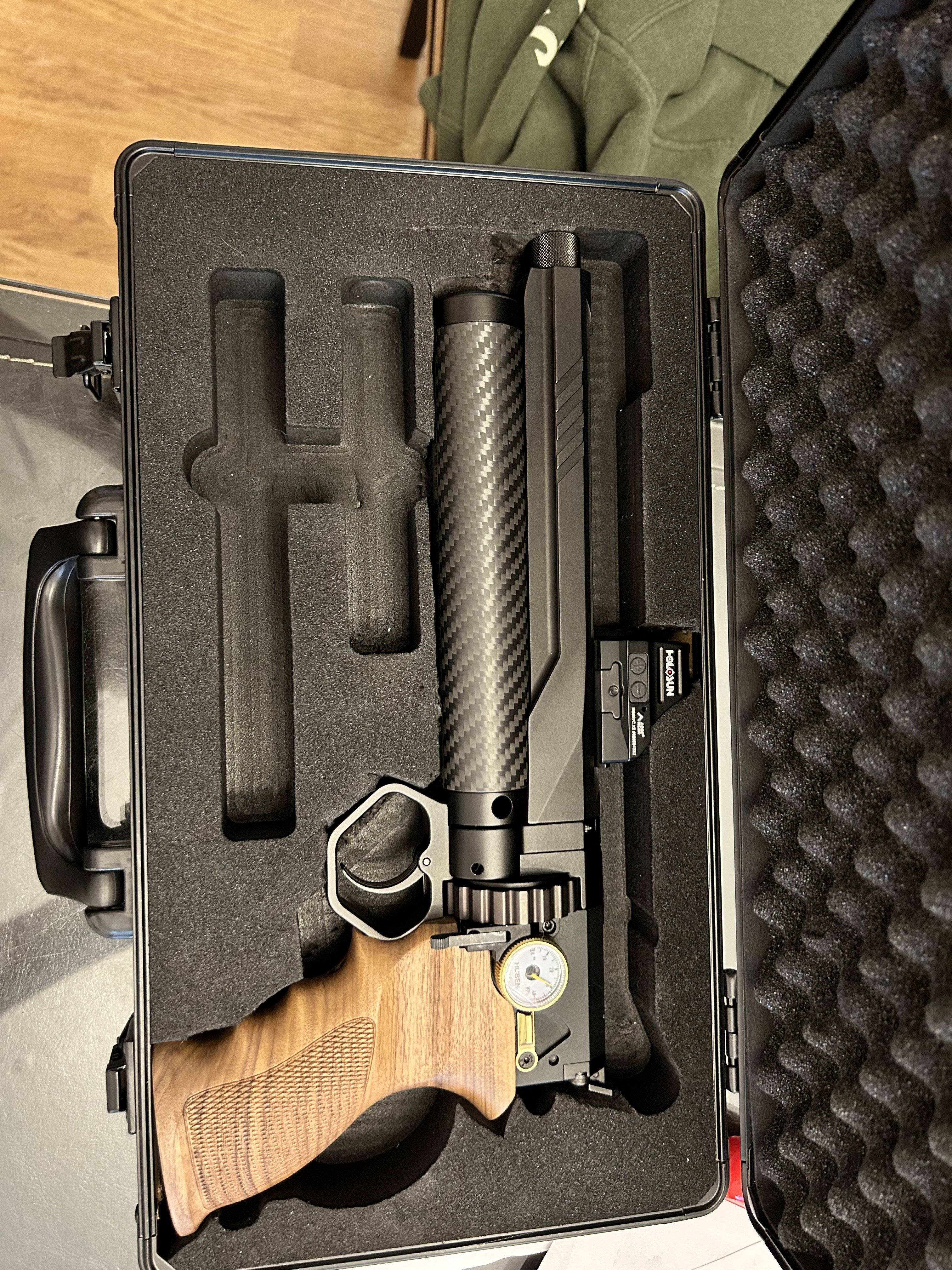

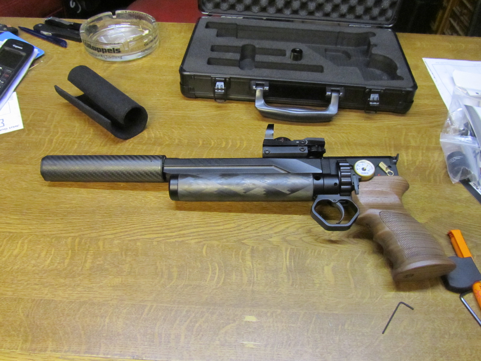

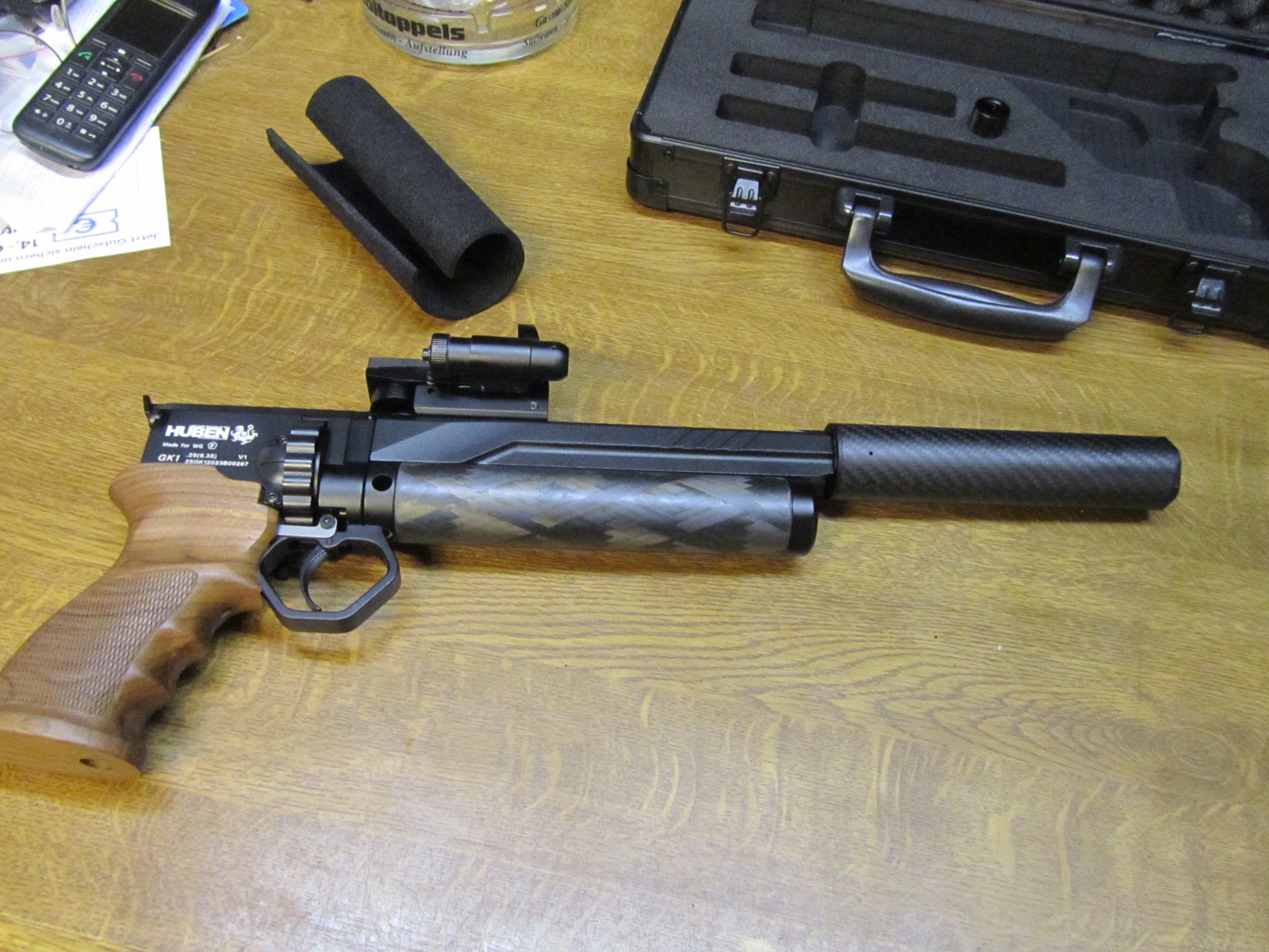

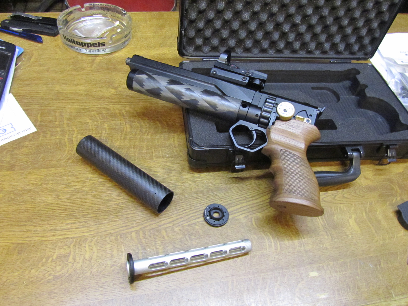

I have just mounted an AliExpress, no name, Reflex sight to the 11mm rail on the GK1 shroud. It fits perfectly. No reason to use a special plate to mount a sight to the receiver block. See photos. I also disassembled the mod. It fits directly on the barrel as the GK1 barrel comes with a 1/2-20 male thread. The following dimensions apply: mod bore = .354", Mod diameter = 34 mm, Mod length = 155 mm, Mod weight = 58.7 grams (without the stupid foam). The sound is not reduced at all with or without the way too dense foam. This moderator is effectively useless. My homemade Mod which uses 3 conical baffles reduces the sound by more than half.
The reflex sight mounts with the following dimensions. Center screen is 49 mm above the barrel center. the laser is 24 mm above barrel center and 29 mm right of barrel center.

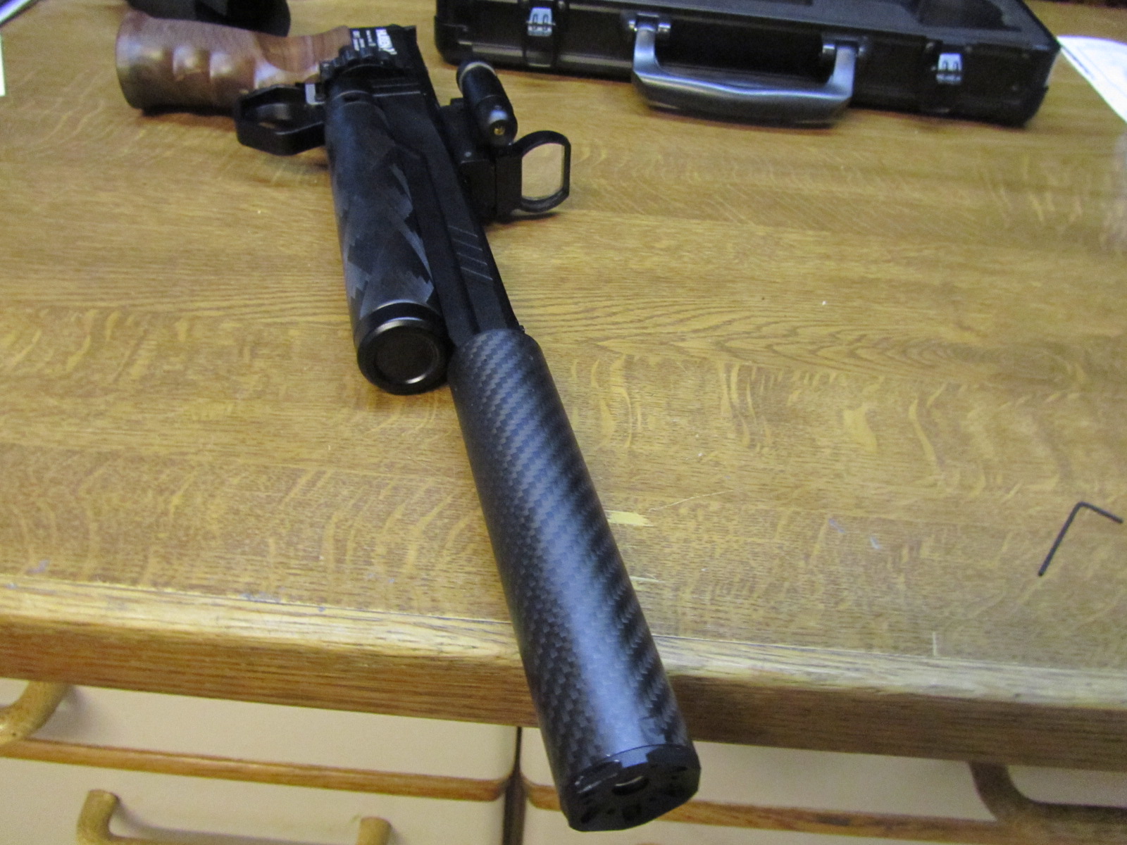

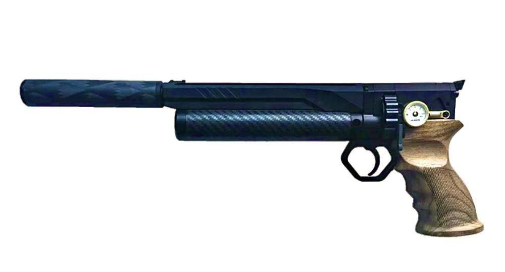

I notice a different carbon print on the EU airtubes.
Aren't the US models completely the opposite? The print on the silencer is on the airtube and vice versa.
