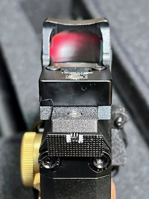

What Red Dot do you have mounted?
A not too cheap Ali express reflex sight with side mounted laser. I have bought 4 of these. They work very well. I have one with a laser that suffers an intermittent switch. As stated earlier, the lens center resides 49 mm above the barrel centerline. The laser resides 29 mm above and 25 mm to the right of the barrel centerline when mounted on the 11 mm shroud rail. These are important measurements. The lower these mount to the barrel, the better. The laser is particularly helpful for targets less than 20 feet away. It avoids estimating hold over distance.
One more point that I have stated before, but restate here again. These reflex sight's biggest advantage over other sight systems is field of view, lack of parallax and rapid target acquisition. The biggest drawback is the required intensity, which is dependent on ambient light. To compensate, there are 5 different intensity settings.

I have ok-ish experience with the RMR knockoffs from aliexpress and a bad experience with the SRO knockoffs - they don't hold zero even on an air rifle and have noticeable parallax.
I eventually ended up with 2 vector frenzys, which is the cheapest original red dot that I could find.
(this was for another air pistol)
You should qualify your experience better. What rifle, what sight (model), URL etc. Otherwise. your comment could bias less experienced members unjustifiably against all reflex sights, which might be judged as truly stupid. As a new member, I suggest that would not bode well for you.
I don't think I'm saying what you suggest I'm saying.
"Knockoff" means fake or airsoft version. "Original" means original - not pretending to be a different company's product, openly or covertly.
This original Trijicon SRO works. This airsoft/knockoff version from aliexpress doesn't work. The difference is 700 USD - this is the "SRO".
The "RMR" is another Trijicon product which is widely copied - the airsoft copies of which can work ok-ish, in my experience (links: original and airsoft/fake). But even though an RMR copy/knockoff/airsoft version has worked ok-ish for me, some of the time, I still prefer a cheap "original" Vector Frenzy red dot to it, because it is better and works better (there may be other places to get it).
An aliexpress knock-off RMR is what FLgunner says he has put on his pistol, but this approach only works ok-ish/some of the time in the specific case of knock-off RMRs and doesn't work in general with all knock-off red dots from aliexpress.
