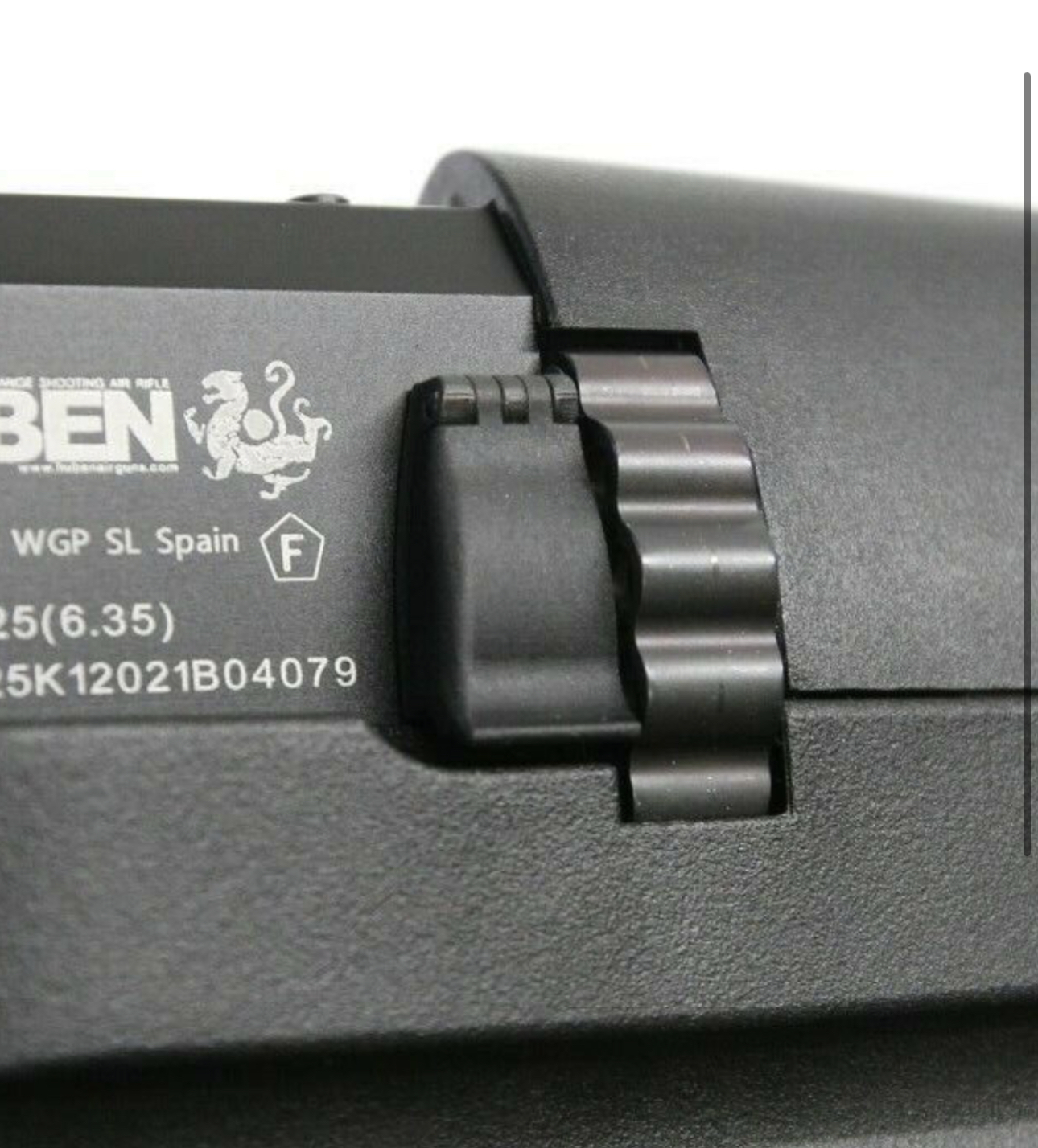

I like to hear this,....any chance you can post a picture of the stock loading gate ? even a video would be sweet.I would like to say that I really like the factory loading gate. I do not find it either difficult nor slow. I can only load one pellet at a time no matter how many holes are exposed to load. I can only hold one pellet at a time between my thumb and first finger. The issue for me was to develop the rhythm loading and then advancing the mag. Once I got that down, I think I am now as fast as anyone with the aftermarket gates........jus saying!!
I can also say that I have had a lot of practice. This thing eats ammo.
By "not working" I don't mean that you occasionaly don't see a red dot, in the case of the super cheap red dots.One more point to your statement. The low cost of things sold on AliExpress does come with the risk that not all work well all the time. Quality is not necessarily consistent from one to the next identical item. Failures do occasionally occur. Forget about getting a replacement, just order another one. These are usually cheap enough and then you have spare parts. I have been generally lucky, but occasionally, I have had issues like the intermittent switch on the side mounted laser. However the design and function of these are as good as others costing much, much more.
I don't do videos, but you will get your chance to practice when you get yours. As fast as you will consume pellets, you will get pretty fast at loading it.. It basically is 3 motions. 1) With pellet between your thumb and fore finger present the pellet at a 45 degree angle to the mag chamber so that the edge of the pellet crown is just below the lip of the hole, then press down and in. The pellet will depress the plastic lip on the gate and travel about half way home. 2) With the finger nail of your thumb, depress the pellet skirt home. You will hear a reassuring click as the pellet skirt clears the gate lip. 3) Reach up with your thumb and advance the mag one click. With practice this becomes one smooth motion. The largest time consuming issue is orienting the next pellet in your thumb and fore finger from the pellet tin.I like to hear this,....any chance you can post a picture of the stock loading gate ? even a video would be sweet.

And between (2) and (3), you can push the skirt of the pellet with a golf tee until you hear/feel another click as it seats in the magazine rifling.I don't do videos, but you will get your chance to practice when you get yours. As fast as you will consume pellets, you will get pretty fast at loading it.. It basically is 3 motions. 1) With pellet between your thumb and fore finger present the pellet at a 45 degree angle to the mag chamber so that the edge of the pellet crown is just below the lip of the hole, then press down and in. The pellet will depress the plastic lip on the gate and travel about half way home. 2) With the finger nail of your thumb, depress the pellet skirt home. You will hear a reassuring click as the pellet skirt clears the gate lip. 3) Reach up with your thumb and advance the mag one click. With practice this becomes one smooth motion. The largest time consuming issue is orienting the next pellet in your thumb and fore finger from the pellet tin.

Yeah the .25 I tested had the aftermarket gate,...never seen the factory in action so I was curious.
and yes the looks of the aftermarket gate isn't all that pleasing to the eye.

I have one of those; it just broke at the hinge. I am not using one now and have no issues at all. My pellets are snug. But I did order another from MOistone.This one (from ebay) looks good, not sure if it’s actual ‘3D printing’, maybe it’s molded or something..
