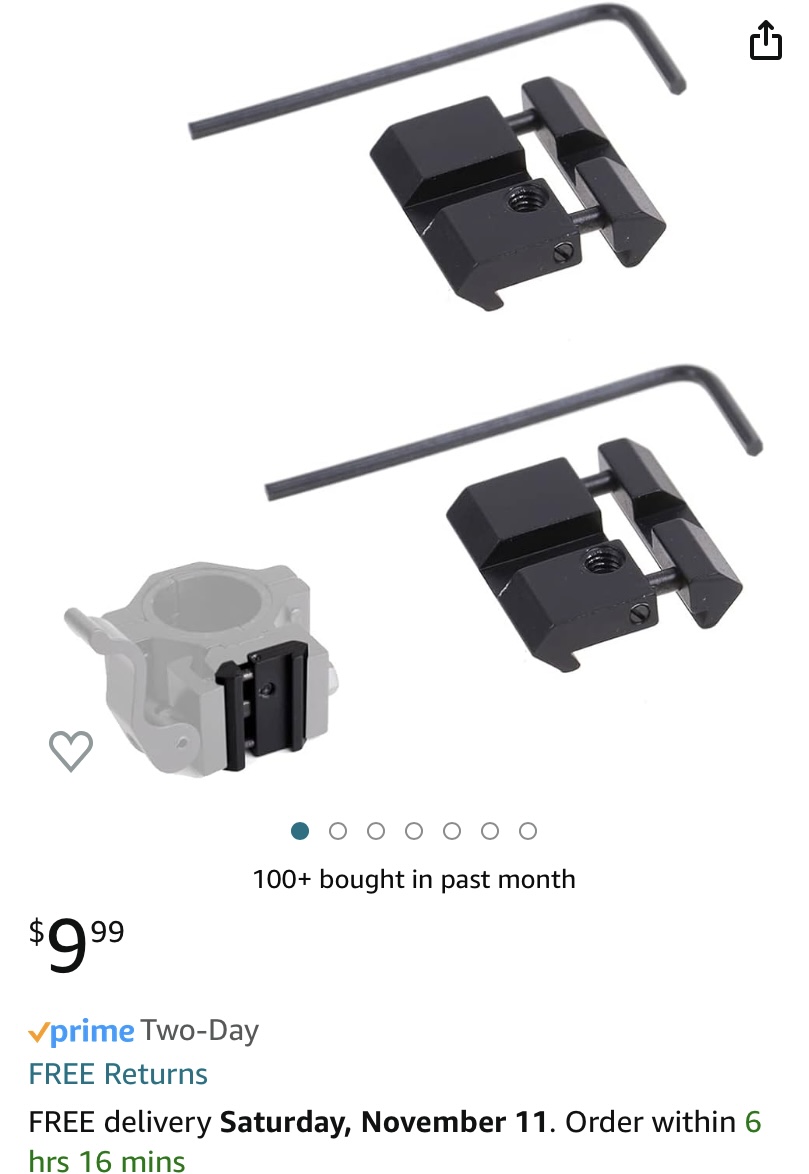

I've been following your posts on the .25 cal GK1 - I was looking for a reflex sight with a laser that will work directly on the 11mm rail. Amazon didn't seem to have anything like that. Can you post a link to the AliExpress model that you have? Thanks!
Maybe?
I used these on my 22 pistol, they’re inexpensive and work great with a pic base.
