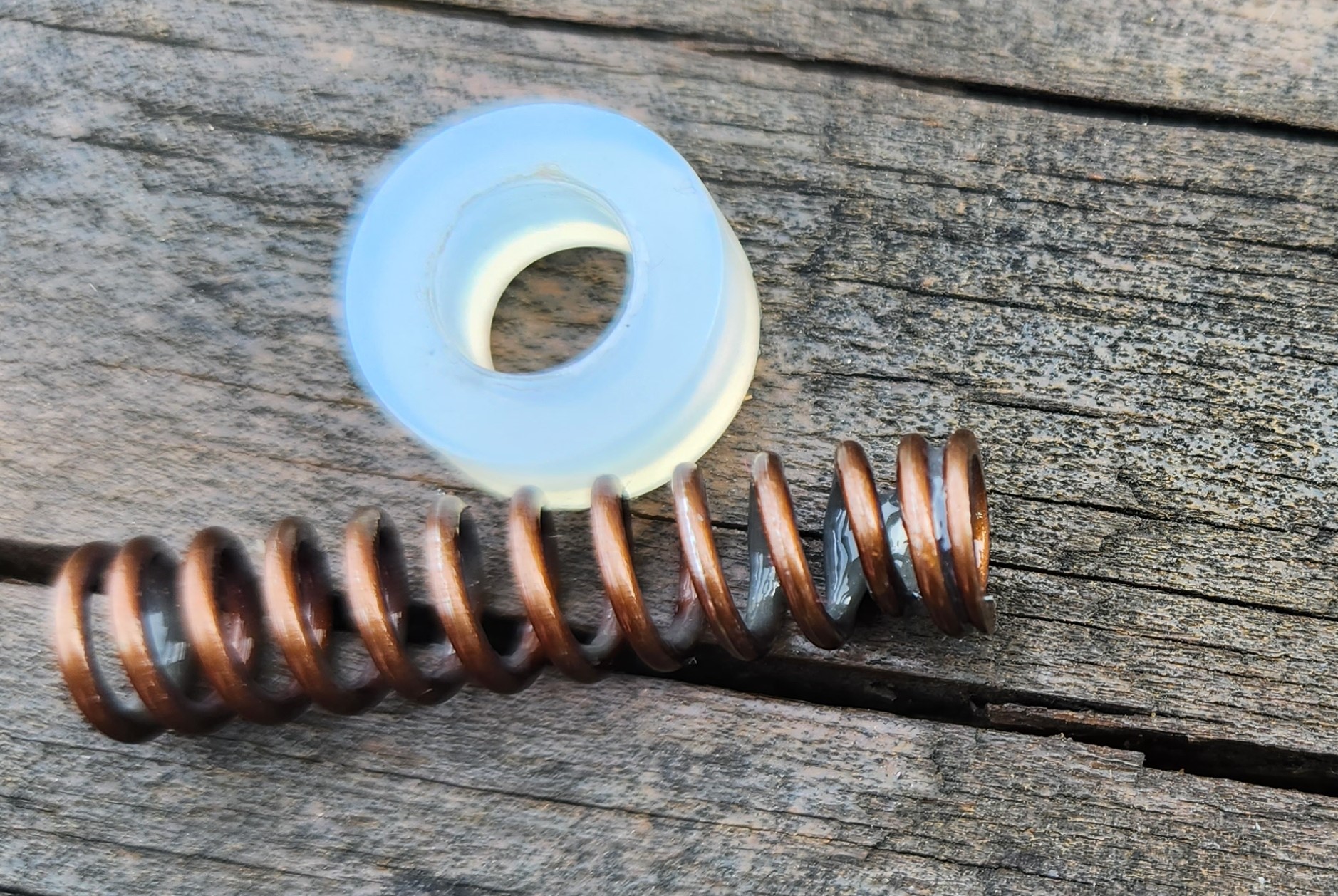

At 250 pellets I checked & new spring & buffer looked good. maybe another 200 or so since, now spring is starting to kink, where it was in the buffer. The plastic buffer/guide was not tight when I put it on. I am putting back together now with a new spring and new buffer, that i reamed out a little with a drill bit. I am not or have I shot at excessively high ft pounds.

Thanks I've watched it. Now, what is this spring for exactly, and what can cause issues with it ?
The spring pushes the striker forward; closing the firing valve after a shot is taken. If the spring breaks during operation and it cannot close the firing valve, all of the air will be released.
As far as what causes issues: Shooting the pistol at its maximum will exacerbate the wear on the spring. I’m starting to believe that this spring is durable with pressures lower than 200 bar. The higher the pressure the faster the spring will fail. The reason I say lower than 200 bar is the huben bullpups are normally tuned for 140-200 bar and have never had as many problems with the striker spring. I’ve had the original striker spring for 4 years.

All right, that's clear thanks. Where can we get those exact springs, I think I want to buy some spare parts just in case? EDIT: Found out, striker spring on the official website. I'm wondering if it possible to replace it with a stronger one?
Sure it’s possible. It can be upgraded to a chrome vanadium spring

The spring in the back is 7.0mm OD, 1.0mm wire thickness, 30mm long; mine looks OK, so far. It might be replaceable by a 1.25mm wire thickness spring, but I'm not going to do it just yet, unless it breaks at some point. I'm not sure if I want to volunteer my pistol for this test just yet (and such a change change might turn out to be wrong for some other unknown reason).
The spring might also be catching on the edge of the hole in the metal part with the two screws. In which case increasing the inner diameter of the buffer would not help and might make things worse. If that's the case than the hole in the metal part might need a little bit of chamfer, but don't go chamfering metal parts just because I said it might.
