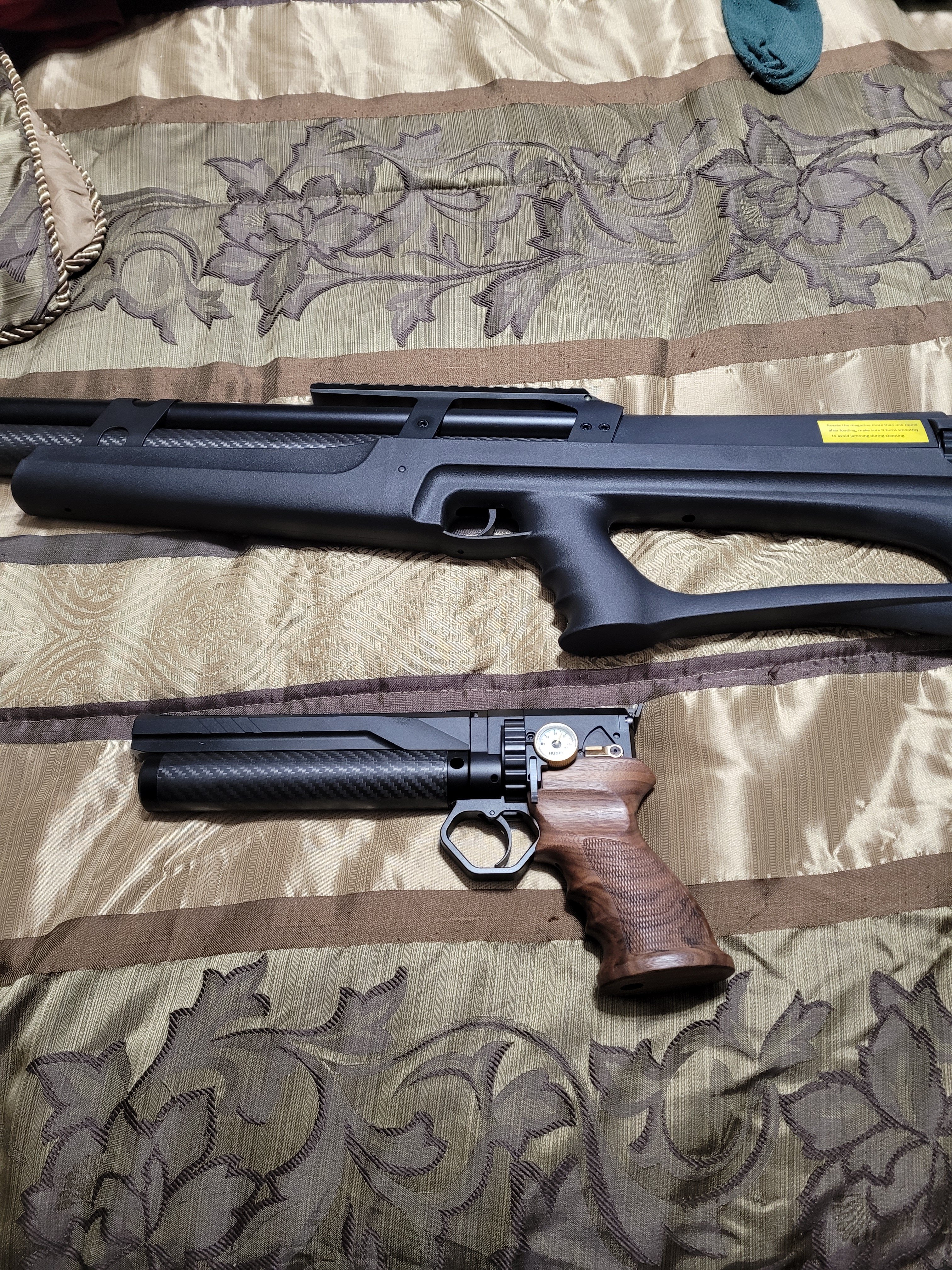

My finished baby.

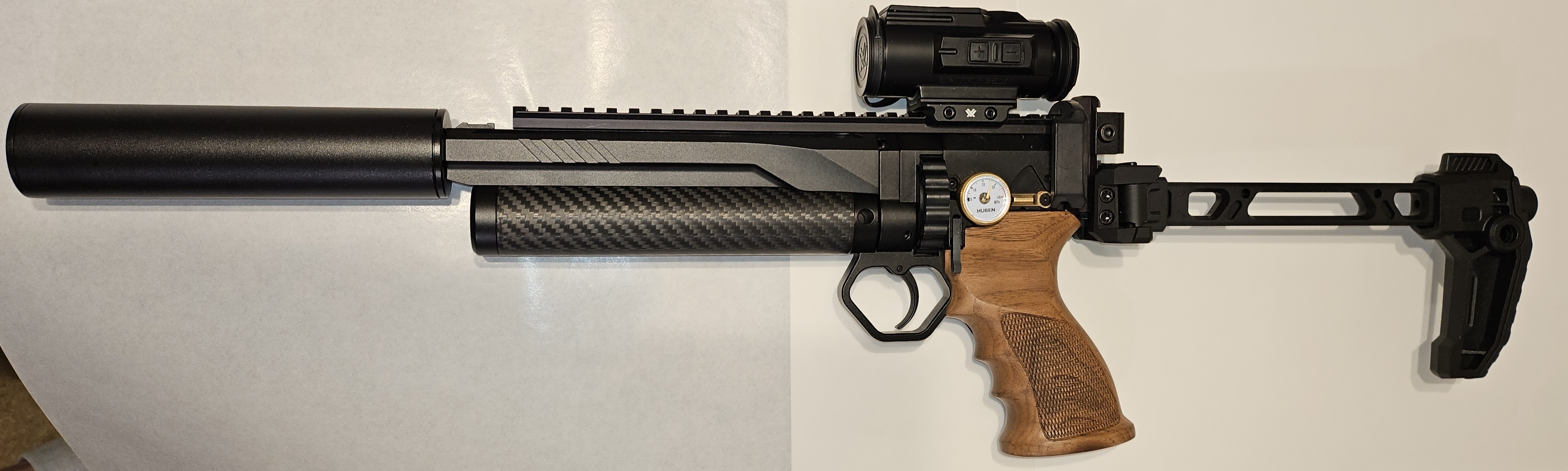

Although I would like to get my hands on an original immersive optics prism.
Looks great. The immersive optics may not be ideal with zero eye relief, wouldn't be able to shoot without stock.
I am still learning to shoot decent. I do have a monstrum pistol scope that works cool as rifle or pistol.
But I am also practicing locking arms together and using left elbow as rest for pistol, so prism still usable that method.
I need enough trigger time outside my apartment to decide which pistol method hunts better for me. But otherwise Carbine is my first choice. My p-rod as bullpup was soooo much more accurate for me.

I'm beginning to think that the grip is unnecessarily wide. It looks pretty, but a 1911-shaped grip might be more ergonomic.
I though the same and was planning to do so reshaping but after testing the pistol I found the grip very comfortable,...still going to do some reshaping but not as much as I was planning
