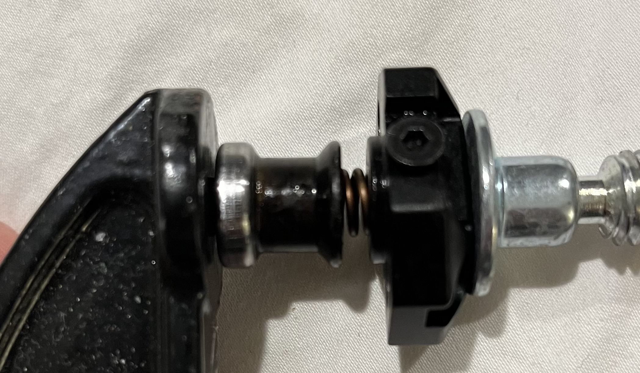

You have not listed the minimum length (stacked) and that is important.12.5 coils
1.2” length relaxed
.275” od
.039” wire diameter

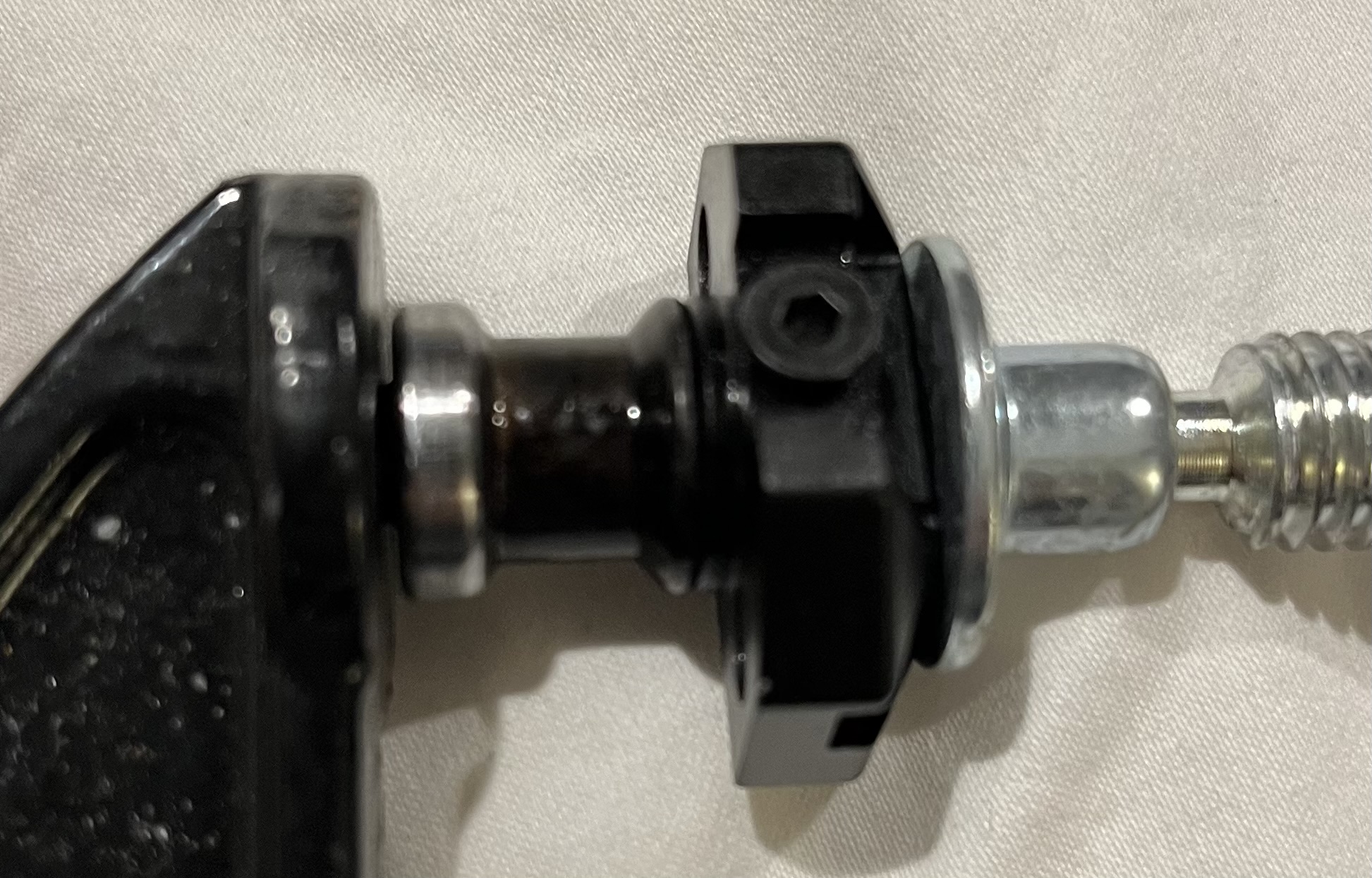

I suggest you do not understand the issue. Of course there is room to compress. It is the pin travel that is excessive causing the spring to stack. That is what is causing the spring damage.I’ll have to correct my assumption on coil being stacked/bound. Even without a buffer, there is room for the spring to fully collapse. View attachment 409745View attachment 409744
At this point, I would be considering an internal guide from the back. The front has some degree of external support.
An internal guide could be made tophat style and fit into the cover. I will try to get some measurements later for this.
Dave
You will need to explain what pin you are referring to. In my picture above, the spring is compressed between the striker and plate cover. This is without the rubber buffer present (which would allow even more room).I suggest you do not understand the issue. Of course there is room to compress. It is the pin travel that is excessive causing the spring to stack. That is what is causing the spring damage.
