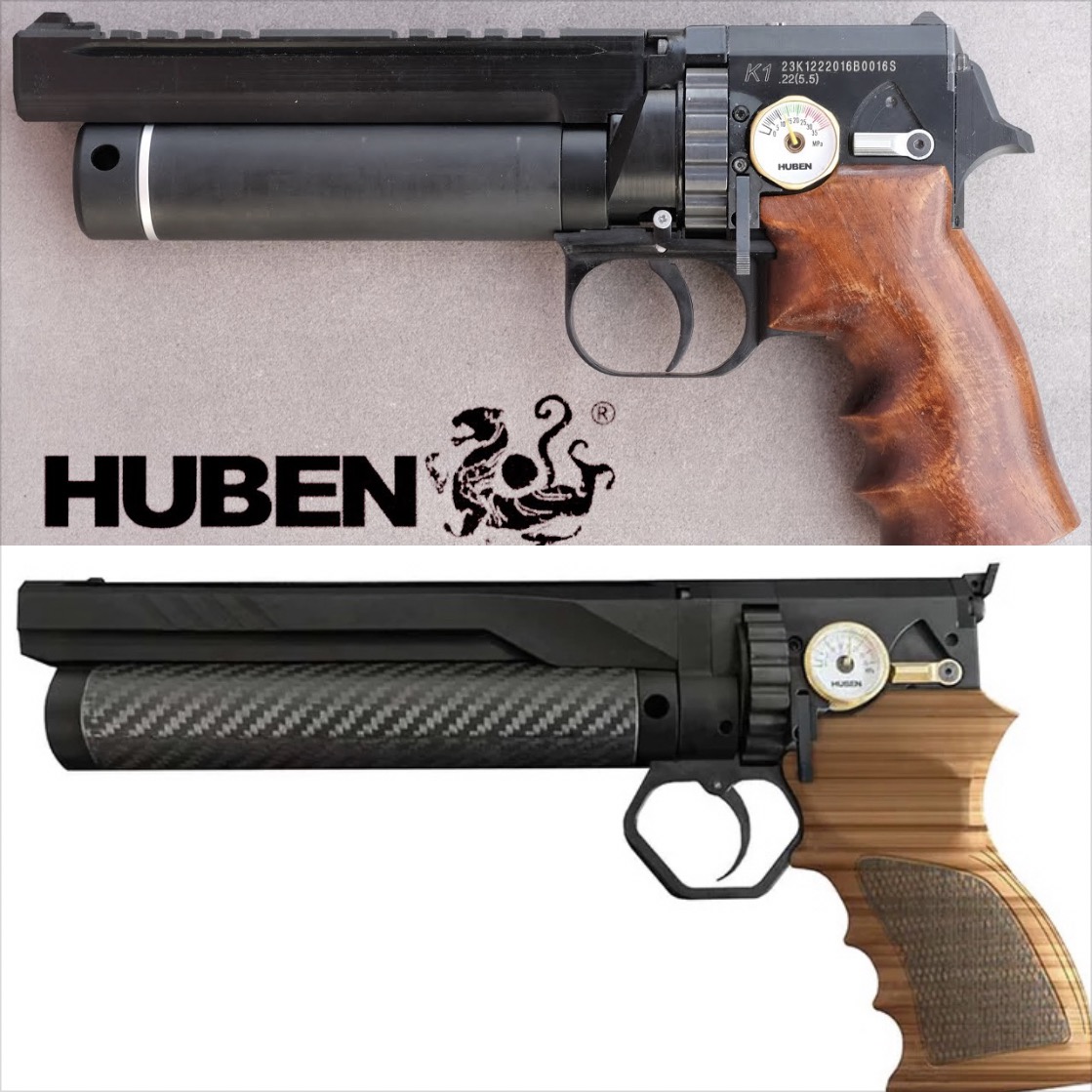

I like the look of Gregor’s pistol over the production version. From the trigger guard, shroud with pic rail, to the small piece in the back of the pistol that adds style and makes for a better grip. The only things that are better about the production pistol are the longer air tube, better sights, and a more refined grip.
I like the Huben design. The angles on trigger guard work with the angles on the shroud.

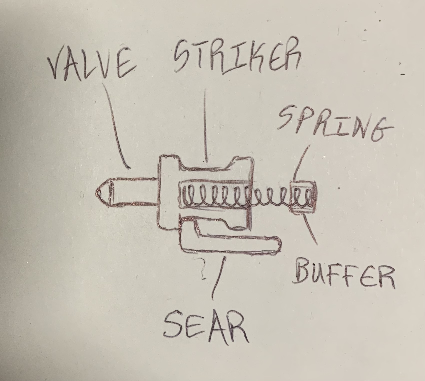

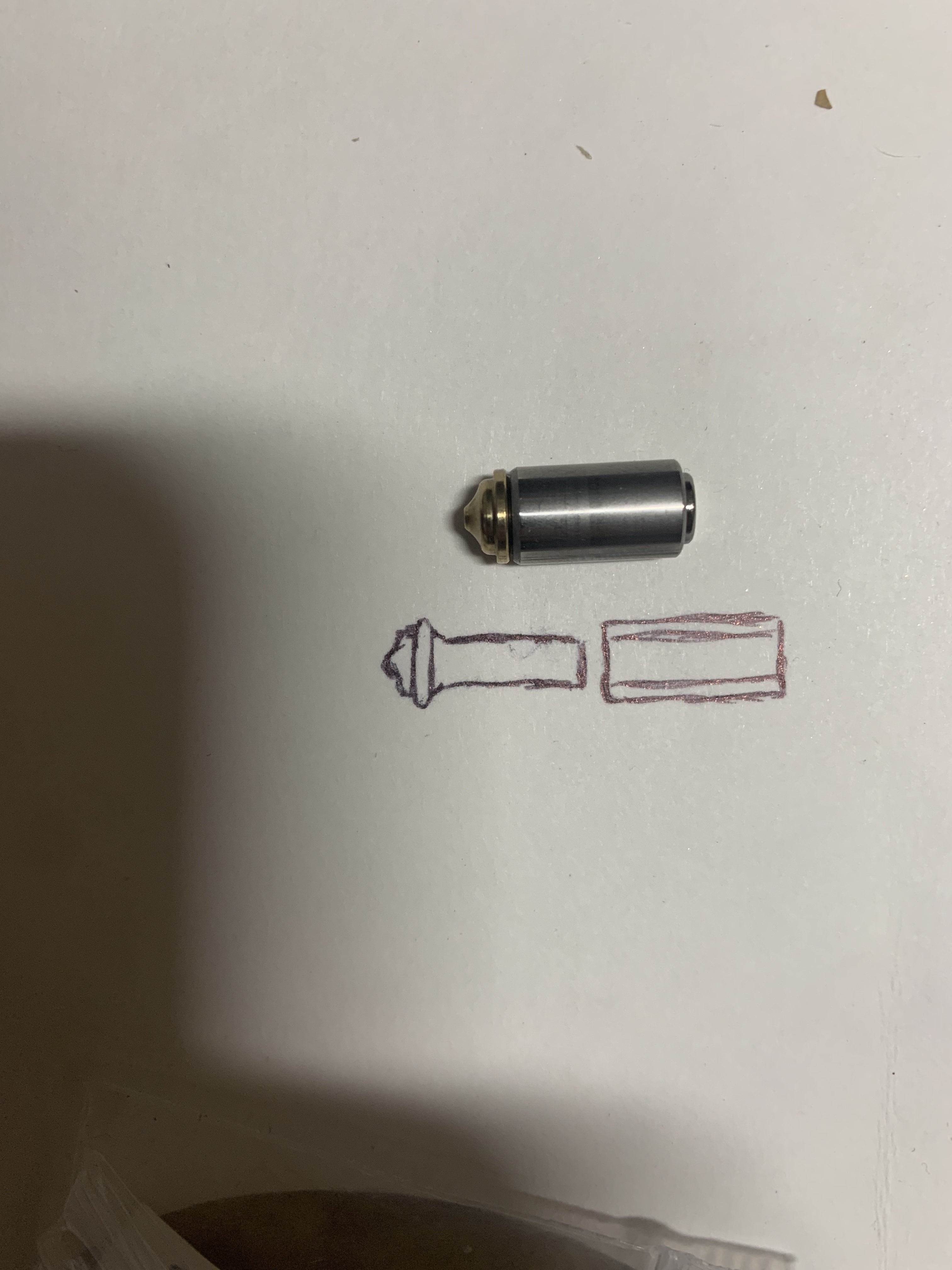

The striker spring returns the striker so that the firing valve stays closed. The striker is held in place by a sear. When you pull the trigger the sear drops and the firing valve opens, pushing the striker back. The striker compresses the spring and the spring returns the striker.
The firing valve is comprised of two parts that when pressurized want to split apart to release the air. The striker along with the sear hold this valve closed.
