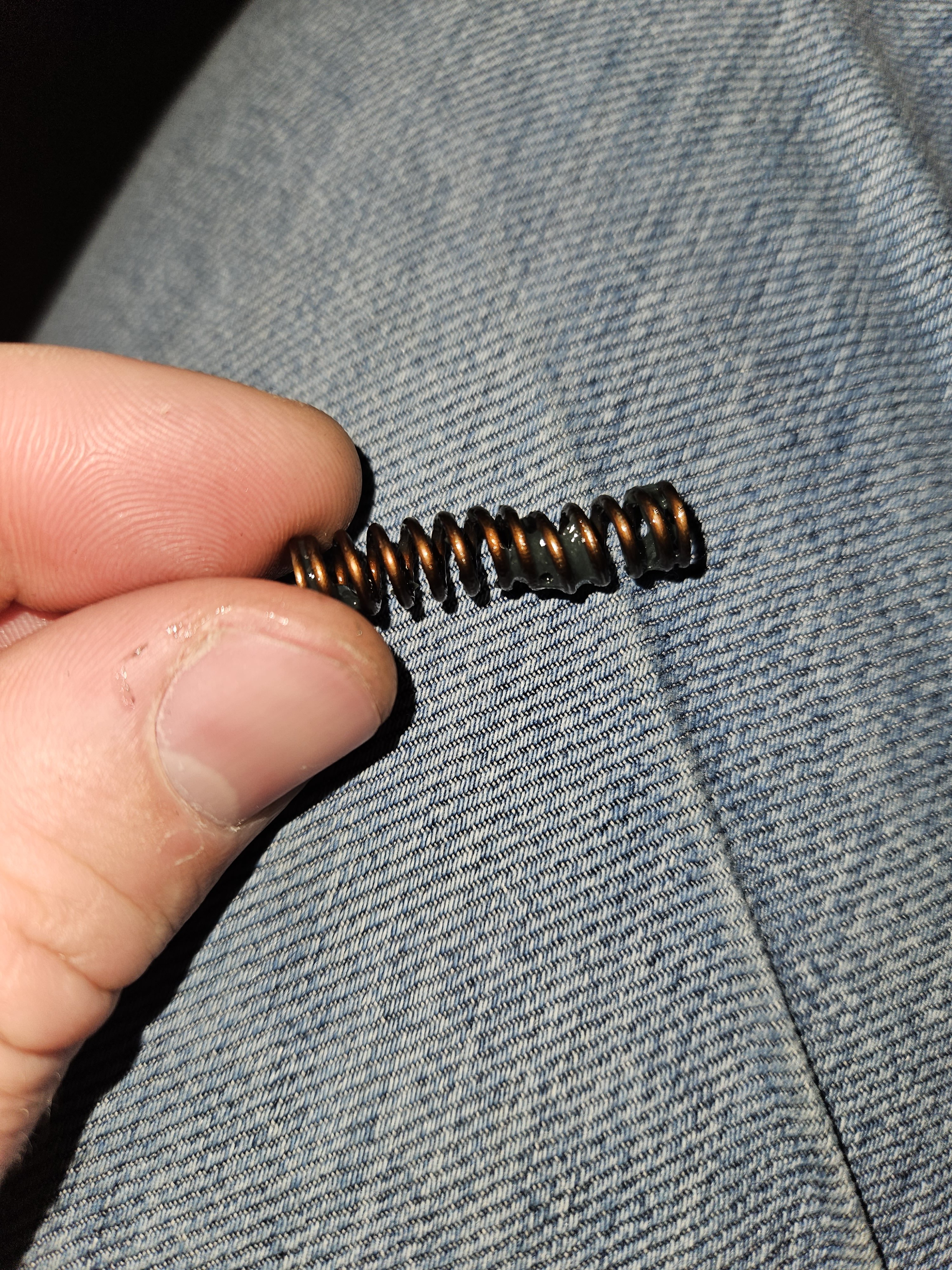

I shoot JTS 21 grain pellets in mine 2000 + pellets so far, fit snug, seat them, tight groups at 40, not one jam or pellet moving. I only hunt tree squirrels and at 850 fps with a 21-grain pellet is going to pass thru. Kills groundhogs too. There is nothing I do or am trying to do that I need a slug for or the trial & error that seems goes with it. That is why I call it my pellet pistol. :)
After reading this thread I was expecting it, but hoped I would get lucky. Nope, ran into the spring issue. Will be turning down the power. I'll keep an eye on this thread to see if anyone comes up with a solution. At least they're easy to change and it came with a spare. I was doing around 80 FPE. I'll see if I can get away with 60 FPE
