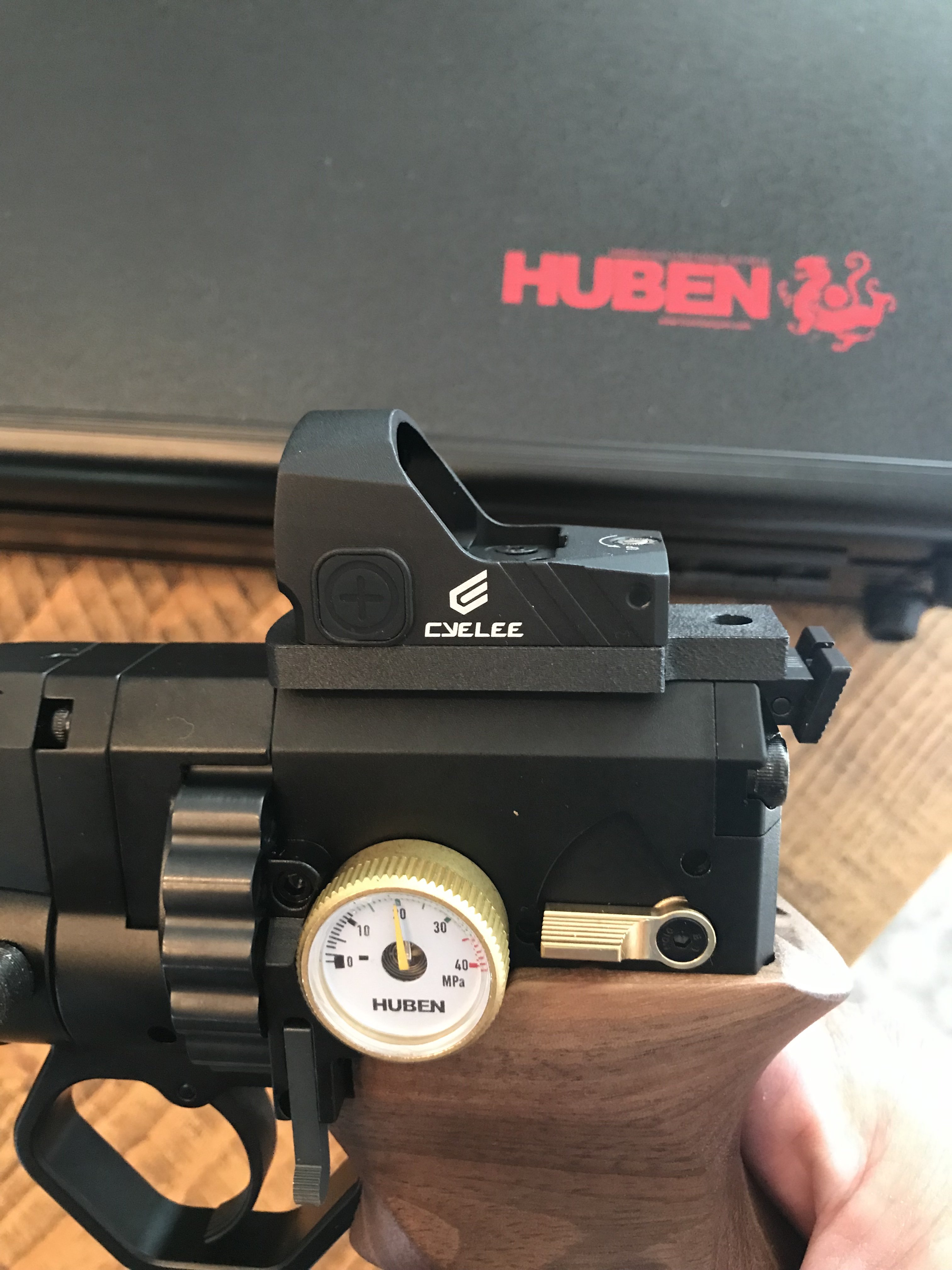

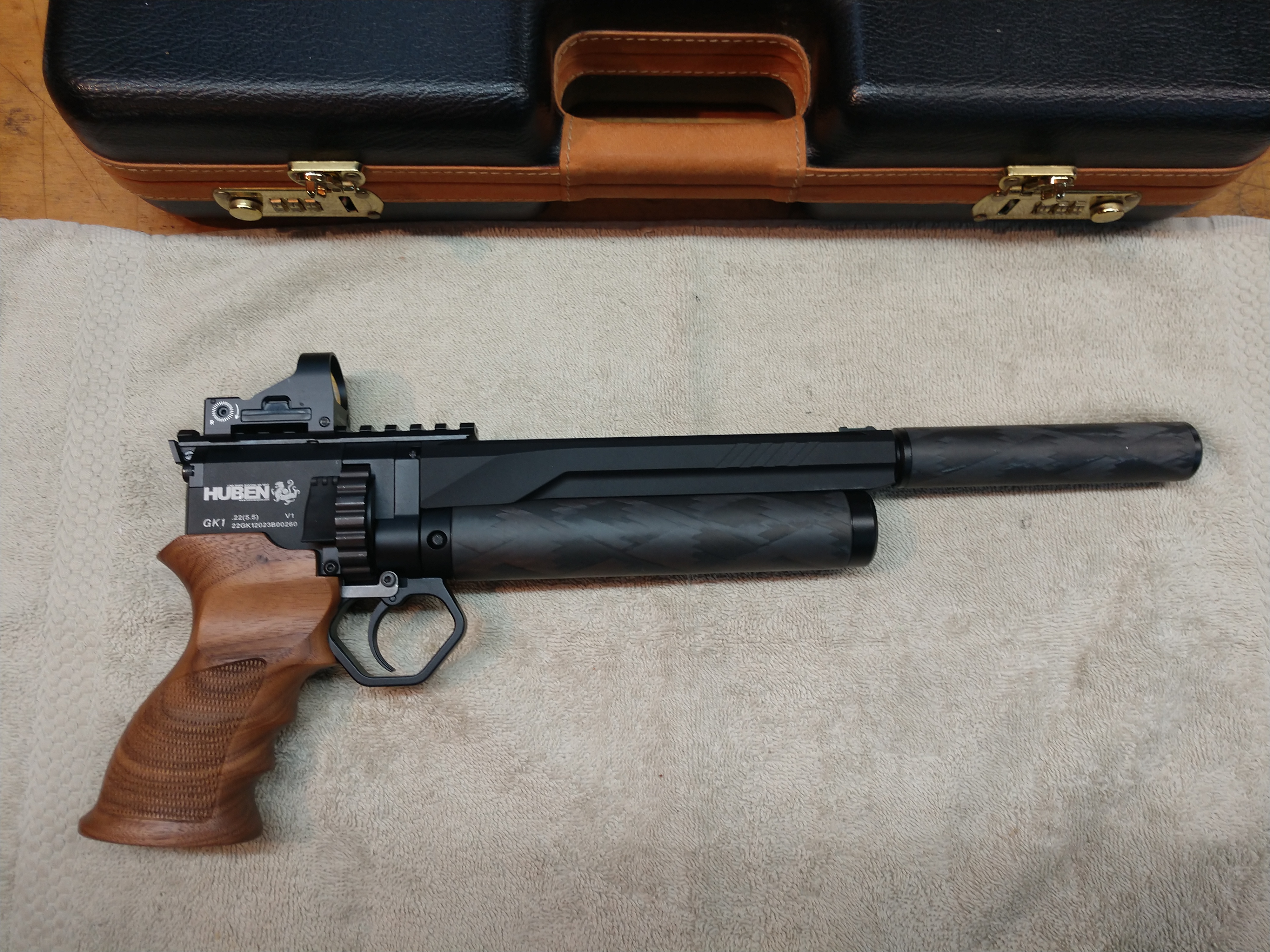

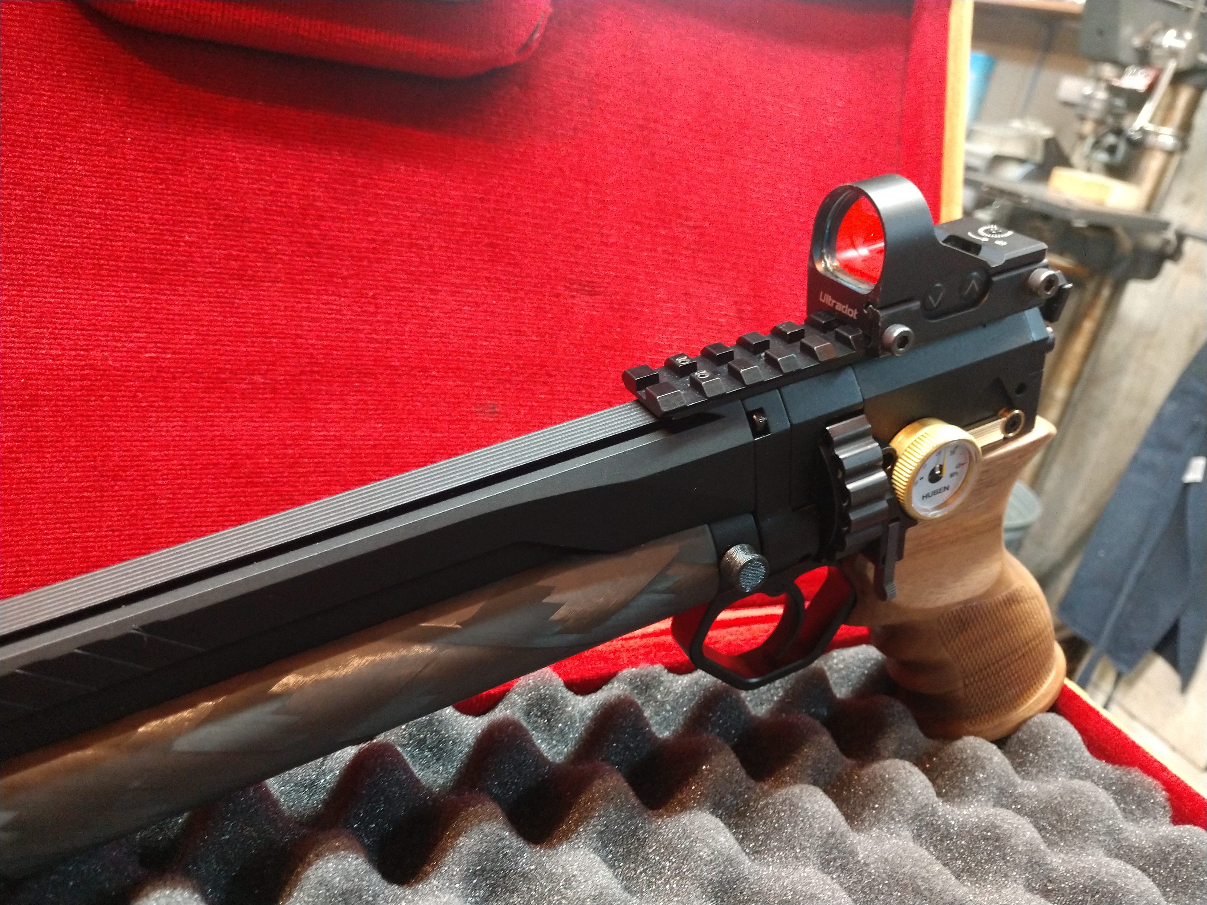

I finally have my red dot mounted on my new GK1.
I was debating what mounting method to use, and have read all the possibilities posted here.
As I've stated before, I'm not a fan of the aesthetics of printed accessories. I know they can be totally functional, just prefer metal. (Working on a metal dust probe plug to replace that printed one).
So I went with the anodized aluminum rail, mounted using the rear sight location, and the little grub screw location that's a couple inches forward from rear.
Also added a recessed QC swivel cup on the bottom of grip for single point sling carry, for my plinking woods walks.
I install these cups often on the bottom of the forearm on my rifles. Much better that a forward mounted sling swivel stud, which can interfere with forehand placement imo.
Haven't had this much fun with a new gun since I got the Leshy 2 a couple years ago. A few pics....
Note: the swivel cannot touch the wood surface no matter how you swivel it, keeping the wood pristine. Love those cups!

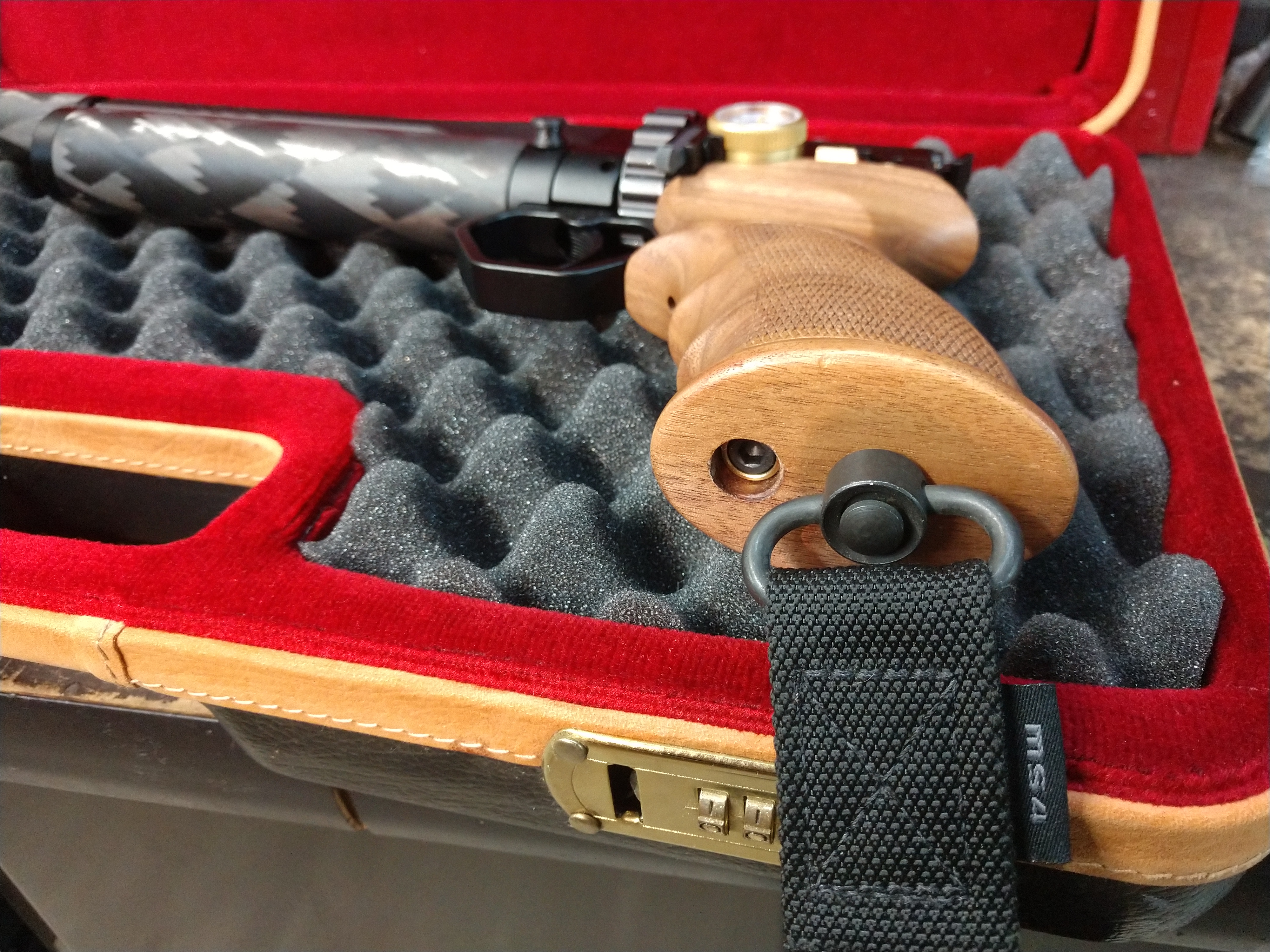

View attachment 422097View attachment 422100View attachment 422101View attachment 422102

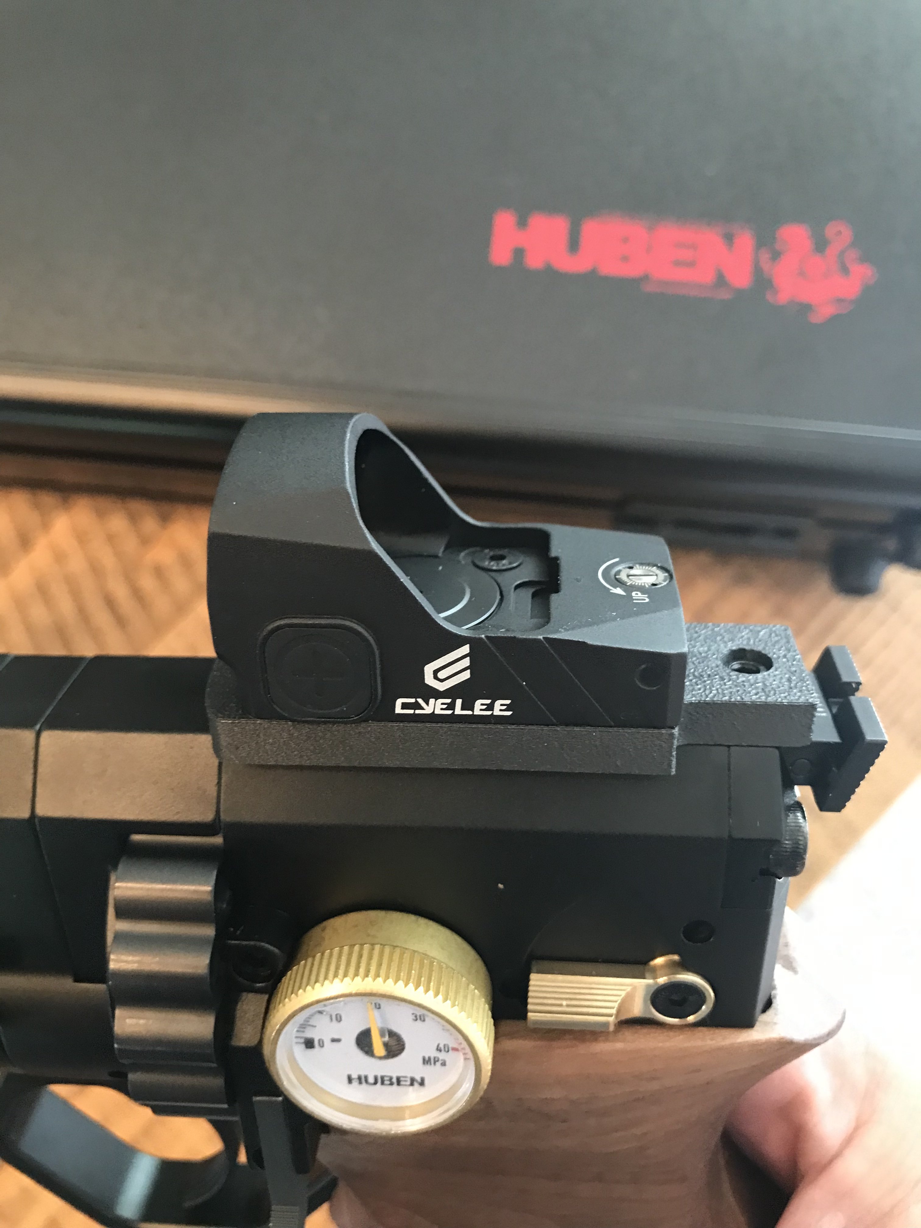

Nice!I just installed the new V2 mount from moistone this morning.I like it much better than the V1 i have,just cleaner and more concise imo.Going out right now to zero the reflex sight👍🏼1522A461-CE7E-49AD-ABF0-4A0C0B06E4E0.jpeg2D2D85C6-0182-4A9A-90EF-C901564D94EF.jpegEDABCA20-4C17-41C6-9EA8-B0B16079C2A2.jpeg
I was stumped yesterday trying to adjust my reflex sight for my new moderator. and the sight was not responding to my sight changes. Perhaps I'm just stupid, but I knew something was amiss so I decided to completely disassemble the sight. In doing so, I discovered a very little set screw underneath accessible though a very small hole on the left side. This screw clamps the sight adjustments and prevents them changing. Beware!

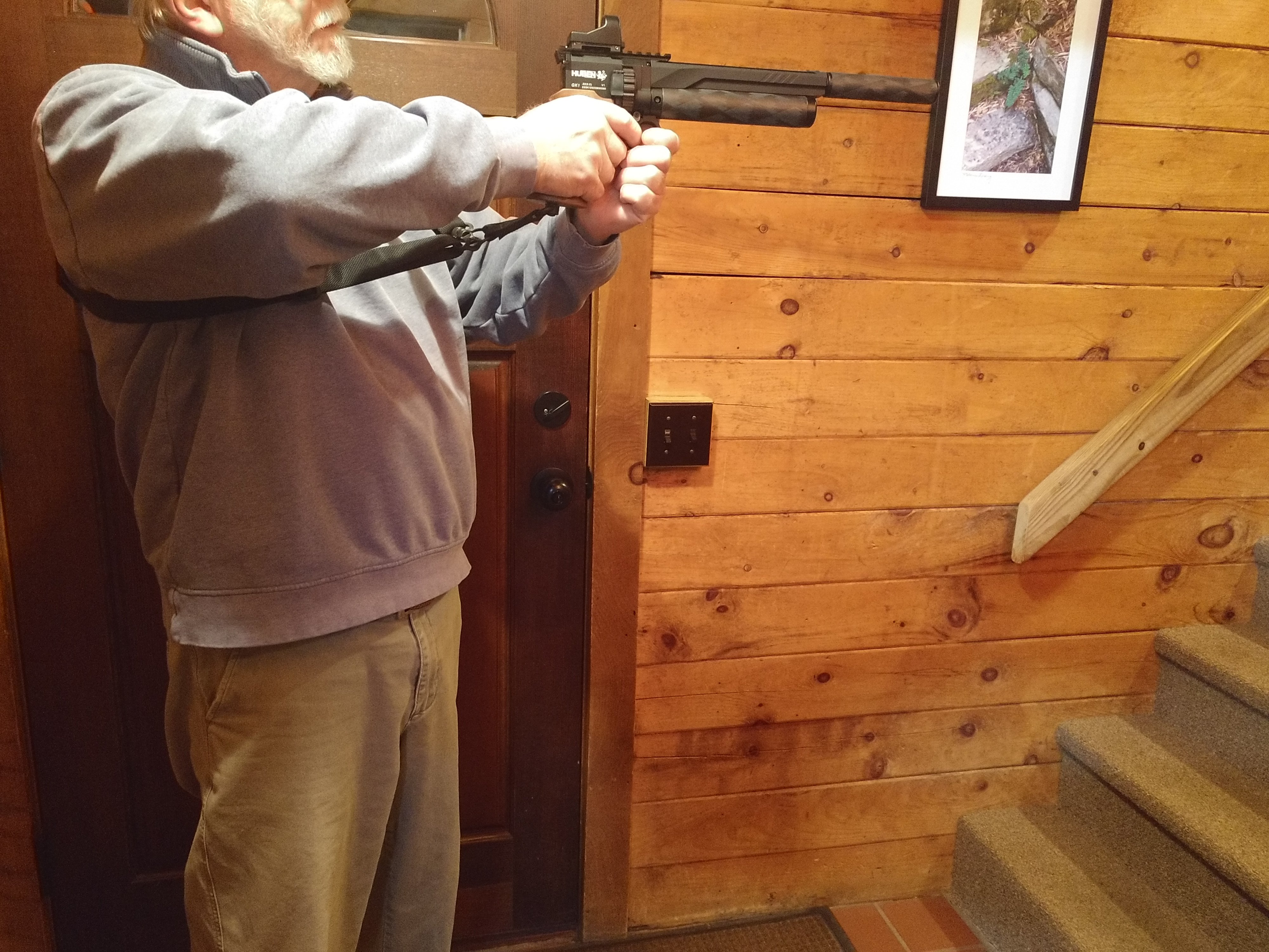

where did you get the recessed swivel cup? Can you post a picture of how you wear that when walking around with the pistol?
Reactions: Sergey1972

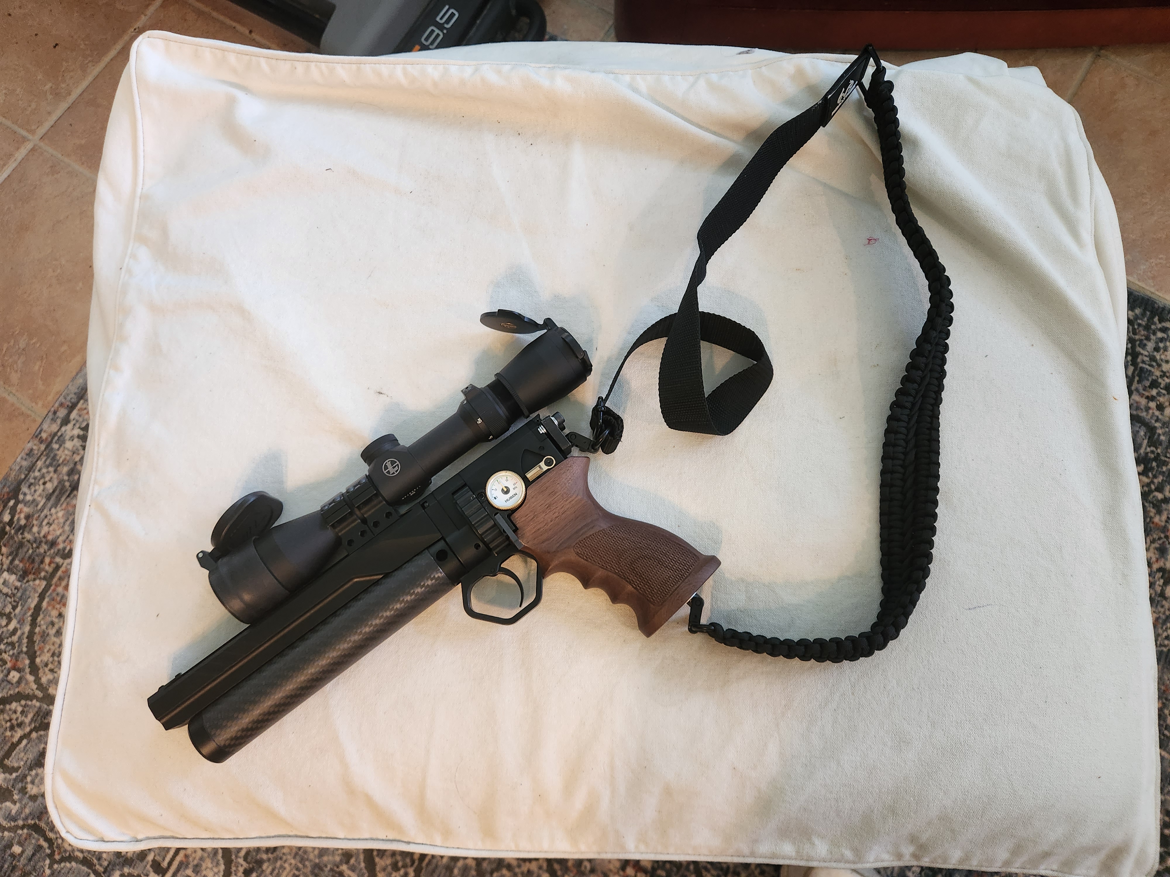

Any of the PB shops have them. Look for sling swivel studs, cups. and QC push button sling swivels.
I often use MidwayUSA.

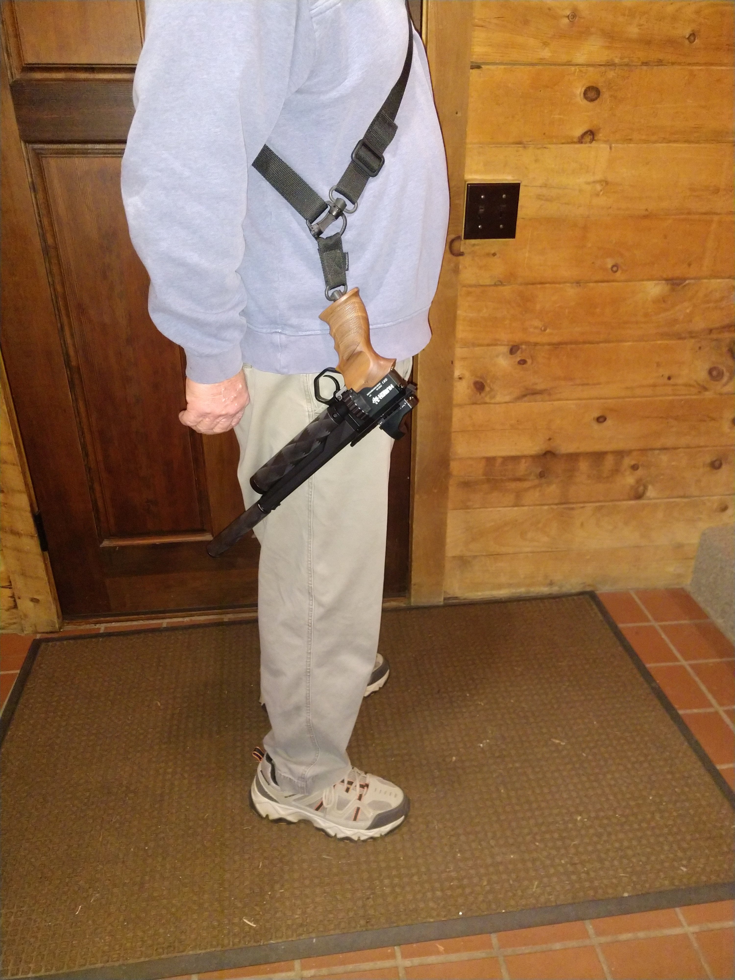

I like the single point sling but especially because you can swing the pistol up to shoot, without disconnecting anything.
And it only takes 2 seconds to plug in or out, yet very secure.
A couple pics
A couple pics

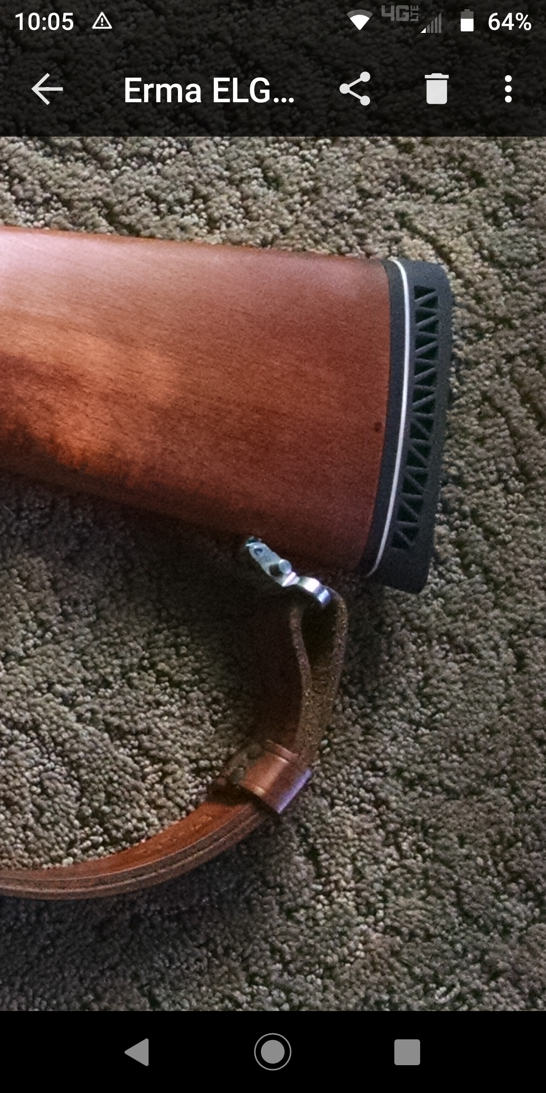

Nice. I did something similar but used two points.
I like how the raised sling studs are easier to install, but It looks like your application on the bottom of the grip, will allow the metal swivel to make contact with the wood, which could scratch or dent it.

I used a threaded insert so I could switch back & forth to mount a stock, or I would have used those Magpul cups. I do have those Magpul cups & swivels on some of my guns.

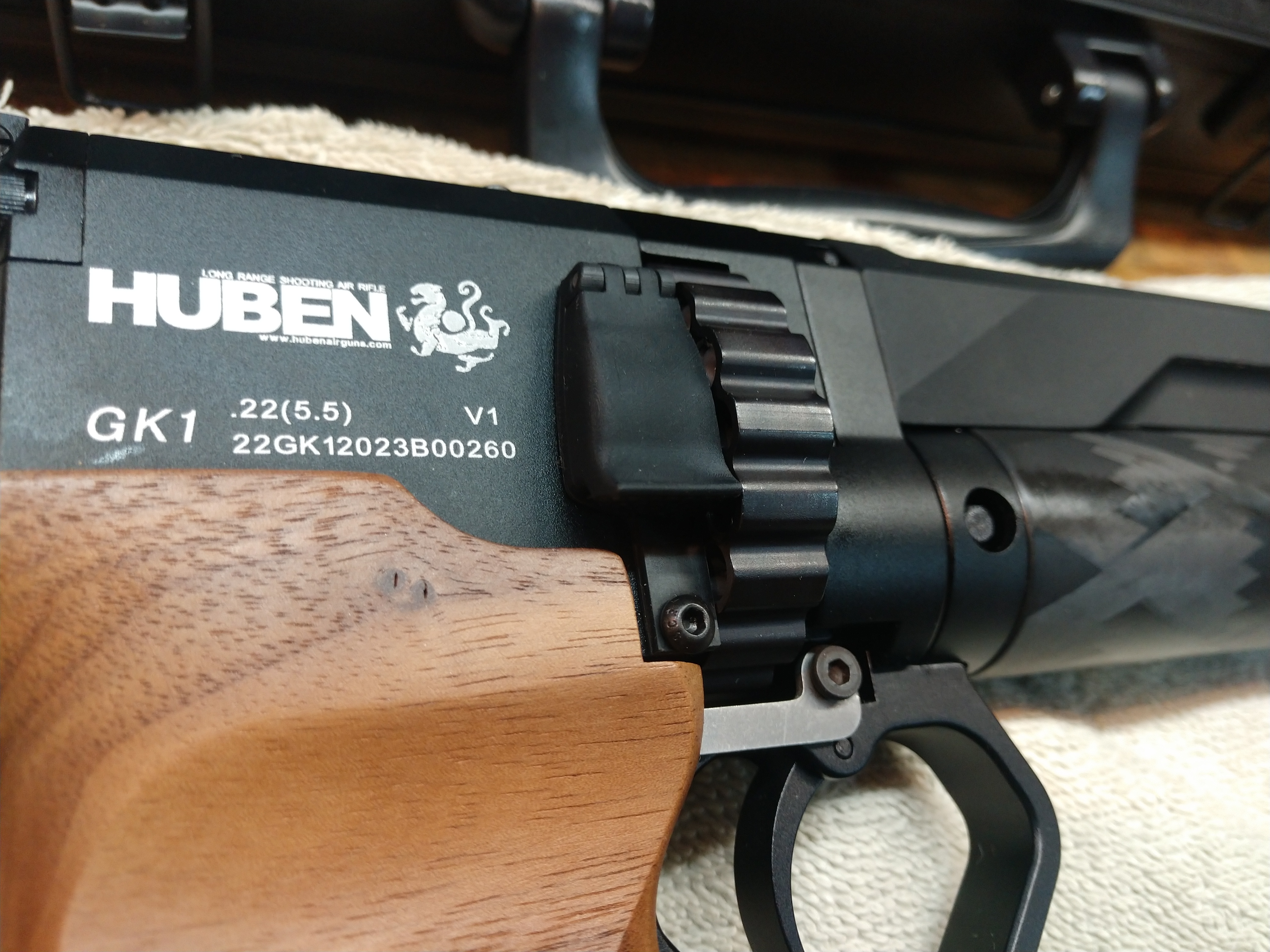

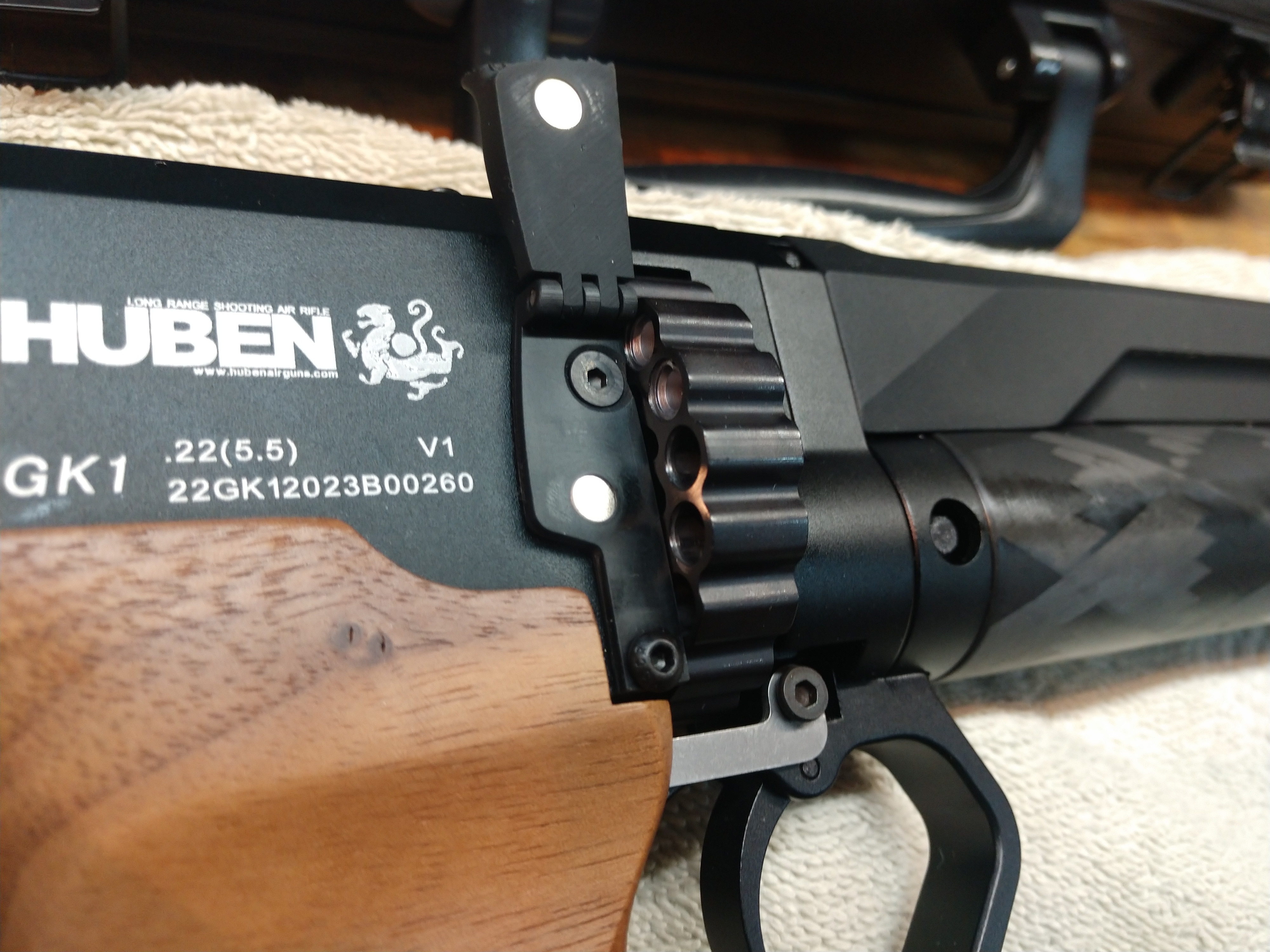

I received the PAS loading gate cover today. Very nice piece. It's injection molded, not 3d printed. Very smooth and professional looking. Much nicer than the printed models i've seen, IMO.
Here are a couple pics
I just installed my injection molded (airguntactical) loading gate and I love it, also for anyone who’s wondering. (At least with mine) the magnets are slightly recessed to prevent them from smacking into each other and cracking. Anyone who’s played with magnets a lot, will know what I’m talking about. Also as much as I’d love to have an aluminum one I absolutely hate having the ares logo on it. Imo I feel like it ruins the aesthetic, I sent him a message asking if he plans on releasing another in just flat black with no logo.
Also very cool sling ideas! It doesn’t go swaying around considerably while walking?

I used a threaded insert so I could switch back & forth to mount a stock, or I would have used those Magpul cups. I do have those Magpul cups & swivels on some of my guns.View attachment 422970
Gotcha, that makes sense. However, If you wanted to avoid having the metal touch the wood, you could just install your sling directly into a QC swivel, then only your sling fabric could ever make contact with the wood, no matter which side the swivel swings to.
I hope this pic, on a rifle stud, will help explain what I mean.
Have fun!
Have fun!View attachment 422984
