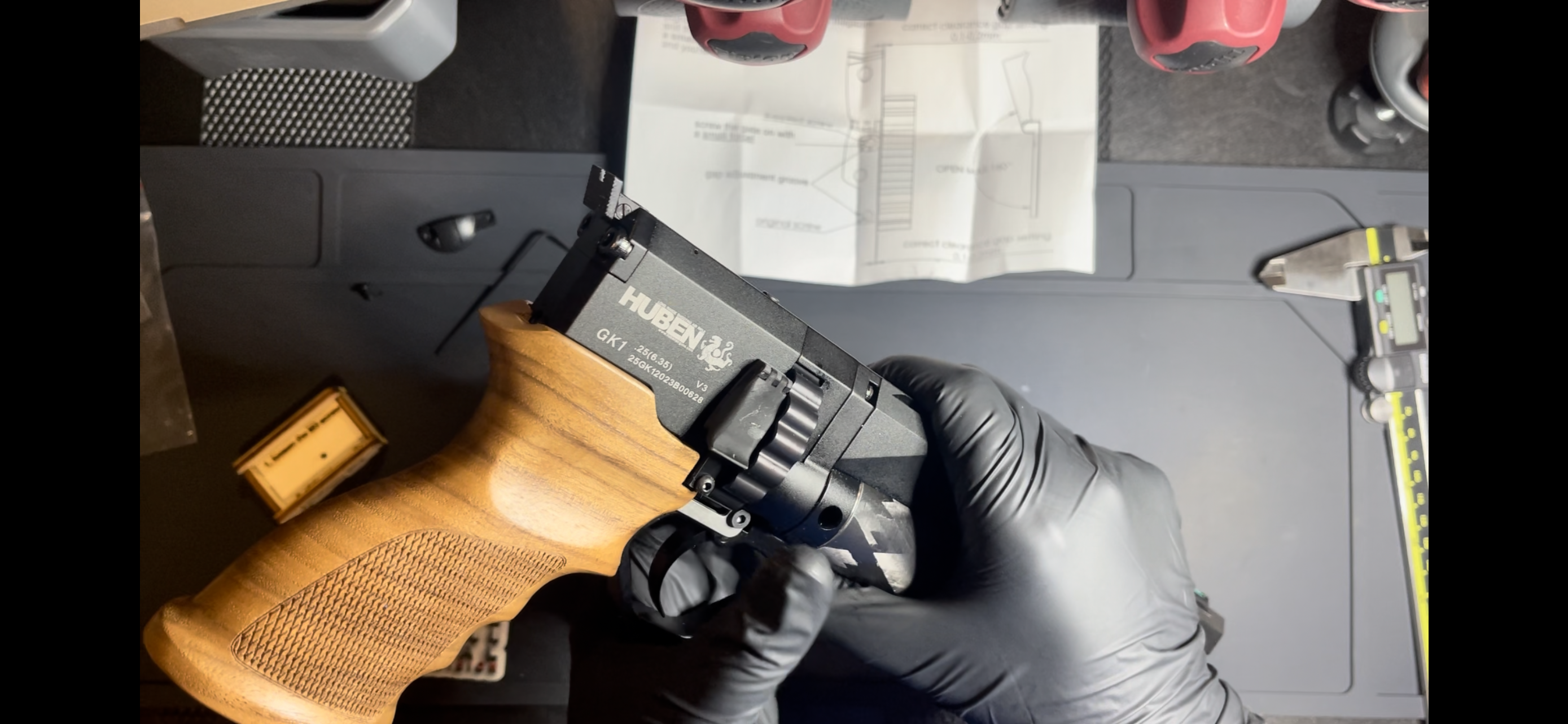

Looks clean - I have been considering switching to ASA and acetone smoothing for the loading gate. Looks like the base still occludes that left-most (top) port slightly?
Looks like the eBay one--wonder if he sold ares the design.
So my initial thoughts here for everyone who is wondering…The Ares aluminum gate is very aesthetically pleasing really compliments the GK-1 but…to be perfectly honest here the hinge on it is VERY loose and if you dont keep it parallel to the ground while loading it slams shut on you.So in terms of aesthetics great but in terms of functionality i am disappointed if i’m being honest…something to consider anyway
I have bought two loading gates so far for my GK1. Both of them were 3d; the first one had a very snug hinge and did not last too long; it broke very near the hinge. I think the hinge was too snug; thin at the hinge & would be easy to break if the hinge is too snug. (IMO). The second one is a Moistone product and is working fine; the hinge on it is not as snug as the first one & this keeps the strain off the part. I have another GK1 on order, I will get another Moistone.
Yeah i think i will be putting the moistone back on as the functionality of it is most important to me.I really wanted to love the aluminum one but when im out there hunting iguanas i need to be able to load the GK-1 from slight angles without the flap slamming shut on me….

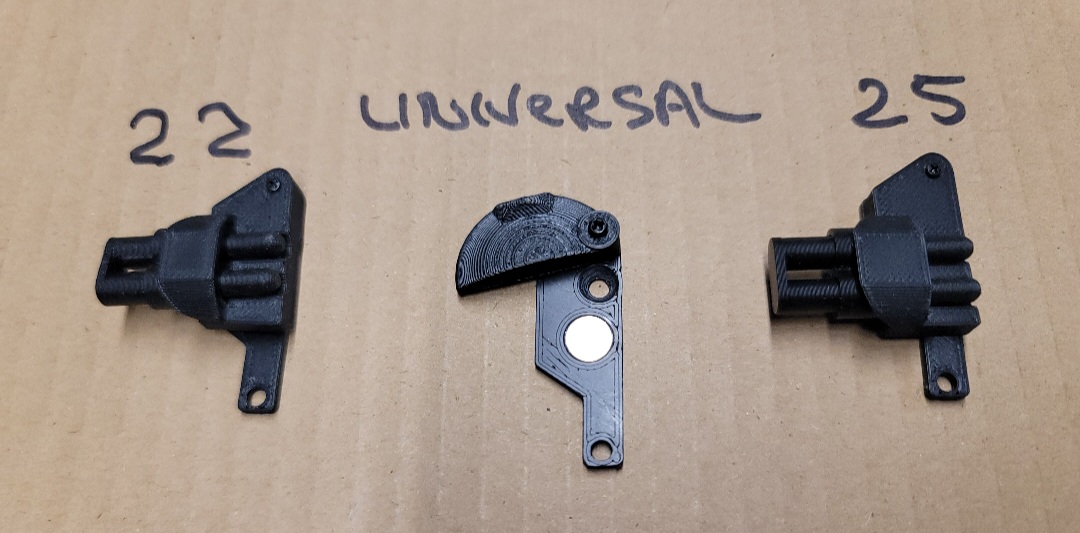

I don't have a GK1(yet) but just received an Ares aluminum gate for my. 22 K1. It's hinge has enough drag that it doesn't swing freely. Looks very nice.
I also ordered the one on the left + a universal door from Jake. I'll tell y'all what I think when it arrives.

Well, I received my aluminum speed loader gate yesterday from Ares with much anticipation. I love the look and finish very much, but I must report that I'm disappointed with a couple of things.
The hinge joint is very loose when open, as mentioned by a member earlier in this thread. I removed the pin and knurled it a little which helped quite a bit.
But the main issue I've experienced is that the gate is not long enough, and does not cover all three magazine holes completely. The third hole on the bottom of the mag is exposed enough to allow the pellet to move back exposing the skirt. The skirt then hits the frame as the mag rotates bending it, or potentially causing a jam.This happened to me several times within two mags, especially if the gun is pointed a little upwards.
So, sadly I asked Zach if I could return it for a refund. He responded quickly and was very cooperative. He issued a refund and told me to keep it. He also suggested that I shouldn't use light pellets, and that I should seat them to avoid this issue.
I shared with him that I respectfully don't agree with his advice about pellet type, and am confident a slightly longer design, (just like the injection molded one I have), would solve that issue completely.
And maybe some tighter tolerances on the hinge joint would help eliminate the slop, but I know that can be tricky when dealing with metal, vs
composites.
So the conclusion for me is that the injection molded version from "Airgun Tactical" has the best overall design an aesthetics to date.
All of the above is of course just my personal opinion, and is worth every cent you paid for it!
Have fun.
Scott
I watched that short video which looks cool as it looks like when you push it to seat the pellets it automatically springs back? Is there a spring incorporated in the loading gate? I think your design is a great idea.
