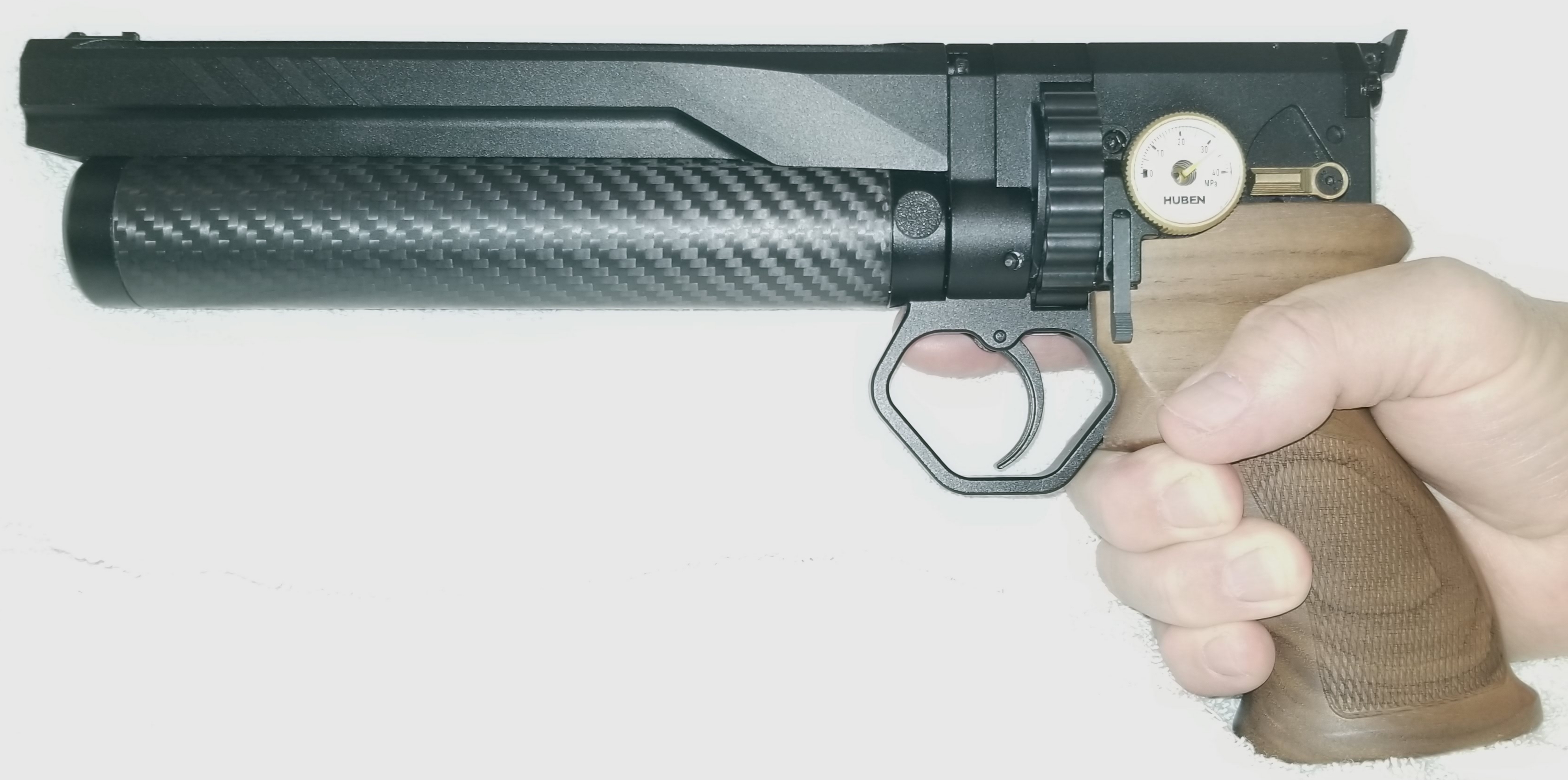

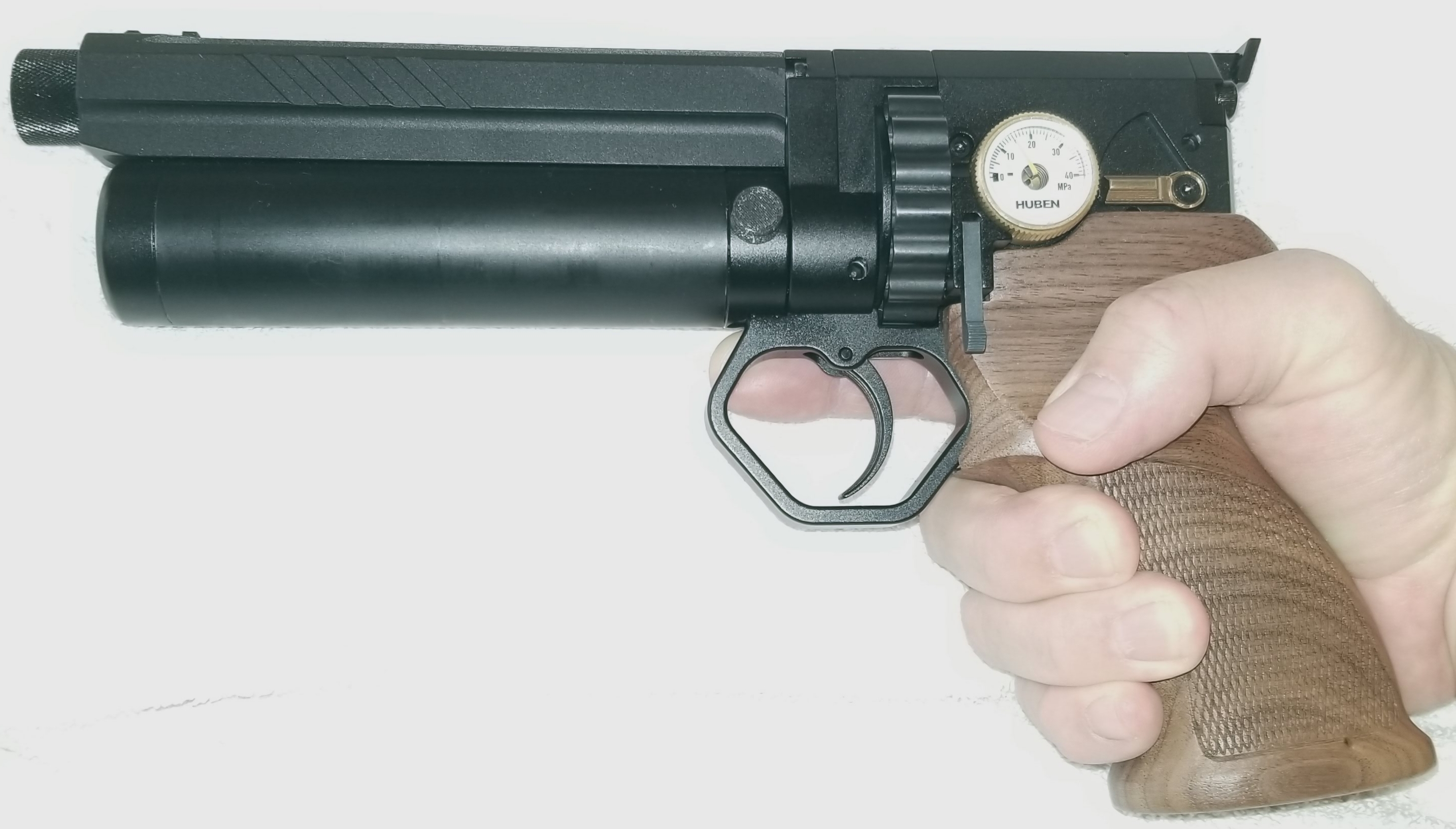

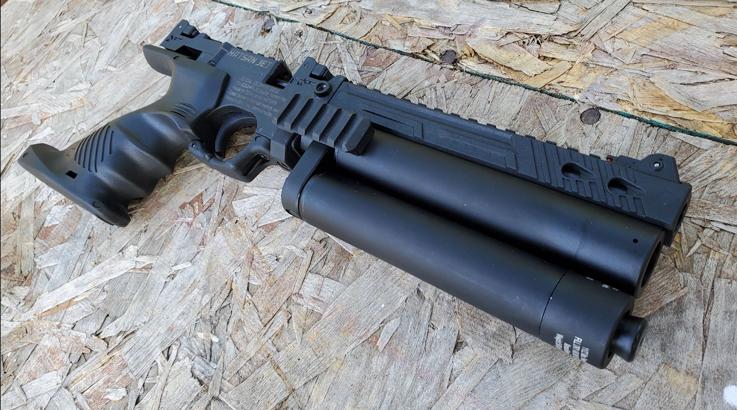

Right on Pirate! PCP air pistols have always had to be absurdly large to produce even modest power (looking at you, HW44 and BRK atomic). The GK1 has blown that constraint away. Yet, it is still, in my opinion, a very chunky pistol. What I dream about now is a shorty variant in 177 with a smaller air tube, 6in barrel with active shroud and integrated 2in mod, capable of shooting one 10-12 shot mag with a flat string at 20fpe. That would be the ultimate portable and stealthy (small game) hunter/pester!
Ho yeah, and it was a Kelly mod.....superb job I like how he did it and will get one 1000%
Hook me up as well please!

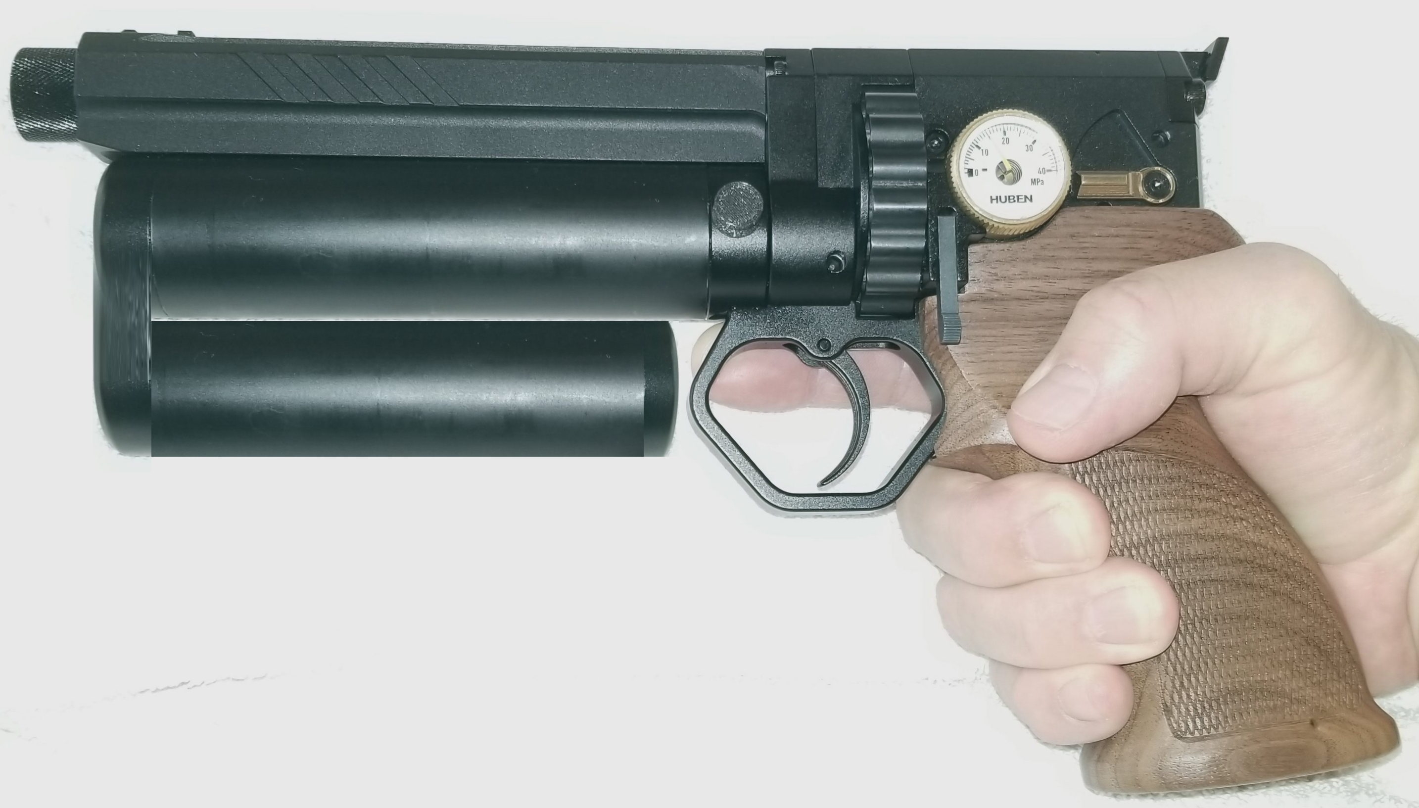

This is probably a stupid idea but, the lower shot count of the shorty could be remedied with a (short) secondary airtank, a bit like on the Hatsan Jet 2.
It would definitely make it more bulky, but at least it'll maintain the shorter length while also having the same shot count as the long version (maybe even a little higher). In other words: gimme a dual-tank shorty!

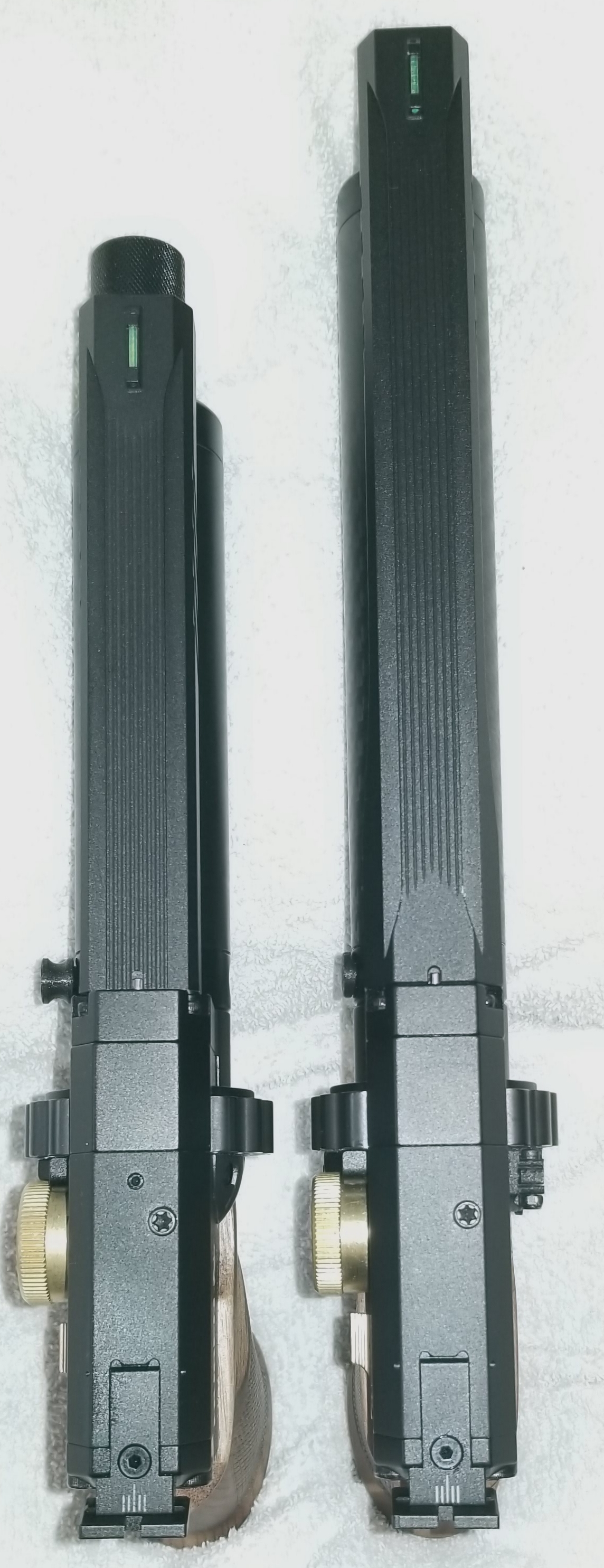

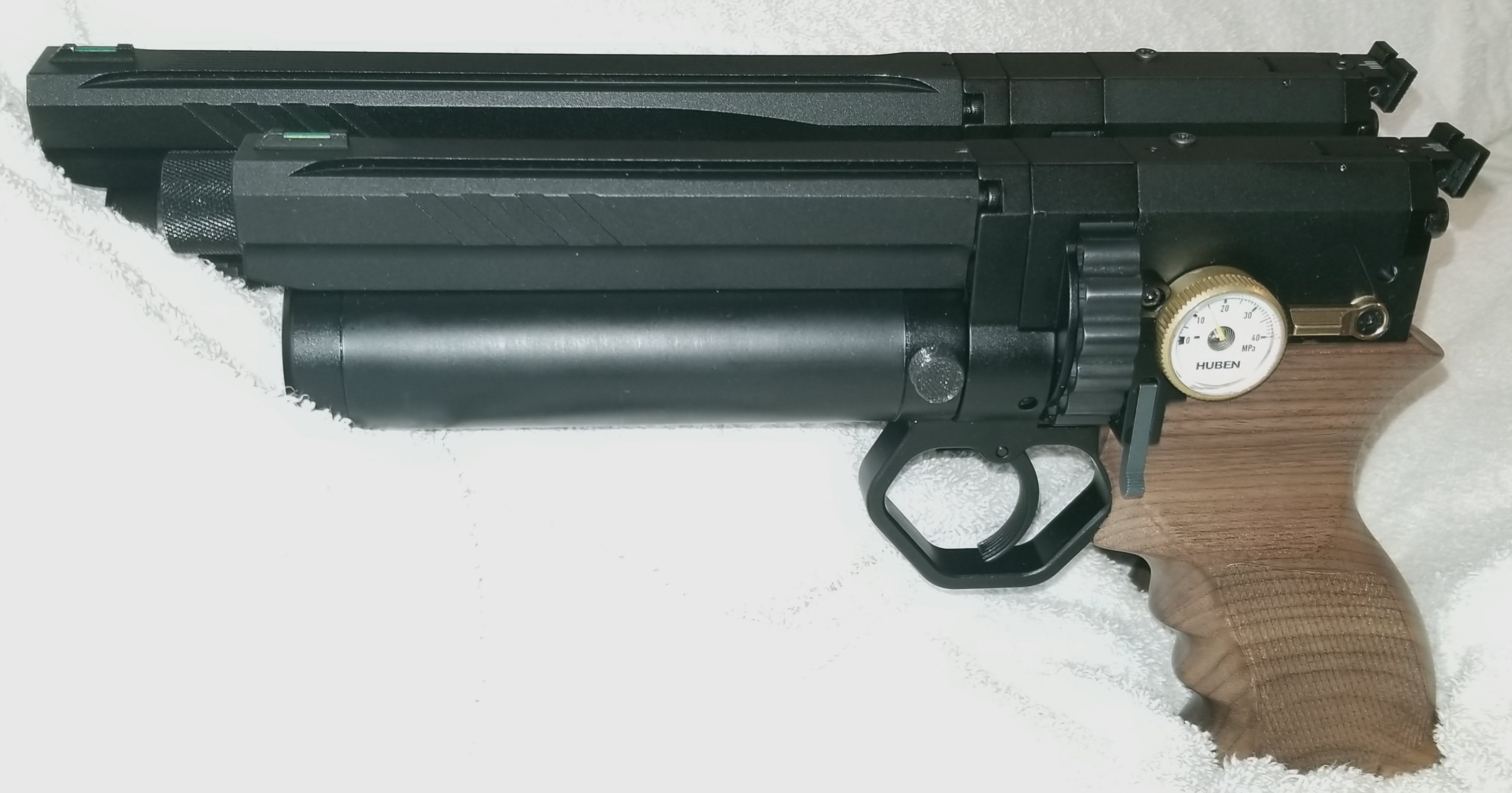

Erh, that ruins the lines. A different shroud might allow for a slightly fatter shorter tank (if newly made/designed). In fact, there is also the option for normal length air cylinder but shorter and integrally suppressed barrel.
Still super cool, shortened as it is.
I think the trigger guard currently gets in the way of a fatter tank.
We where still able to shoot quite a bit of rounds per fill, I was at work so we didn't have much time to play but Billy will come back one day that I will be open to shoot a bunch and collect data.
I would never want a twin tube on this gun it's just so sweet as is that I would not want to ruin the feel and looks, it's just absolutely fantastic.
I like how Kelly kept the OEM shroud so you still have the original front sight.
