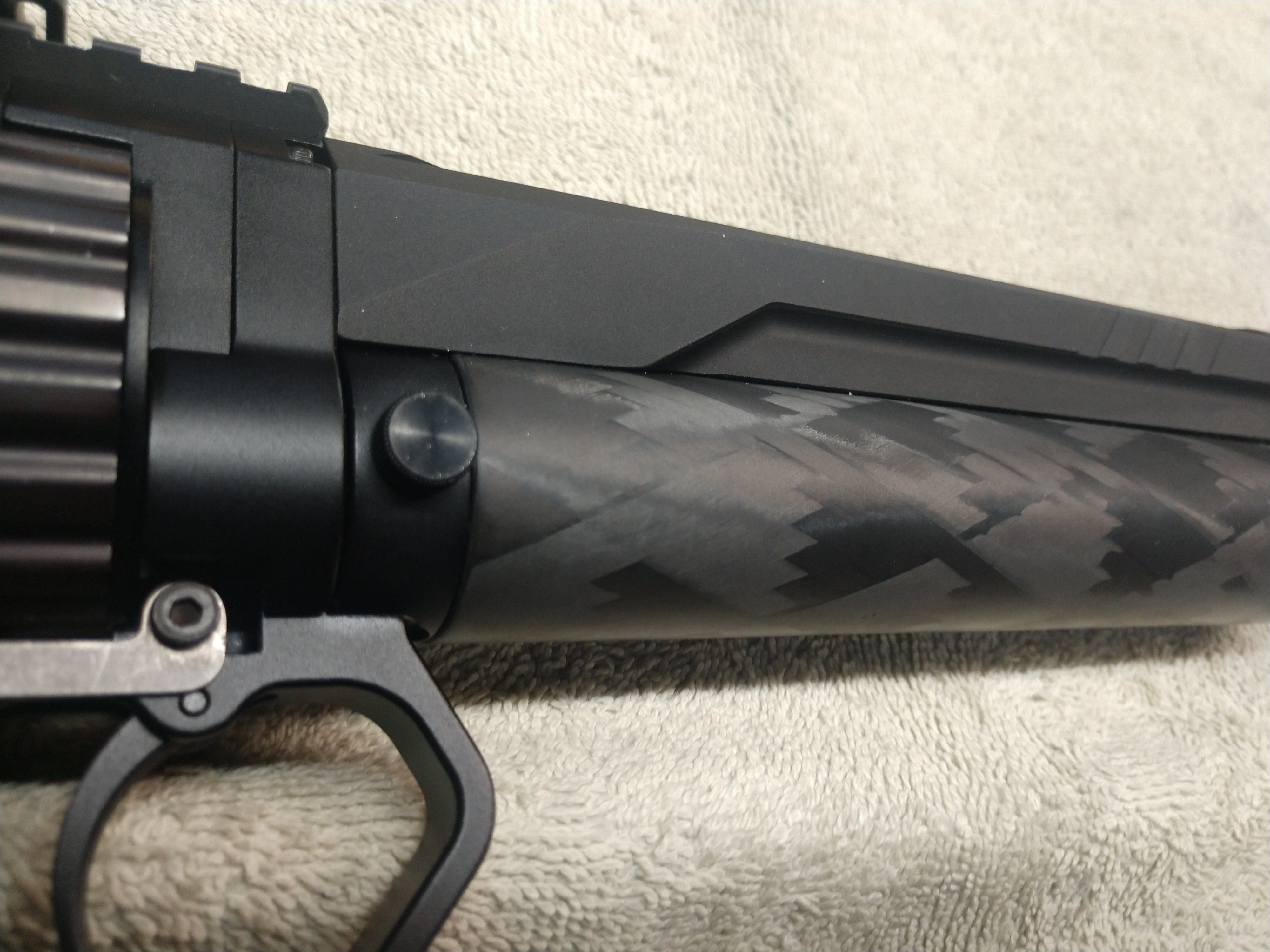

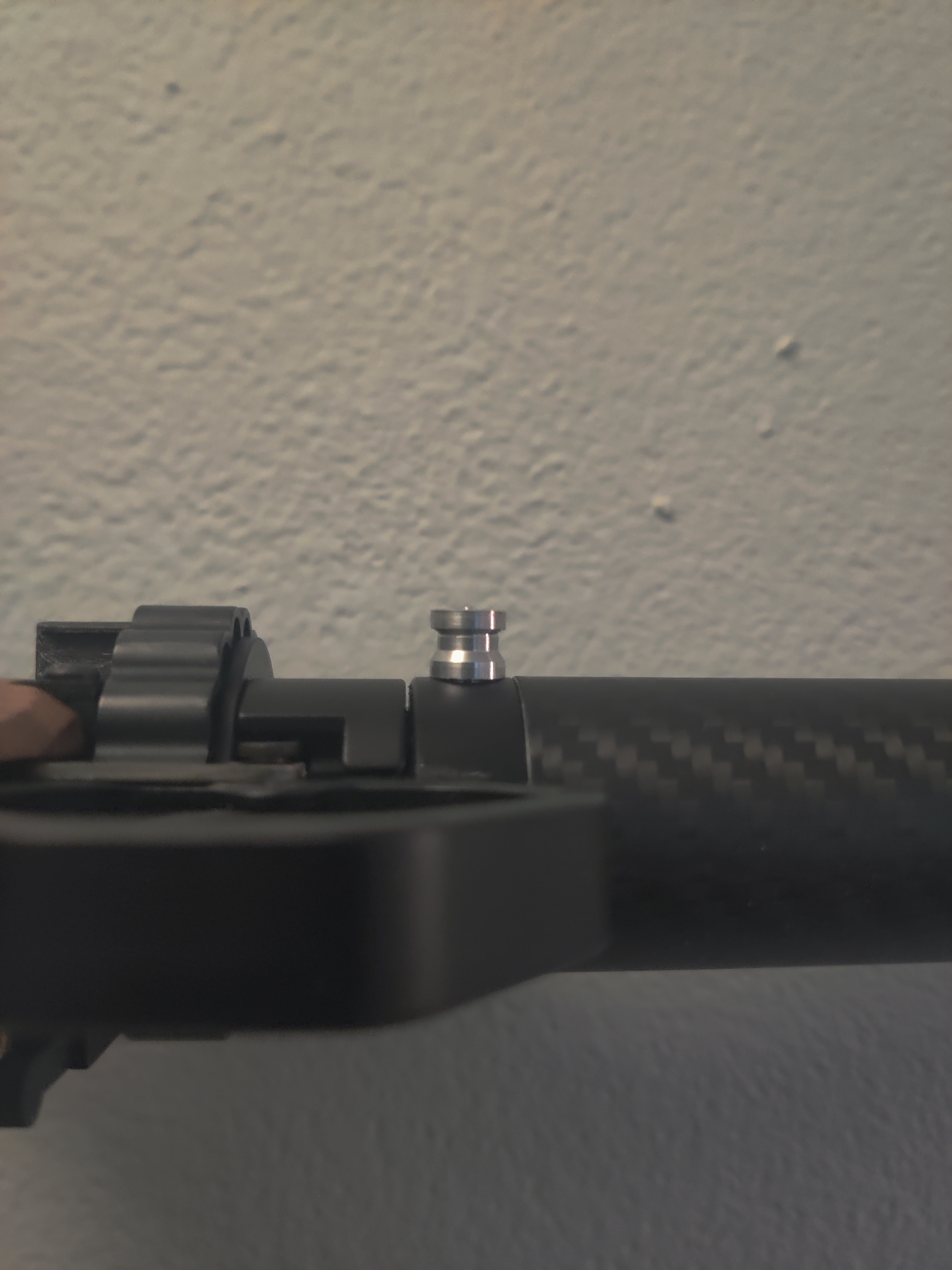

First attempt at making anything out of metal. Please don't judge too harshly. The 3d printed one I bought was impossible to remove without pliers so I watched a YouTube video and immediately became a machinist. The 3d printed one was also too short and didn't reach to the other side. This was a practice run. I think on the next one I'll use brass and put the first o ring closer to the end.

Very nice work!

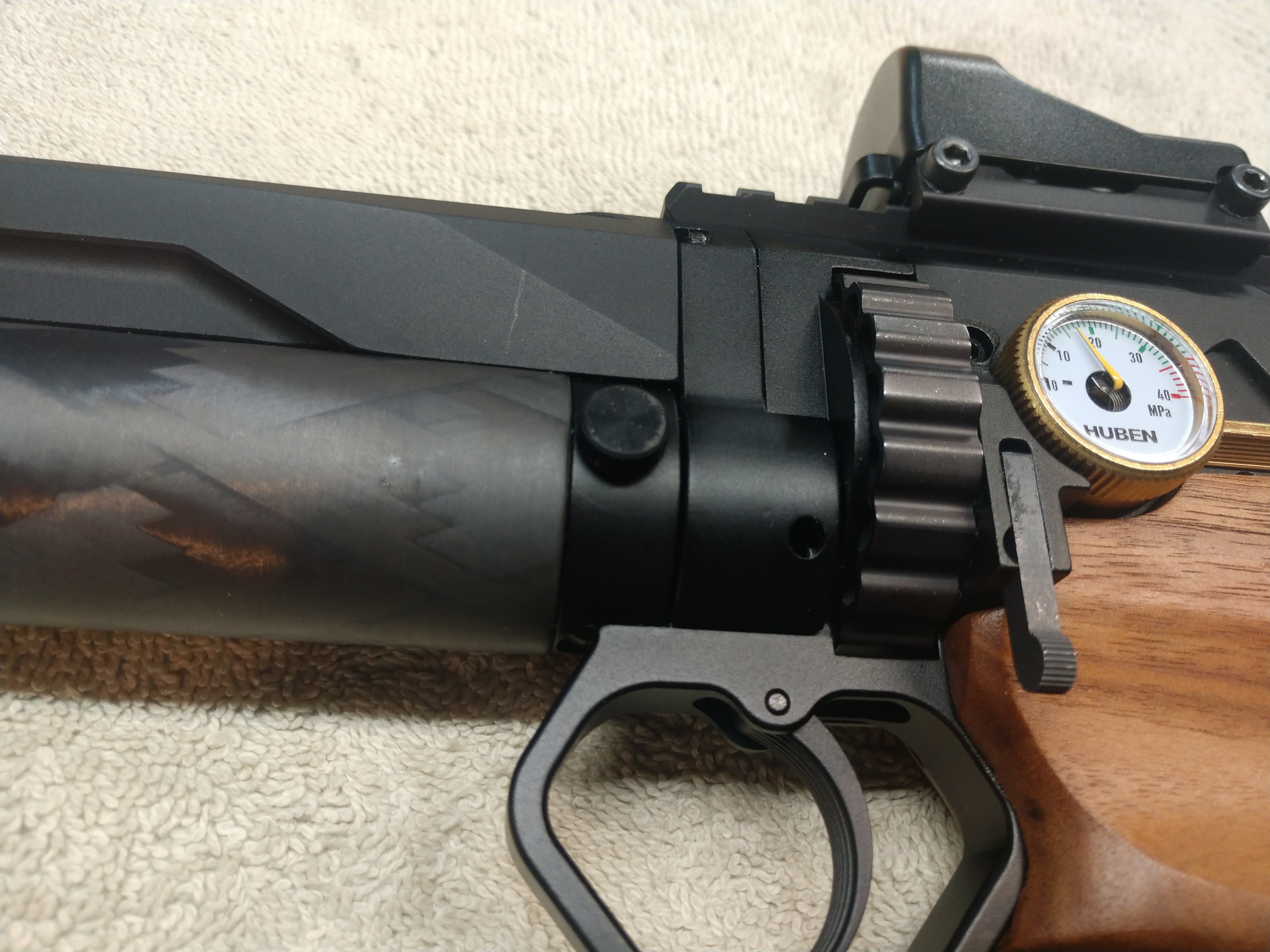

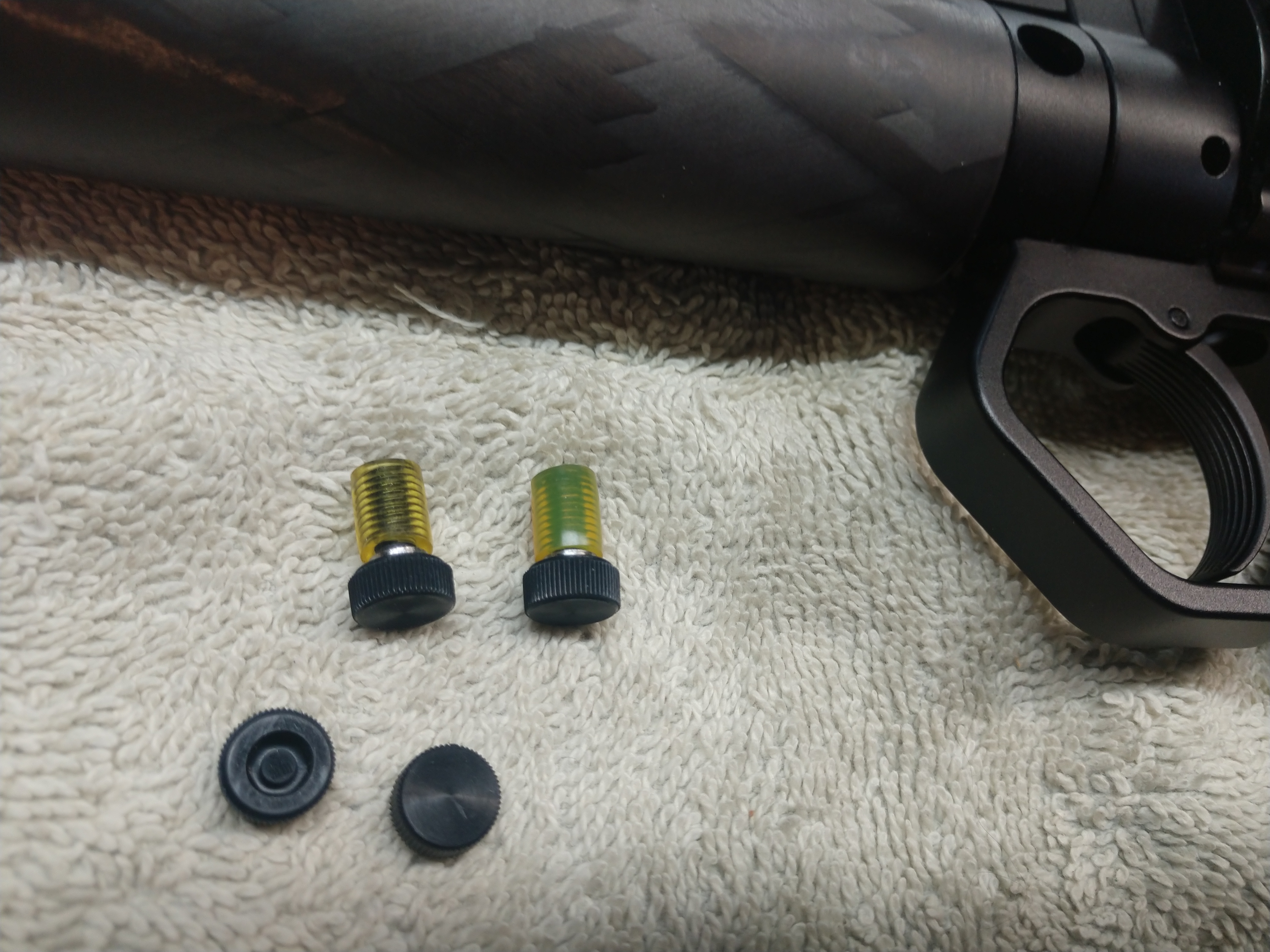

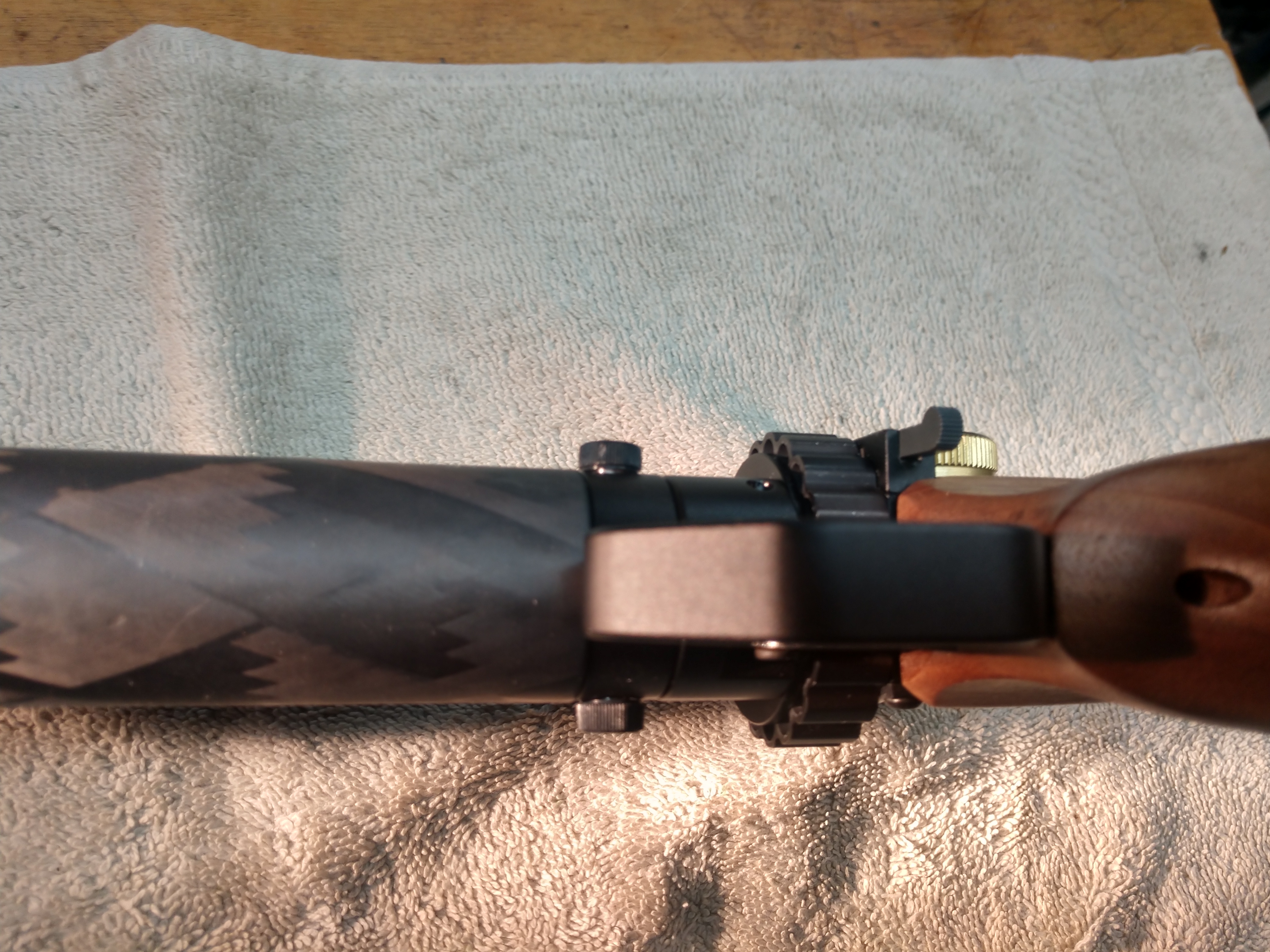

Well, I too didn't care for the look of the printed version. I made my own using an 8/32 hex head bolt about 1-1/4" long, with RC fuel tubing over it. Turning the head diameter down so the decorative plastic cap can be pressed on. (The caps are designed to press onto 6/32 hex heads).
I use these caps sometimes as canopy mounts for my RC helicopters.
Anyway, then since I liked the looks, and how secure it fit, yet easy to remove, I figured I'd make two, one for each side, using two shorter hex bolts.
Here's a couple pics. Either one can be removed to fill. This method completely covers the hole on both sides,,,dust free! Cost about .30¢ ea.
I'm always moding my stuff to make it look more attractive to MY eye, and sometimes even more functional.. Great hobby,
Have fun!

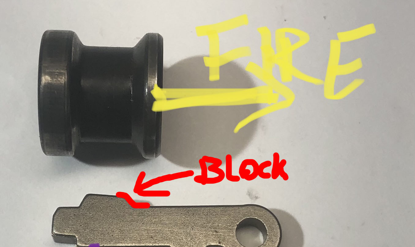

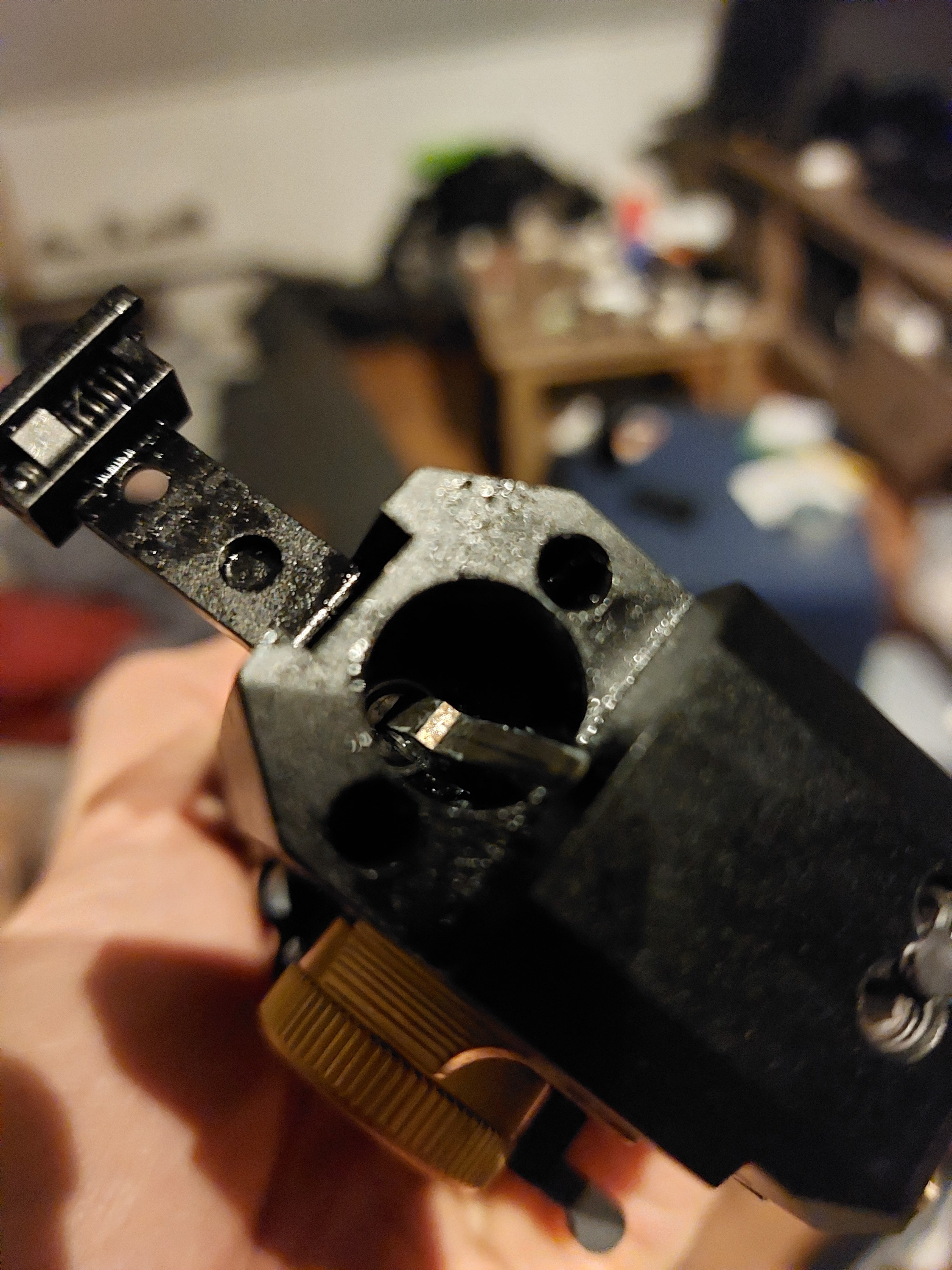

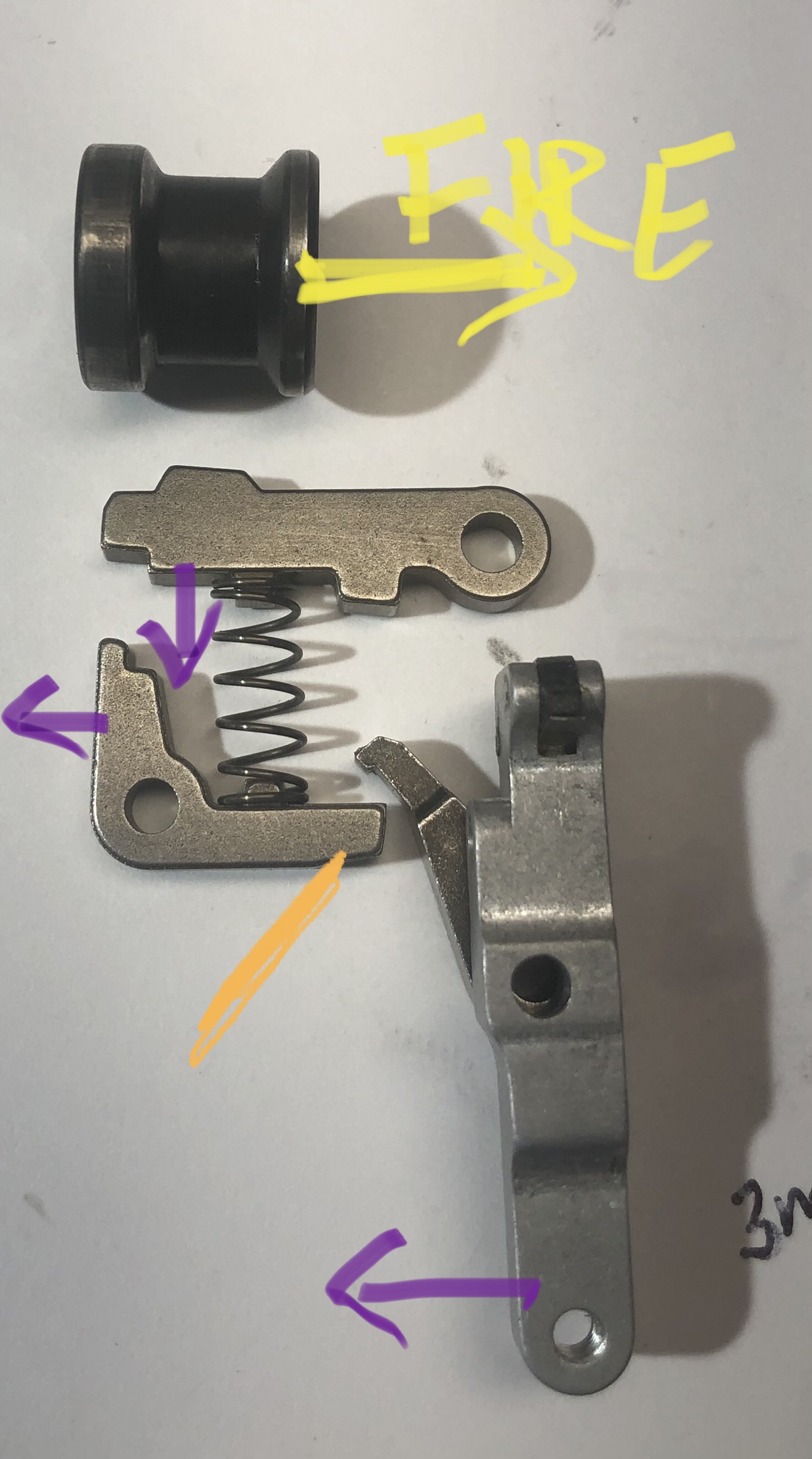

Anyone know how to get the valve assembly back in after degassing? I can't seem to get all the parts past the seer for some reason.. I can get the valve itself all the way in, but the striker that sits behind it is impossible to get all the way in past the seer.
If you hold pressure on the ‘striker’ then pull the trigger, see if that helps.
Dave
Reactions: DonEnzone
Nope.. it doesn't work. The seer doesn't even move an inch when I pull the trigger.
I guess my GK1 is pretty ruined right now
Safety off, trigger held back in “fire” mode and hold it there while pushing dead center in the cavity area where the spring goes. It’s just in a bind or likely the striker is ever so slightly canted to one side. If you are in the center and the trigger is being held back it should not require a lot of force to reset back center atop the sear.

It seems the tip of the striker gets blocked by this part of the seer when I try to push it back in. I tried with quite some force. But no luck.
Right, so when you hold the trigger in “fire” the area you marked in red “block” is allowed to drop lower which then allows the forward rim of the striker to pass over it.
