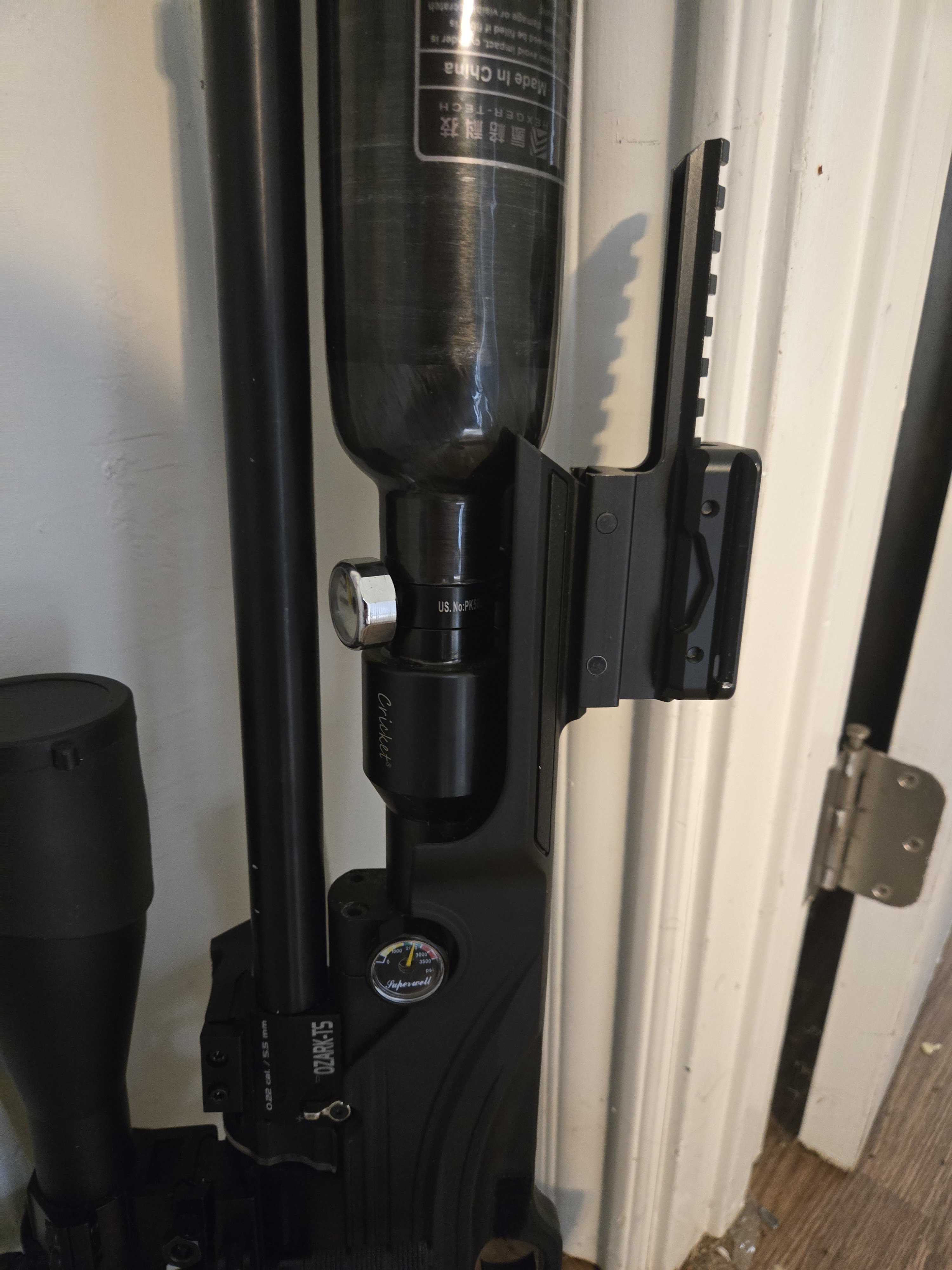

Thinking about one of these for a Niksan Ozark TW. Will it fit and how much length will it ad. Thanks
I have one on my Ozark TS with a 0.5L CF bottle. I had a 0.7L on there but moved it to a .30 gun.
I can't say for sure that it will work on a TW.
The bottles used on the Ozark are 60mm, the CF are usually 61.5.
You may have to add a little clearance in the stock, I doubt it but it is possible.
The MAX moves my CF bottle just past the support.

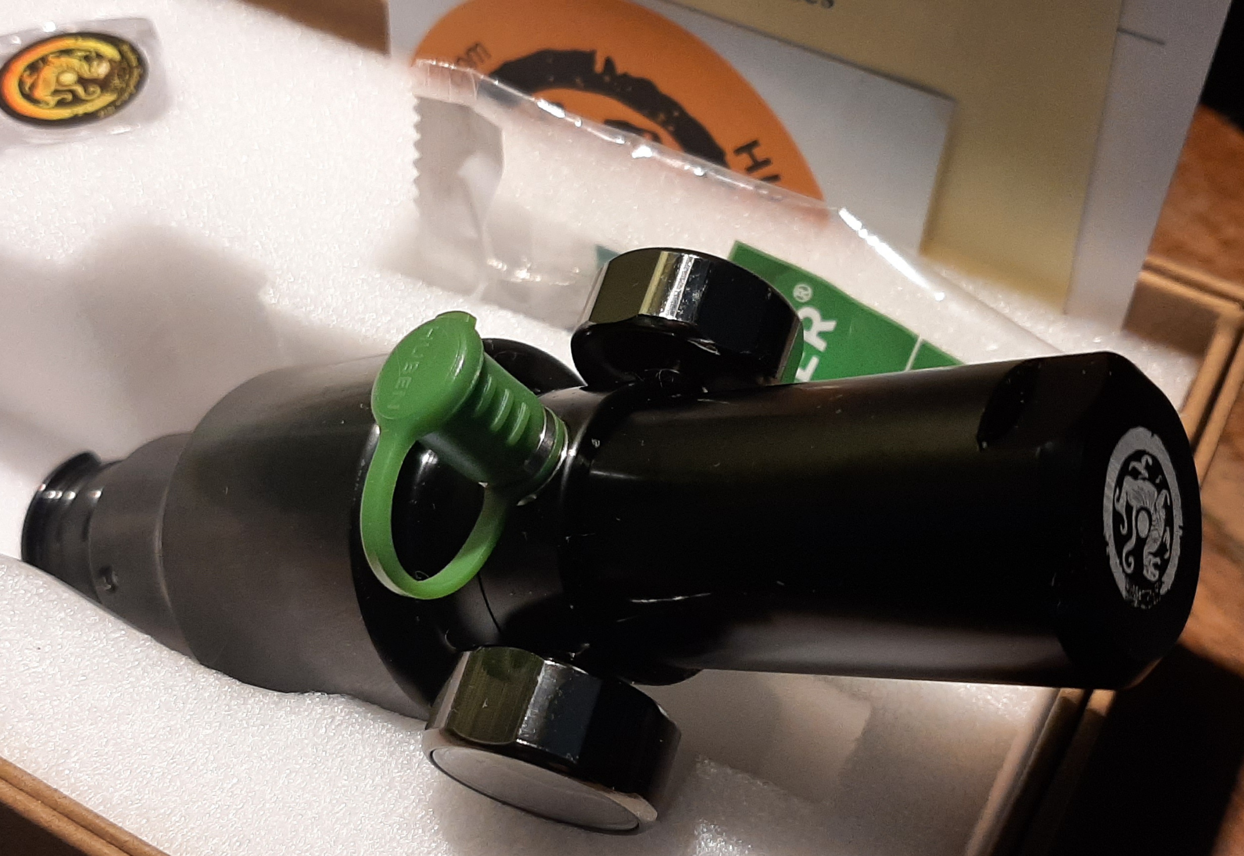

Hey guys,
What's the secret for removal of the bottle thread cover on these things?
I thought there would be some instructions either in print or online, but not finding much out there. Surprised as well as this thing is packaged that there isn't more. I haven't scanned the QR code that came on the fancy authenticity card they sent w it yet. Maybe that's the golden ticket?

If you mean the little testing tube that should just unscrew. Should only be hand tight.
Email Nick Scott at Huben Power.
[email protected]
He is quite helpful.
With the holiday and time difference he may be a little slow answering.
[email protected]
I think so.
Maybe it's my lack of upper body strength, but it won't turn & is too smooth to get a good grip.
I'll try a lid gripper or something w a little tack & see what Huben says if I fail.
Thanks
It is for setting the regulator.
You can't adjust once the bottle is on.
So you use that as the bottle.
You can drain it in seconds so making adjustment to the regulator is easy.
If you don't have a screw on test gauge you can do it on the gun. Just don't turn the adjustment more than 1/4 turn at a time.
I usually take a sharpie and draw a line on the screw head so I can keep track of where I am when adjusting.
You need a g1/2 to M18 Adapter for this but a lot easier than on the gun.
