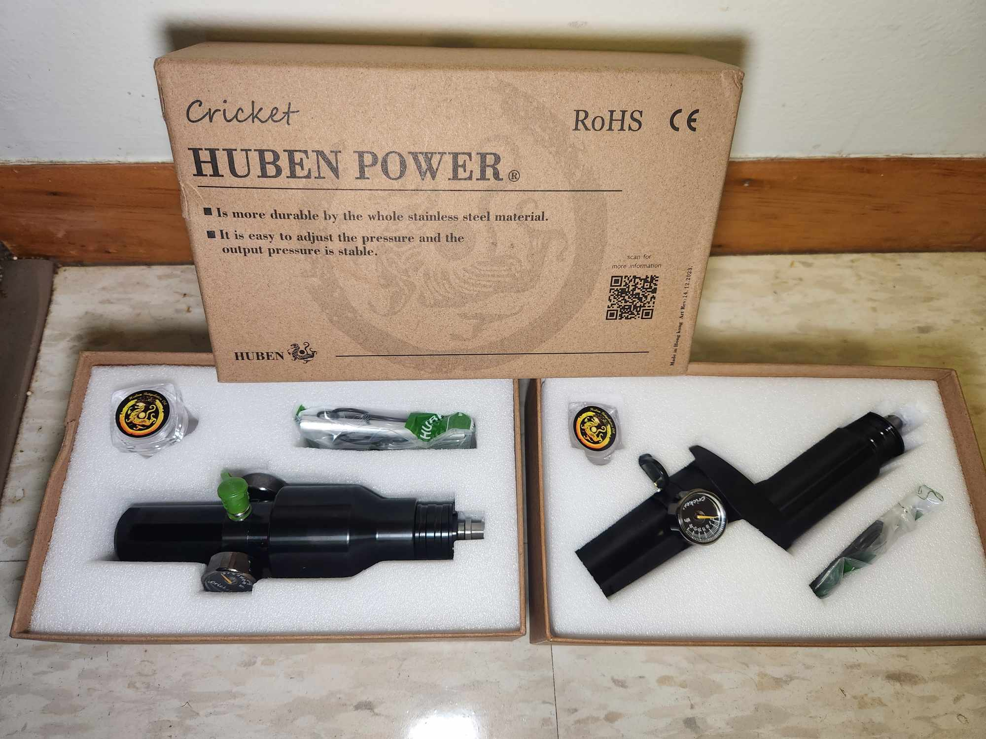

Starting this thread now and I'll keep it updated as I go along. In a nutshell: I received (2) regs from Huben Power to the Airforce Condor or Talon platforms. The 23CC plenum drop down version is going on my old ,22 Condor (now owned by a friend) and the 50cc power plenum straight version is going on a .25 Condor that a gentleman should be shipping to me here soon.

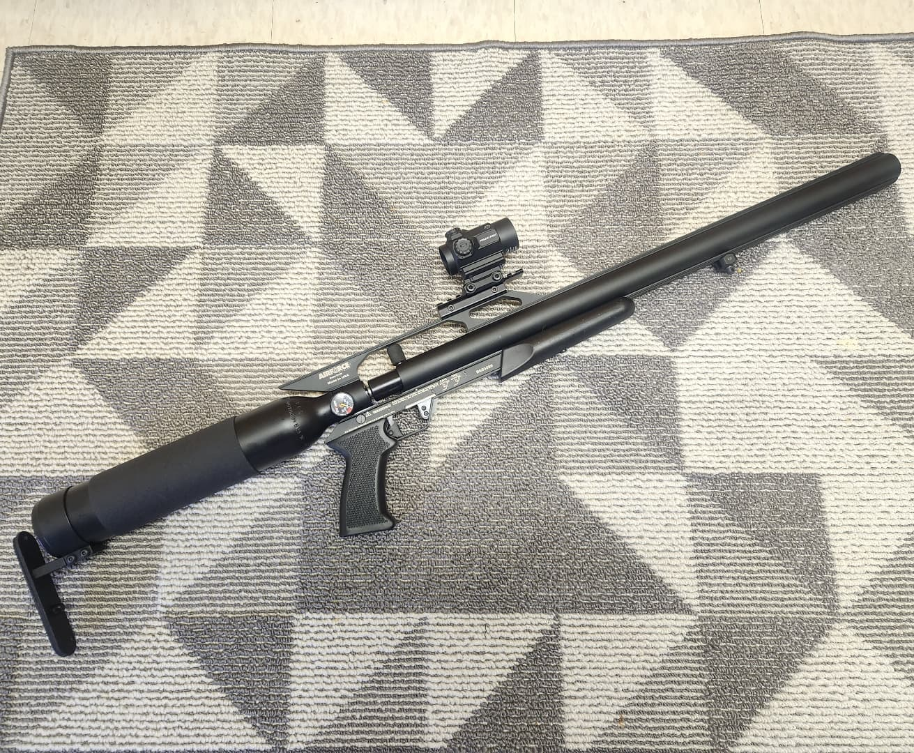

Alright I got my project gun, here it is! This is a .25 and will be getting the 50cc plenum this weekend. Primary Arms red dot mounted high to use with NODs (it has 2 NV settings)

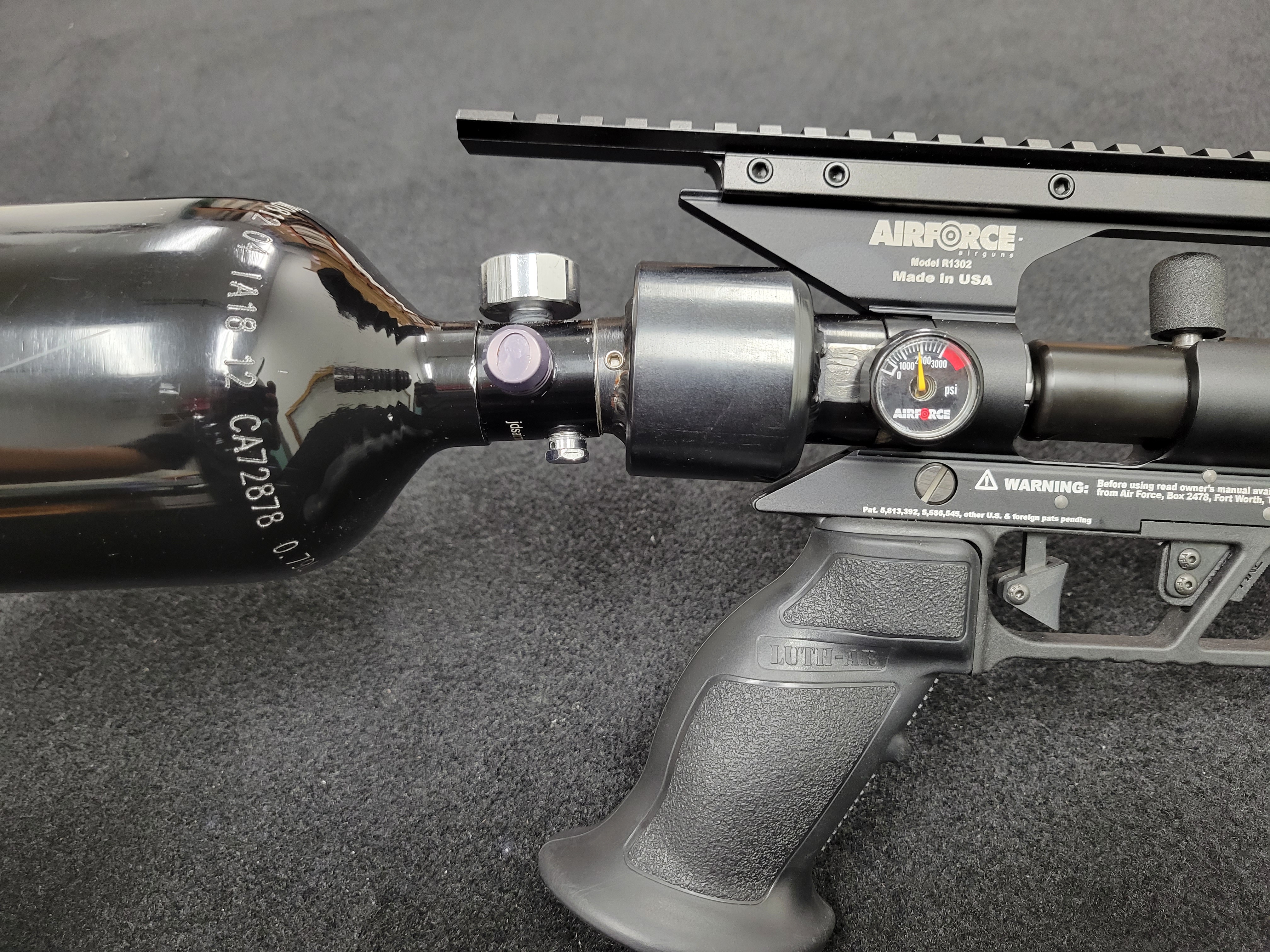

And here is my old Condor SS .22, which belongs to my homie now, already regged with the drop down version and a 68ci 4500psi tank. Been sitting for a week with zero creep or leakage. Slinging 28gr Eun Jin at 880.

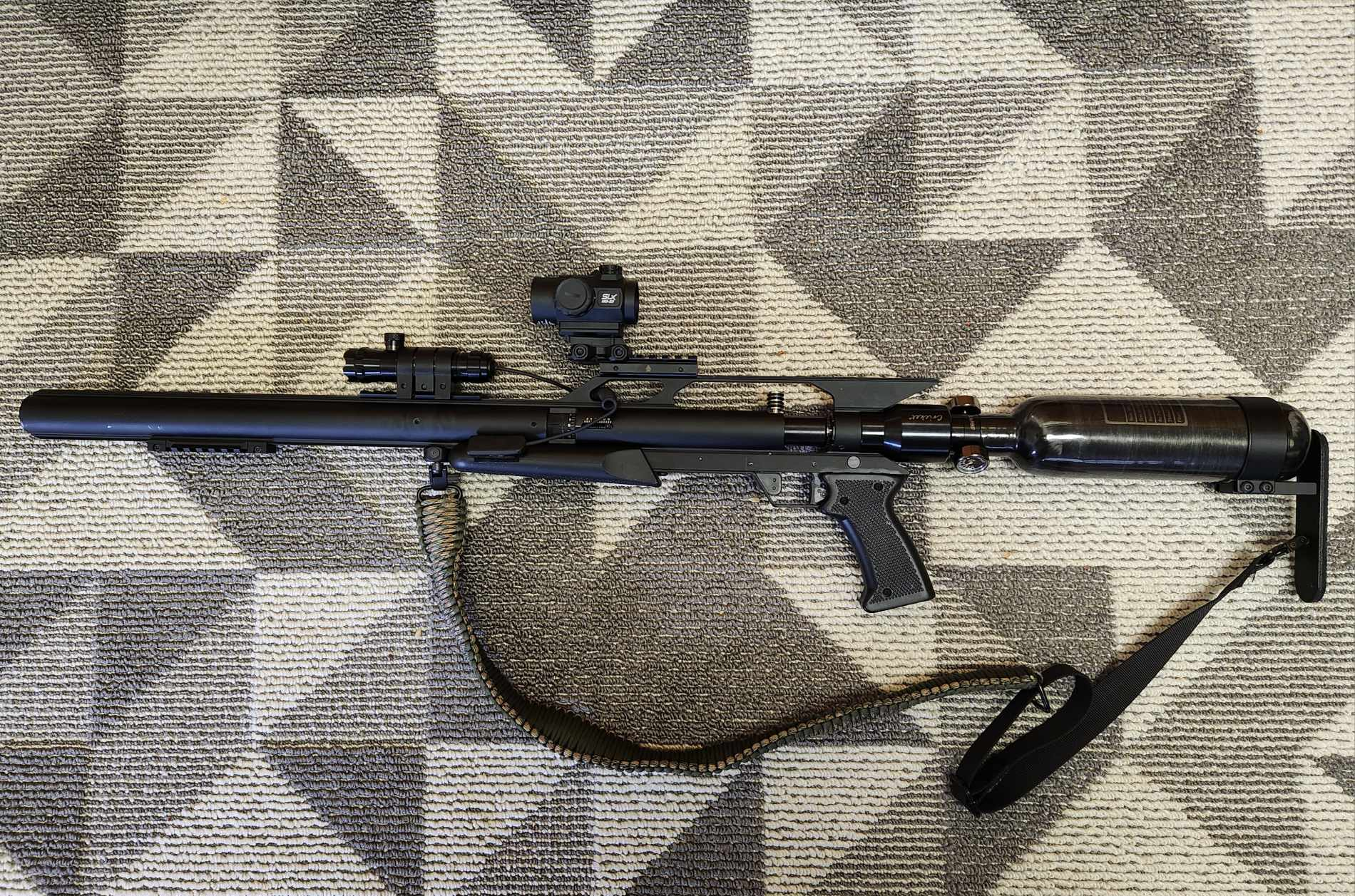

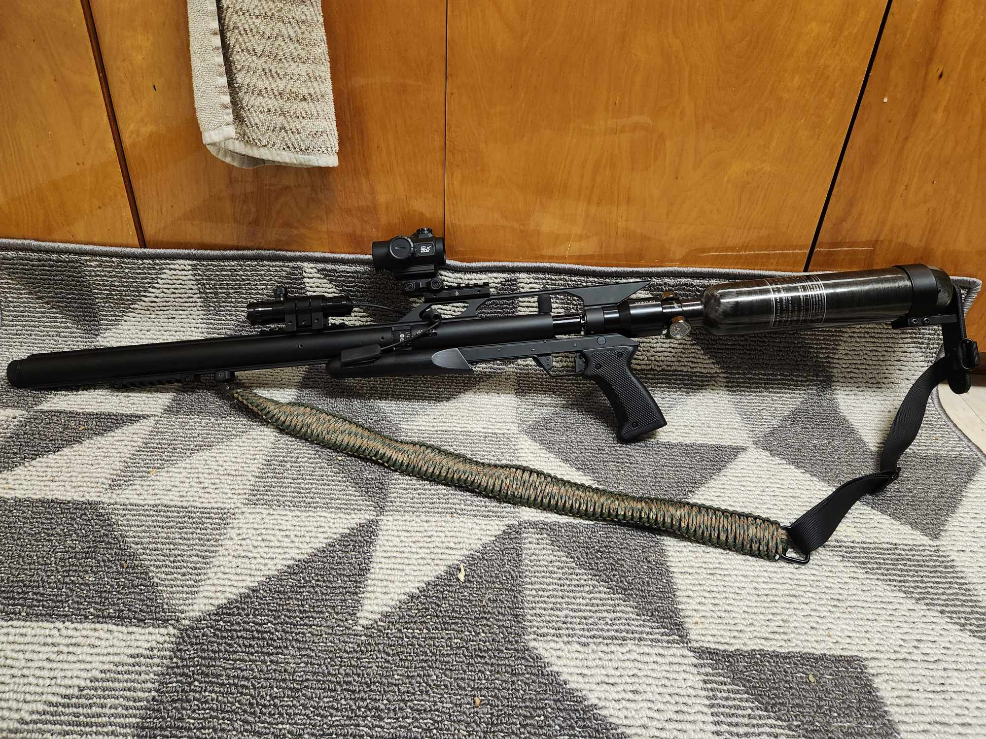

I've been testing the 50CC plenum model on my newly acquired (and somewhat clapped out!) .25 Condor SS. At first I was only getting 45fpe but I think I had the reg set too high at like 190 bar. I lowered it to 150 and I am getting about 50-52fpe. Curious to see if I could get more than that at lower pressures, I shot the bottle down below the reg pressure and unfortunately the velocity decreased as the plenum pressure dropped below 150. I think 150 bar is the ticket with the stock hammer and spring. I do, however, have a heavy spring and the 95g heavy hammer on the way from TalonTunes. I am thinking with those I can maybe crank it back up around 180 and get some pretty serious power like 60fpe. It's been really fun tinkering with this thing and I absolutely fricken LOVE having this broomstick equipped with a red dot and shooting pellets, for once. Such a fun gun for pest control out to like 75 yards!
Here is a pic from yesterday:
For a quick and dirty hunting setup that can go all weekend on one charge, I think I've got this thing setup almost exactly how I want it! The Primary Arms red dot has 2 NV settings and it's mounted really high so I can use it with NODS, and I mounted a cheap Amazon green laser ( https://amzn.to/42S4nCf ) for those Quickdraw McGraw hip shots that I love to do to vermin. Damn thing is so bright I can easily see it in direct sunlight! Gun is a little long with the 500cc tank but it's growing on me.

Nice looking rig. What LOP on that thing? Were you a basketball player? 🏀🗑️
Haha dude its only aboutttttttt..................... 17 inches! Haha. Not bad with that super far forward red dot, honestly. But yeah, I've been looking at other tanks that will still fit the factory butt stock so I can still use a sling. I am thinking this .36L tank would be a pretty solid option to cut out like 7cm/2.75": https://amzn.to/4bMBKdN. That or this .42L which is like 3cm longer than the .36L --> https://amzn.to/48pxT3q
If I had known I'd be getting a TON of shots like this from the beginning I'd have started with a shorter tank. The longboi is starting to grow on me, though, and the shot count is insane.

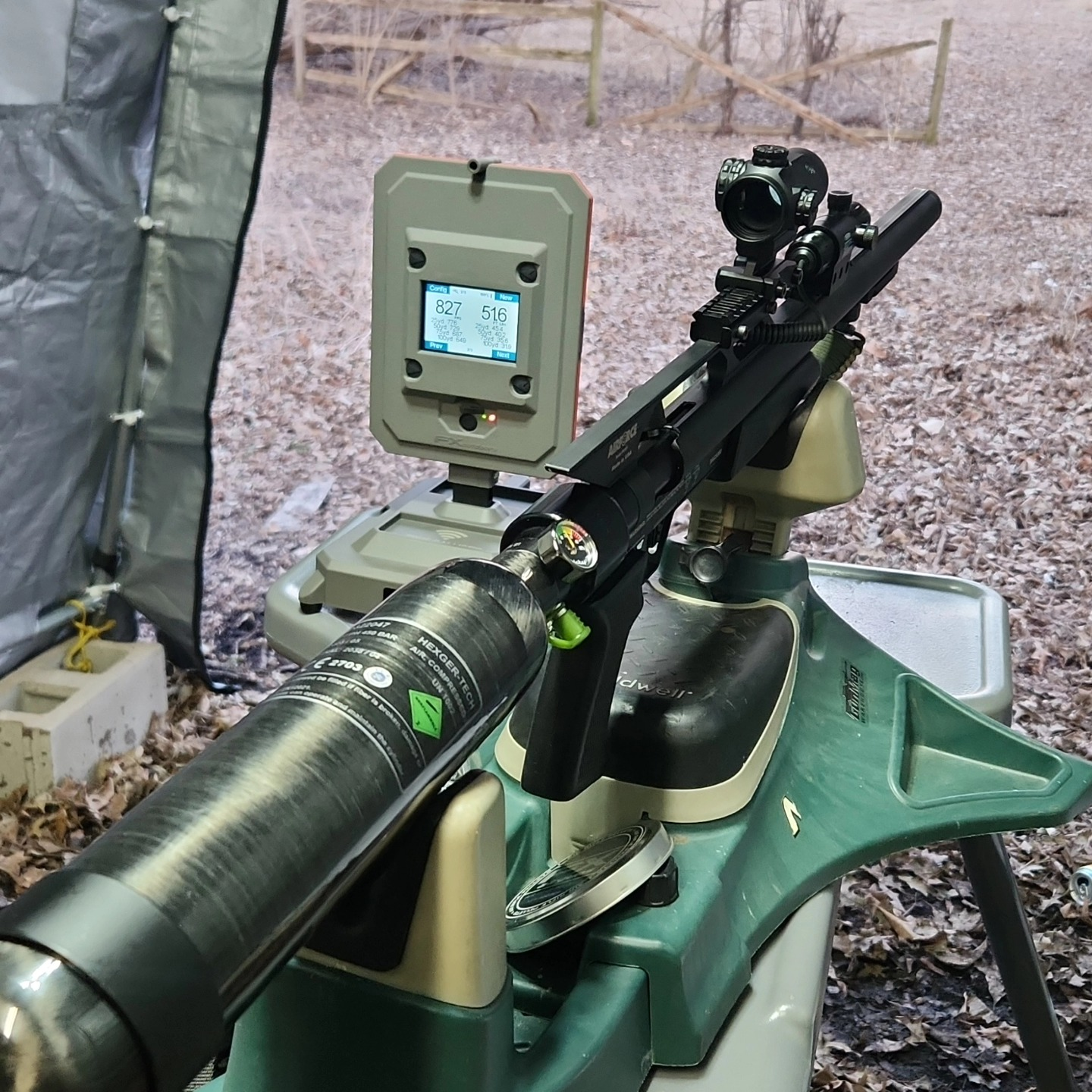

Now with the .25 Condor SS shooting the 34gr FX pellets I am achieving 58FPE, launching them at 875fps! I did this by inserting a TalonTunes 95g heavy hammer and upping the reg to 170. I am at 12 on the power wheel, and still getting a TON of shots per fill. I think I could get even more power if I put the heavy spring in there and jacked up the reg to 200..... but why? I am already shooting heavy pellets at the optimal speed. LOVE this red dot setup! I have it zeroed at 30/50 yards and it is very flat between near and far zeros. It is already proving to be quite a vermin dispatcher in this configuration...
