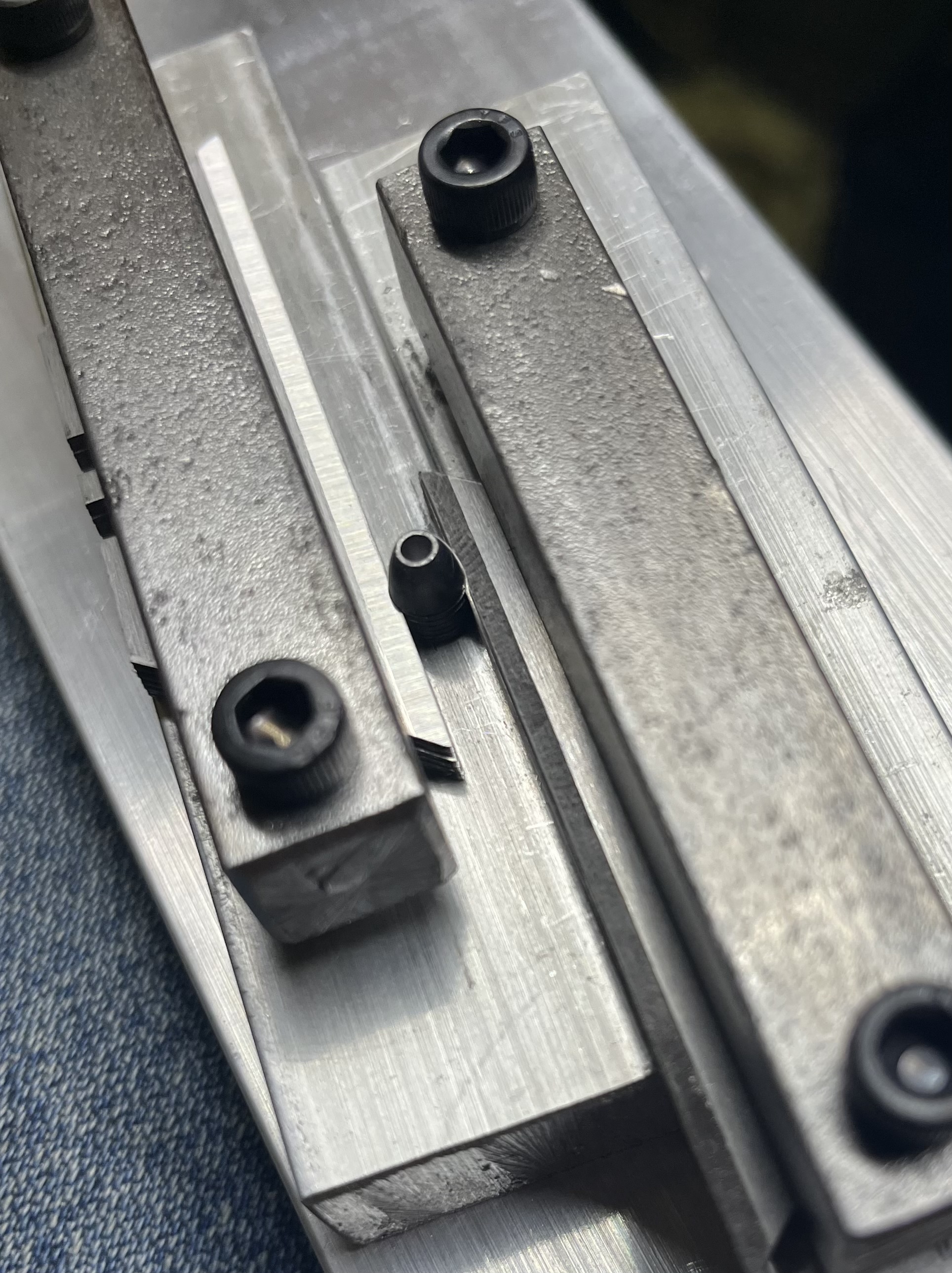

I didn’t suggest it for the peanut because I wasn’t sure if the driving bands would align correctly but since you mentioned the nsa’s and knurling, I’ll throw this out there. I knurl smaller slugs up using two opposing stacks of utility knife blades. They are adjusted to only cut a specific depth and so the results are repeatable. The slugs fill the bore without the added friction, center in the chamber better and hold the lube of your choice better.
DaveView attachment 491999View attachment 491998
That is genius. I will be making one of these asap. Knurling with a file on the Peanuts worked really well... it only affects the drive bands and they are easy to keep on axis when rolling them.

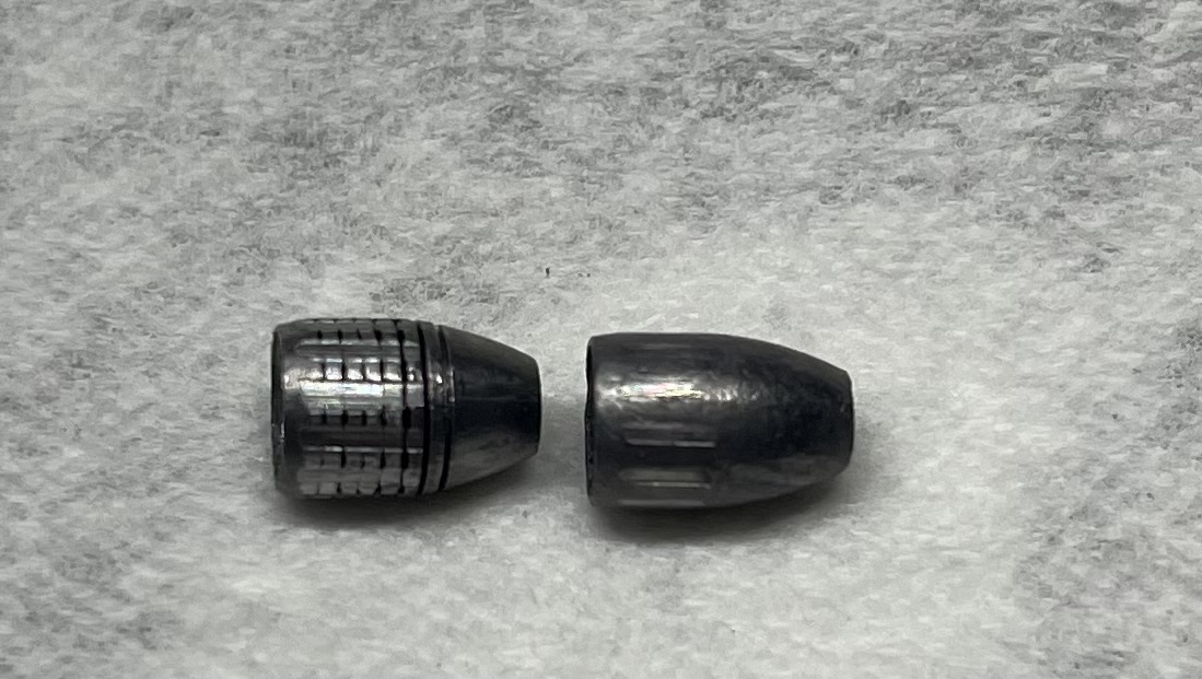

I have .22 (.2185) & .25 peanut in .2527. Still trying to acquire .219 & .220 sizing dies at NOE to complete the set.
Also have the .22 & .25 three ring round nose:
