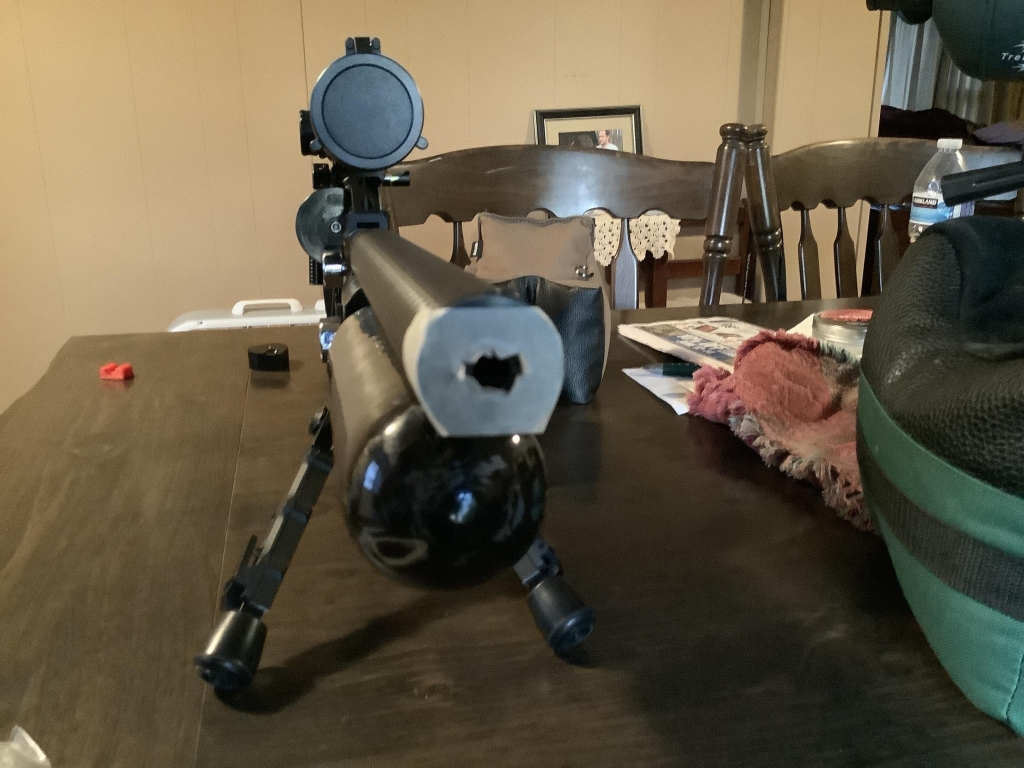

Hello, I put a Huggett Astile on my Evinex Max Air only to have it clip all of the inner Plastic baffles and totally destroy the inside of the moderator. So it is now useless and cannot be used anymore. I hope that this gets to the company that can help me to get their product on line to where the folks can again open up & be heard & we can open up new avenues into the ability to create a new ideas & help in the planning of help for the ones that really need your help & ideas for the future. This means an opening up of your new ability's to help your customers

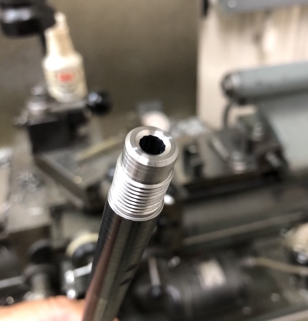

It is why LDCs usually have a relatively large exit opening. My machinist friend has replaced LDC end-caps (after rethreading the barrel) with an exit opening a few thousands larger than the caliber resulting in a quieter LDC. And with a good crown the shot groups tighten up also. We have noticed these issues on many brands of air guns.

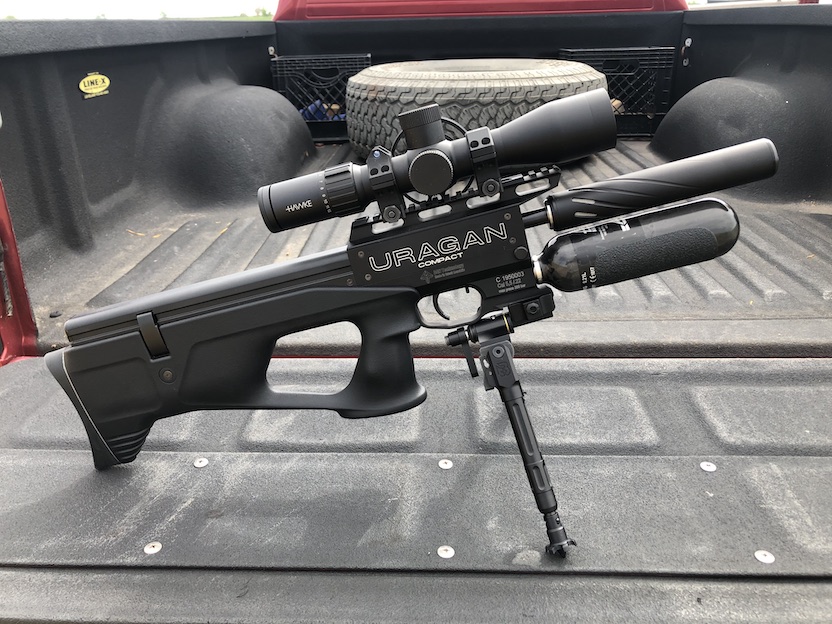

This is my Uragan compact barrel after being rethreaded and crowned centered on the bore. The original threads were not concentric a surprising amount. An adaptor was made to install a Huggett.

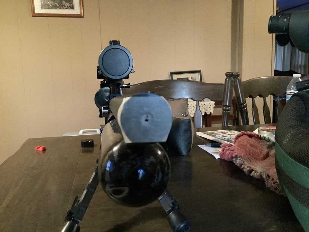

That’s what we are eluding to Yo. There are a ton of guns out there that their machining is off. When I get a gun, I immediately tape the end of the shroud and fire a pellet. It blows out the tape but you can press it carefully back onto the muzzle and see where your pellet exited the hole. You will be very surprised how many guns the pellets are almost clipping the hole in the end of the shroud. Not Donnys or Huggetts fault. It’s to owner who didn’t detect he had a jacked up gun.

I spent a $1000 on this rifle. An awesome Evanix max-air it is not the rifles fault. I could feel & see that the moderator was not in alignment all the way through. I had used it for several weeks and removed it for a few days then re installed it when this happened and found that some of the modular sections did not totally line up. (I had added 2 more modules plus a new muzzle adapter from hugget) which made the length much longer than normal and maybe that was to much for this system to be able to keep every thing in perfect alignment. I do not know. Fortunately Hugget has contacted me so we can work together to work out this problem. I am very happy that they care enough to work this out with me. I really think that we can figure this out together.
