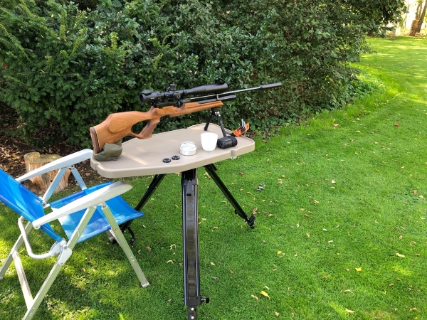

sorry for the late answer. I have a Weirauch hw 100 k and with a Weirauch moderator it makes no sound at all. And it is a FAC model. But without moderator it’s really loud!

Raptor... beautiful looking rifle. And near silent with the Weihrauch moderator - that is really impressive!
