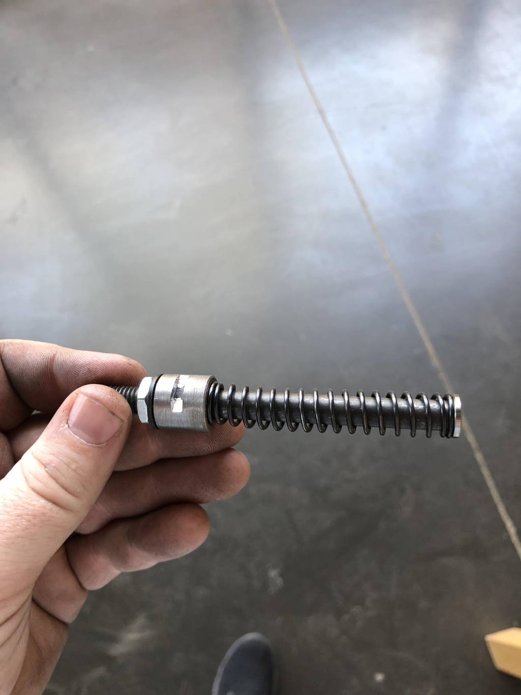

That thread was extremely useful. While not exactly the same mechanically your mods got me pointed in the right direction.
I made a custom spring guide and was able to reuse the stock spring. I set the spring preload such that the hammer free flies the last 1/8” to the valve. It’s amazing how much quieter the rifle is with the absence of excess air. The rod is a M8x100 bolt with the head turned down. The end cap is some 4140 with a delrin guide.
I did have to modify the back of the stock to accommodate the bolt stroke.
I didn’t lighten the hammer. It weighed at 46 grams stock.
With JSB 15.83 I’m hitting 840 with the reg set to 135 bar. 60 full power shots before going below 135 bar. That’s sub 20 psi per shot. ES of 18, SD of 3. I’m not sure what people consider “good” or “excellent” but this is a massive improvement over stock.
