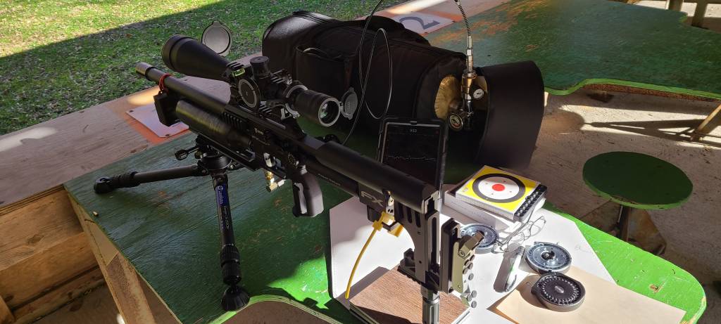

I am using this Huma externally adjustable regulator - for a while - for tethering to my Impact MK2 PP at BR.
I am mounting every time - to a DIN output on my scba tank (not inline with two microbore hoses) and storing in my gun case when not used.
I set my @185 bars and that acting as a pre-regulator for my MK2 which reg is set (currently) @ 143 bars. This is removing a stress on a single reg in the gun (180ish bars vs 250 bar).
I like this Huma product, it is precise, and the only maintenance needs is to keep it clean and lube the o-ring occasionally.
At the time when I was researching the external adjustable regulators the other option was the Altaros (pretty much functions inline attached to a mb hose as your setup in the video), I picked this one that attaches to a tank directly. The Ninja reg was just way too pricey in contrast to a quality what I could get or needed.
I don't know your gun, but in my case I am just helping the internal reg with a consistent input, acting as a pre-Reg?
