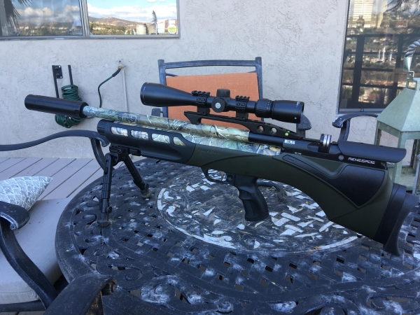

HUMA regulator for Daystate Renegade .22
Daystate Renegade .22 with Huma reg., Vortex Razor HD LH 3-15x42, DonnyFL Sumo.
My God what a beautiful rifle! I like everything you've done...the green camo goes perfect with the stock, and you have it tuned to perfection. And I am diggin your choice of scope and the fact that you also downsized on the magnification. I have the Athlon Midas 2.5-15 x 50 SFP scopes on both my Wildcat and Streamline rifles and I think it is more than enough magnification. I wish both my rifles had an adjustable buttstock...does the renegade come in .25 by any chance? :)

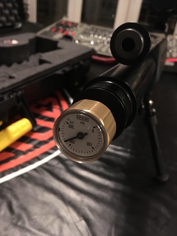

I think I'm going to bite the bullet so to speak and get the EDMU for my WC. I'm tempted to inlet the stock so that I can install it where the little brass nut is so that I can read reg pressure. Once I get things set, I can just put a WIKI there and move the EDMU out to the end of the tube. That is, if it will fit inside the dust cover.

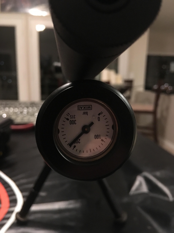

Yeah, I just put the Wika in the end of the pressure tube on my .30 Bobcat. The dust cover needs minor machining to shorten the inner lip by 1.55mm. It works now, but to fit perfect it needs the minor machining. Once that’s done I’ll install the EDMU there. I think it would be a waste to install it to only read reg pressure since there’s so much else it does based on system pressure and air use. Installing the Huma or Wika there would be a very good idea. WIKA on .30 Bobcat MK2 photo below:
No, I didn’t adjust the slingshot at all. From the factory I had about 890 to 895 FPS. That as high as you’ll get with the Huma Reg. In reality due to the very small transfer port you need a pretty high reg pressure to get a decent pellet velocity. I settled on approx 135 to 140 bar and around 860 to 865 FPS. This is right at 30 FPE with 18.1 JSB. You’ll get about a 60 to 65 shot count with 250 bar fill before coming off reg, and then another ten shots or so without a POI shift at 50 yards. ES should be around 7 or 8.
